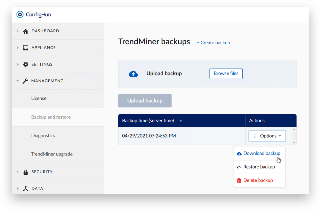

  1. Expand the ‘MANAGEMENT’ menu and go to the ‘Backup and restore’ section.
  2. Click on ‘Options’ drop down button and then choose ‘Download backup’ to download and save the file. Do not uncompress it.
