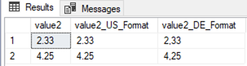

In this case, assuming the values and timestamps originate from the same table, the values.sql query might look as follows
SELECT 
        value2, 
        FORMAT(value2, 'N', 'en-us') as value2_US_Format, 
        FORMAT(value2, 'N', 'de-de') as value2_DE_Format 
FROM Table_1 
