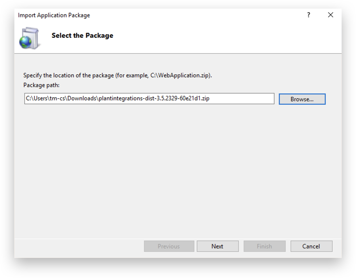

  4. Select the TrendMiner Plant Integrations zip archive and click 'Next'.

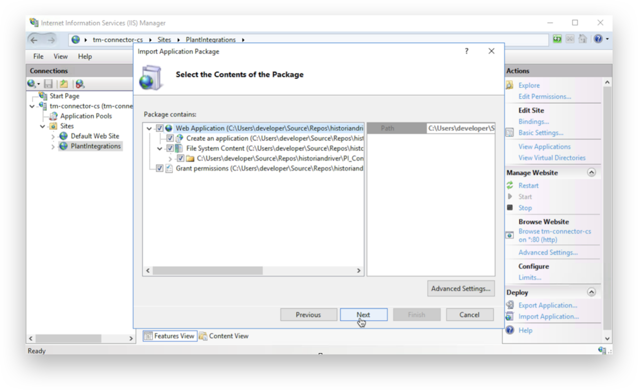

  5. Click 'Next'.

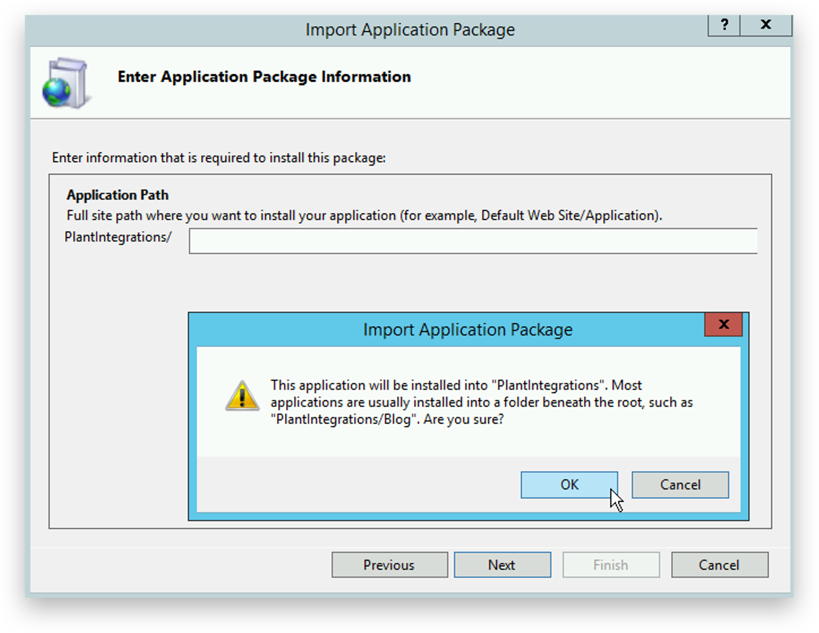

  6. Remove the autocomplete path of HC and click 'Next'.
  7. Click 'OK' to continue. If this error message does not appear, go back to the previous step.

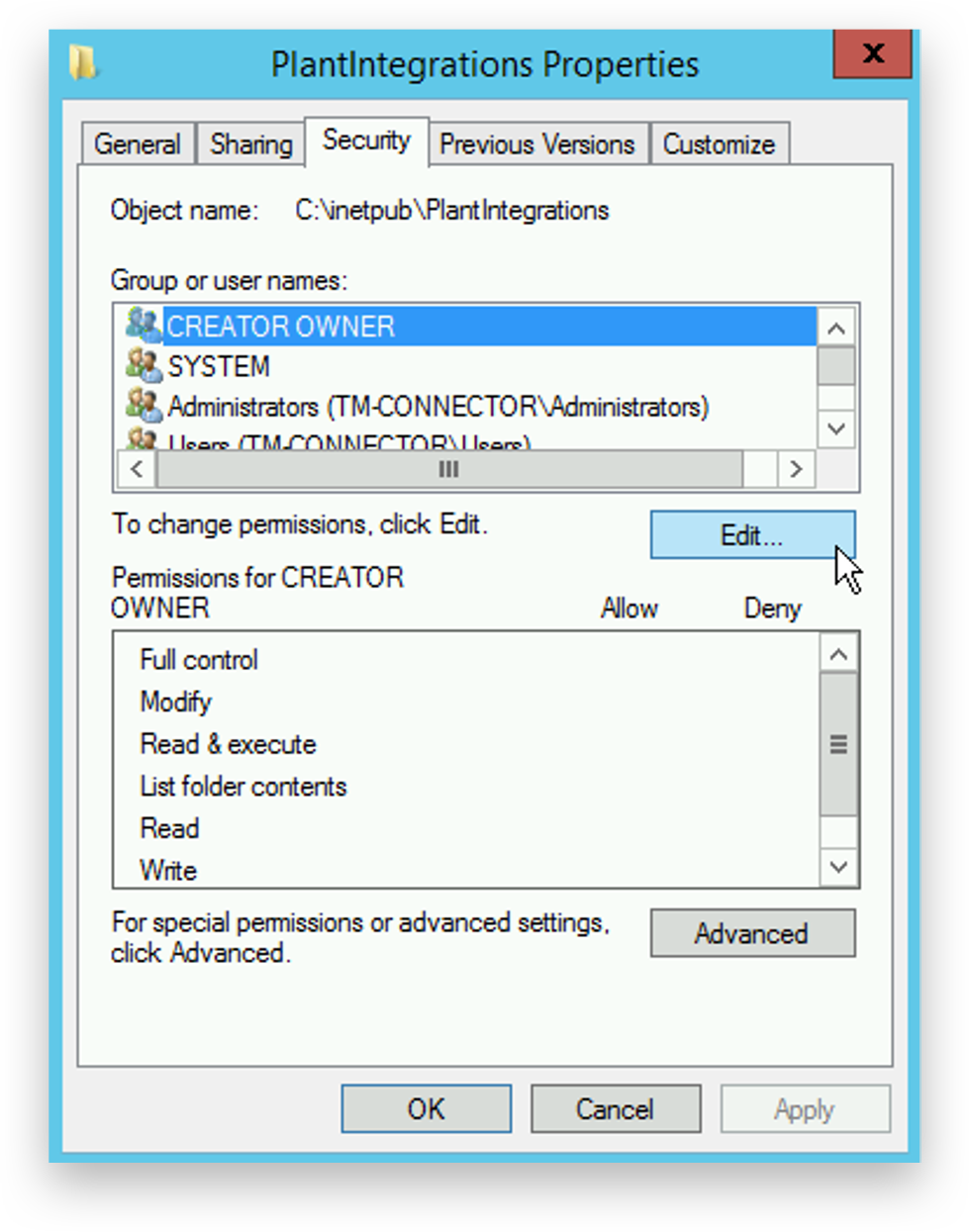

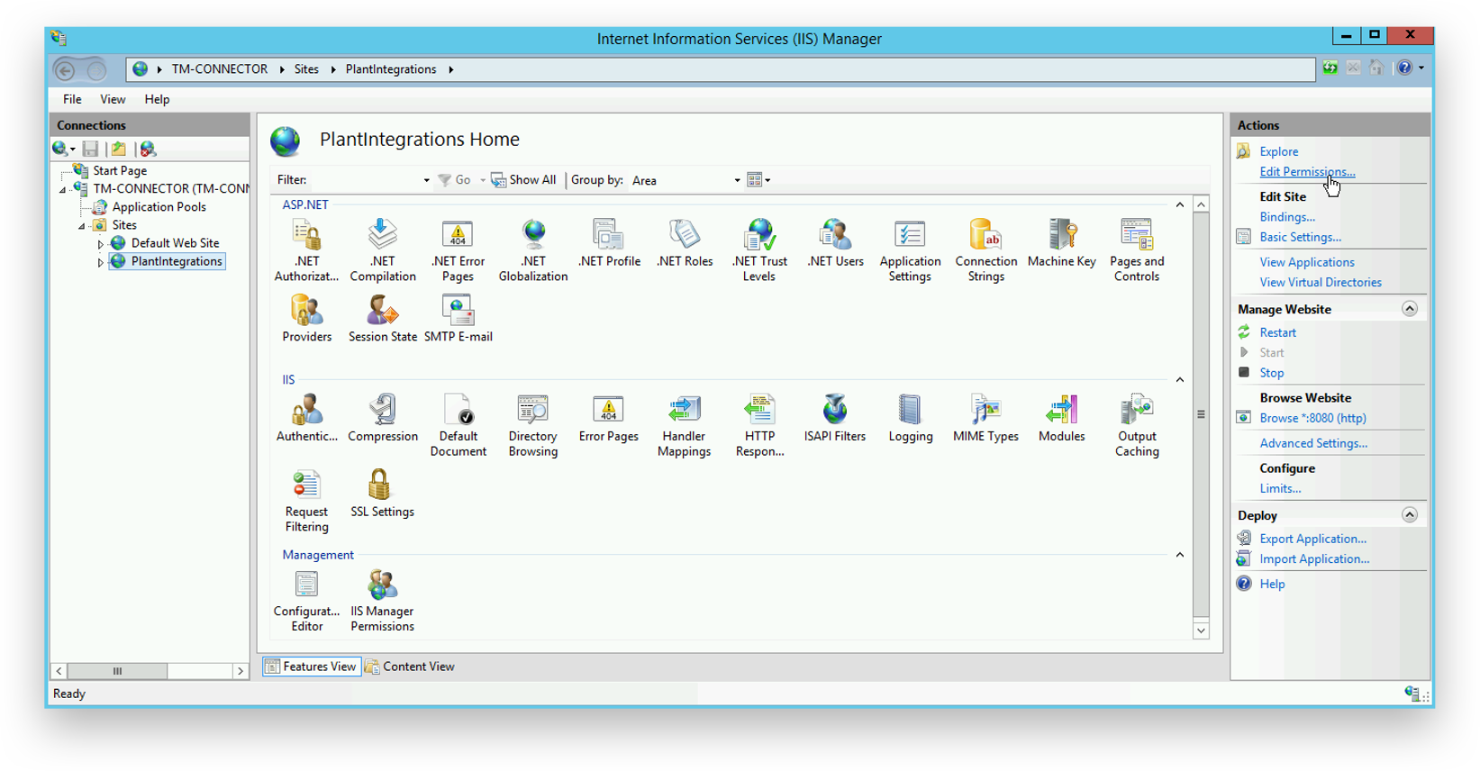

  8. Edit the permissions of the newly created site.

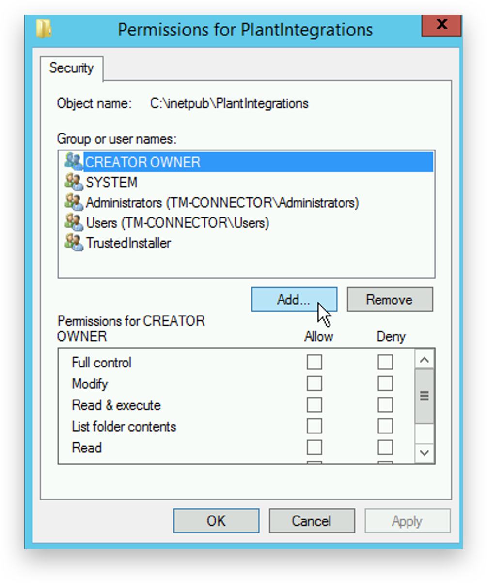

  9. Click 'Edit'.

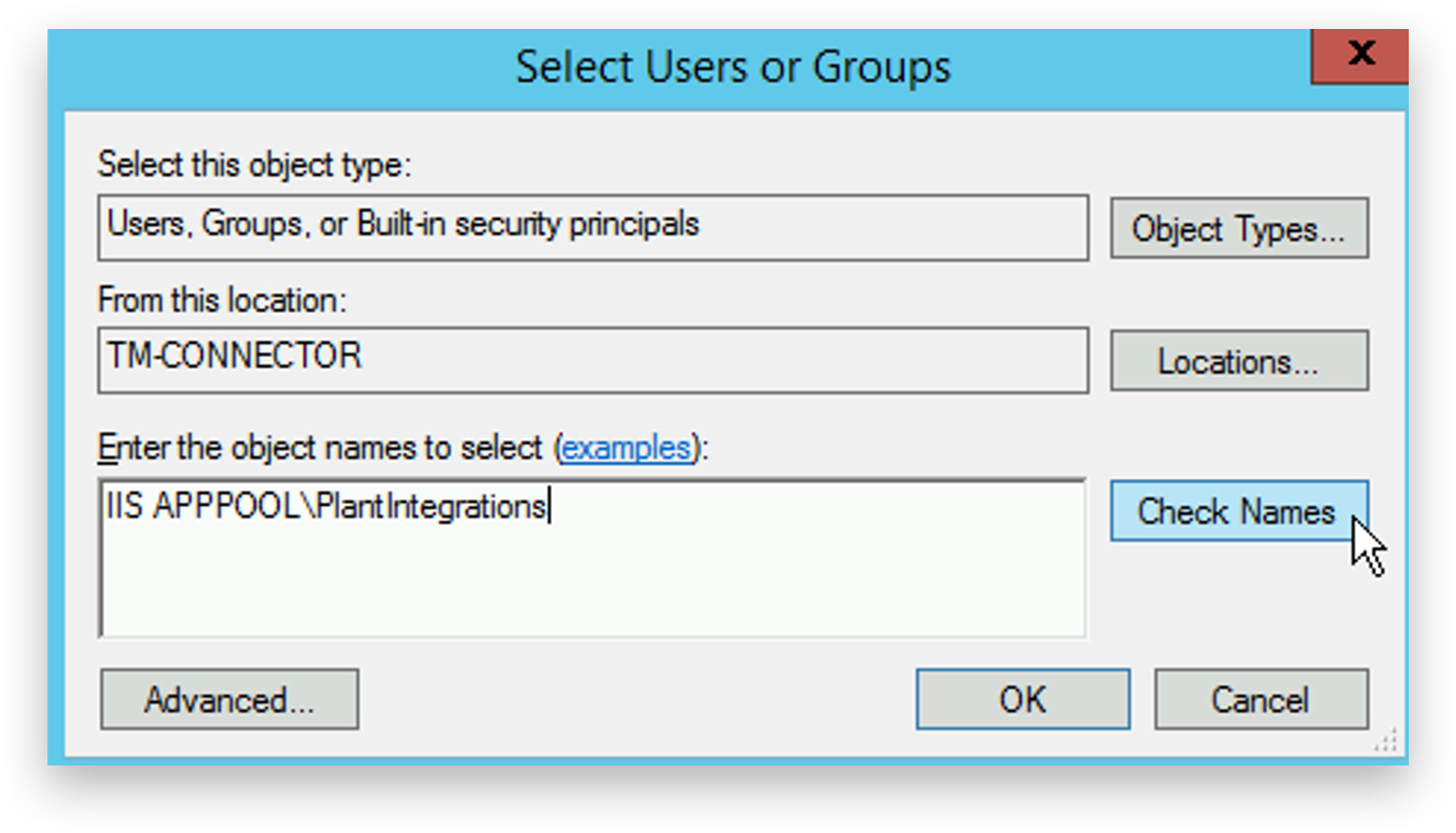

  10. Click 'Add'.
  11. Ensure the location is the current server. If this is a domain, select the current server in 'Locations'. Type IIS APPPOOL\<pool name> and click 'Check Names'.
  12. Click 'OK'.

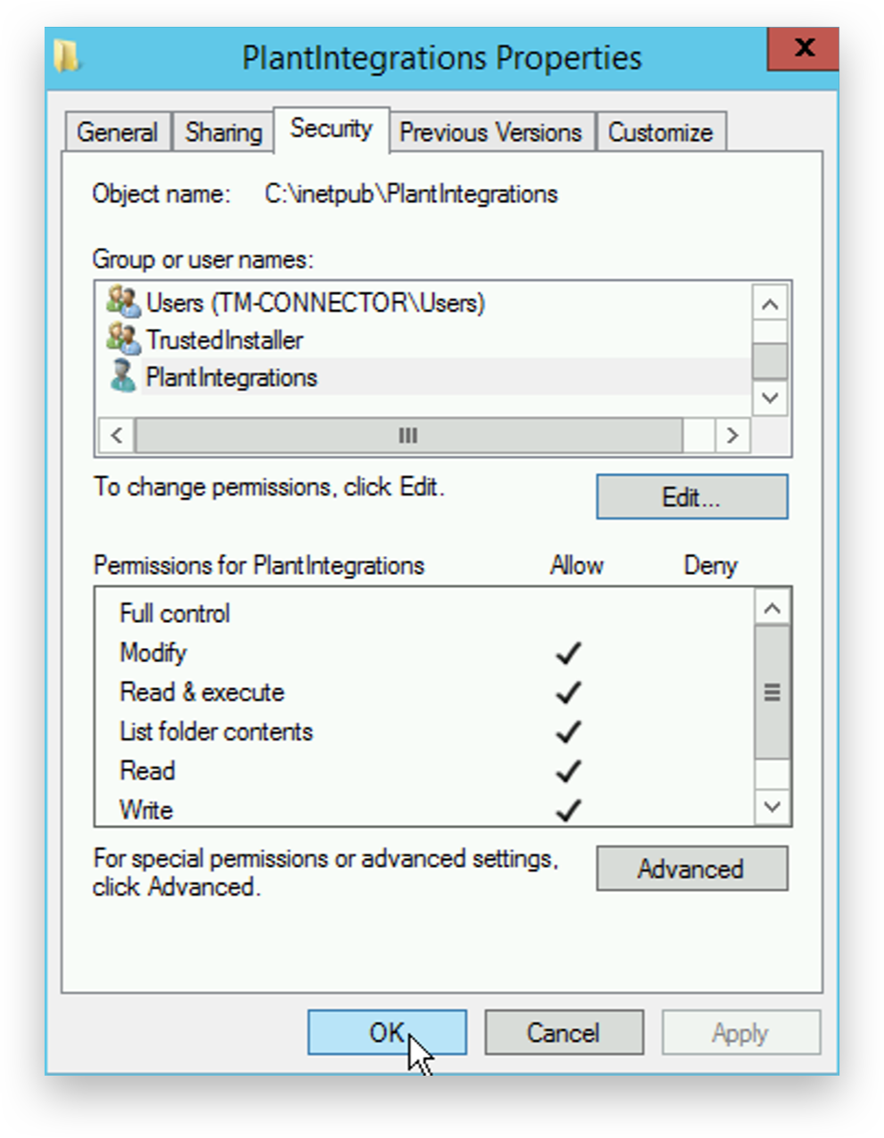

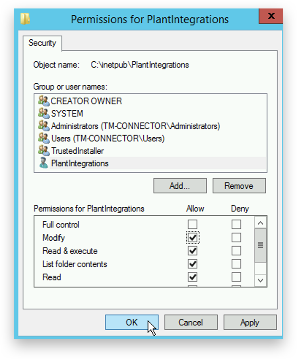

  13. Give the new user 'Modify' permissions.
  14. Click 'OK'.
  15. Accept the new settings by clicking 'OK'.
