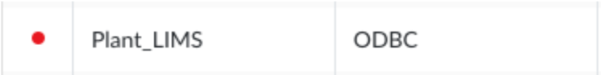

Issue: the connection status of the ODBC data source shows a red dot
