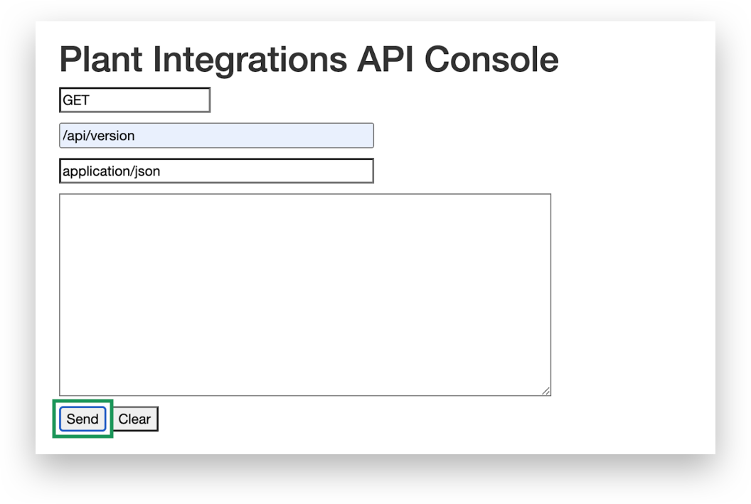

  1. Browse to the local server at the configured port to validate the Plant Integrations installation.
  2. To validate the Plant Integrations version, run the following API call in the Plant Integrations console. Type ‘/api/version’ without the quotation in the second box and click send.

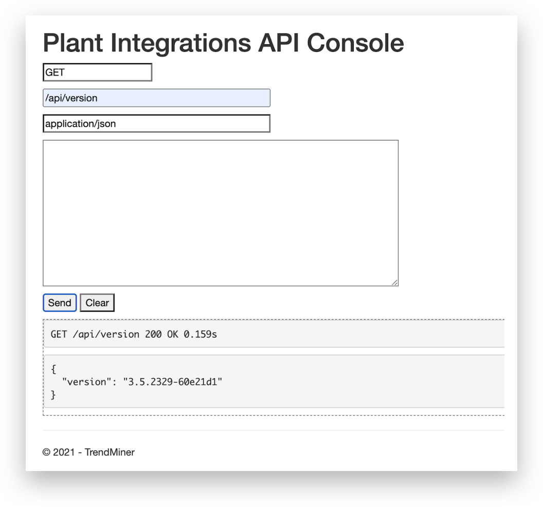

  3. The above API GET request should return the updated version of Plant Integrations.
