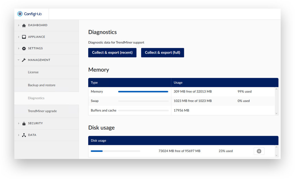

  1. Further instructions are provided in subsequent slides to extend the disk. Expand the ‘MANAGEMENT’ menu and click ‘Diagnostics’.

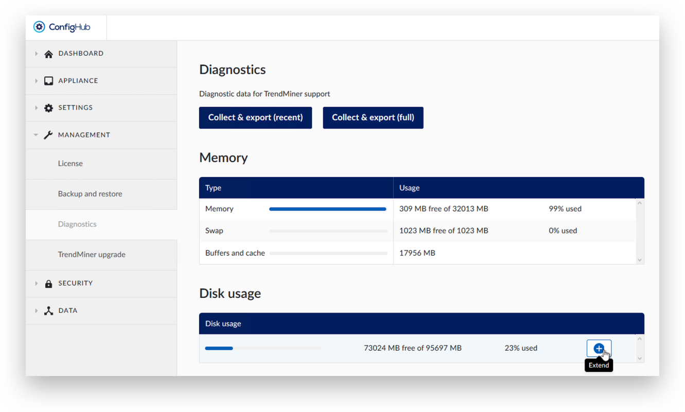

  2. Under the ‘Disk usage’ section, click the ‘+’ icon to start the disk extension process.

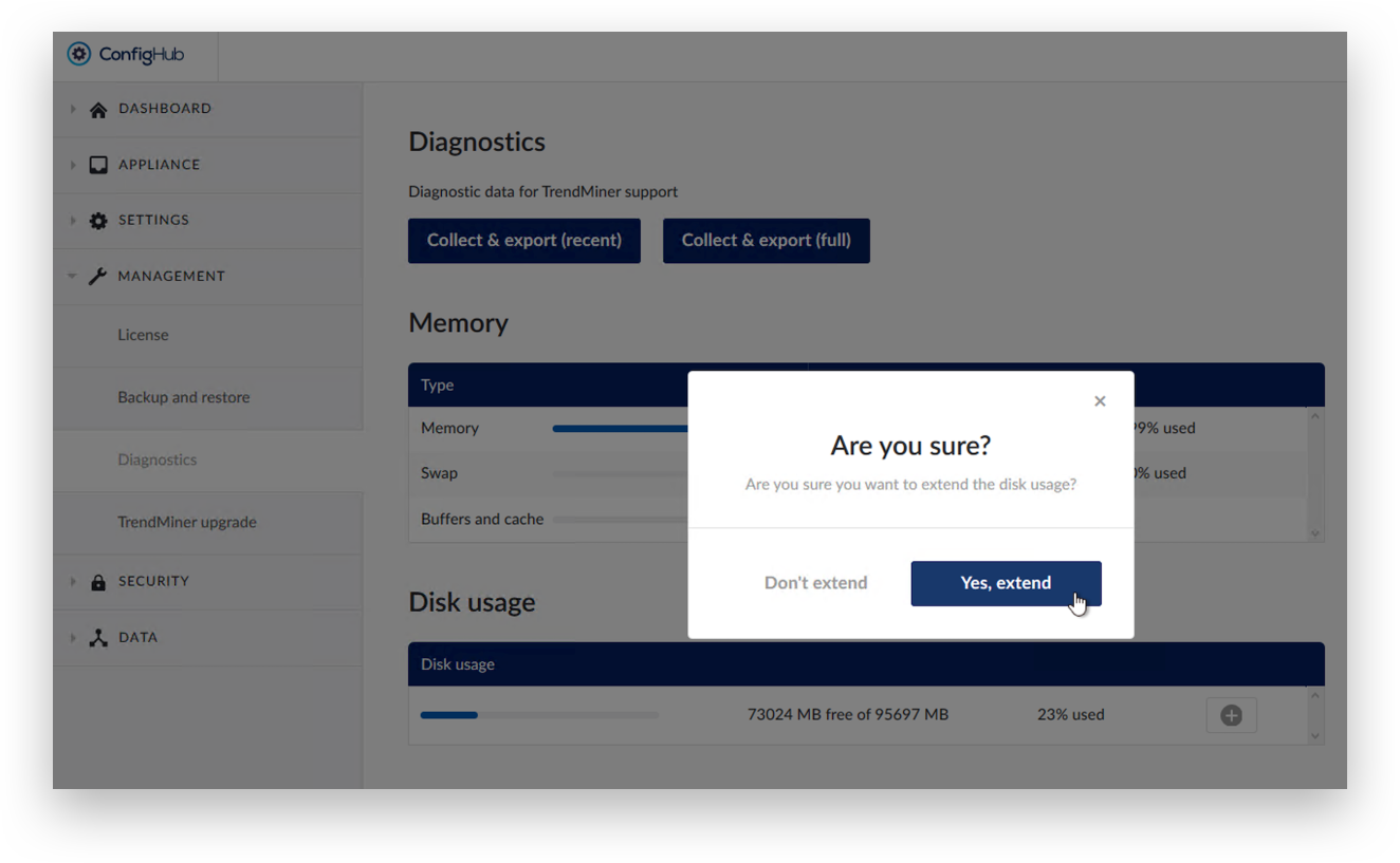

  3. Click ‘Yes, extend’ to confirm the choice.

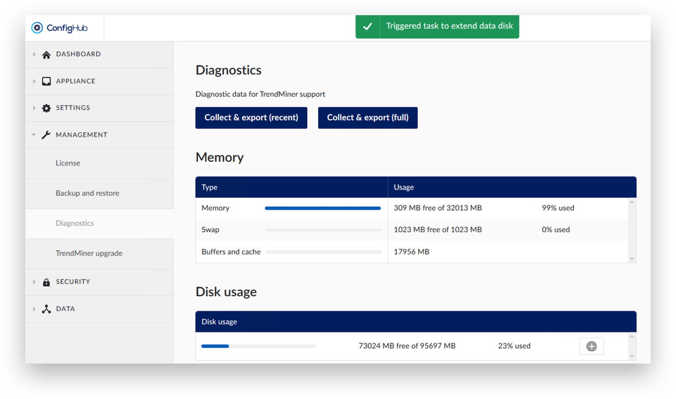

  4. A green message at the top will say ‘Triggered task to extend data disk’.

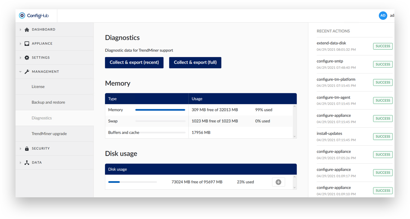

  5. Wait until the ‘extend-data-disk’ status changes to ‘SUCCESS’ in the ‘Recent Actions’ panel. TrendMiner is now able to use the extra disk space.
