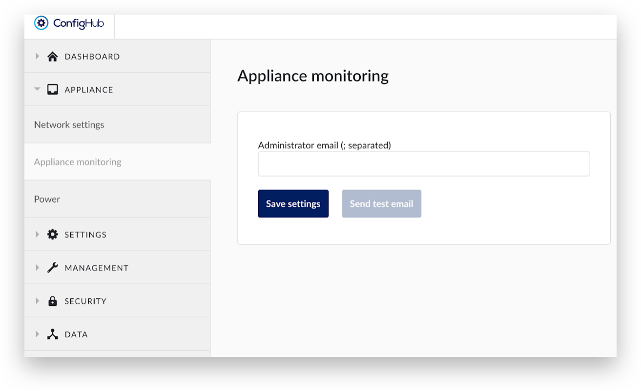

  1. Expand the ‘APPLIANCE’ menu and click on ‘Appliance monitoring’.

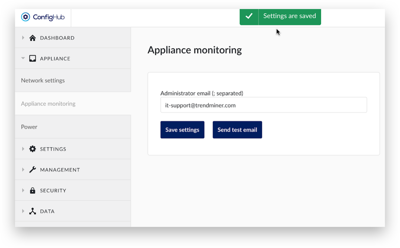

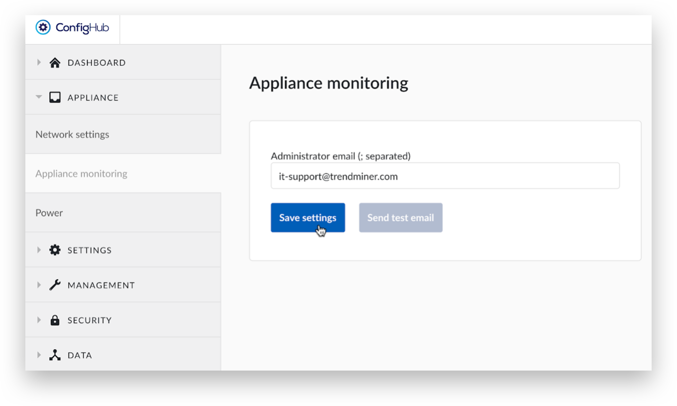

  2. Provide a mail address of the TrendMiner infrastructure administrator or the administrator group then click ‘Save settings’.
  3. A green message at the top will say ‘Settings are saved’.

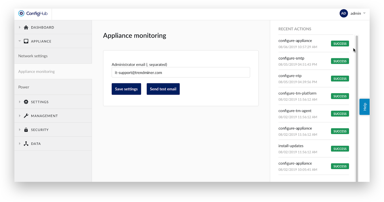

  4. This will trigger the ‘configure-appliance’ task under ‘Recent Actions’. Wait until the ‘configure-appliance’ task changes to the ‘SUCCESS’ status.

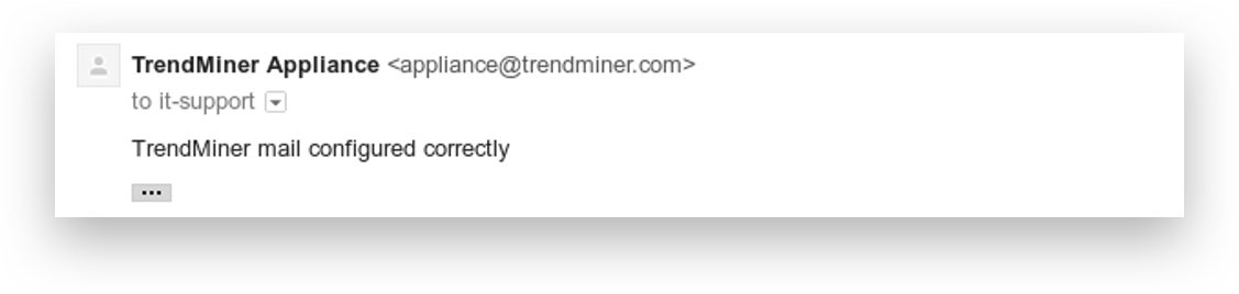

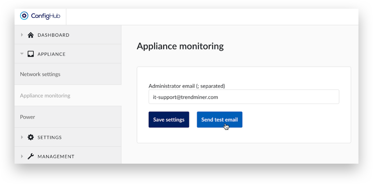

  5. Once the configuration task is successful, verify the mail configuration by clicking ‘Send test mail’.
A test email will be sent to the provided email address.
