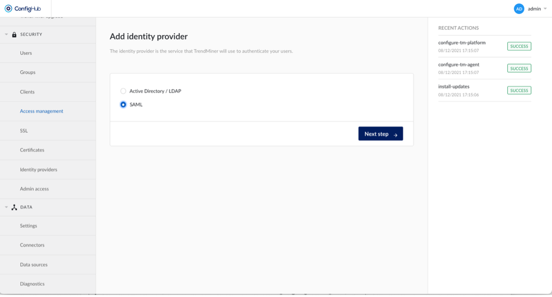

  • Looking to switch from LDAP to LDAPs -> follow these instructions:

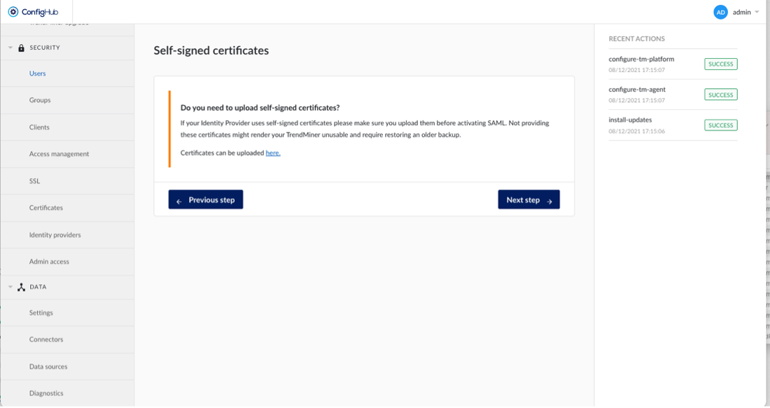

    1. Import the right certificates (AD Root CA) into ConfigHub (certifications section)
    2. Restart tm-keycloak

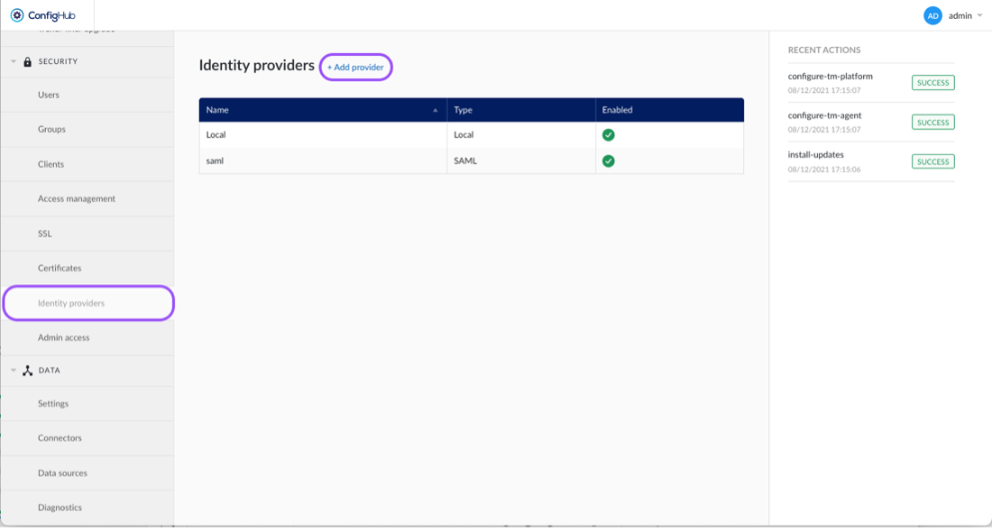

    3. Change the URL in the Identity Providers session from ldap:// to ldaps://
ldaps go by default through port 636 (ldap goes through 389), so this one will need to be open.
  3. Select the "Active Directory / LDAP" option.

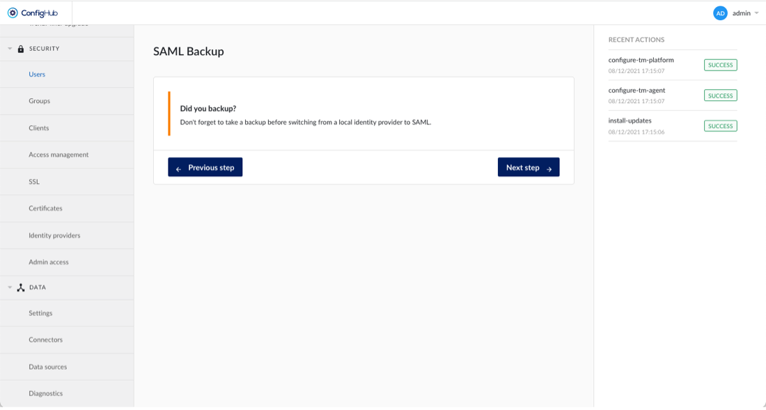

  4. Create a TrendMiner backup. A backup allows you to rollback to the final non-AD/LDAP state.

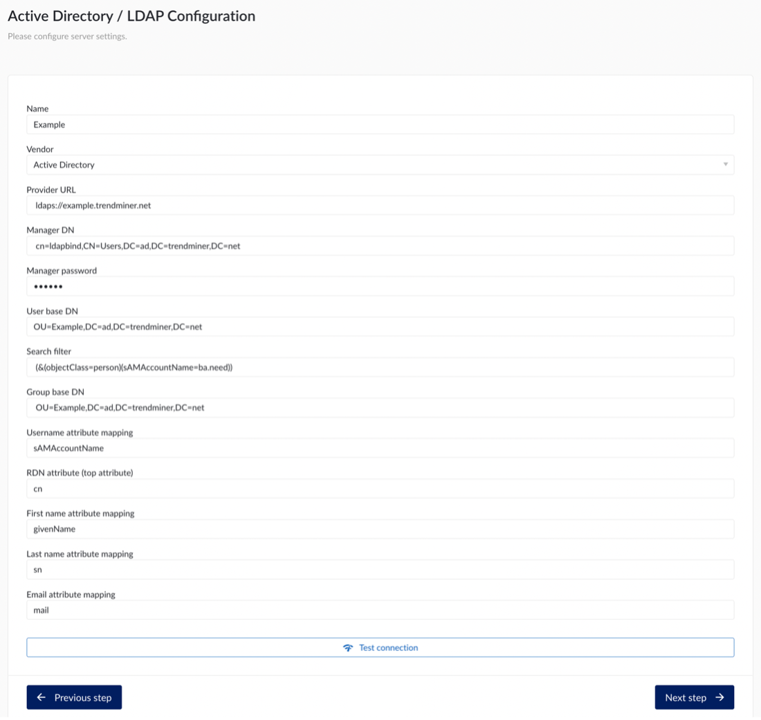

  6. Configure the Active directory / LDAP connection. Users are found by starting at a configurable point in the LDAP tree structure. TrendMiner will then recursively descend the tree and select users thatmatch a given filter.
    • Name:
    • Vendor: Choose your vendor from the available list:
      • Active Directory
      • Red Hat Directory Server
      • Tivoli
      • Novel eDirectory
      • Other
    • Provider URL: The hostname of the LDAP server, including the protocol ldap://
    • Manager DN: Name of LDAP attribute, which is mapped as Keycloak username. For many LDAP server vendors it can be 'uid'. For Active directory it can be 'sAMAccountName' or 'cn'. The attribute should be filled for all LDAP user records you want to import from LDAP to TrendMiner.
    • Manager password: The password of the Manager DN user.
    • User base DN: Full DN of LDAP tree where your users are. This DN is the parent of LDAP users. It could be for example 'ou=users,dc=example,dc=com' assuming that your typical user will have DN like 'uid=john,ou=users,dc=example,dc=com'"
    • Search filter: Additional LDAP Filter for filtering searched users to restrict the users that are permitted access to TrendMiner. Make sure that it starts with '(' and ends with ')' E.g. (objectCategory=Person) will select all users.
    • Group base DN: The DN of the starting point of tree walking for groups. For example, 'ou=groups,dc=example,dc=org'.
    • Username attribute mapping: The name of the attribute that represents the username of the user.
    • RDN attribute (top attribute): Name of LDAP attribute, which is used as RDN (top attribute) of typical user DN. Usually it is the same as Username LDAP attribute, however it is not required. For example, for Active directory, it is common to use 'cn' as RDN attribute when username attribute might be 'sAMAccountName'.
    • First name attribute mapping (optional): This attribute points to the user's first name.
    • Last name attribute mapping (optional): This attribute points to the user's surname or last name.
    • Email attribute mapping (optional): mail address of the user.
    • Test connection: You can use the Test connection functionality to validate your configuration quickly

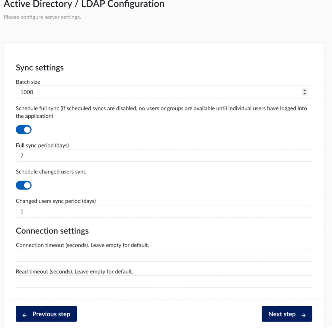

  7. Configure the server settings:
    • Sync settings:
      • Batch size: Count of LDAP users to be imported from LDAP to TrendMiner within a single transaction.
      • Schedule full sync: Enable a full synchronization of LDAP users to TrendMiner. If scheduled syncs are disabled, no users or groups are available until individual users have logged into the application.
      • Full sync period (days): Period of full synchronization of LDAP users in days.
      • Schedule changed users sync: Enable synchronization of new or changed LDAP users to TrendMiner.
      • Changed users sync period (days): Period of synchronization of changed or newly created LDAP users in days.
        A manual sync can be performed by the TrendMiner admin after the configuration is complete.
    • Connection settings:
      • Connection timeout: LDAP connection timeout in seconds.
      • Read timeout: LDAP read timeout in seconds.

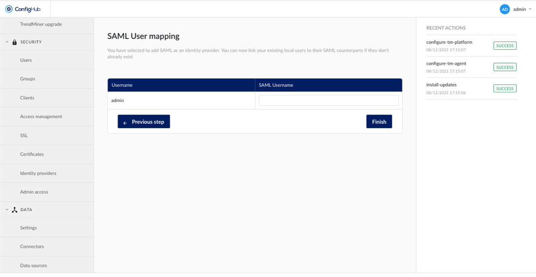

  8. The next screen allows to map existing (local) TrendMiner users to the users of the LDAP provider.
  9. The LDAP setup is complete and you should be able to login in TrendMiner.

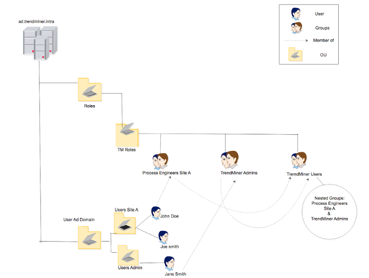

Two example configurations are described here. A first case describes a simple configuration where users of one group receive access. A second case describes a more advanced configuration where users of multiple groups receive access.
Consider the following LDAP tree structure:
(objectClass=person)
The full filter becomes:
