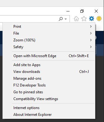

Internet Explorer 11
Left click on the cogwheel in the top right of the browser window.
Click on 'F12 Developer Tools'.
This will open the developer tools.

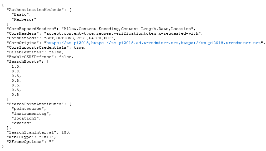

Make sure that the URL used, exists in the configuration of PI Web API.
To see which URL or 'origin' is allowed, the following link can be visited:
https://PI_SERVER/piwebapi/system/configuration
PI_SERVER should be replaced by the server on which PI is installed. This is the part before '/PIVision' of the URL on which PI Vision can be viewed.
E.g. If http://my-company.something-else.com/PIVision is used to visit PI Vision, the URL for the PI Web API would be https://my-company.something-else.com/PIWebAPI.
Depending on how the server is configured, this might show a screen that says 'Insecure connection'.
When visiting this URL, a response will be shown including the 'CorsOrigins' (see following figure).
The 'CorsOrigins' list should contain the 'origin' on which PI Vision is visited.
E.g. http://tm-pi2018.ad.trendminer.net/PIVision is used, the 'origin' in this case is 'http://tm-pi2018.ad.trendminer.net', which is not in the list of 'CorsOrigins'. However 'https://tm-pi2018.ad.trendminer.net' is in the list of 'CorsOrigins'.
