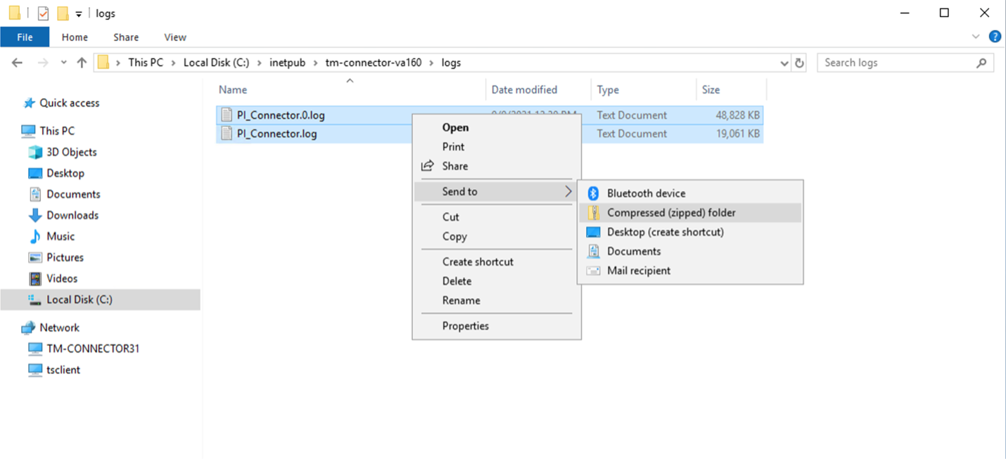

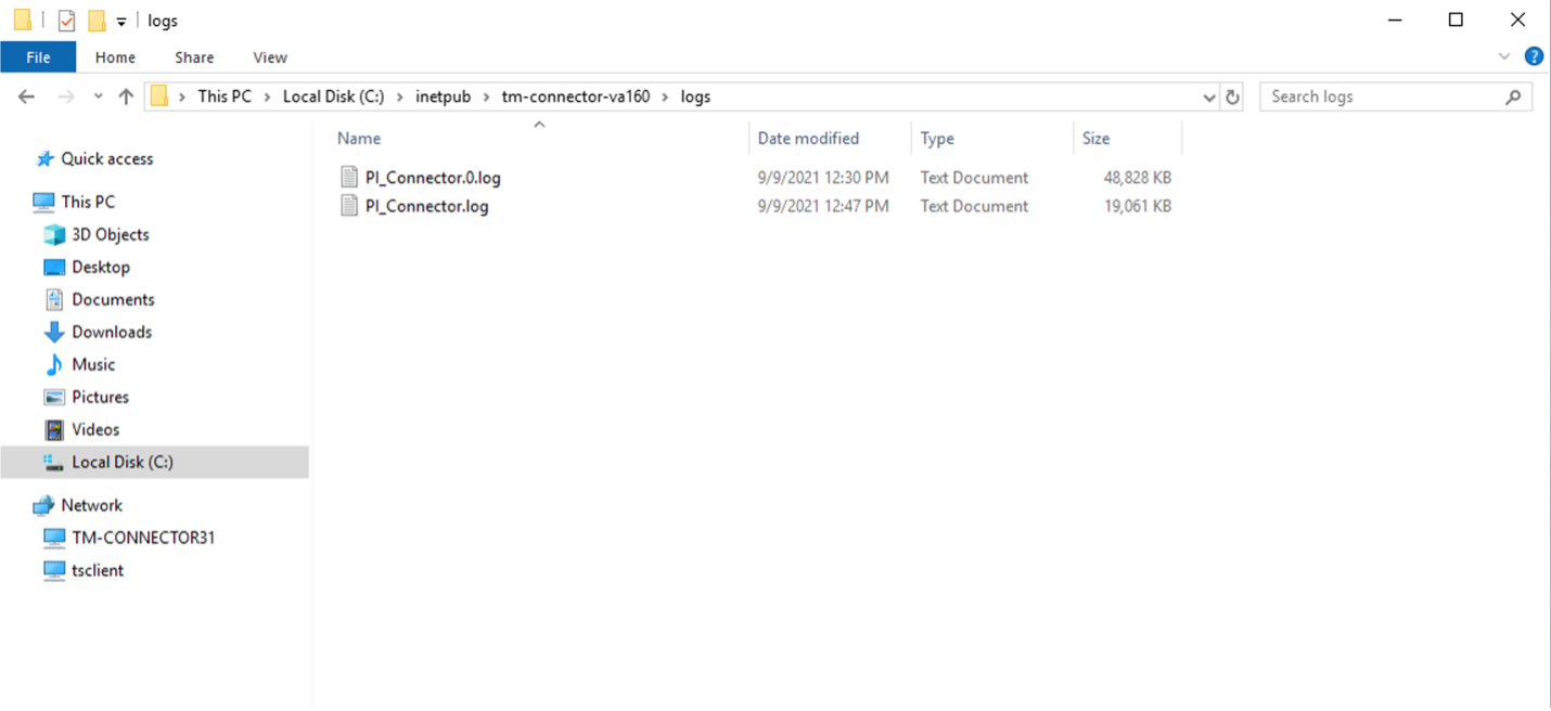

  1. Log in on the connector (plant integration) server.
  2. Open the folder 'c:/inetpub/<myconnector>/logs'
  3. Select all .log files and compress them into a .zip file.
