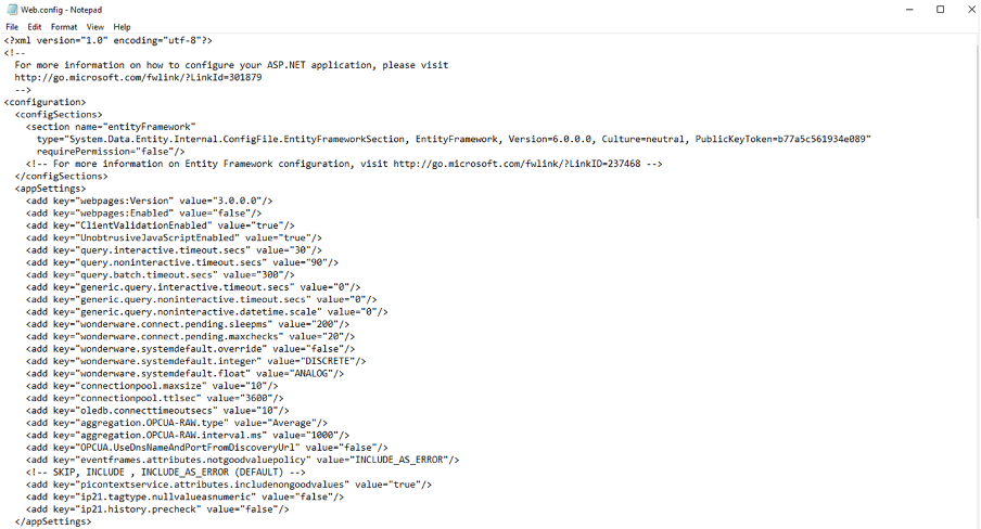

TrendMiner’s standard connector (also known as ‘Plant Integration’) supports out-of-the-box connectivity to some common time series, context and asset data sources. More information on the natively supported data sources can be found here. Some of these connections have configurable parameters which can be used to optimize the connection or change the behavior of the connection. All connector configuration is saved in a file called Web.config which is located in the root directory of the installed connector.
The following parameters are supported in version v3.6.4628-7b4561a[1].
