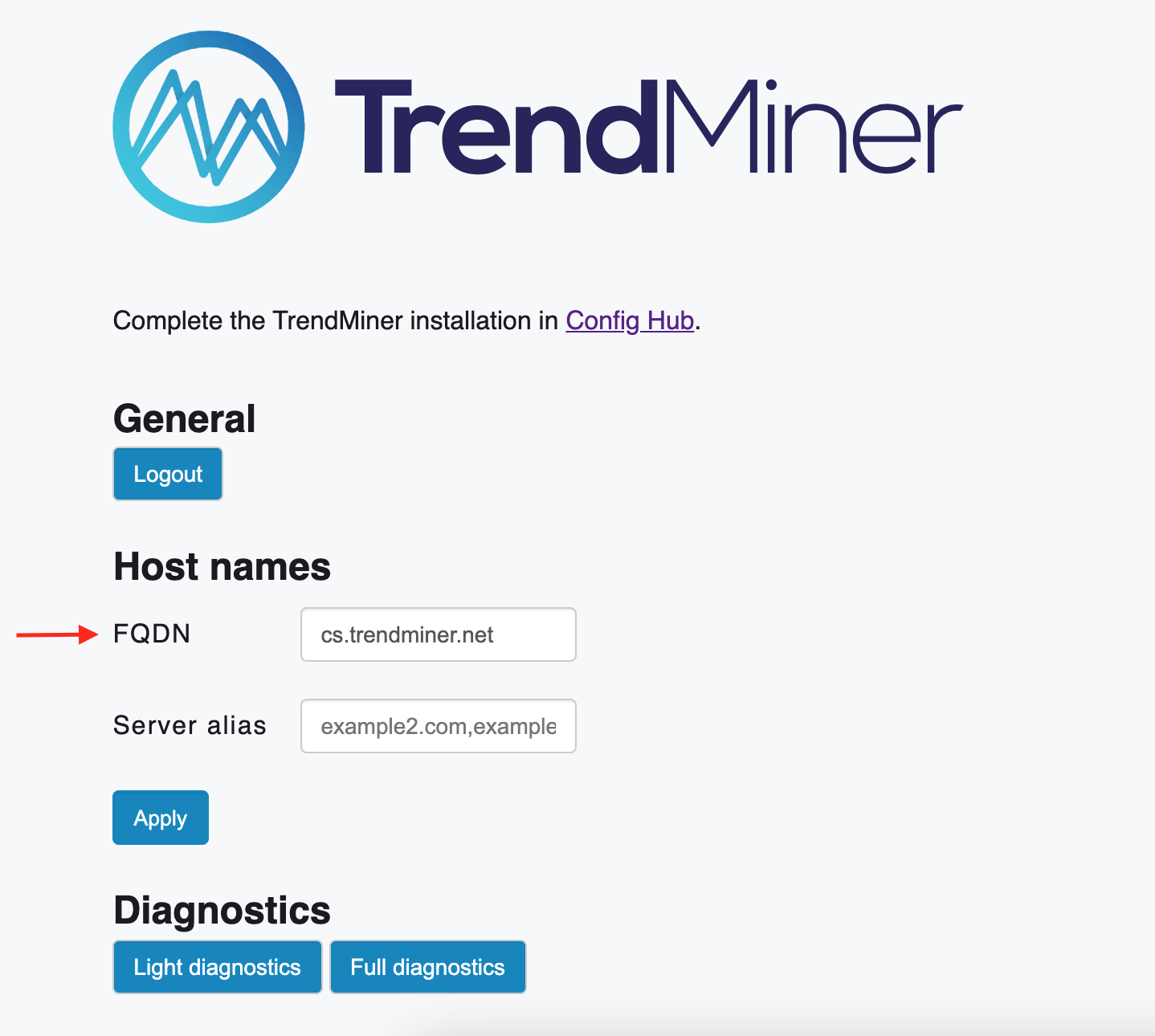

  • Before the upgrade, make sure the FQDN (Fully Qualified Domain Name) of your installation is filled in properly on the appliance page. If this field is not filled in correctly the update will be stopped. This page can be found on http://<trendminerurl>/appliance
    Note that:
    • the FQDN should not contain the protocol (https);
    • only 1 FQDN can be configured. Only this configured FQDN can be used by users to browse to TrendMiner. In case you require multiple FQDNs to be configured, please contact TrendMiner support before triggering the upgrade;
    • the FQDN is case sensitive.

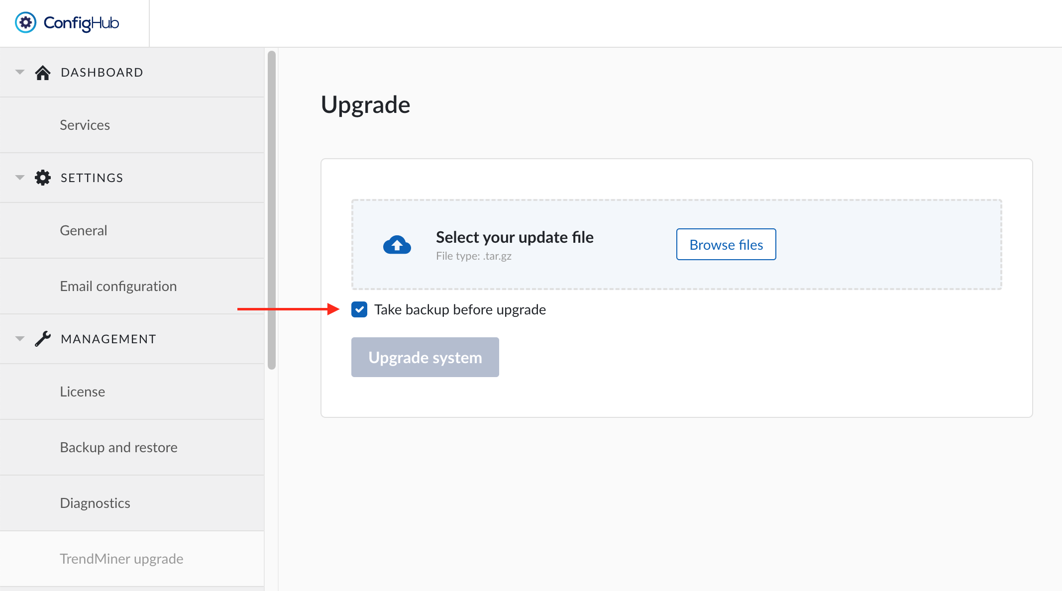

During an upgrade a backup is automatically created. This backup process can take a significant amount of time that adds to the overall downtime. To reduce this, the admin can take a manual backup first before launching an upgrade.
Create a manual backup via ConfigHub -> Backup and restore:
Uncheck the "Take backup before upgrade" checkbox when upgrading TrendMiner:
