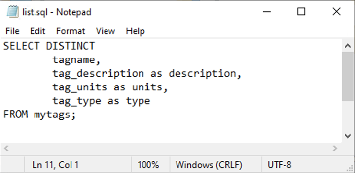

List file
The list.sql file will contain a SQL SELECT statement and shall return all the tags with additional metadata as shown below. If the “type” property doesn't return one of the supported tag types, you shall generate your own mapping with the type.csv file.
Example query output:
Only the tag name is strictly required and needs to be unique per tag (the tag name is used as unique identifier within TrendMiner). Description and units can be left empty. The type is required if you want to support different interpolation types for different tags. If not, the type can be hardcoded in the queries.
For additional examples, refer to the following article: Examples of SQL queries for ODBC connections
Note that stored procedures can be used for retrieving tags as long as they return a result set.

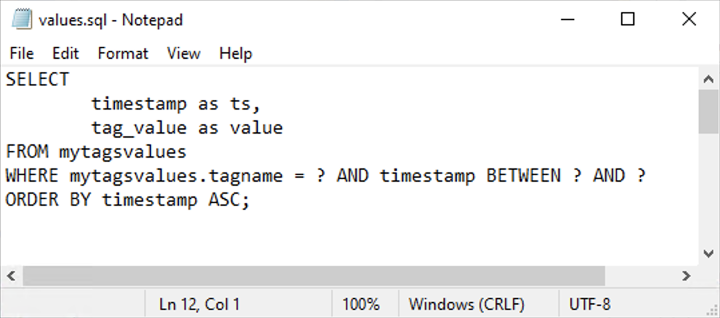

Values file
The values.sql file will contain a SQL SELECT statement and shall return all the values and timestamps for a given tag name and date range.
Queries to retrieve points use binding parameters (specified in query by ?). If binding parameters (?) are not supported then .NET string formatting can be used so use '{0}', '{1}' and '{2}' (include single quotes) instead of the question mark.
Note that stored procedures can be used for retrieving tag data as long as they return a result set.
Output requirements:
Timestamps should be in chronological order, oldest first
All timestamps returned should be inside of the requested time interval
The complete response should be returned within a reasonable timeframe of 5-30 seconds. A well performing data source returns 1 month of data in around 1 second. The response time can be influenced by tweaking the index granularity setting in ConfigHub. Check the user documentation for more info.
Acceptable amount of datapoints within the given timeframe. The number of data points returned can be influenced by tweaking the index granularity setting in ConfigHub. Check the user documentation for more info.

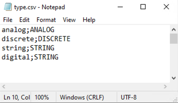

Type file
In case that the types returned in the list.sql file aren’t one of the supported ones you can generate your own mapping as shown below. Even though it isn't require it is good practice to map each type to one supported by TrendMiner.
