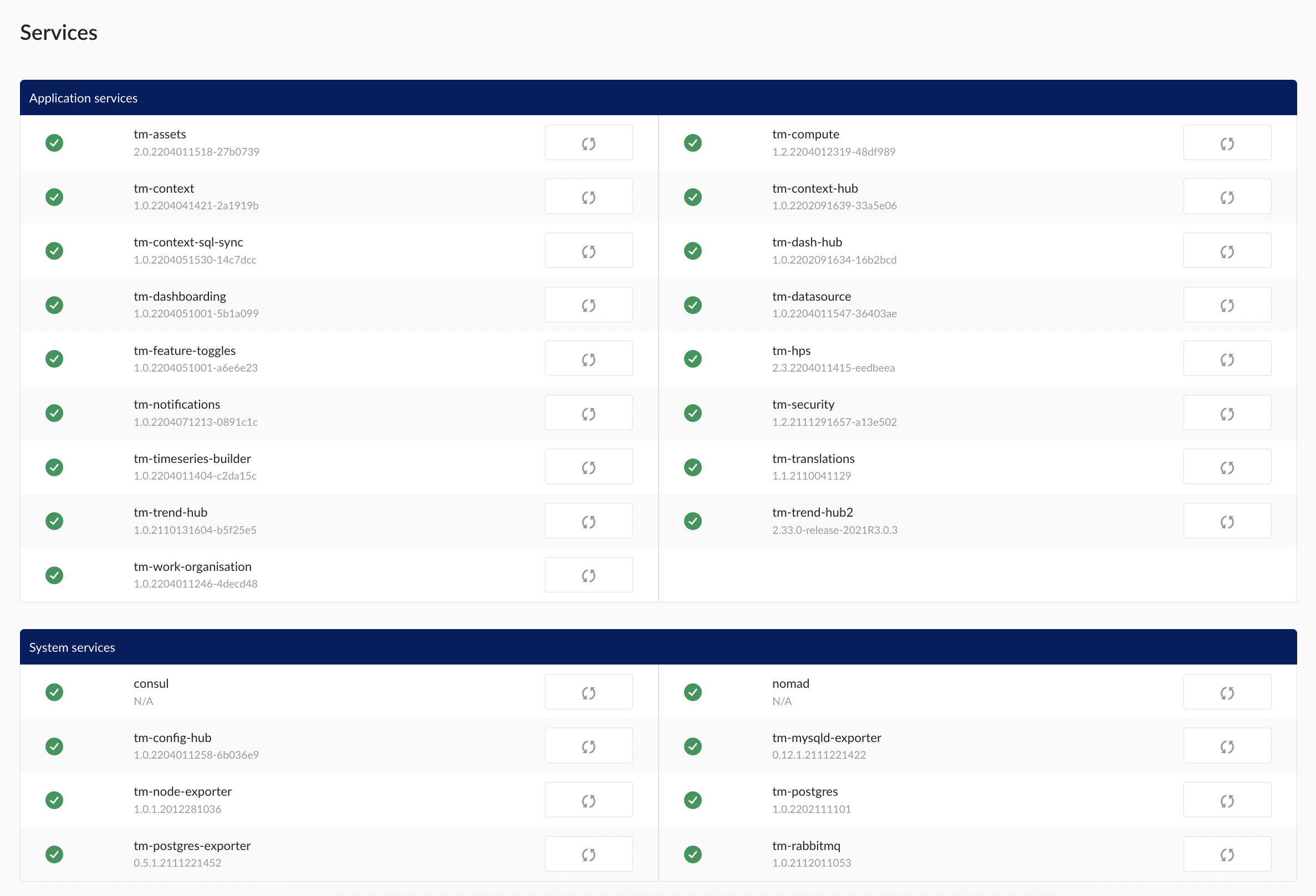

  1. Log in to ConfigHub by browsing to ‘http://<trendminer_address>/confighub’. Make sure all the Application Services are in healthy status.
    Services 2021.R3.0

  12. After logging in again, make sure all services listed below are shown and healthy. In case of missing services or if the status is not green, please contact TrendMiner Support.
    After the upgrade to 2022.R1.0 a manual restart of the service will no longer be shown in the task queue on the right of the screen. This is a known issue in this release. When restarting a service keep refreshing the page until the service shows a green checkmark again. If after several minutes the checkmark does not turn green, please contact support.
