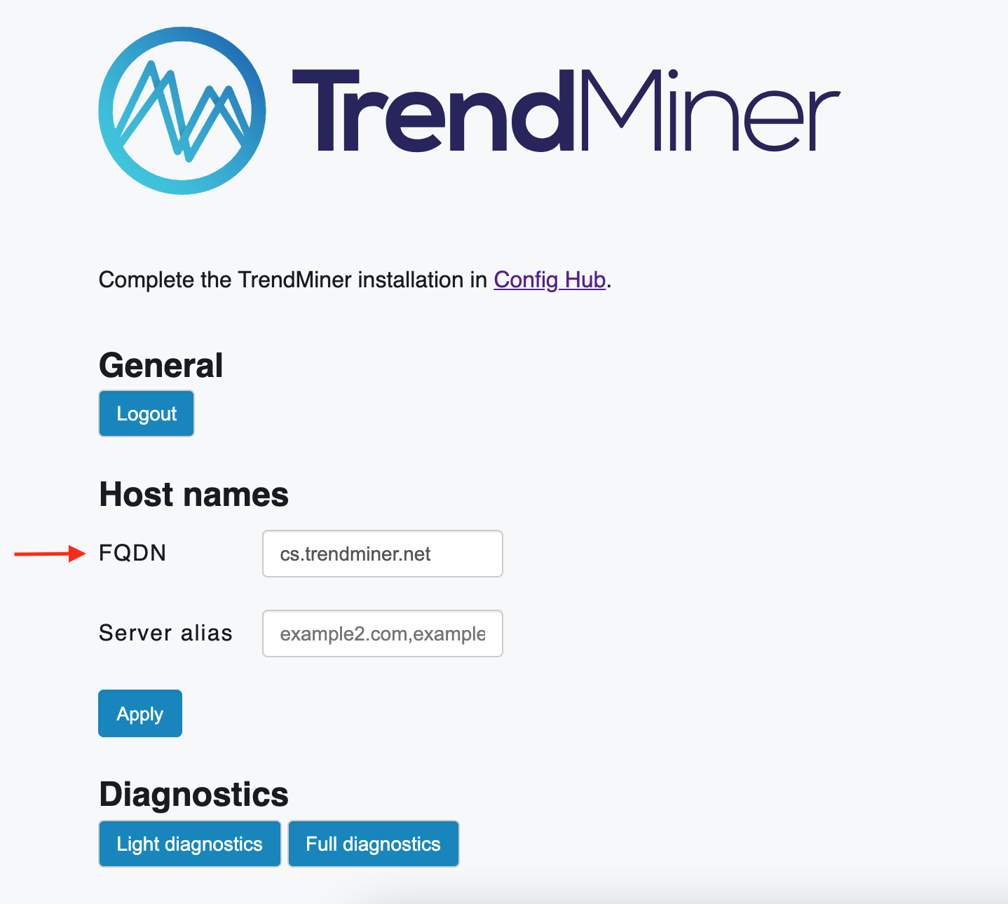

  • Before the upgrade, make sure the FQDN (Fully Qualified Domain Name) of your installation is filled in properly on the appliance page. If this field is not filled in correctly the update will be stopped. This page can be found on http://<trendminerurl>/appliance
    Note that:
    • the FQDN should not contain the protocol (https);
    • only 1 FQDN can be configured. Only this configured FQDN can be used by users to browse to TrendMiner. In case you require multiple FQDNs to be configured, please contact TrendMiner support before triggering the upgrade;
    • the FQDN is case sensitive.
