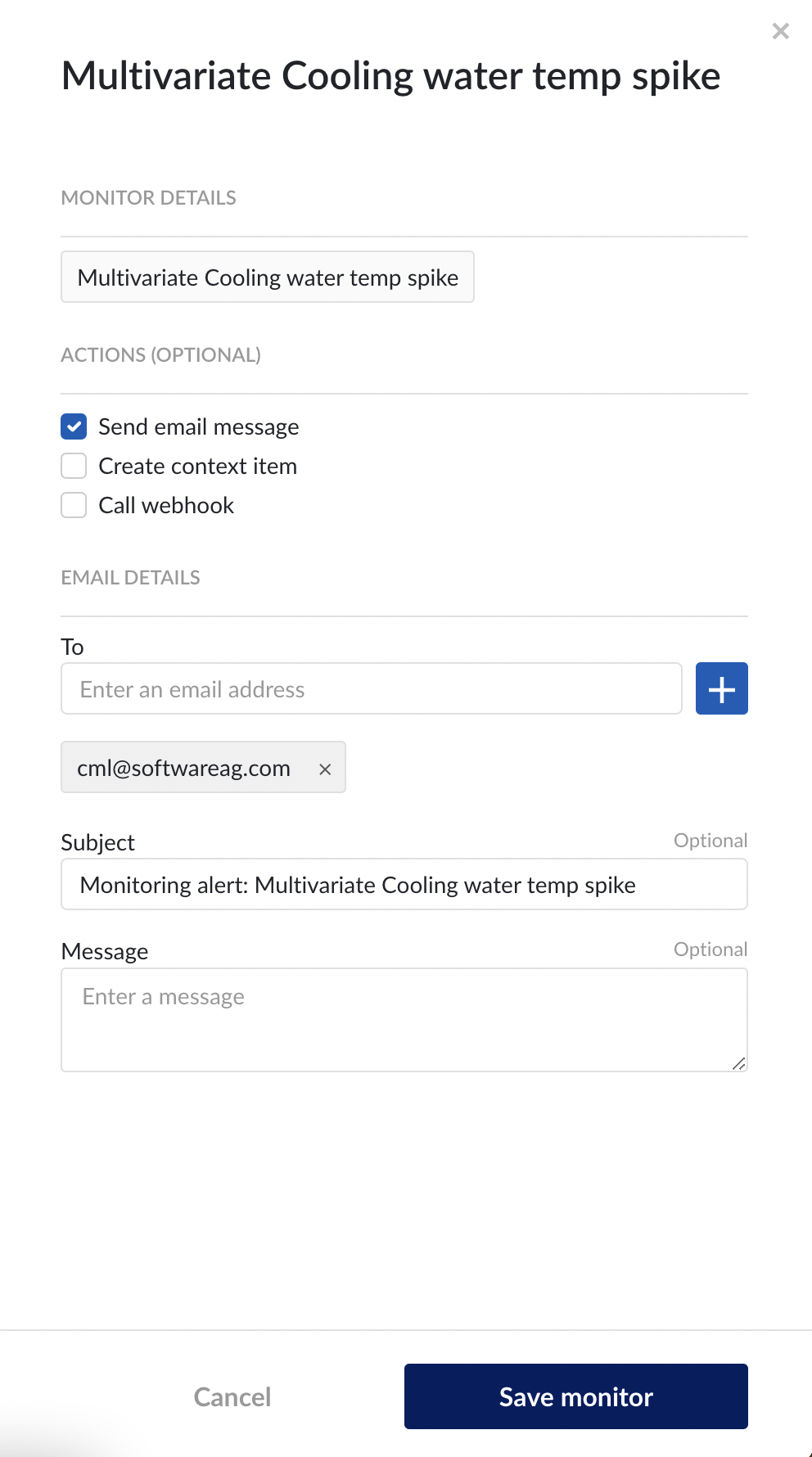

TrendMiner monitoring can alert users by email when one of their monitoring patterns detects a match. The screenshot below shows an example of such a monitoring mail alert.
