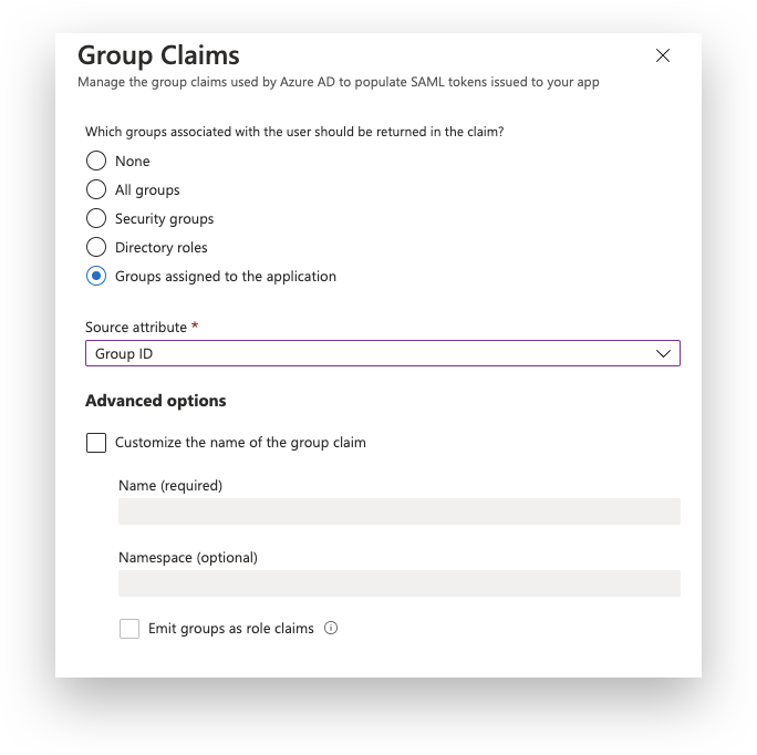

Configure groups:
Click the "Edit"-button under "User Attributes & Claims"
Click the "Add a group claim"-option.
Set the Group Claims as shown on the screenshot below:
Associated: Groups assigned to the application.
Source attribute: Group ID
