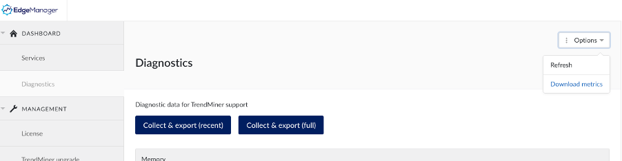

The Edge Manager diagnostics page contains the following functionality:
Extract appliance logs
  • "Collect and export (recent)": when clicked, TrendMiner will generate an archive file containing the 'light logs' and start the download once the archive file is available. The 'light logs'/'recent logs' will contain only recent data and will also contain less data. Gather these logs for issues which occurred the last day(s) and are unrelated to performance or service crashes.
  • "Collect and export (full)": when clicked, TrendMiner will generate an archive file containing the 'full logs' and start the download once the archive file is available. The full logs will contain more historical logging (up to a week or longer) and will contain more data. The full logs are required for more profound troubleshooting, performance analyses, ...
When in doubt about which log files to collect, please collect the full logs.

Export metrics
Via the “Options” button at the top right, you can click “Download metrics”, to trigger the export of the metrics data.
More information about metrics collection can be found here: License audit
