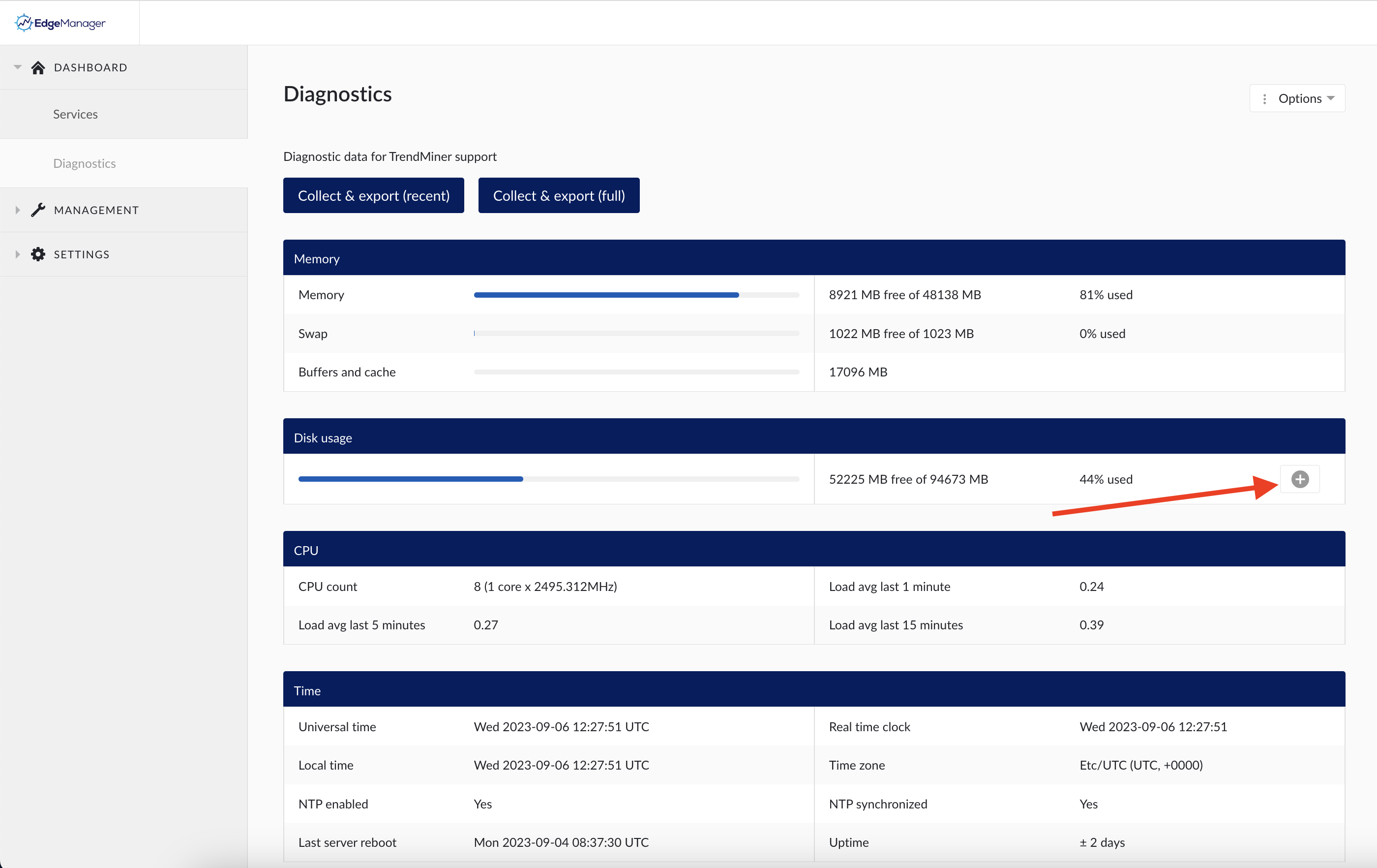

  4. Open Edge Manager -> expand the ‘DASHBOARD’ section and click ‘Diagnostics’.
    edge_manager_diagnostics_2023.R3.0
  5. Under the ‘Disk usage’ section, click the ‘+’ icon to start the disk extension process.
    edge_manager_diagnostics_expand_disk_2023.R3.0
  6. Click ‘Yes, extend’ to confirm the choice.

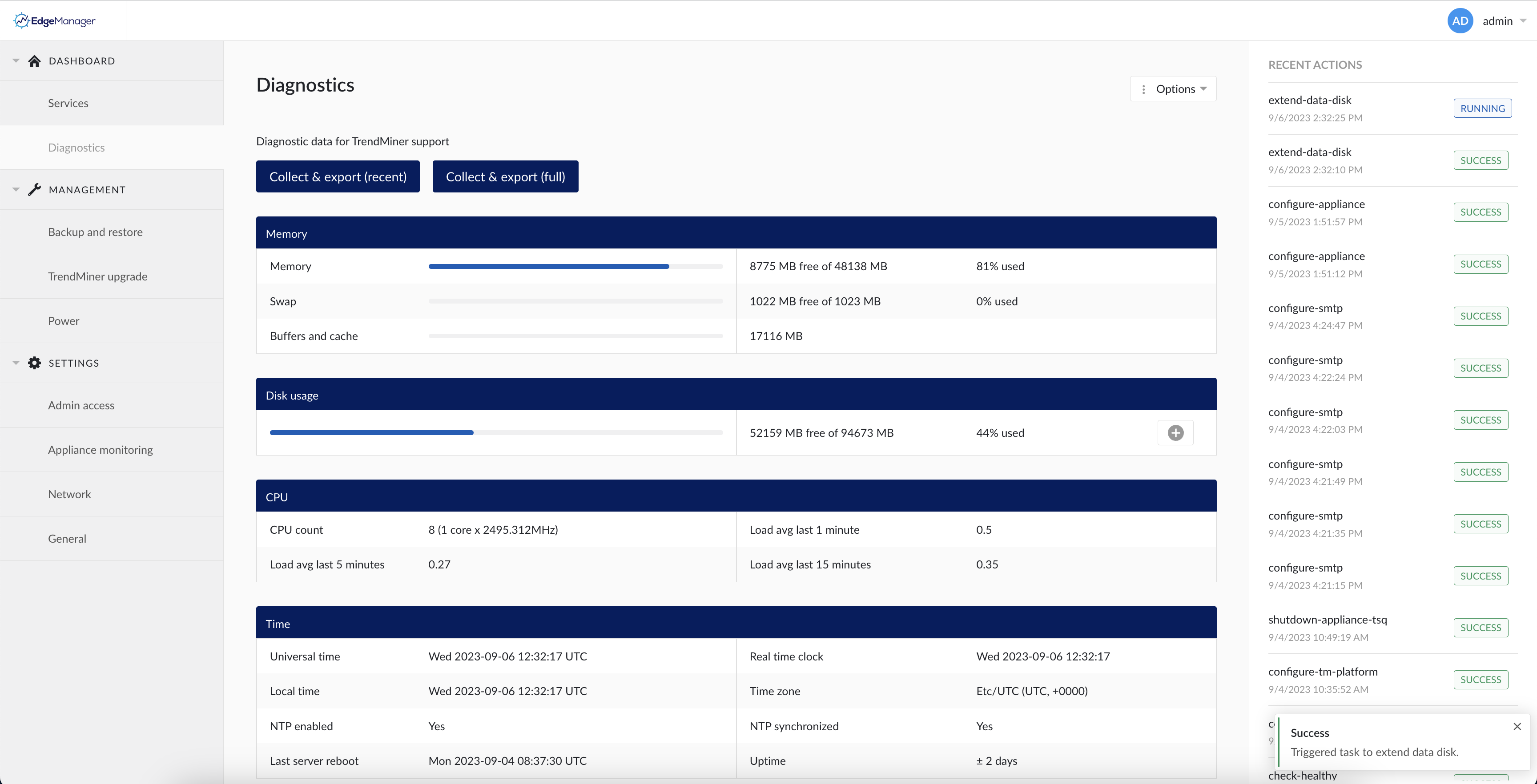

  7. A green message on the bottom right will say ‘Triggered task to extend data disk’ and a new task 'extend-data-disk' will show up in the ‘Recent Actions’ panel on the right.
    extend_disk_confirmation-2023.R3.0
  8. Wait until the ‘extend-data-disk’ status changes to ‘SUCCESS’. TrendMiner is now able to use the extra disk space.
