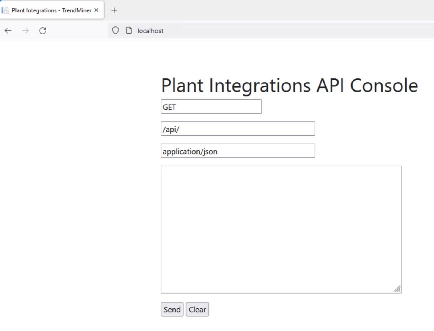

As of connector version v5 the old "Plant Integration API Console" is no longer supported and is replaced with a swagger UI which shows a complete overview of available API calls and allows more convenient usage of the connector API.

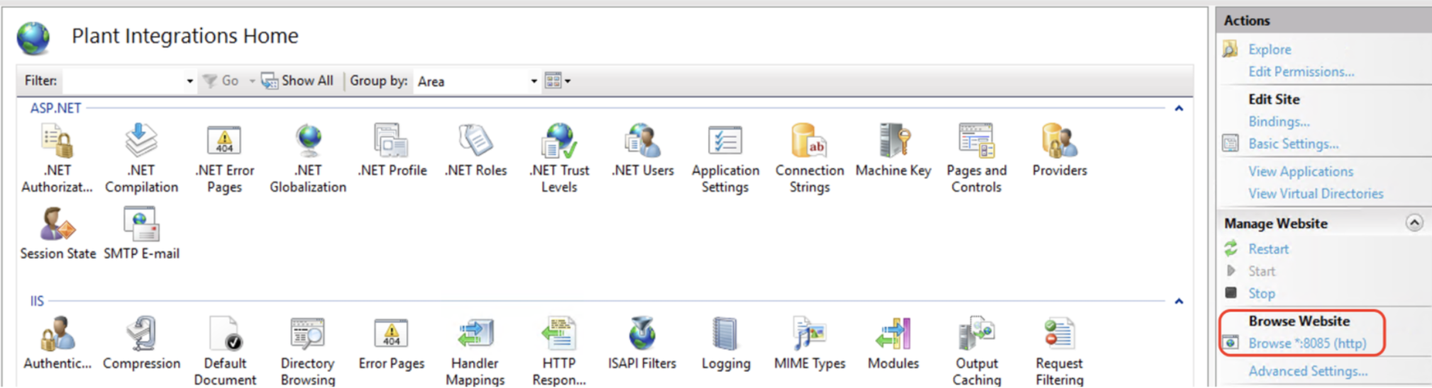

How to reach the swagger UI?
On the Windows server (the connector server), browse to http://localhost:<port> or just http://localhost in case the connector is running on default port 80.
