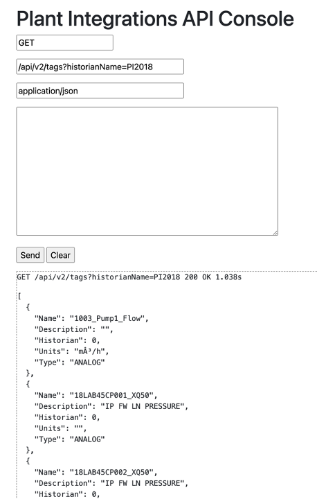

When you have the exact name of the data source, execute the following API call:
GET /api/v2/tags?historianName=<historianName>
Where <historianName> needs to be replaced with the datasource name.
This query can take a moment to execute depending on the number of tags being called, but it should return a list of all tags which will be available in TrendMiner.
With this api call we list the tag information retrieved from the historian or database. There is no set character limit for these fields, but multiple foreign characters can fill up this space and cause the datasource synchronization to fail in rare occasions. If you do notice this then please reach out to TrendMiner support.
