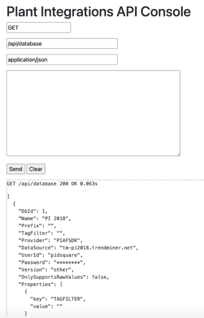

To know which data sources are configured on this connector open the connector API and execute the following API call which can be found under "Data Sources":
GET /api/database

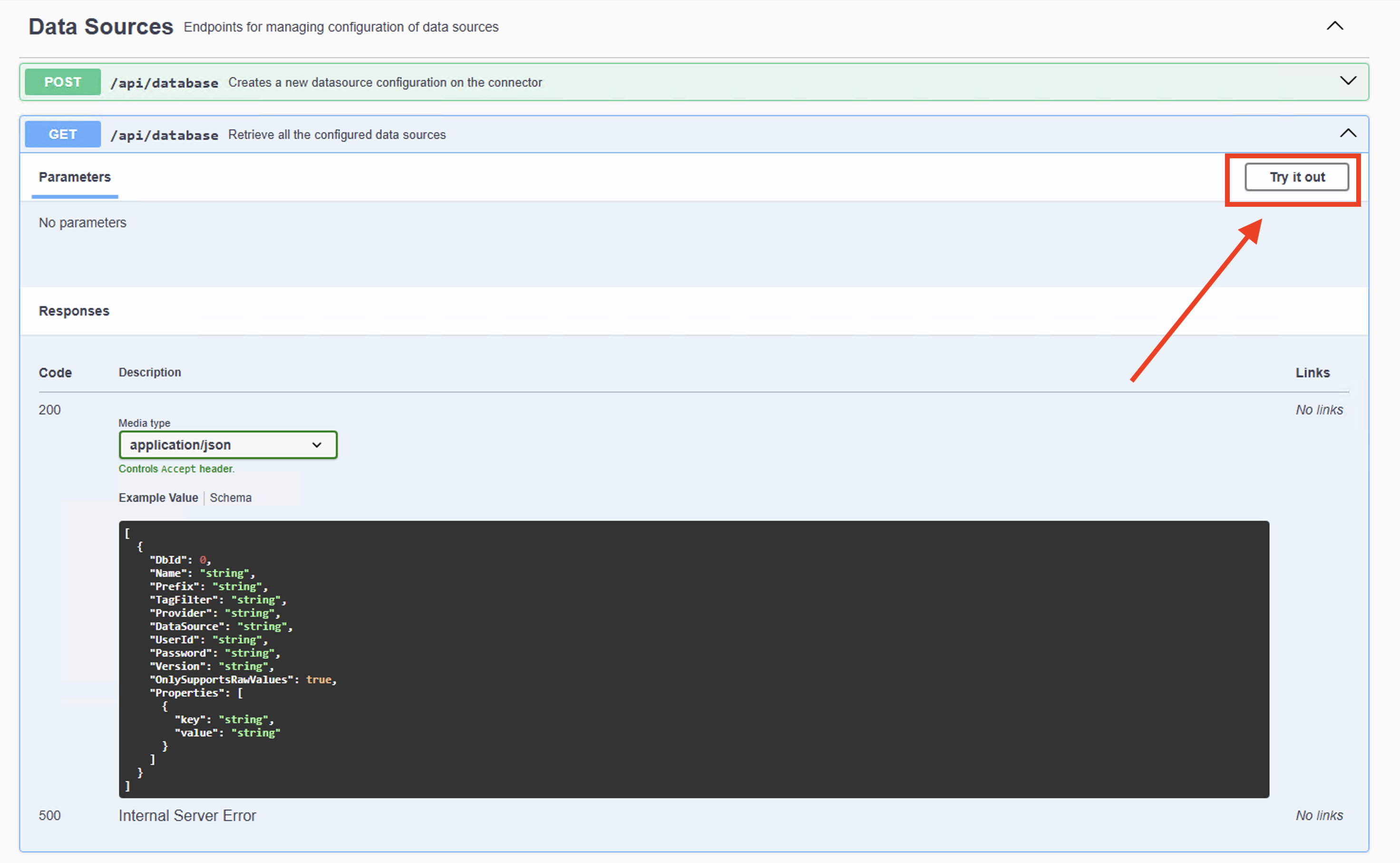

  1. Open the GET /api/database section and click on "Try it out" in the top right.

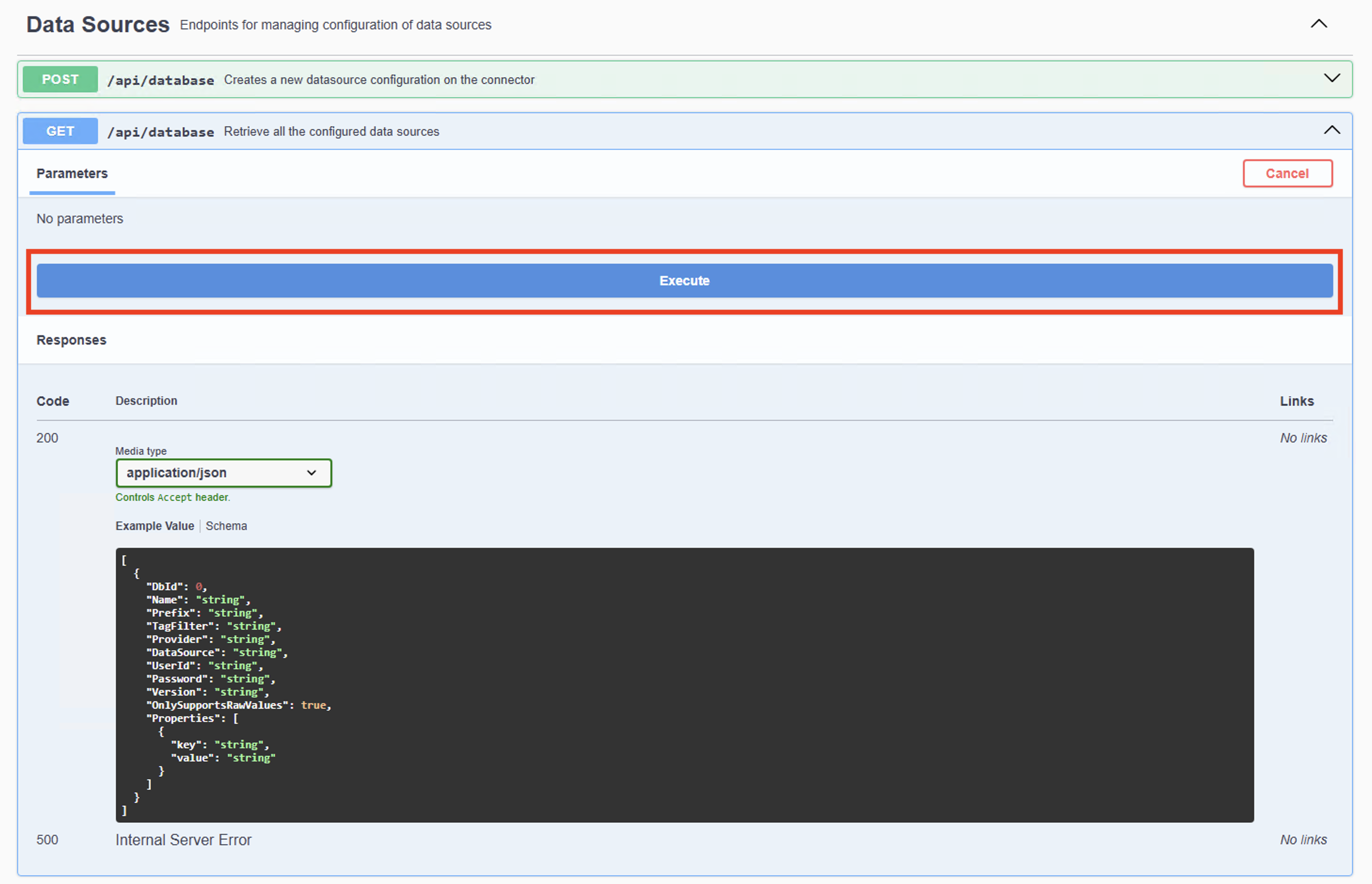

  2. Click on "Execute".

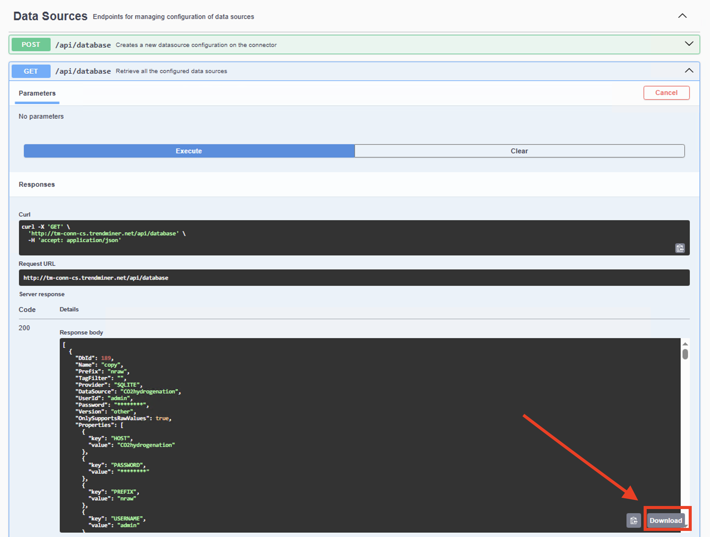

  3. The API call will be executed and the result will appear in the black box. Click "Download" to extract the result.
The result shows a list of all the data sources and their configuration details.
