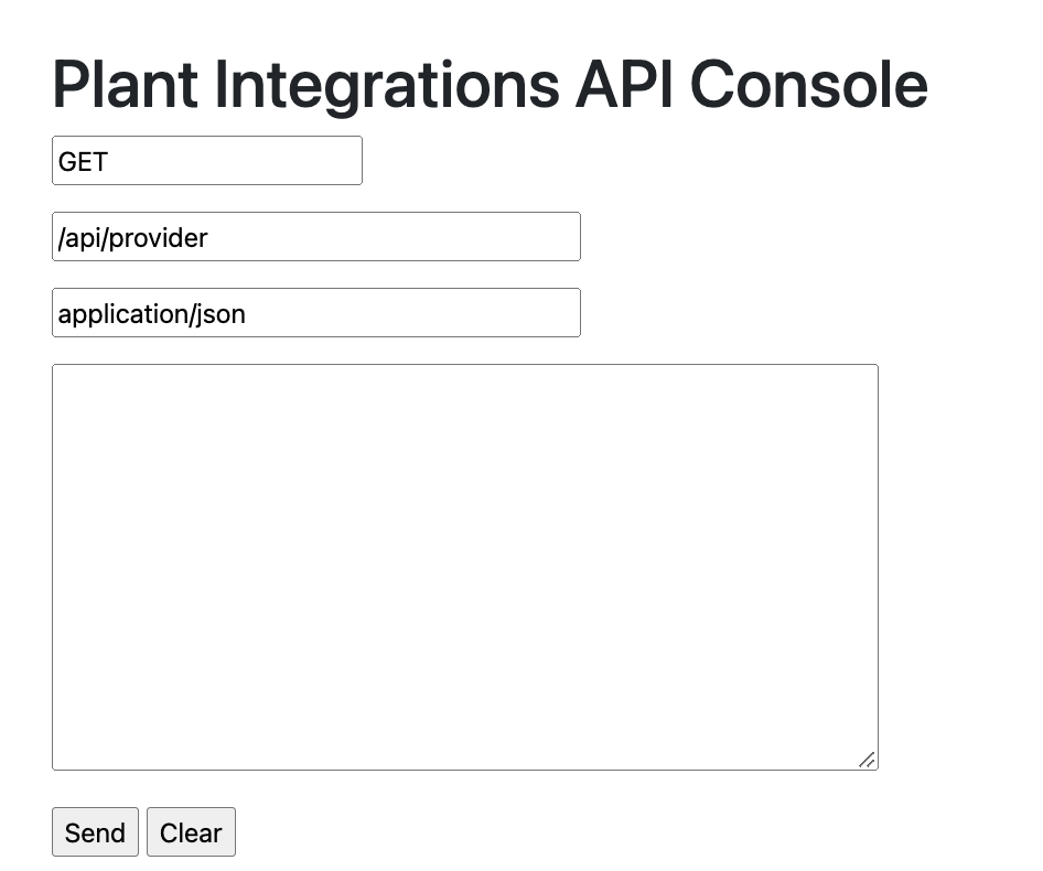

To know which providers a connector supports and what the technical name of the providers is, open the connector API and execute the following API call:
GET /api/provider

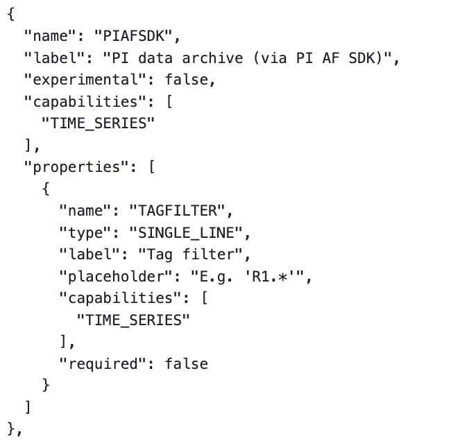

The result of this call contains a list of providers with their dynamic properties. The properties are parameters which will be shown in ConfigHub and which allow the admin to configure the data source connection.
