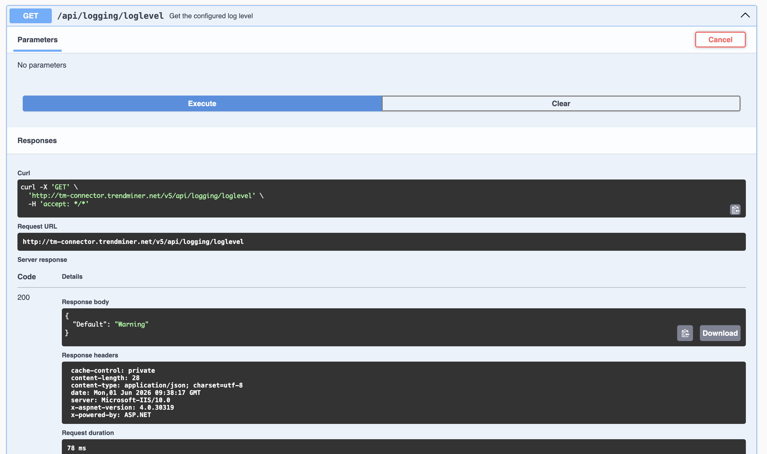

To retrieve the currently configured log level, do a GET on the connector API (via Swagger) at the /api/logging/loglevel endpoint. No parameters are required.

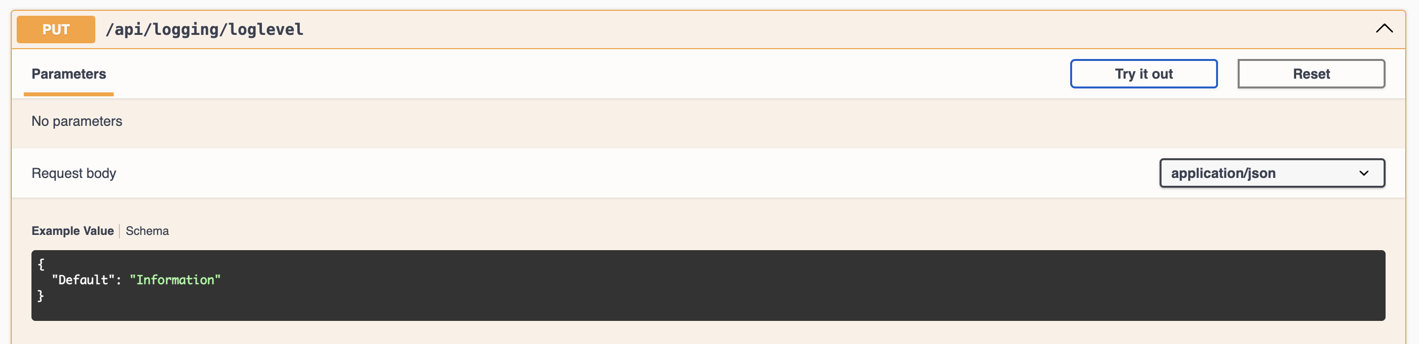

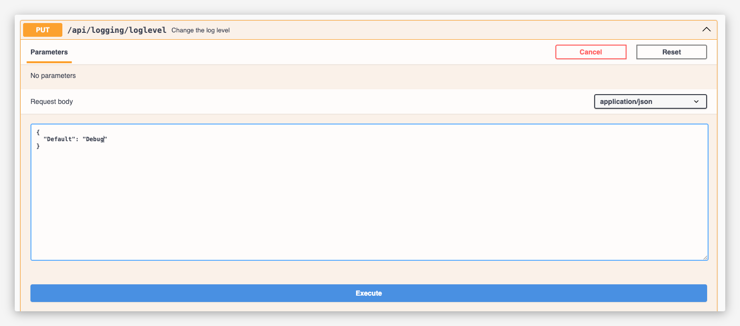

Changing the log level can be done by doing a PUT on the connector API (via Swagger) at the /api/logging/loglevel endpoint.
By default, the log level is set to Warning.
