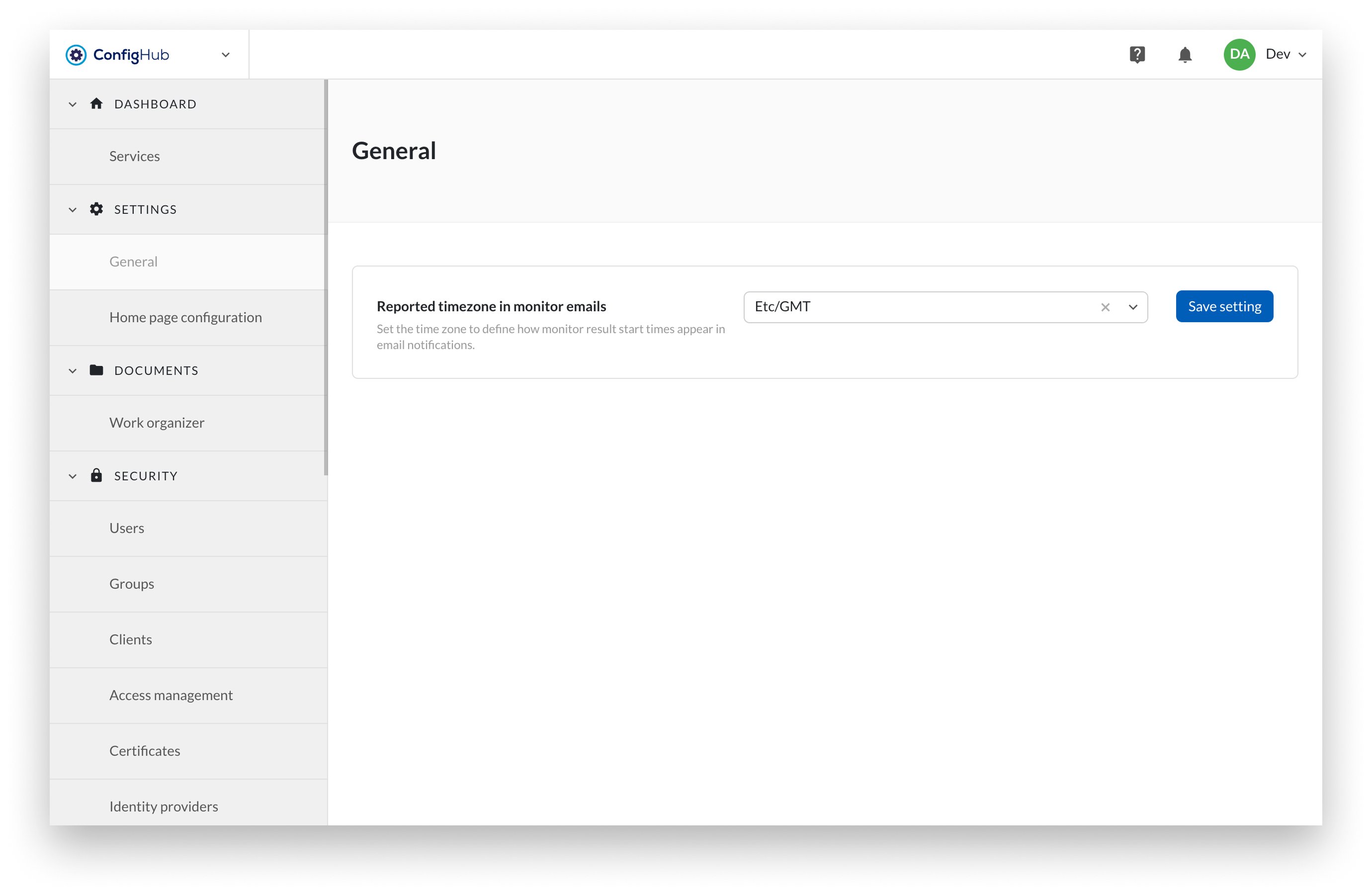

Settings
General
Configure the Reported timezone that is used in TrendMiner monitoring emails (monitor results). Only 1 timezone can be configured per TrendMiner installation.

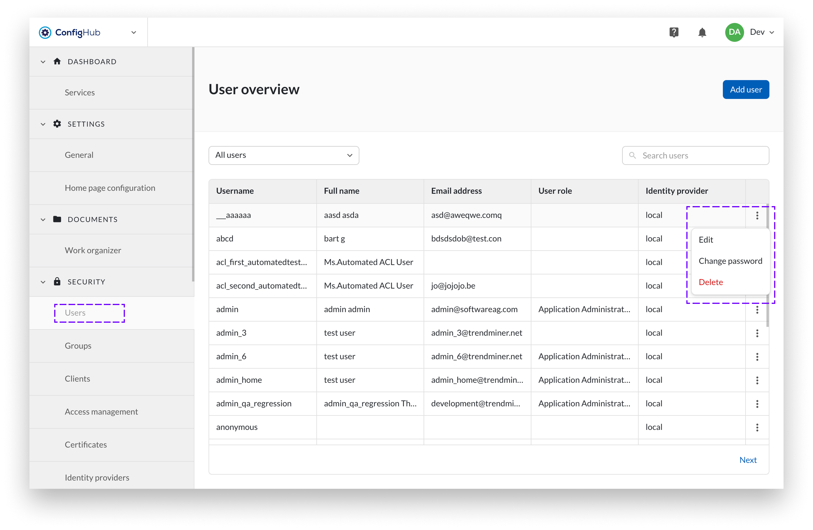

Users
TrendMiner users can either exist locally or via an external Identity Provider. An overview of all users can be found under the "Security" section in ConfigHub.
The user overview displays the username, full name, email address, and identity provider for each user. To find specific users, you can use the search bar. There is also a User Role dropdown filter for narrowing down the list based on roles. It is important to note that you cannot use the search bar and the dropdown filter at the same time.
Creating users
You can review a list of user roles to each specific user using the “User role” column in the table.
Usernames need to be unique and cannot be changed afterwards.
User details
From the user overview a user can be clicked to open the user details. In the user details view more options can be performed such as:
  • Change password (local users only)
  • Delete the user account (local users only).

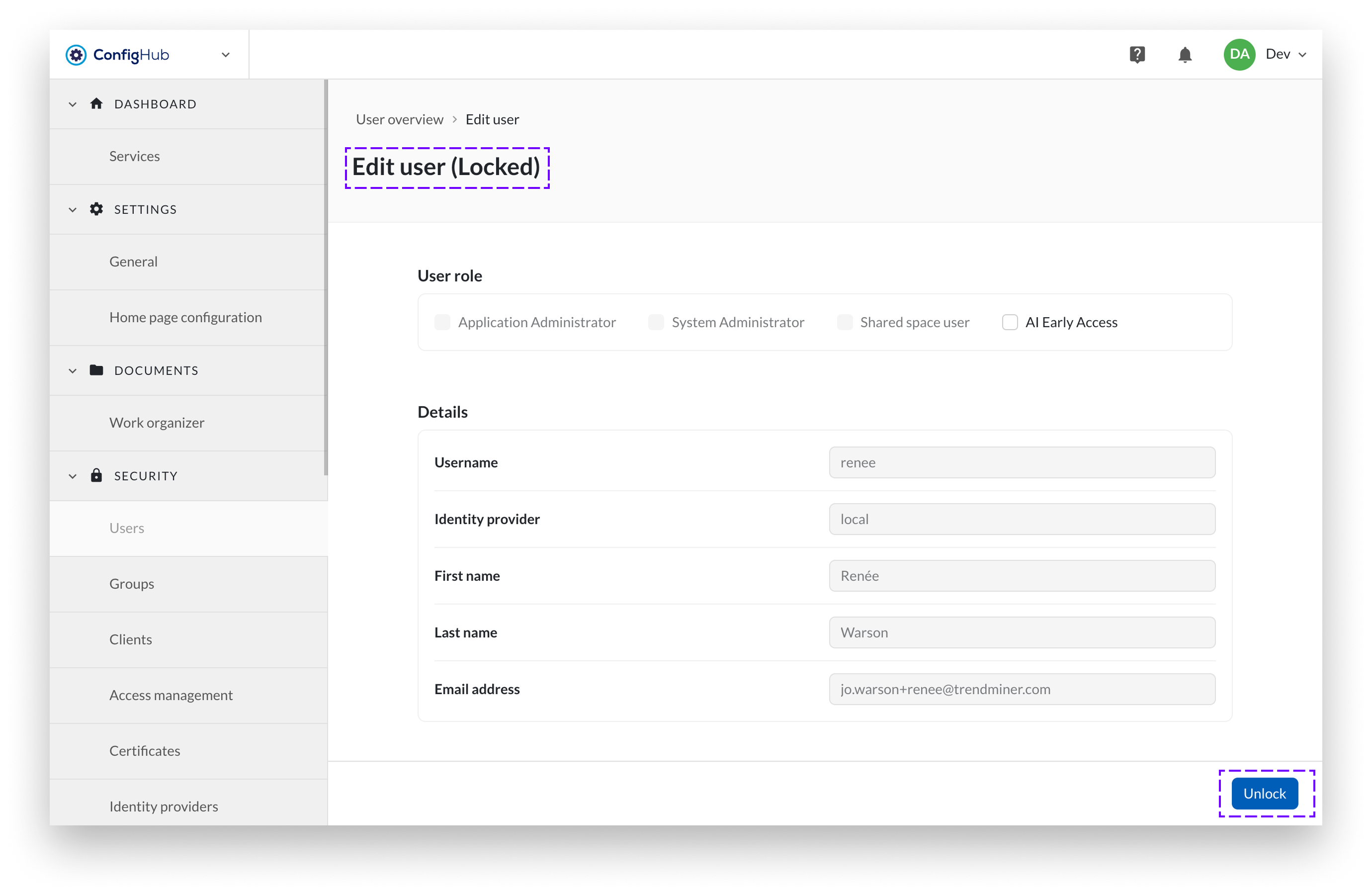

Unlock user account
A user account is automatically temporarily locked after 10 login attempts using the wrong password (both for local accounts as for LDAP accounts). The user itself will not be able to see the difference between entering a wrong password or the access being denied because of a locked account. In both cases a generic error message is shown on the login page: "Invalid username, password or locked account". This is by design for security reasons.
Only users with the system administrator role can access ConfigHub and look up the user account to check if the account is indeed locked. A locked account can be recognized as follows:
  • The word "Locked" behind the username
  • An "Unlock" button at the bottom right
  • No option to edit the user details or change the password as long as the account is locked
To unlock a user account:
  • Click the "Unlock" button
  • All locked accounts get automatically unlocked when the tm-keycloak security service gets restarted.
  • Accounts get automatically unlocked after 1 hour. This lock time increases exponentially with the number of failed login attempts (the more failed logins, the longer the accounts remains locked).
Delete a user account
In the users overview action dropdown there is the option to delete a user account. This option is only available for local users. User accounts managed by an external identity provider cannot be deleted in TrendMiner. Instead these accounts need to be revoked TrendMiner permission on the IDP side, or they can be deleted on the IDP side. Note that revoking access or deleting a user in the external IDP will not delete the TrendMiner user account.
The saved work of a deleted user will not be deleted and will remain available for other colleagues with whom the work was shared before the account deletion. Monitors owned by the user will be disabled.
The deletion of a user account cannot be undone and the username cannot be reused afterwards for the creation of a new user.

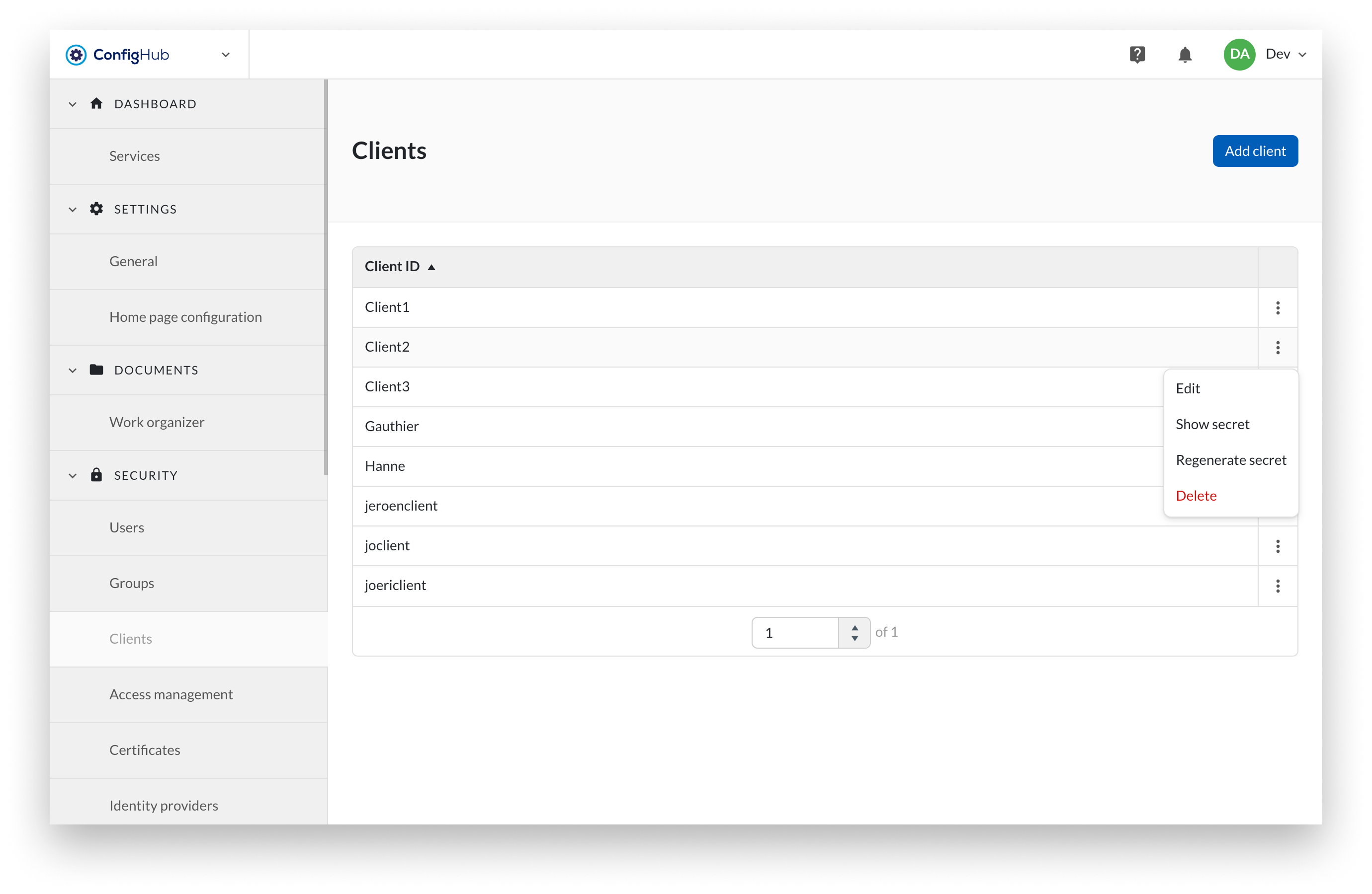

Creating Clients
TrendMiner allows the creation of a client and secret in order to generate a token to be used in external API calls.
To create a new client you will need to go to the clients-menu under the "security" section. From there clients can be created via the "+add client"-button.
You will be asked to enter a name (client ID) for your client which will be used for external references. Once the client is created you can select an action from the actions dropdown to:
  • Edit the client ID
  • Show the secret of the client
  • Generate a new secret
  • Delete the client
Regenerating a secret will invalidate your old secret and tokens. This action cannot be undone.

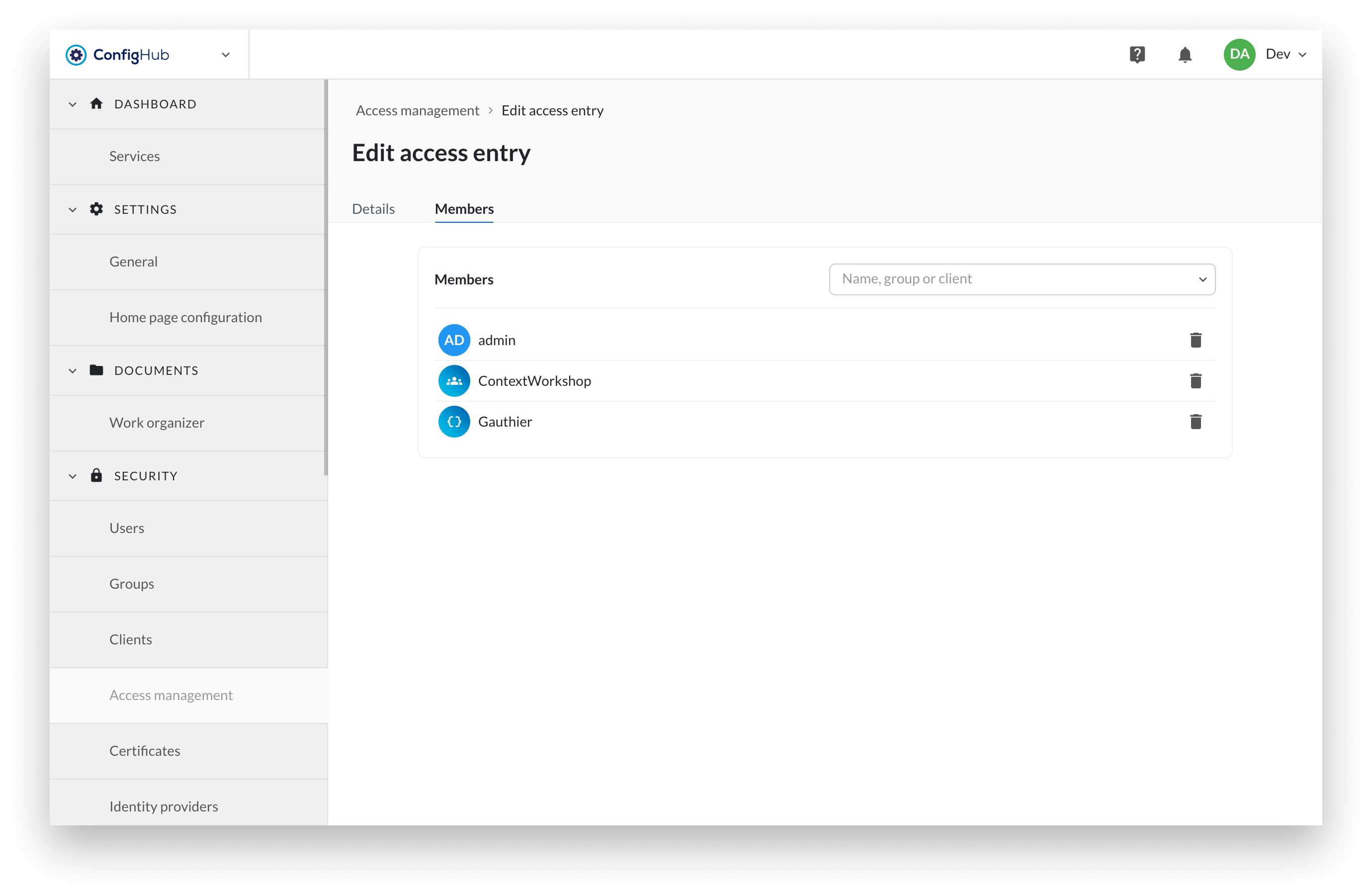

Access Management
Only access for time series data sources and expert functionality (notebooks and custom calculations) is managed in ConfigHub.
Permissions on assets and context data is managed in ContextHub. Consult the user documentation for more information on context and asset permissions.
  • Domain:
    • "DATASOURCE": for time series data source access permissions
    • "TIMESERIES_BUILDER": for notebooks and custom calculations access permissions
  • Entity:
    • Using the DATASOURCE domain: Enter the name of the data source, as configured in ConfigHub -> Data sources or use "ALL" to indicate the collection of all data sources.
      Notice
      Only alphanumerical characters and '-' or '_' are allowed in data source access permissions. In case you have a data source name using special characters, please rename the data source before assigning an access permission to it.
    • Using TIMESERIES_BUILDER domain, add one or more of the following "Entity" values:
      • NOTEBOOK: access to MLHub
      • CUSTOM_CALCULATIONS: access to the custom calculations in the TrendHub tag builder.
      Notice
      In the TIMESERIES_BUILDER domain, entity "ALL" is not supported. Each entity must be added individually.
  • Members: Users, groups or clients you want to grant access permission for the domain
No subgroup inheritance
The system only checks if a user is directly in the user group assigned the permission. It does not consider membership in subgroups of that user group (subgroups do not inherit permissions from the parent group).

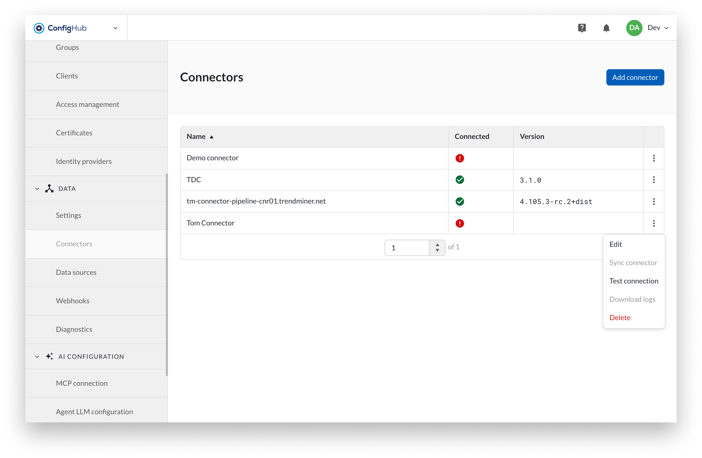

Connectors
Add a new connector by clicking the (+ Add connector) label next to the title and fill connector details in the corresponding fields:
  • Name: free to choose name. The only restriction is that each connector name should be unique.
  • Host: hostname of the connector.
  • Username and Password: should only be filled in when they are configured on the connector installation.
As soon as a new connector is successfully added, it will start syncing all the data sources which are configured to the connector.
If the connector cannot be synced, it will show a red exclamation mark in the connector list. To learn more about the cause of the failure, open the connector details  side panel by clicking on the connector name. The error feedback will be shown under 'Last sync'.
For successfully connected connectors the 'Last sync' field in the connector details will show the last sync date and time and status ''Successful". The last sync date and time will be updated when a manual sync is triggered or when TrendMiner synchronises the tag cache for that connector, typically during a nightly tag cache refresh.
A green checkmark in the connector list indicates that TrendMiner is connected successfully to the connector, but it does not indicate if there are syncing issues between the connector and the data source. The health status for connected data sources should be consulted in the 'Data sources' menu. Also note that the status will not automatically update after the page is loaded. Refresh the page or choose the 'Test connection' option to update the connection status of a connector.
The version of each connector is listed in the Connectors overview table. This information is important in case a newer connector version supports new features or improvements for a specific data source.
To edit the details of a connector click on it to open the details page.
Changing the name of the connector will not affect the tags from the connected data sources but changing the host, username or password to an incorrect value will render the tags from the connected data sources inaccessible.
Other available options are:
  • Sync connector: this will trigger a manual (re-)sync of all data sources which are configured on this connector. Choose this option to update all tags from all connected data sources at once.
  • Test connection: this option will test the connection to the connector without triggering a sync and will update the health status of the connector.
  • Delete: this option will remove the connector from the configuration and remove all data sources which are using this connector, until the data sources are reconnected via a correctly configured connector.

  1. Install a connector.  If your connector is already connected, this step can be skipped.
    1. In ConfigHub select the tab "Connectors".
    2. Click "+ Add connector" and fill in the details of the connector.
