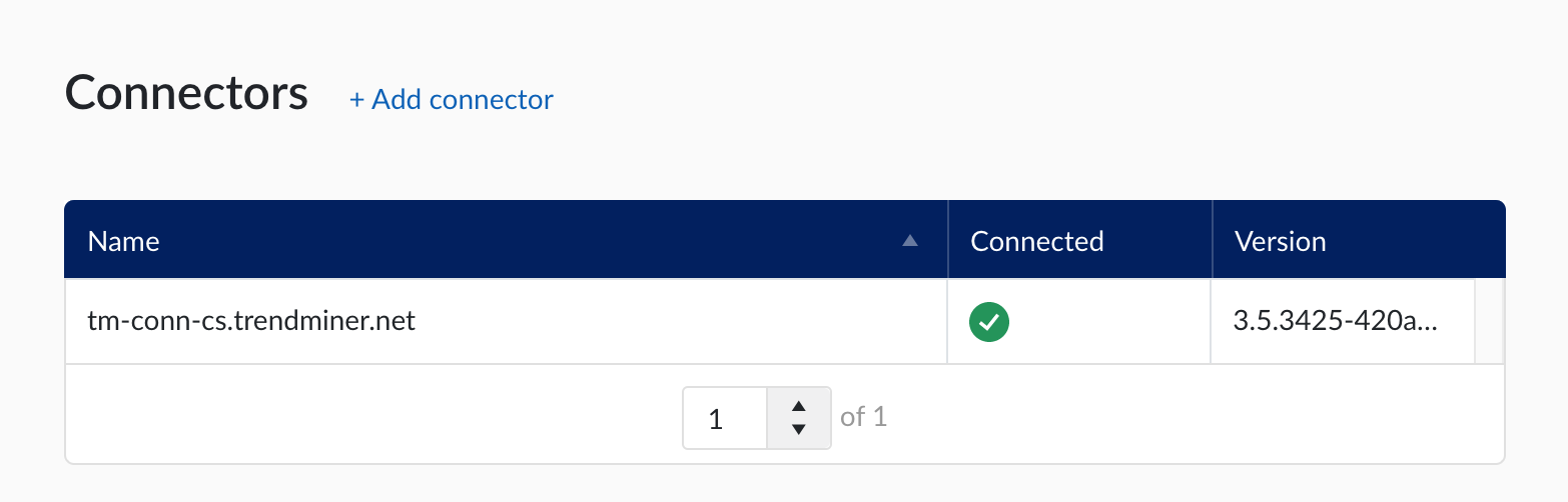

If your connector is added successfully, the version will be shown in ConfigHub and you are ready for the next step.

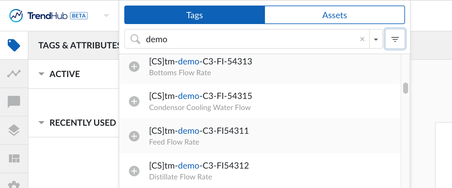

Once the right permissions are assigned, log in to TrendHub and you should be able to search your tag names and descriptions in the tag browser. If this looks ok, you're ready for the next step.

When this endpoint is implemented, the tags can be indexed in TrendMiner. Tag indexing will start as soon as the tag is added to the active tag list. If the tag was already added before the tag indexing status might be on 'failed' and you might need to manually trigger re-indexing.
Once the tag is indexed it can be visualized on the chart and it can be used in analyses.
