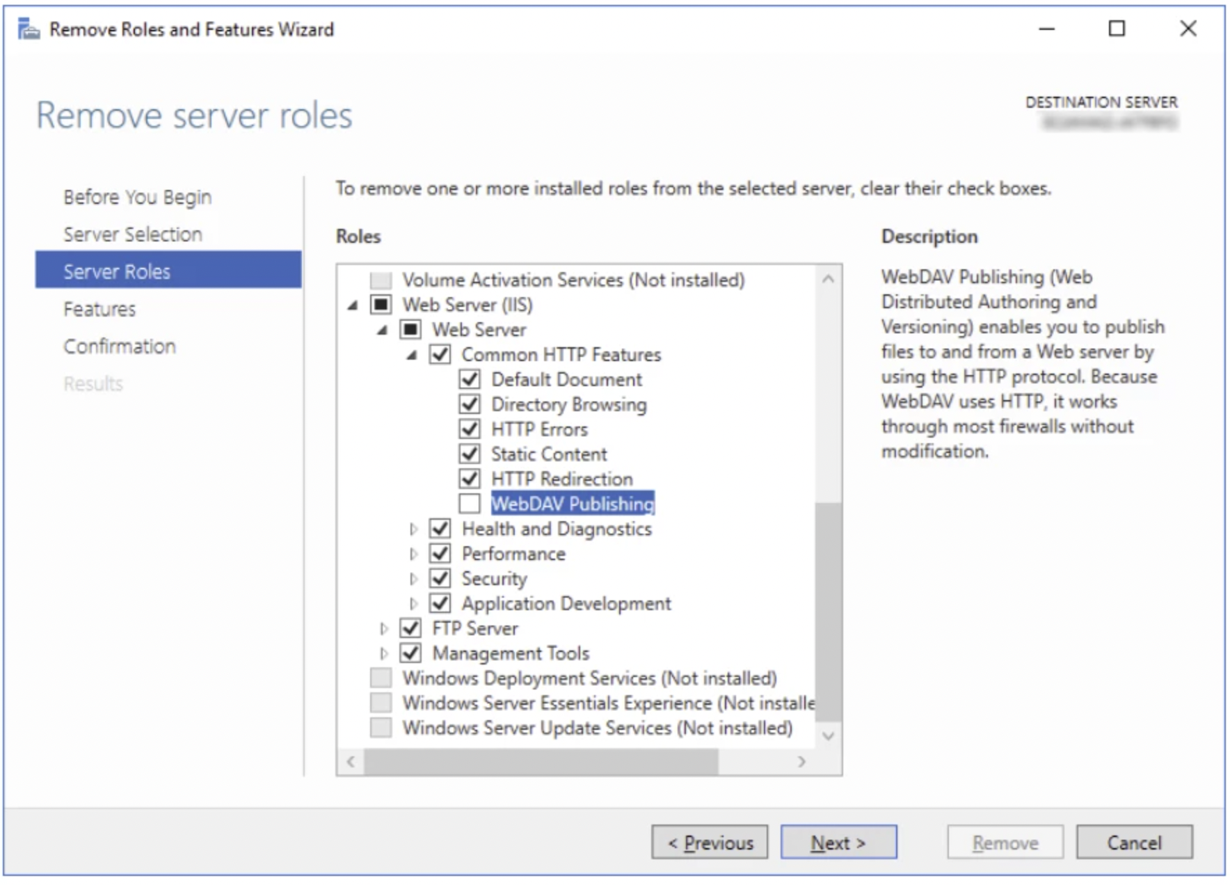

Probable reasons:
  • wrong configuration in IIS: check if the correct .net version is installed
  • WebDAV should not be enabled:
More details and information about the required IIS configuration can be found in Prerequisites to install Plant Integrations connector
