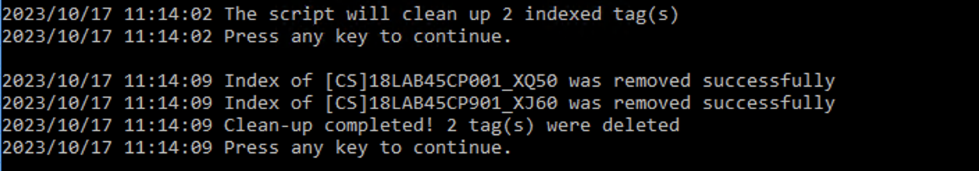

    When the script runs it will first show feedback on how many indexes will be deleted. Press ENTER to proceed and clean these indexes.
    Clean index script output 2023.R3.0
