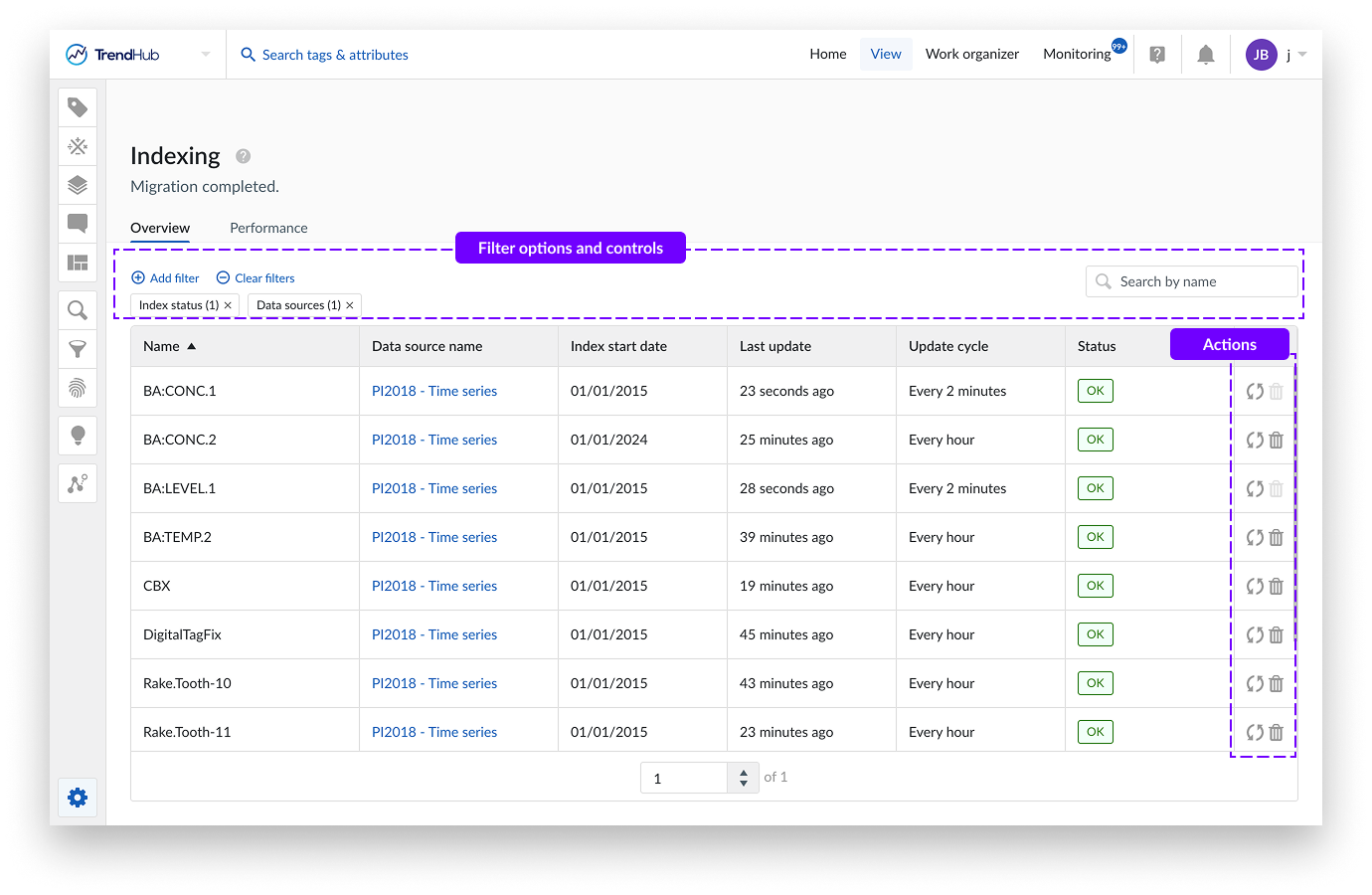

The Index Manager is divided into two main tabs, each serving a specific purpose:
The Index Overview tab offers a comprehensive summary of all tags indexed within the TrendMiner system. For each tag, the following details are provided:
  • Datasource name: This column indicates the name of the datasource linked to each tag, assisting administrators in pinpointing the data's origin. Tags created within TrendMiner are marked with an Internal label.
  • Index start date: The point in time up until we have indexed tag data. For tags that have been successfully indexed, this date should align with the configured horizon.
  • End of data: Date of the last known index point in the TrendMiner index storage. This date is updated when new data points are added to the index.
  • Last update: The latest attempt by TrendMiner to update the index, whether successful or not.
  • Update cycle: This column outlines the update frequency for each tag, indicating how often the datasource is checked for new data.
  • Status: An indication of the overall health of the tag (refer to the table below).
For a healthy system, the Last update period should be within or close to the specified update cycle. The Last update value shows when TrendMiner last attempted to update the index. The End of Data value, however, updates only if a new data point was received during this attempt.
For each tag, the following actions can be performed:
  • Refresh index: This action deletes and recalculates the index and the index policy of the current tag. It will also automatically delete the index of any Tag Builder tags constructed on top of the refreshed tag.
    A refresh of an index can be useful in case data has been modified/corrected in the datasource itself after the initial storage. Such updates are not automatically picked up by TrendMiner.
  • Delete index: This action deletes the index of the current tag and automatically deletes the index of any Tag Builder tags constructed on top of the deleted tag. Since tags which are used in monitors are required to have an index, they can not be deleted.
    Deleting an index can be useful to free up storage or to clean up Stale tags.

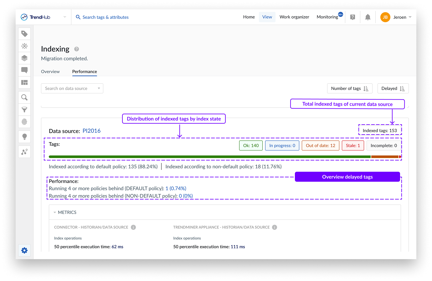

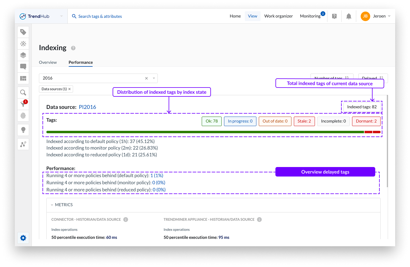

The Performance tab visualizes a card for each connected and internal time-series datasource. Each card provides the following detailed information:
  • Number of Indexed Tags: Displays the total number of tags that have been indexed for this specific datasource.
  • Number of Tags per Index State: Shows the distribution of tags across different index states.
  • Number of Tags per Index Refresh Policy: Shows the distribution of tags which should be indexed hourly or every 2 minutes.
  • Number of Delayed Tags: Indicates the number of tags that are delayed in their indexing process.
  • Dropdown with Metrics: Provides additional metrics on historian performance, offering deeper insights into the datasource's indexing efficiency. More information on how to interpret these metrics can be found here.

Diagnosing performance issues
The index manager provides a lot of information allowing the application administrator to diagnose indexing related issues. Although setups can be very different across different customers, requiring different optimizations, the current section provides some general guidance.
A healthy system should reflect the following criteria:
  • (almost) all tags in OK indexing status, or In progress
  • no delayed tags in the performance overview
In these cases, it is good practice to check to which historian these tags belong. Out of date or Incomplete states happen when TrendMiner tries to index the tag, but an error occurs when trying to fetch the data.
If a lot of tags originate from one specific historian, there might be a connection issue. In case this only happens for specific tag, there is most likely a data quality issue (for example out of order points being returned by the historian).
Delayed means the tag status is still OK but the last updated date is > 4 hours or 8 minutes (monitors)
Scenario A: historians are performing well
Since a lot of tags are delayed but the historians are performing well, it is likely we are dealing with a system where a lot of tags are indexed (>10 000) and the TrendMiner system is no longer able to append the index according to requested refresh cycle. In this situation, consider increasing the number of indexing threads, specified in ConfigHub.
Scenario B: historians are all underperforming
Alternatively, but less likely, the performance of all historians is not adequate. Do consult the historian specific metrics to identify the origin of the bottleneck, such as for example throttling due to a network bandwidth issue.
This typically points to an ill performing historian, which you can verify by evaluating the connection metrics in the datasource card.
