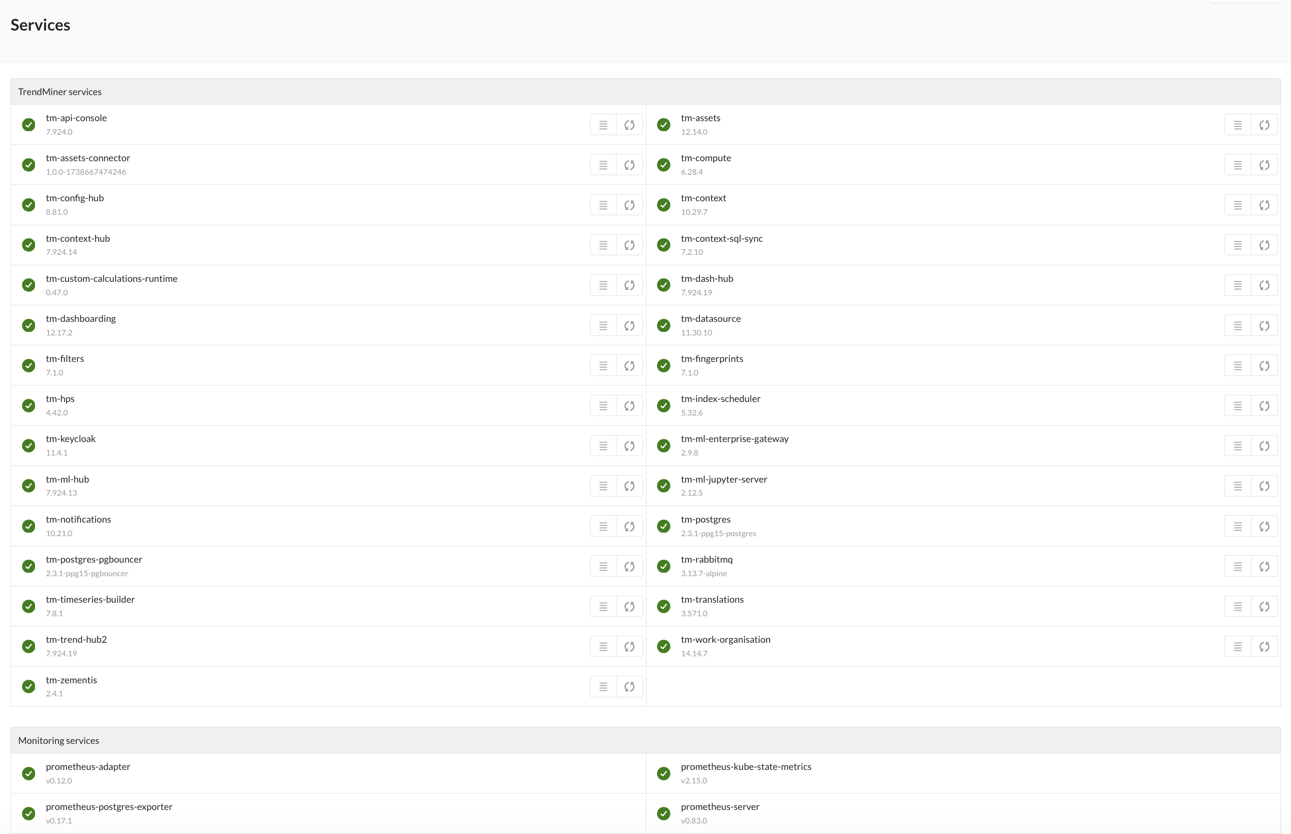

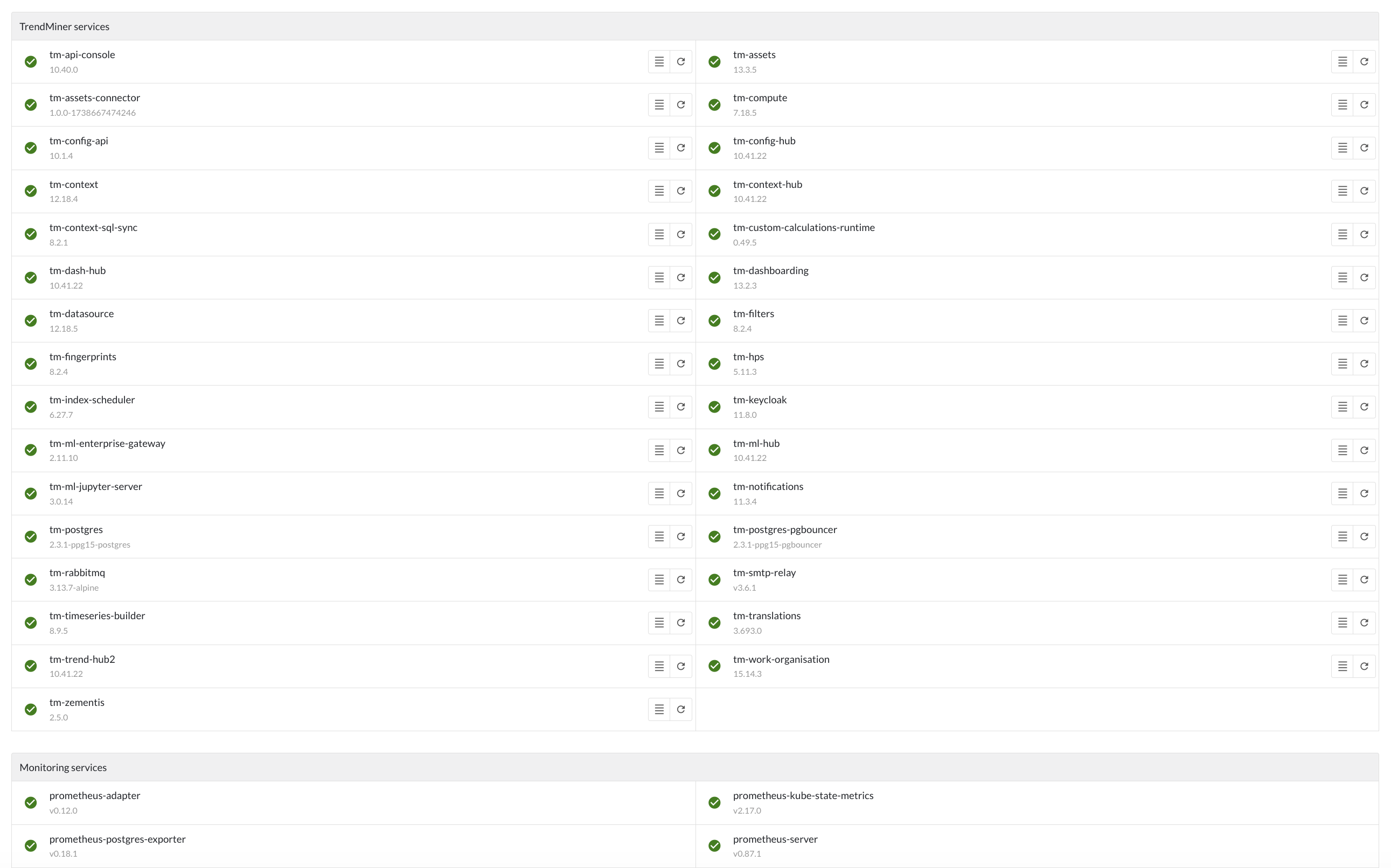

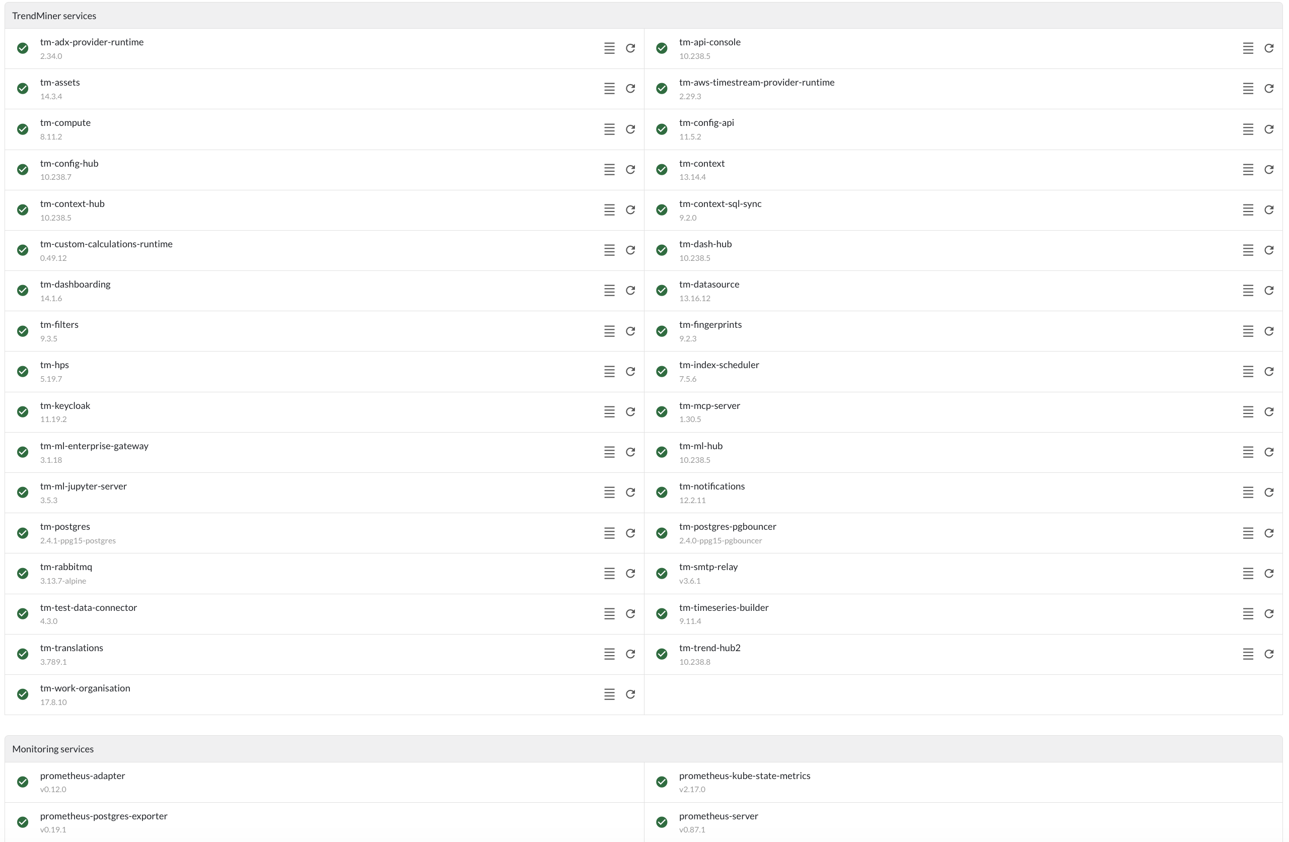

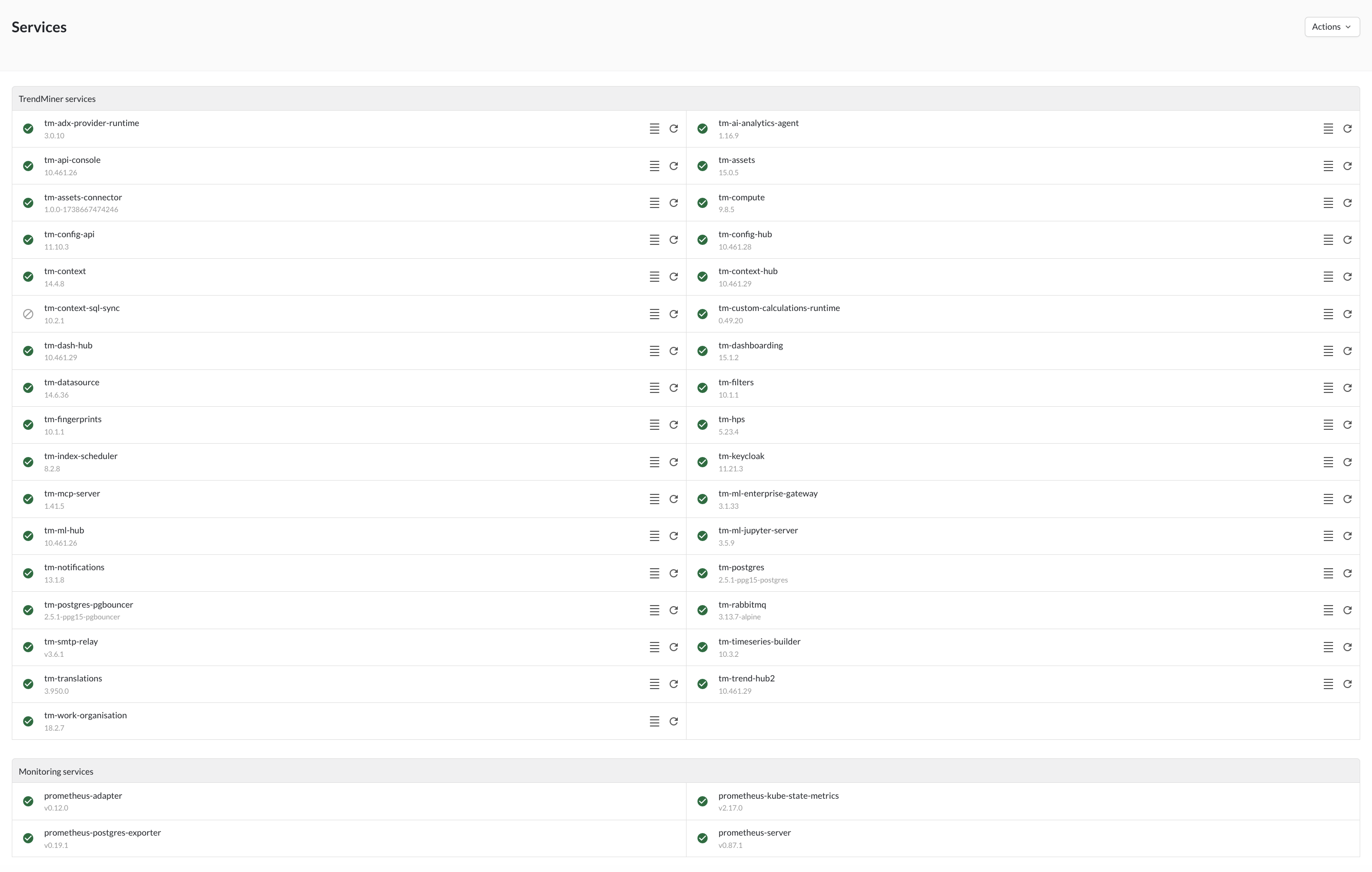

  2. Once rebooted, make sure all the services are healthy in the 'DASHBOARD' -> ‘Services’ page.
    For customers without expert license some services will be greyed out.
