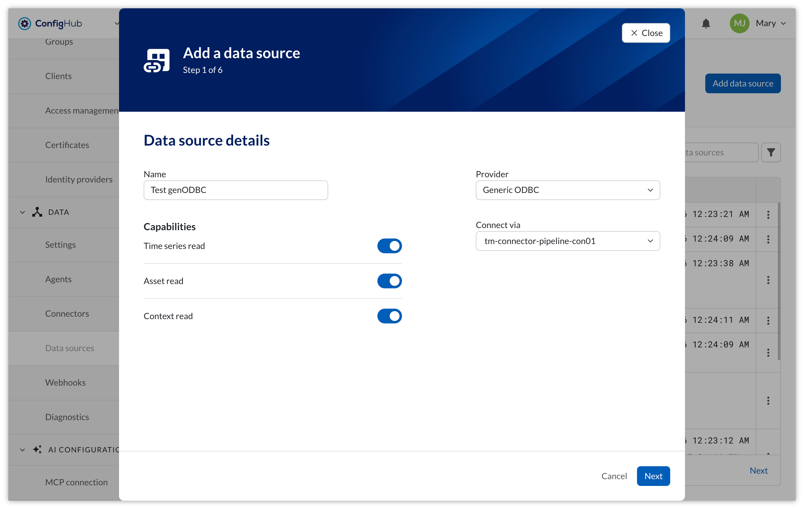

Creating a Generic ODBC data source in ConfigHub
To integrate with and ingest data from a database that supports ODBC, a data source of provider type “Generic ODBC” can be added and configured in ConfigHub.
To do so, navigate to Data > Data Sources in the left side menu. Choose the "+ Add data source" option, which will open a wizard. In the first step, choose a name and select “Generic ODBC” from the Provider dropdown.  This will add two new options to fill in:
  1. Capabilities: tick the box for each capability you intend to activate
  2. Connect via: which Plant Integrations you will use to connect to the database
Selecting the capabilities for the data source with the given checkboxes will define the additional steps in the wizard to complete, grouped in the following sections:

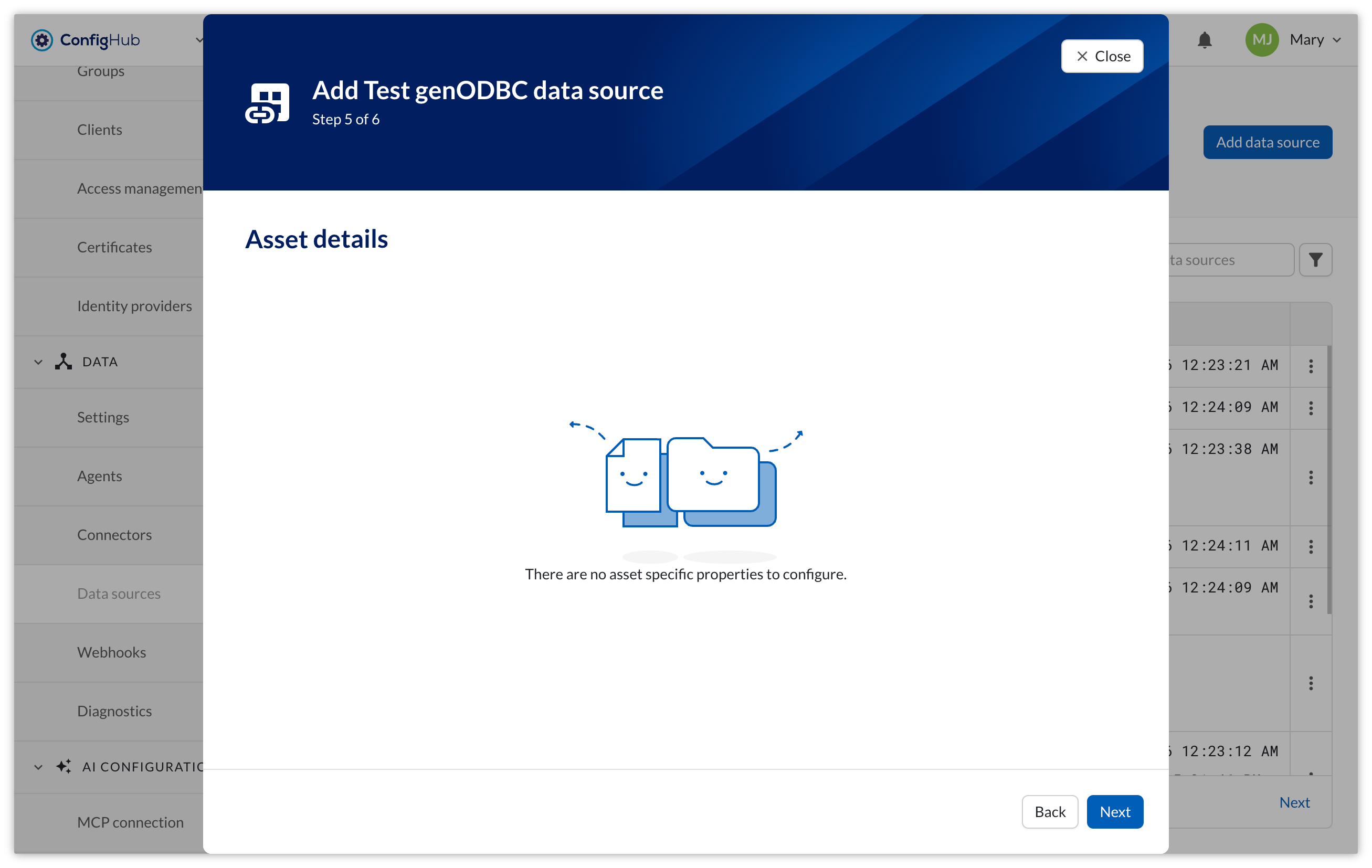

  • Asset details - configure properties and queries relevant to asset data

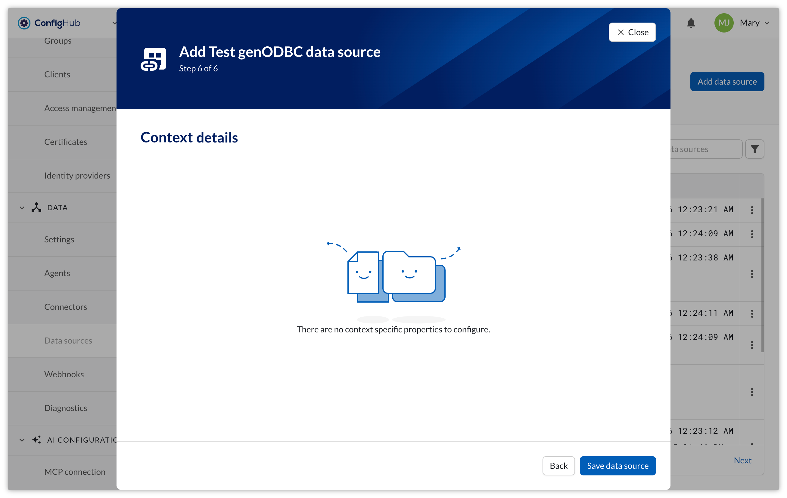

  • Context details - configure properties and queries relevant to context data
Once the connection and property steps are completed and saved, the data source is created in Draft state and the Query Designer opens automatically, where the queries listed for each enabled capability (see the tables below) are written, tested, and saved. The data source can only be activated once its required queries are filled in.

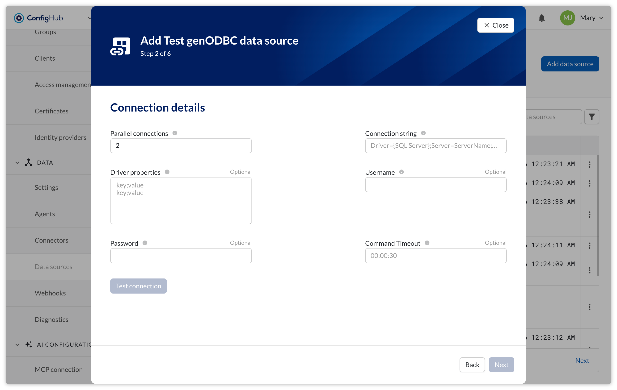

Connection details
The properties below configure how Plant Integrations connects to the underlying database.
Table 8. Connection details
Property
Required
Capability
Remarks
Connection string
yes
Time series
Asset
Context
Connection string used to connect to the underlying data source. When the same keywords are used in the connection string and the driver properties, the values from the driver properties are overwritten by the values from the connection string.
Same logic applies for credentials: Username (UID) and passwords (PWD) from driver properties are overwritten by username and password from connection string and theses are overwritten by the username and password provider properties.
Notice
Advanced: When the Odbc driver does not support the UID or PWD keywords, but use Username and Password instead, you can specify these as dummy keywords in the driver properties and those will then be overwritten by the username and password provider properties specified in ConfigHub.
Driver properties
no
Time series
Asset
Context
Driver properties are used as an additional way to add keywords and their values to the connection string. Driver properties are seen as more general properties and will be overwritten by values specified in the connection string.
Username
no
Time series
Asset
Context
A convenience field to enter the username used to establish a connection to the database. This information can also be specified in the connection string and driver properties.
Password
no
Time series
Asset
Context
A convenience field to enter the password used to establish a connection to the database. This information can also be specified in the connection string and driver properties.
Warning
Driver properties and Connection string are not encrypted, password however is encrypted.
Parallel connections
yes
Time series
Each data source has 2 queues: one interactive - plot calls, one non-interactive - index calls, batch calls etc. Parallel connections determine how many connections each queue has to the connector. By default there are 2 parallel connections to the connector.
Command Timeout
no
Time series
Asset
Context
Predefined time limit in which a command needs to be executed before terminating and generating a error.
By default the interval is 30 seconds. A custom time can be set using the format “hh:mm:ss“ (hours, minutes, seconds). E.g. “00:01:30“.
Not all data sources support command timeout

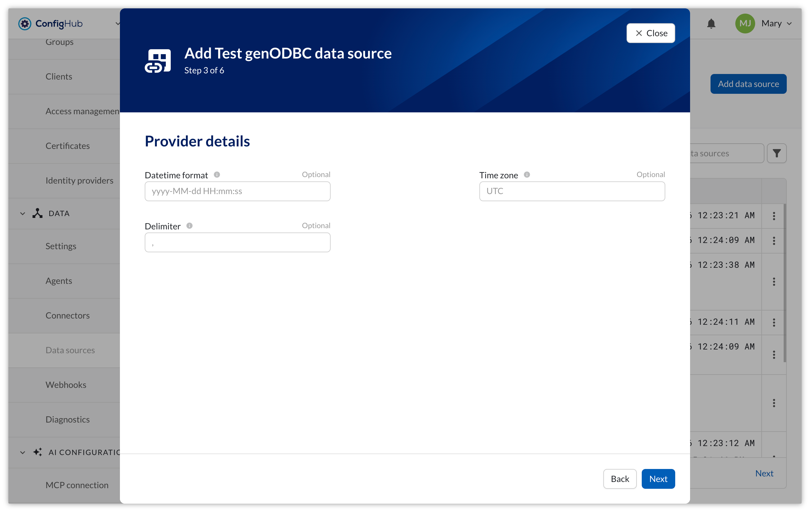

Provider properties
The properties below are shared across capabilities and configure how time series, asset and context data is interpreted - datetime format, timezone, and the delimiter used for multi-value fields.
Table 9. Provider (shared) details
Property
Required
Capability
Remarks
Datetime format
no
Time series
Context
An optional format your time series data is stored in.
Daylight Saving and Local timestamps
When the datetimes are stored as a date time in your local time zone, you SHOULD include the offset (which changes during daylight saving transitions) in the string representation of the timestamp, specify the DateTimeFormat as yyyy-MM-dd HH:mm:ss zzz and set the Timezone to your local time zone. This will insure that the daylight savings transition rules are respected, and that your datetimes will be parsed correctly.
There will be a validation error shown when you specify a DateTimeFormat without the offset specifier (zzz) and a Timezone other than UTC.
ISO8601
If the source system expects/returns the datetime values as ISO8601 UTC, you should use yyyy-MM-ddTHH:mm:ss'Z'as DateTimeFormat and UTC as Timezone.
e.g.2024-01-01T08:00:00Z
Timezone
no
Time series
Context
An optional timezone your time series data is stored in. Default is UTC.
The list of supported values are defined by the operating system of Plant Integrations. To get this list you can use the following command:
Notice
The second line for each time zone is the identifier that can be used, e.g. “Pacific Standard Time“
Delimiter
no
Asset
Context
Delimiter used to separate a multi string column/ field in the provider. The default is comma (,)
Asset Capability
  • To parse data values of type STRING_ARRAY.

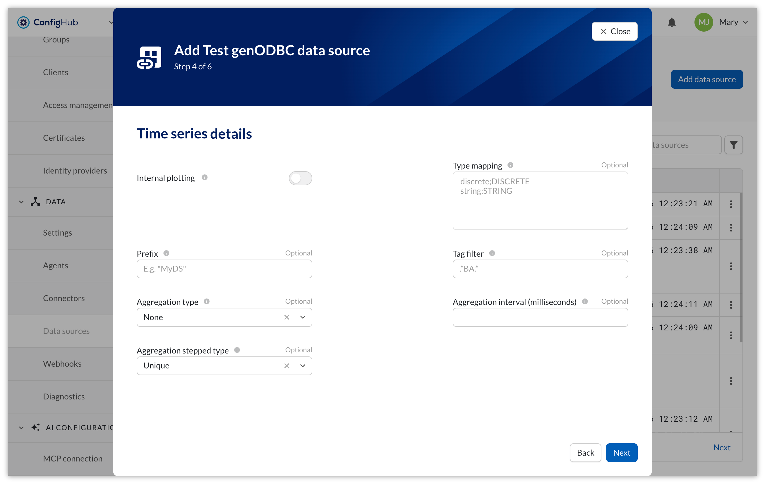

Time series details
The properties below configure the Time series capability. Most - Type mapping, Prefix, Tag filter, Internal plotting, and the aggregation settings - are configured directly in this step. The Tag list query, Index query, Plot query, and Digital states query are written and tested separately, in the Query Designer - see Query Designer for how the editor, template variables, and run/preview behavior work. The table below documents the columns and variables each query must use.
Caution
Because the id of the tag is missing from the contract between tm-datasource and tm-plant-integrations. The name column is used for {ID} variable.
Table 10. Time series capability properties and queries
Property/Query
Required

Tag list query
yes
A query used by TrendMiner to create tags. A query needs to be provided that will, given your database schema and tables.
Example:
Columns:
  • id (string)
    • Unique identifier for each row returned by the query, like a primary key in a database table
    • Mandatory
  • name  (string)
    • Name of the tag
    • Mandatory
  • type (string)
    • Type of a tag. Without additional mapping, type must be one of the following tag types:
      • ANALOG
      • DIGITAL
      • DISCRETE
      • STRING
    • Optional, if the column is not in the query, the default type ANALOG is used
    • Custom types can be returned here but then a type mapping must be added as well.
  • description (string)
    • Description of a tag
    • Optional, can be empty or null value
  • units (string)
    • Unit of measurement for the tag
Index query
yes
A query used by TrendMiner to ingest time series data for a specific tag. The query is expected to return a ts (timestamp), value and optionally an offset.
The results should be sorted ascending on timestamp, if not they will be sorted by the provider.
Variables:
  • {ID} (string)
    • The name is returned by the tag list query
  • {STARTDATE} (string)
    • TrendMiner will ingest data per intervals of time. This demotes the start of such an interval.
    • Value is formatted (string) using the format specified in the DateTime format provider property.
  • {STARTDATE:ToDateTime} (DateTime)
    • Value as DateTime data type
  • {STARTDATE:ToOffset} (string)
    • Offset of the start date as a string, e.g. “+01:00“
  • {STARTDATE:ToOffsetInMinutes} (numeric)
    • Offset of the start date specified in minutes, e.g. 60
  • {STARTDATE:ToUnixTimeSeconds} (numeric)
    • Start date specified as unix epoch milliseconds
  • {ENDDATE} (string)
    • TrendMiner will ingest data per intervals of time. This demotes the end of such an interval.
  • {ENDDATE:ToDateTime} (DateTime)
  • {ENDDATE:ToOffset} (string)
  • {ENDDATE:ToOffsetInMinutes} (numeric)
  • {ENDDATE:ToUnixTimeSeconds} (numeric)
    • End date specified as unix epoch milliseconds
  • {INTERPOLATION}  (string)
    • Interpolation type of a tag, which can be on of two values:
      • LINEAR
      • STEPPED
  • {NUMBEROFINTERVALS} (numeric)
    • Number of intervals to return. It can be used to optimize a query to return the expected number of points.
  • {INDEXRESOLUTION} (numeric)
    • Index resolution in seconds. It can be used to optimize a query to return the expected number of points.
Example:
select ts, value from source where id={ID} and ts>={STARTDATE} and ts<={ENDDATE} order by ts asc
or
select ts, value, offset from source where id={ID} and ts>={STARTDATE} and ts<={ENDDATE} and offset>={STARTDATE:ToOffsetInMinutes} and offset<={EndDate:ToOffsetInMinutes} order by ts asc
Columns:
  • ts (DateTime2 | long | string)
    • Timestamp of the value
    • Supported types:
      • string: parsed using the format specified in the DateTime format provider property.
      • long: unix epoch in milliseconds (UTC)
      • DateTime2: Seen as UTC when offset column is not included in query
  • value (string)
    • Value at the specified timestamp
  • offset (long | string)
    • Used to specify the offset of ts when specified as DateTime2
    • Is only used when ts is specified as DateTime2
    • Optional, can be empty or null value - defaults to Zero
    • Supported types:
      • string: “+/-hh:mm’” format e.g.”+01:00”
      • long: in minutes e.g. 60
Internal plotting
no
  • Internal plotting disabled:
    • Plot query configured: the configured plot query is executed when zooming in on lower time frames or when no index data is available. This configuration is preferred as it uses the data source's aggregation/interpolation which reduces the load on the TrendMiner server and the amount of data which is sent over the network.
    • Plot query not configured (empty): index data is used as plot data. No additional data source calls are triggered when zooming in on the chart. This is also known as a 'RAW' data source in TrendMiner. The downside of this configuration is that TrendMiner will not be able to show data if a tag is not indexed.
  • Internal plotting enabled:
    • Plot query configured: the configured plot query is ignored. Same behavior as if plot query was not configured.
    • Plot query not configured (empty): TrendMiner uses the configured index query and aggregates the data internally. Internal plotting is uses more server resources and requires more data to be sent over the network. For these reasons it is advised to only use internal plotting if no performant plot query can be provided.
Plot query
no
A query used by TrendMiner to plot time series data for a specific tag. The query is expected to return a ts (timestamp) and a value.
