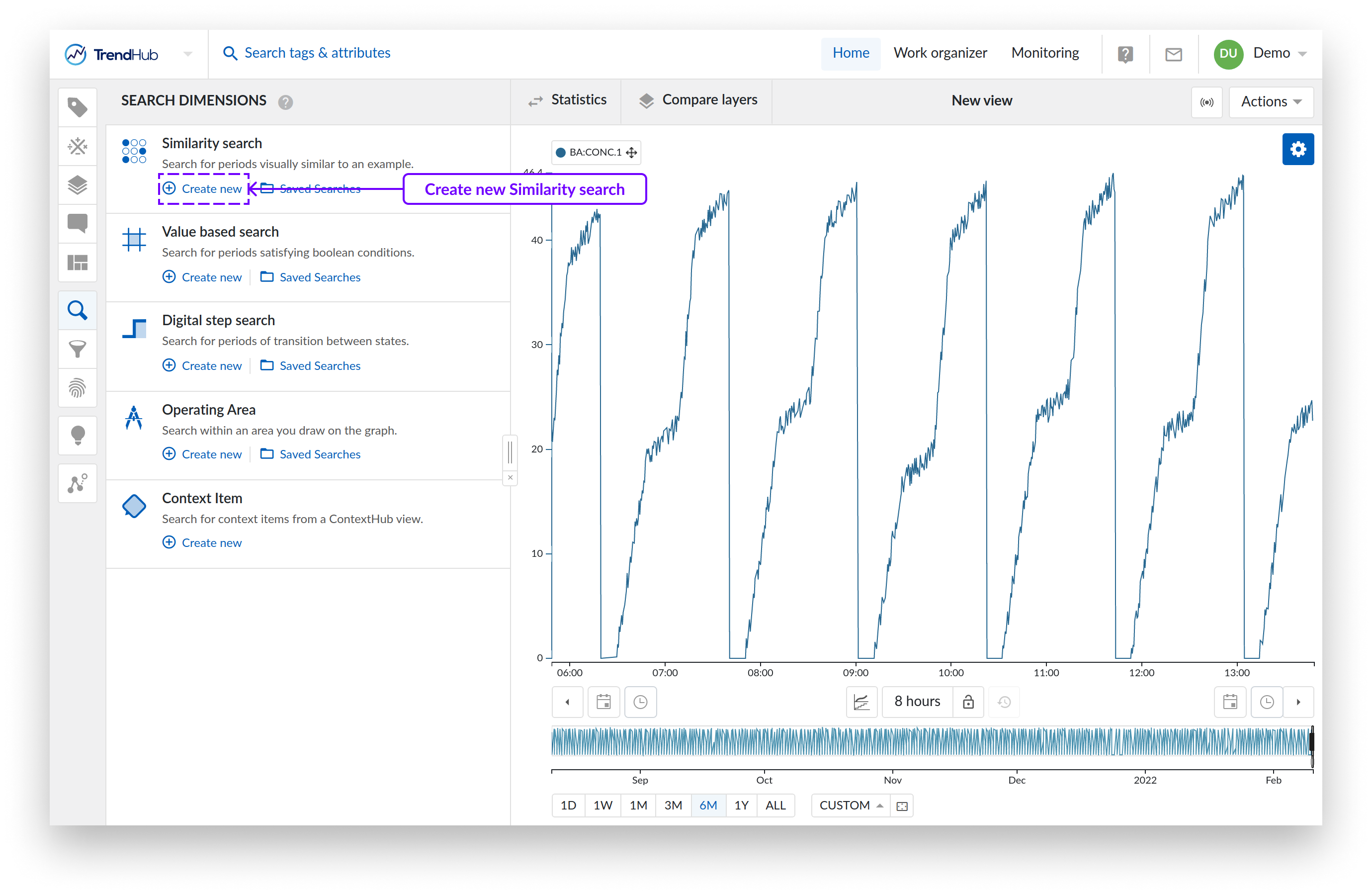

Within the search menu, click "Create new" under the Similarity search option. When the similarity search option is selected, the similarity search tool will use the complete pattern highlighted within the focus chart as search query.

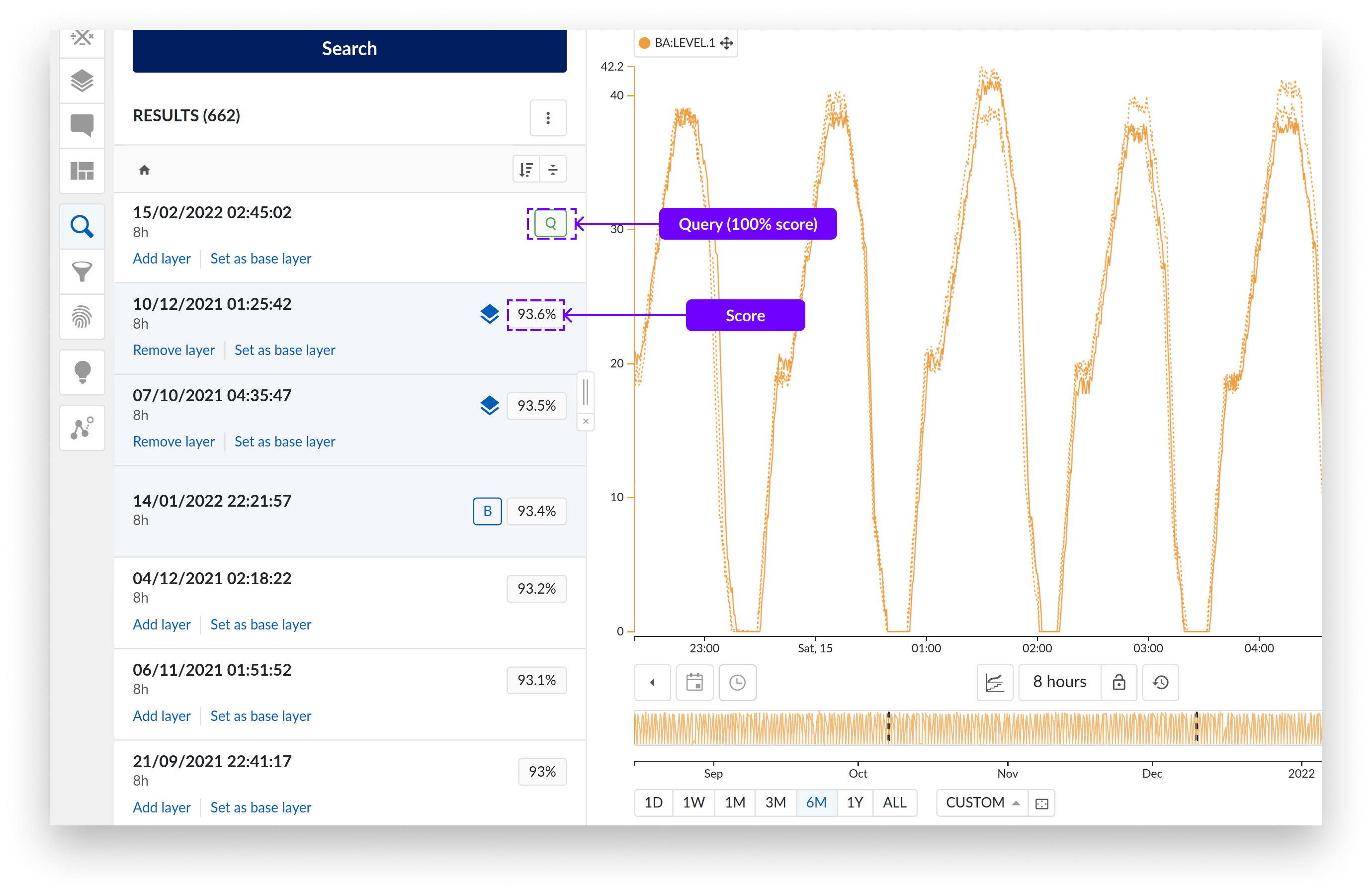

Wait for the result list to appear. By default, the results are sorted and grouped by match score (see working with the search result list to change the order of the results).

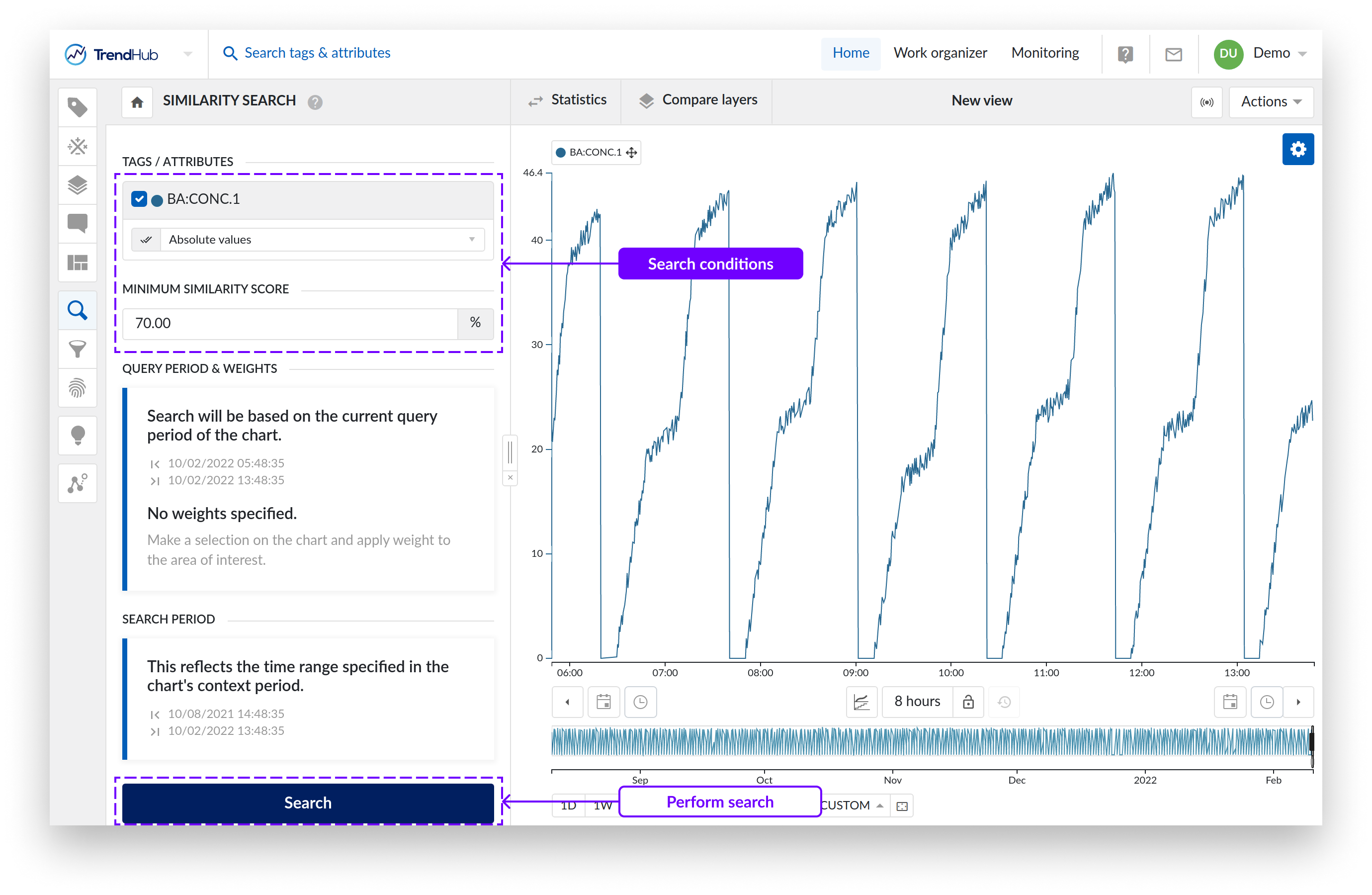

Visualized tags can be included or excluded from the search by selecting the checkbox next to the tag name.
For each tag, the similarity search can be performed on absolute values or on signal shape.
Absolute values: Select this option when the absolute level and evolution over time needs to be matched.
Signal shape: Select this option when the absolute level of the measurement is less important, but the signal shape or measurement evolution (up / down) needs to be matched. The signal shape option will not rescale the measurement but will allow vertical displacement of the pattern.
The user can change the minimum match score (default = 70% match quality). If this value increases, fewer results will be found. Decreasing the value has the opposite effect.

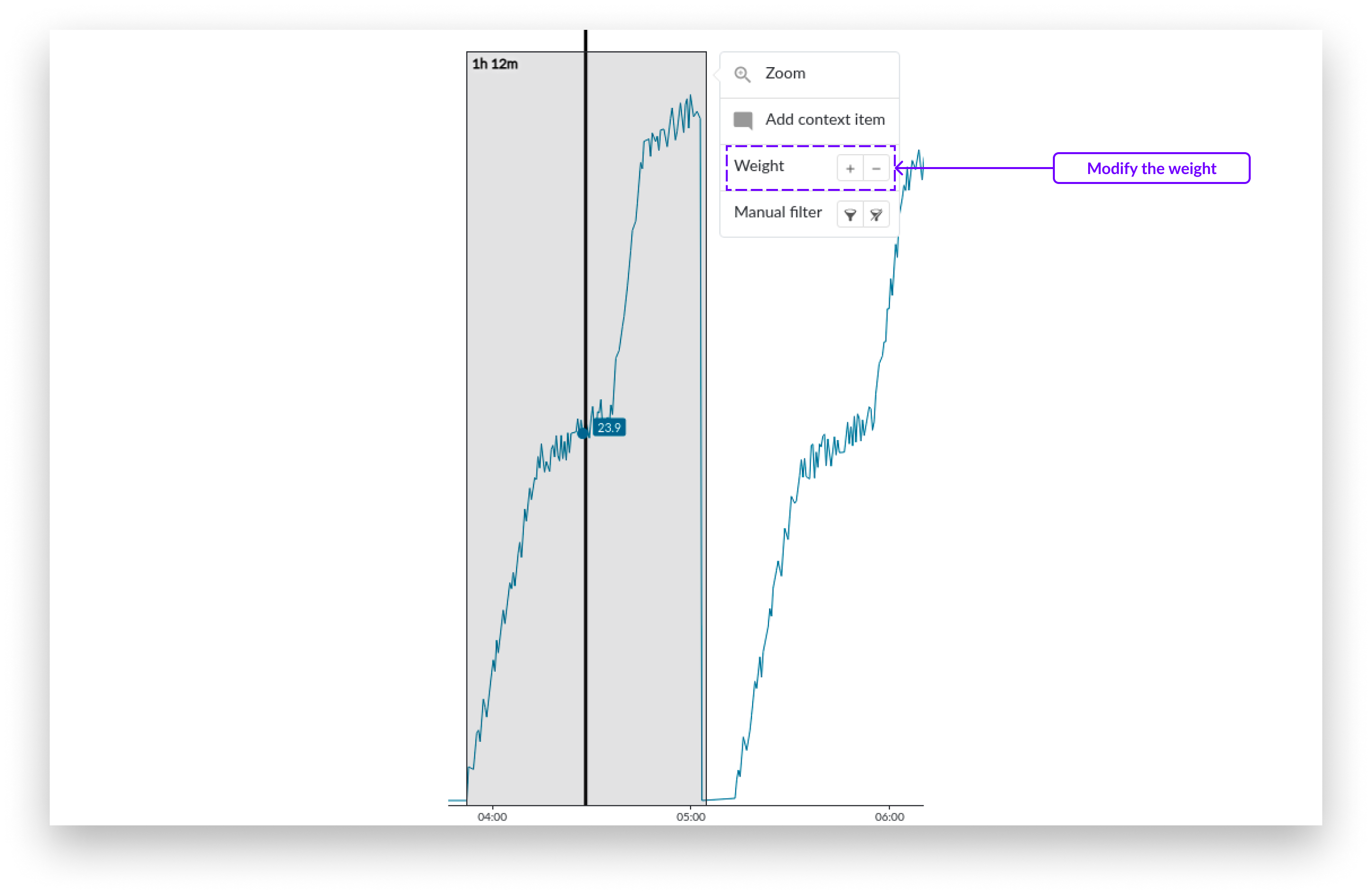

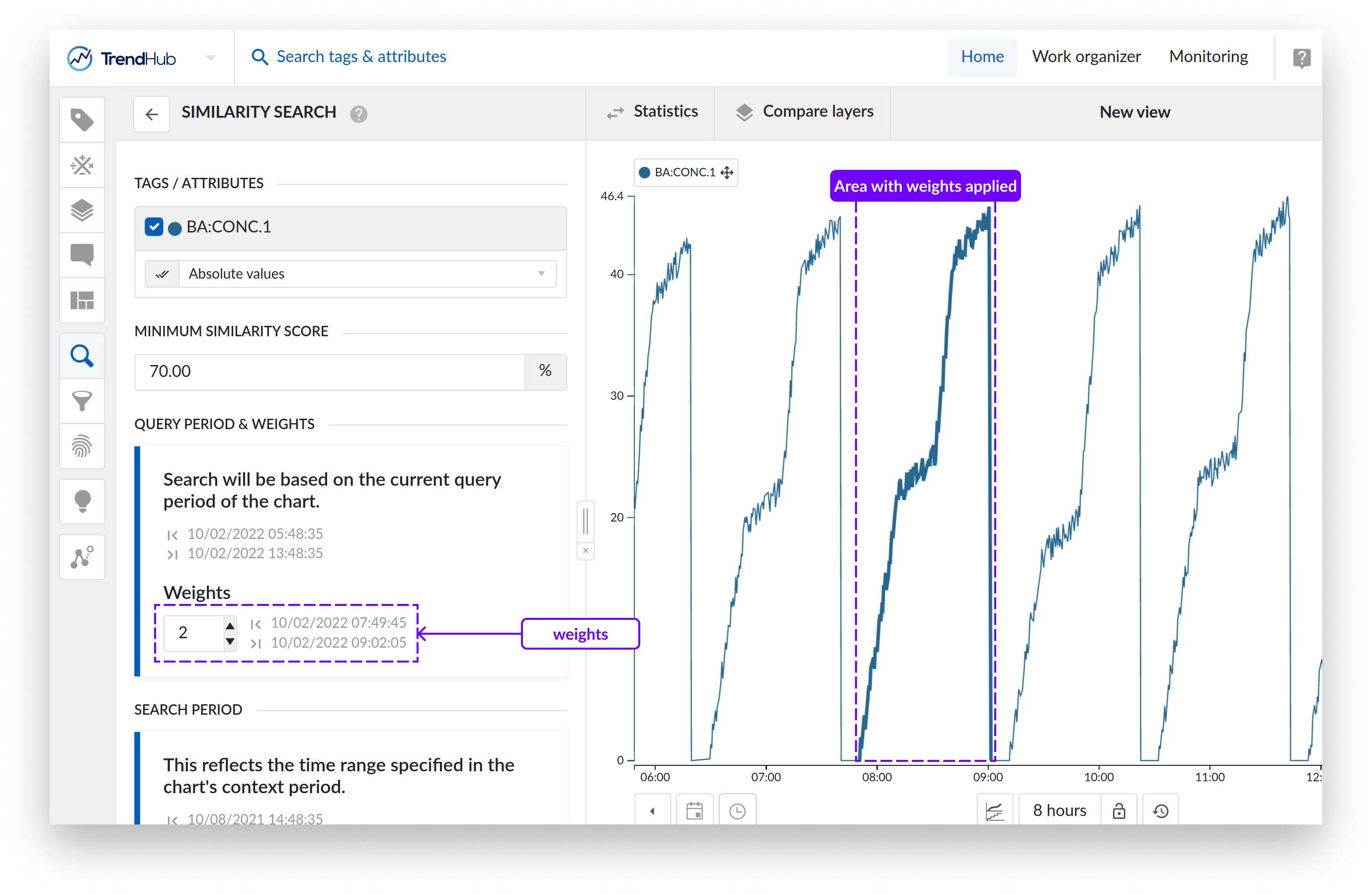

In some cases, a specific part of the pattern is more important for your analysis. In these cases, weights may be used to increase the importance of a selected sub-window of the query.
Highlight a selected area.
Use the weight buttons to set the weights. The line thickness of the trend will change accordingly. The period on which the weight is applied, and the level of the weight is also indicated in the left side panel. You can still alter the level of the weights by using the arrows next to the level indicator.
Press the button "Search" to start the search.
The similarity search will still look for matches based on the full pattern, but mismatches in the highlighted region will be penalized more.

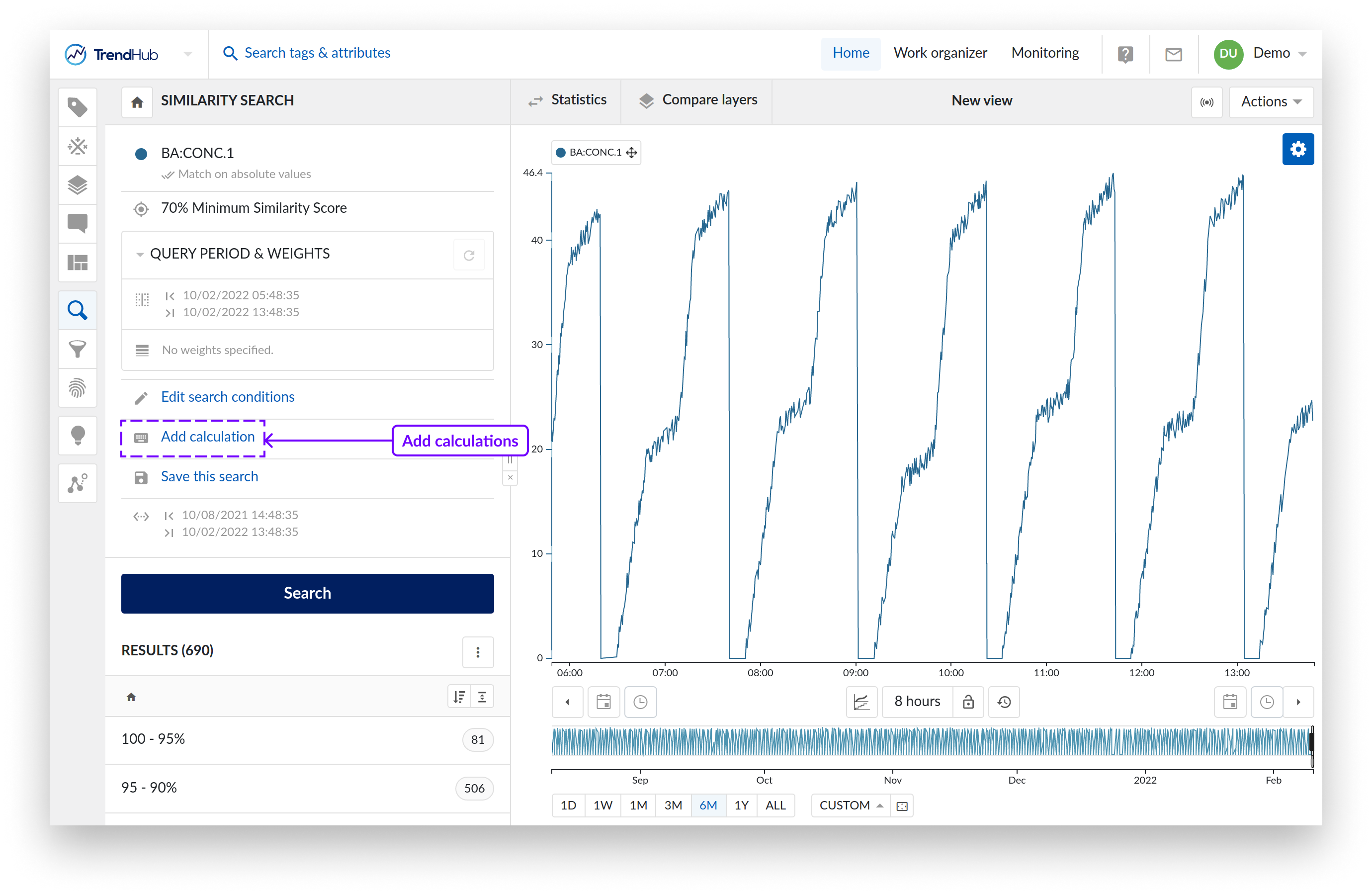

It is possible to add one or multiple calculations to the search results and the search definition, by clicking on the "Add calculation" link. Please look to the Calculations on search results document for more information about how to work with calculations.

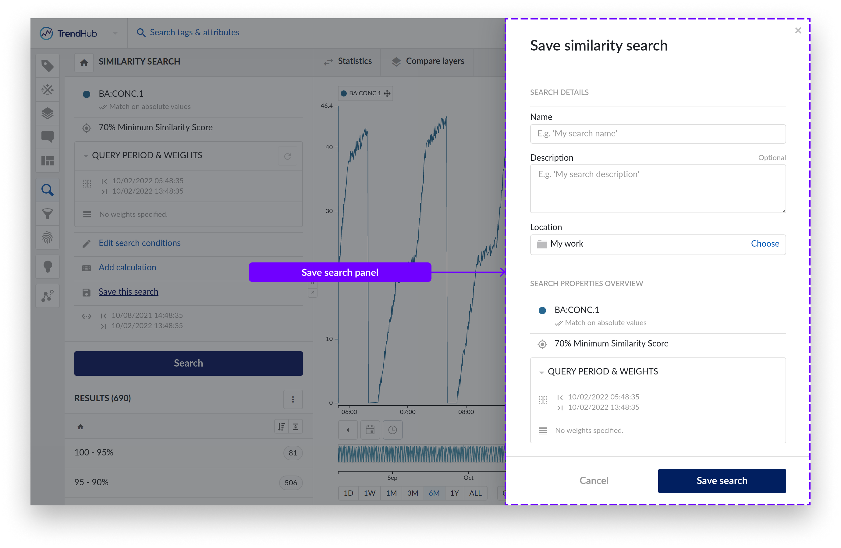

After creating or editing a search, save it following the next steps:
Click on the link "Save this search" on the Search summary.
This action will open a panel, where you can specify:
The search name
A description
The location in the Work Organizer
Click on the button "Save search" on the panel.

Scores for similarity search results are based on visual similarities between the query (solid line) and the search result (dashed line). At every point the absolute difference is taken, summed, and rescaled to the range of the query time period. A relative score from 0% to 100% is obtained.
Generally, the following rules apply:
= 100%: query
> 80% but <100%: good match
>60% but <80%: average match
<60%: bad match
