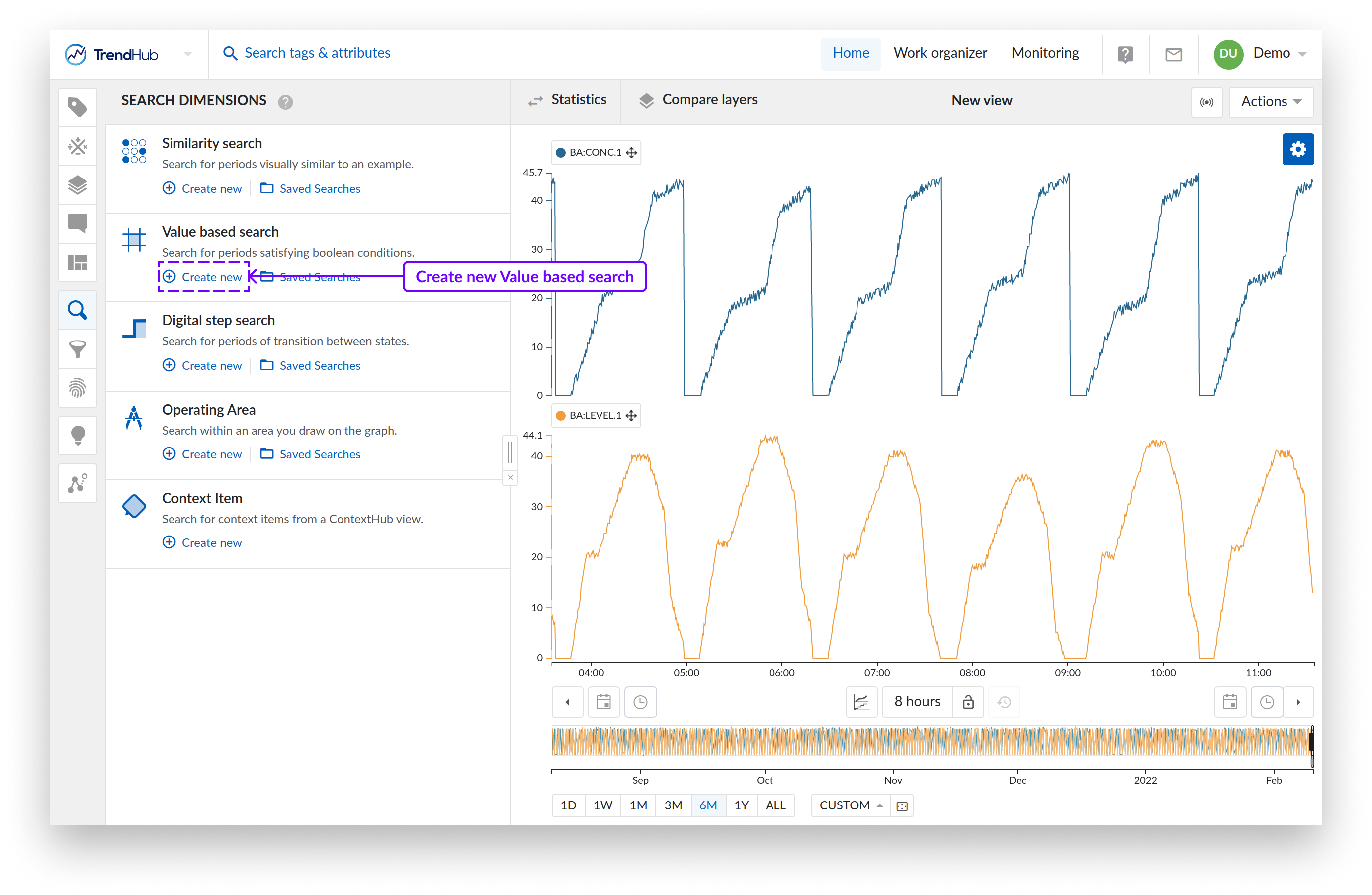

  1. Select a set of tags and the time period of interest.
  2. Within the search menu, click "Create new" under the Value based search option.

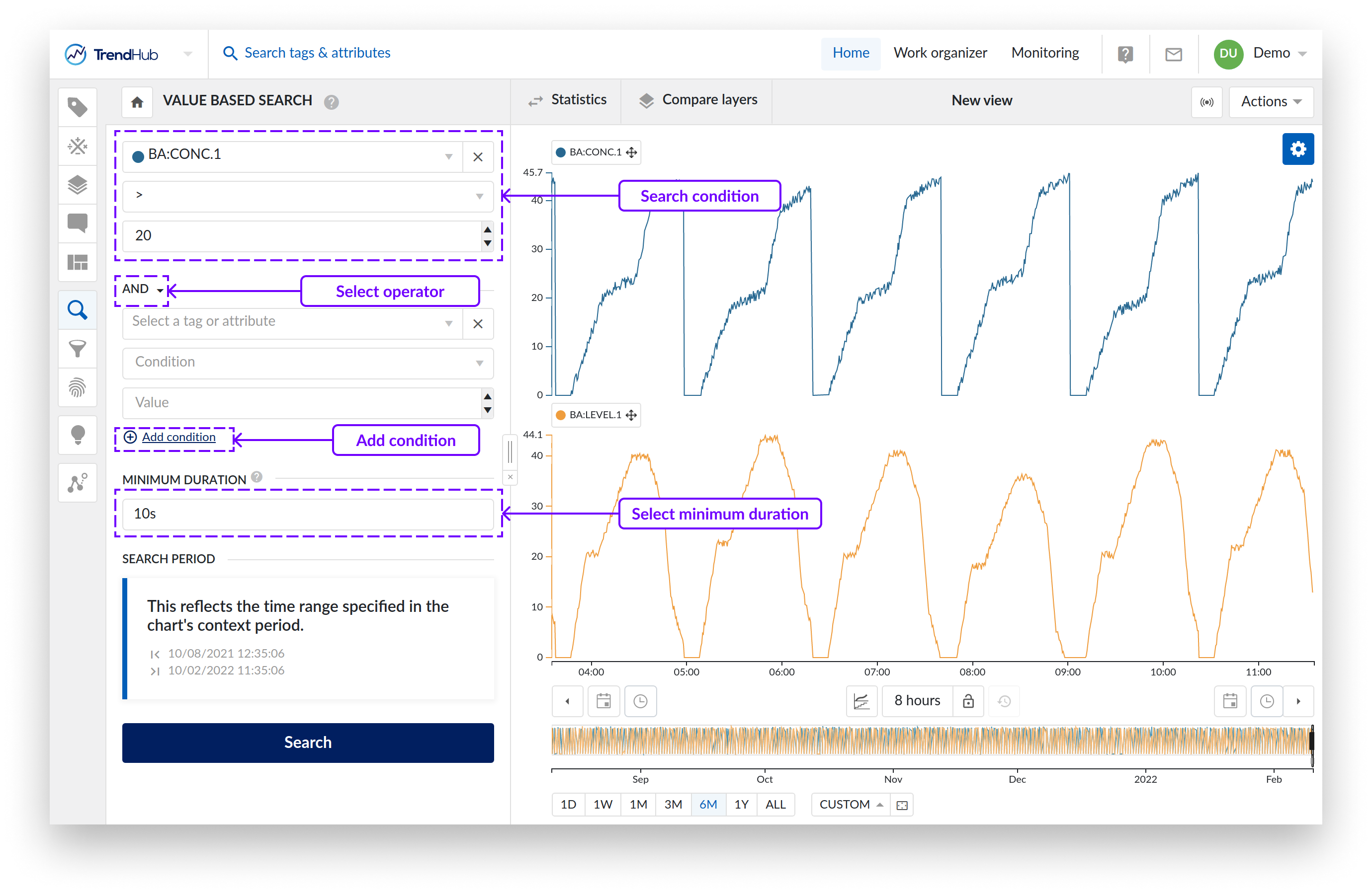

  3. Add the search conditions (see “Setting up and editing search conditions” below).

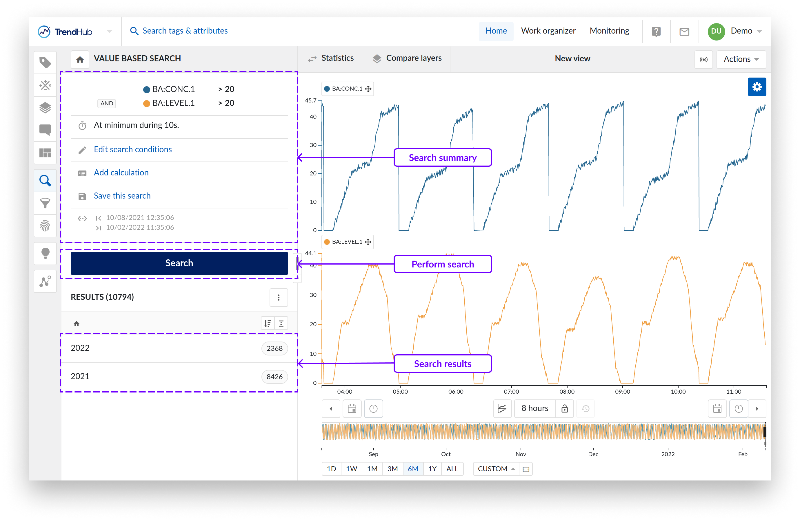

  4. Press the "Search" button to start the search.
  5. Wait for the result list to appear. By default, the results are sorted by date and descending (see working with the search result listto change the order of the results).
  • Select the tag or attribute of interest. Only active tags are available in the dropdown menu.
  • Specify the condition and the value for the selected tag.
  • For digital and string tags, when you use the condition “=”, you can select multiple states.
  • Add multiple conditions by clicking on the “Add condition” link. Up to 10 conditions can be combined.
  • By clicking on the logic operator in the value based search, the standard 'AND' operator between the conditions can be replaced by an 'OR' operator.
    Only one operator can be used over all search conditions. More complicated Boolean logic based on combinations of AND / OR / NOT operators are currently not supported. However, Filters can often be used to indirectly implement more complex logic.
  • Adapt the minimum duration for which the results must match the specified conditions in the "Minimum duration" field. This parameter may be used to filter out noise (brief spikes that satisfy the specified Boolean conditions).
    The index resolution setting determines the maximum resolution at which results are available. This implies that with a resolution setting of 1 minute, no results will be found with a duration smaller than 1 minute.

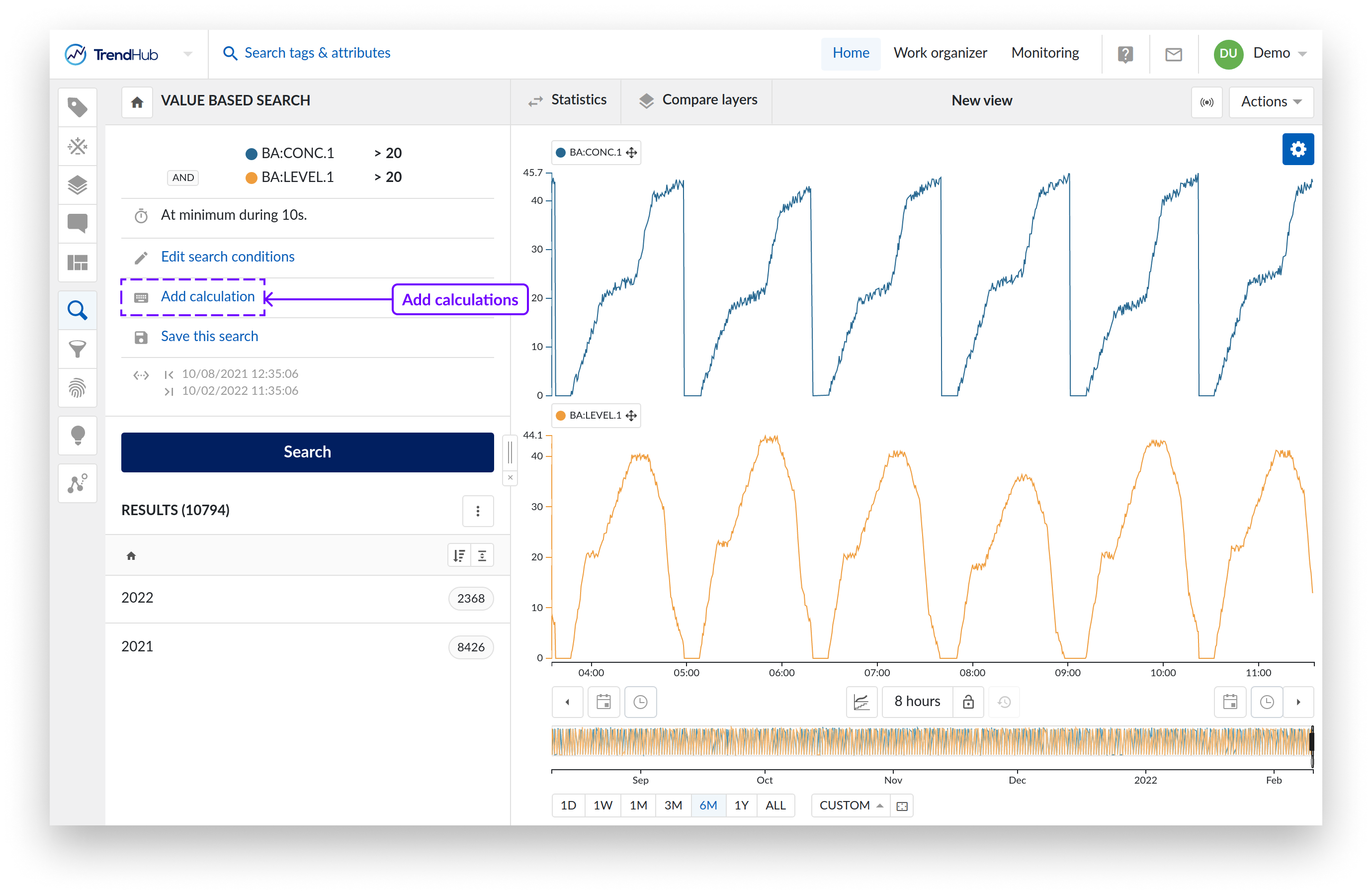

It is possible to add one or multiple calculations to the search results and the search definition, by clicking on the "Add calculation" link. Please refer to the calculations on search resultsarticle for more information about calculations.
After creating or editing a search, to save it click on the link "Save this search" on the Search summary.
This action will open a panel, where you can specify:
  • The search name
  • A description
  • And the location in the Work Organizer
Click on the button "Save search" on the save search panel.
