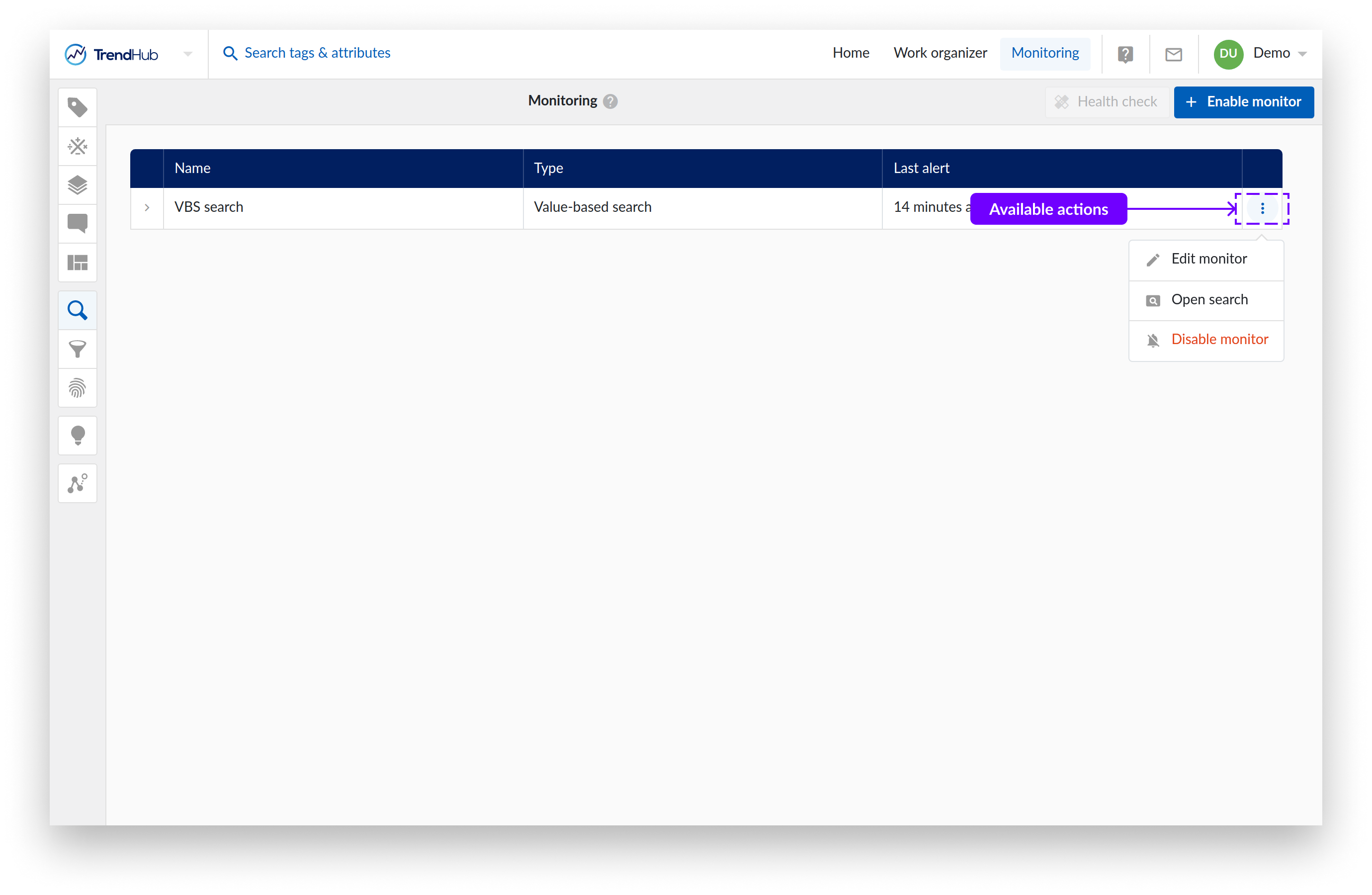

An overview of all enabled monitors is available from any hub, by clicking on the Monitoring tab in the top menu bar.
When you are new to TrendMiner, this screen contains little information. A call to action is shown to enable your first monitor. In a later stage, additional monitors can be set up by clicking the "Enable monitor" button. Please visit this article to learn how to enable monitors.
Once a monitor has been setup, a table will be displayed, containing all enabled monitors. The overview provides the following information:
Name of the monitor (which is equal to the name of the search or fingerprint).
Indication if the monitors is based on a fingerprint or search and which type of search.
Indication when the most recent event happened.

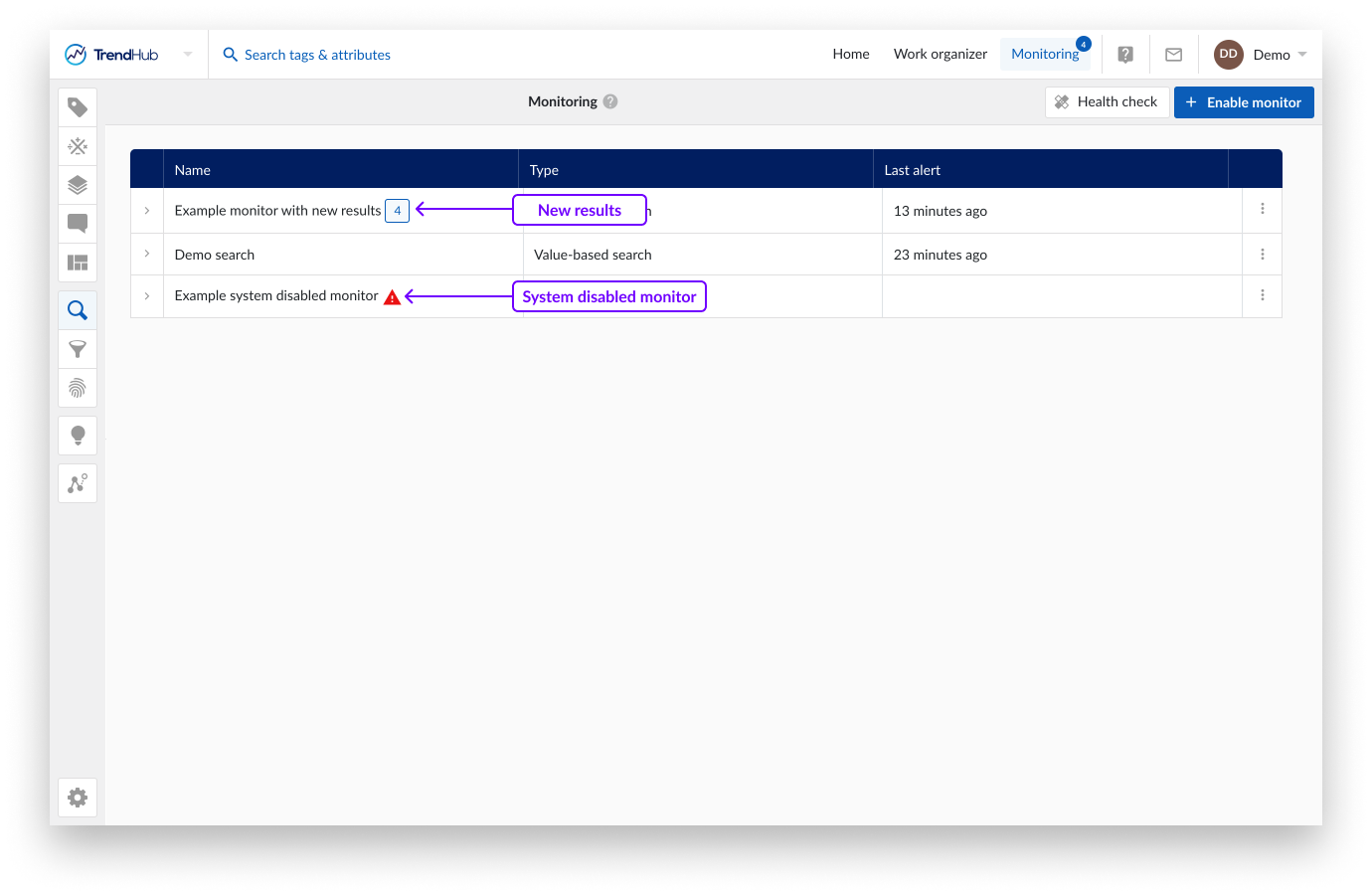

Indication of the number of new results.
Indication if a monitor is disabled by the system.
In the options drop down, shown in the last column, you can find the following actions:
Edit monitor: this action will open a panel where you can modify and save the actions connected to this monitor.
Open search/fingerprint: when clicking this action, you will be directed to the search or fingerprint detail panel.
Disable monitor: after clicking this action the monitor will be disabled. It will no longer be visible on the monitoring and alert overview page. When re-enabling a specific monitor, the previously defined settings will be restored automatically.
Editing a monitor opens the set-up panel of a monitor where you can modify the actions connected to this monitor. If you want to modify the conditions for which the monitors need to check, you need to modify the underlying search or fingerprint.
Each search or fingerprint can only be connected to 1 monitor.

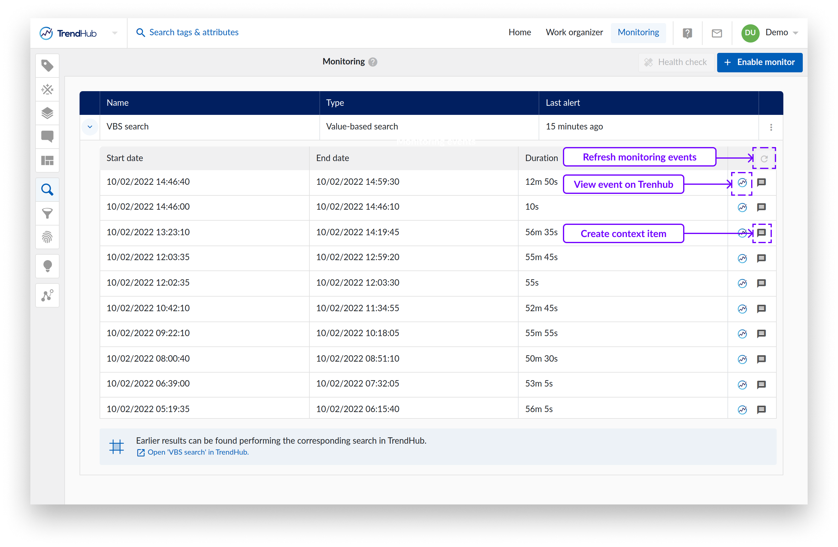

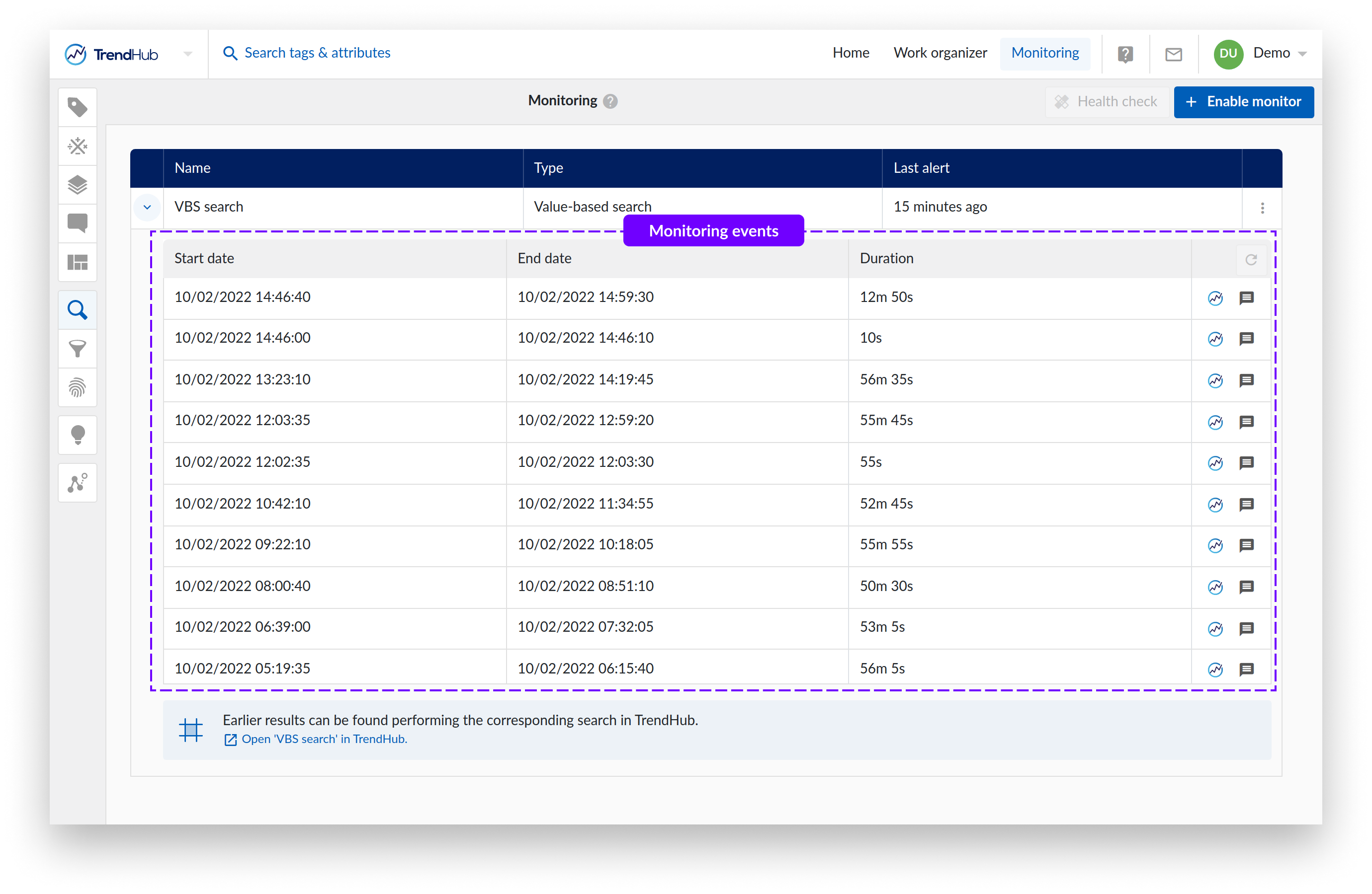

You can see the events reported by a monitor by selecting the monitor.
Up to 50 events are displayed on a table in ascending order, from the most recent to the oldest. The table will display the information of an event in the following columns:
Start date: this is the starting date and time of an event.
End date: the end date and time of the event. To see if an event is still open you can refresh the page, if the end date updates it means it is still open.
Duration: the duration of the monitor since the starting date. To see if an event is still open you can refresh the page, if the duration updates it means it is still open.
Score: For monitors of type Similarity search you will see an extra column indicating the match score.
When the Events table is open, new results are not added automatically. The refresh button will become available when new results are detected. Clicking on the refresh button will add the new events at the top of the Events table.
For every monitor event, 2 actions are available:
Show event on TrendHub: this will visualize the event period and relevant time series in TrendHub.
Create context item: This will open the creation form of context items, with the time stamps of the event pre-filled. For more information about creating context items please see Context Items.
The link at the bottom of the event table will direct you to the search or fingerprint detail panel.
New, unseen monitor results will be indicated with a blue number indicator above the Monitoring tab. On opening the monitor tab, new results per monitor will be highlighted next to the name of the monitor. When reviewing the monitor result table, the unseen results will be highlighted with a blue background.
