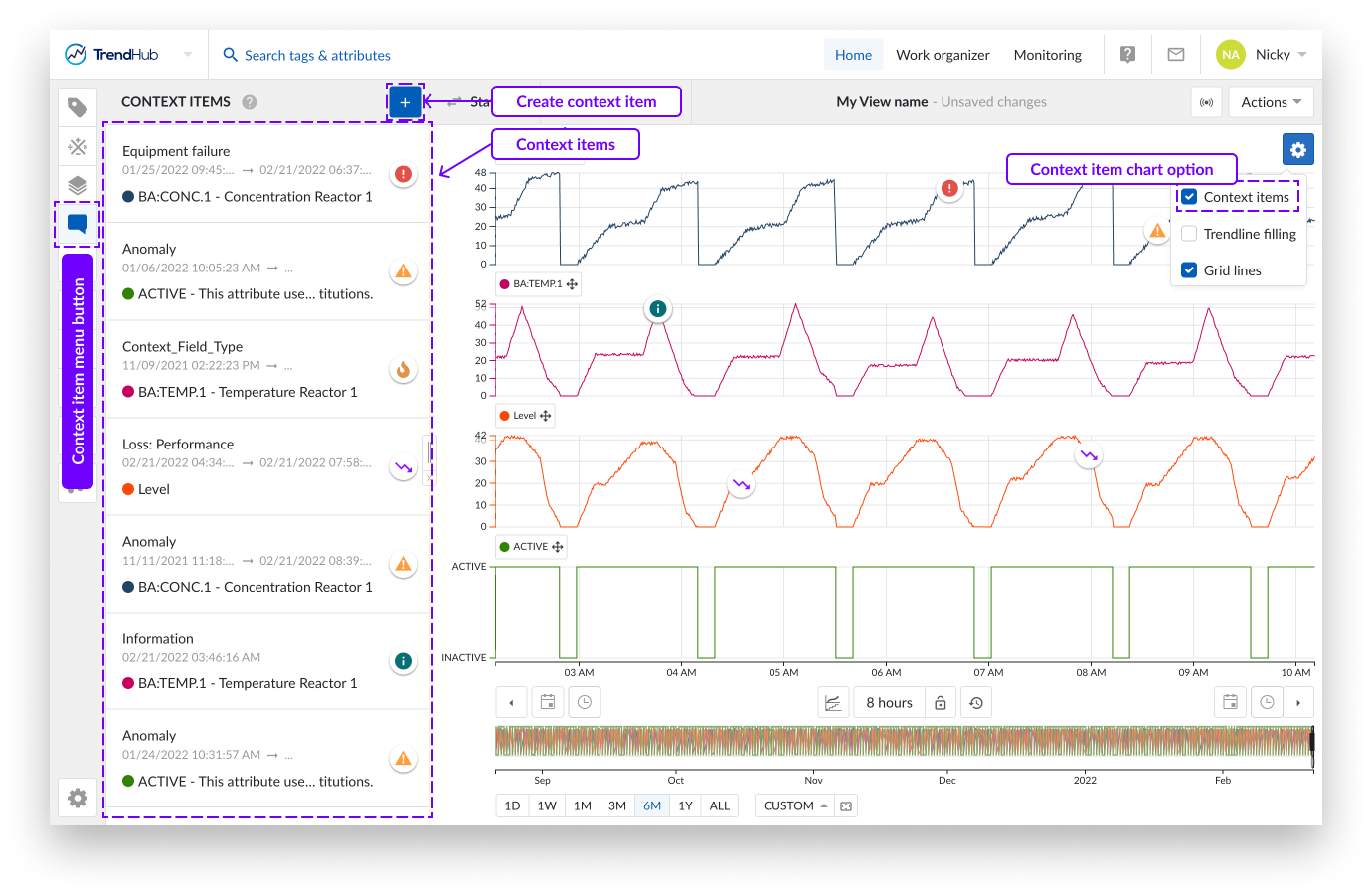

Context item Menu
The context menu is opened by clicking the context item menu icon, located in the menu bar at the far left of the TrendHub screen.
On the context item menu, you can see an overview of all context items that are present on the focus chart.
On the image above you can see the overview of those context items with some details about the context item type, time of occurrence, to which component the context item is linked, and the symbol of the context item.
In case a context field is enabled as a label, this will be displayed under the context type. Setting labels for specific context item types can be done by your local administrator.
To see context items in the menu, one visible tag (or attribute) is required.

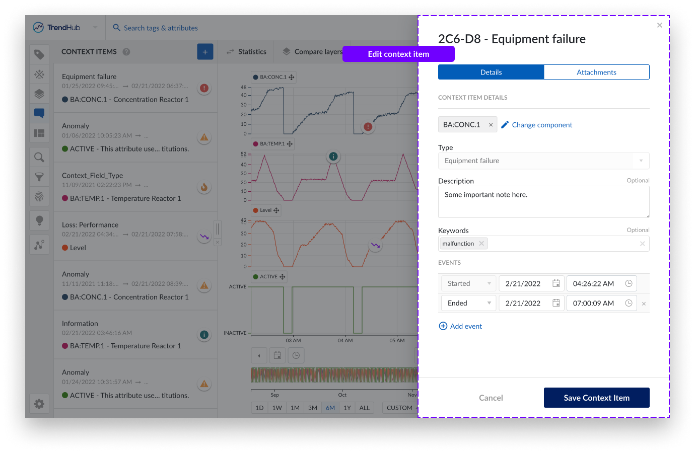

Creating context items: Context items can be created manually using the context item menu, the focus chart, or via search results. By setting up monitors, context items can also be created automatically.
By default, the first visible tag (or attribute) is selected. You can easily select another tag or attribute if needed by clicking the "Change component" link.
After selecting a type, the "Events" section is revealed where you can specify dates. Depending on the type, one time input is shown (for instant items) or two to enter a start and end date (for interval items).
Creation in context item menu: Creating a context item in the menu is done by clicking the blue plus button at the header of the menu. Once clicked a right-side panel appears where you can define the context item.
Component, type, and the events are required fields before a context item can be created.

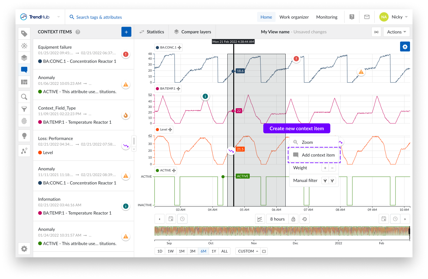

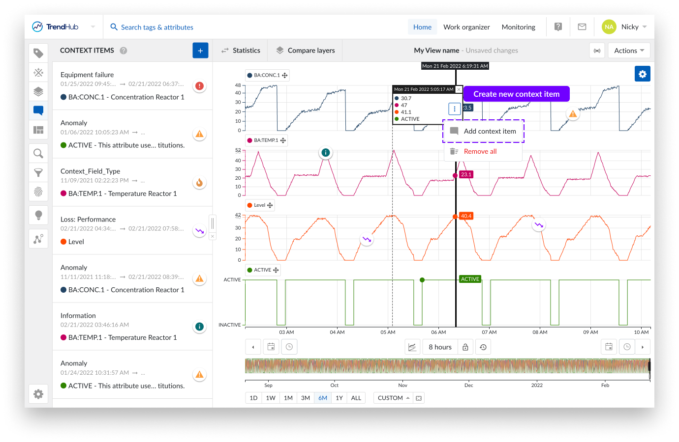

Creation on chart: Creating a context item on the focus chart has the advantage that the start and end time will be pre-filled based on your selection.
Double clicking on the focus chart adds a data scooter which has an option called "Add context item". Clicking this option starts the context item creation flow as mentioned above.
Creating a selection on the focus chart also reveals the option "Add context item" for the selected period. By clicking this option, the context item creation flow, as mentioned above, is started.

Context item details: By default, context items are visualized on the focus chart. So, make sure that this option is enabled if you are not seeing your context items (see chart configuration in the first screenshot).
You can hide context items on the chart by disabling the context item option. The benefit of this action is the increase in performance of the focus chart (trend and stacked trend).

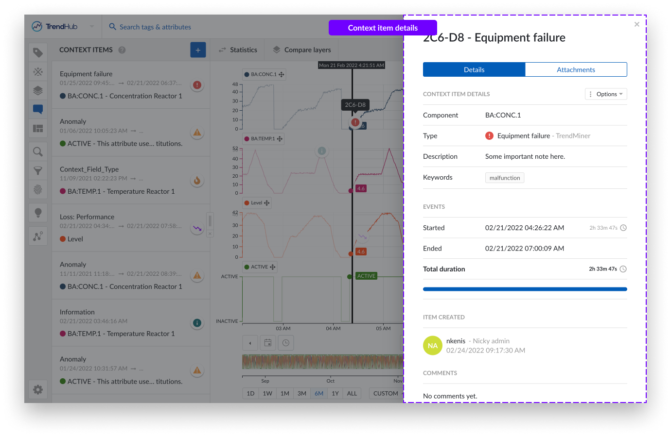

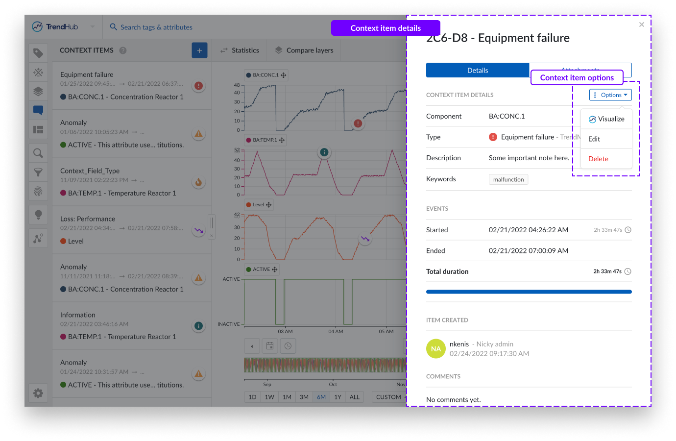

Details: You can visualize the details of your context items by clicking a context item icon on the chart or clicking on any context item on the context item menu. Doing this reveals the context item details side panel.
The details side panel above reveals all contextual information of that context item. The following details are provided:
Context item details, including:
Component on which the context item is created
Type of context item
Description
Timestamp (only for instant items)
Keywords
Context fields (if available)
Events (only for interval items)
Start date and time
End date and time
Duration
Information about the creator of the context item and time of creation.
Comment section, where users with the proper rights can add comments to a context item, providing yet further detail.

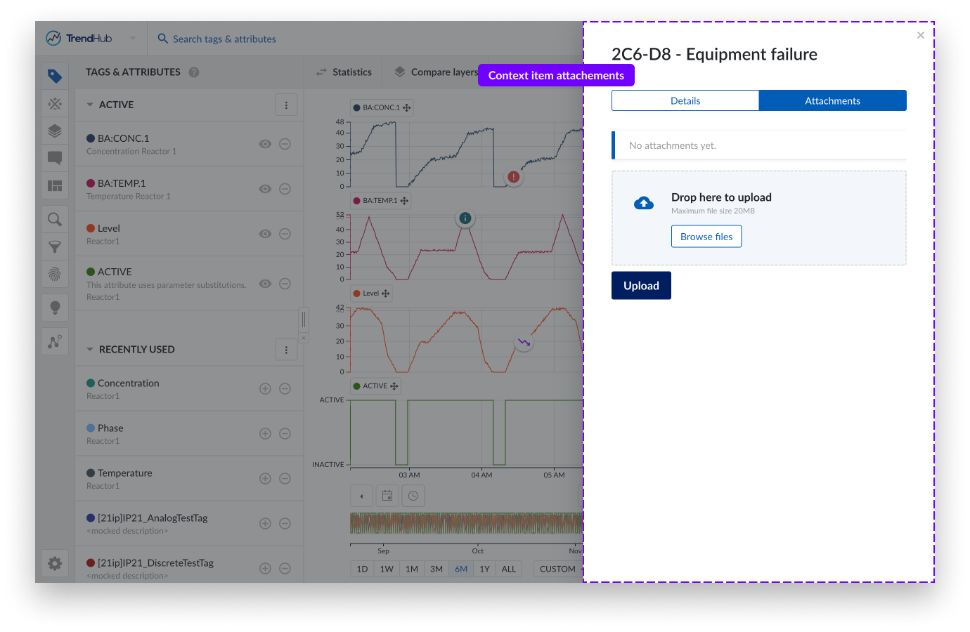

Attachments: You can also add documents to a context item. To do this, simply drop an item on the attachments tab. All documents can be stored and retrieved in this location.
Context item options: Further context item options can be found behind the options button on the details tab.

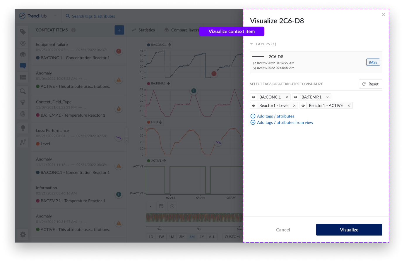

Visualize: The first option "Visualize" lets you visualize the period of the context item directly on the focus chart. Clicking this option opens another side panel where you can modify some settings before the actual visualization starts.
Clicking on "LAYERS (1)" reveals the period the focus chart will jump to.
You can also update the tags and/or attributes which will display the period of the context items. By default, all active tags are selected but can easily be removed or even updated.
One option to add additional tags and/or attributes is by adding them one by one using the "Add tags / attribute" link option.
The second option is to add all tags and attributes which are included in a saved view using the option "Add tags / attributes from view" link option.
When you do something by mistake, you can easily reset the list using the reset option.
Clicking the confirm button "Visualize" will update your current view with the period mentioned in the layer and all selected tags and/or attributes.
For saved views this will result in unsaved changes.
Edit: With the edit option, users can update a context item. Clicking this option triggers a similar creation side panel, with all current details filled out.
Remove: When a context item is no longer needed it can be deleted using this option. Only users with deletion rights can perform this action.
All users have editing rights to update any context item. To delete a context item, deletion rights must be provided. Although, administrators can delete any context item, even when deletion rights are not specified.
Deleted context items cannot be retrieved.
