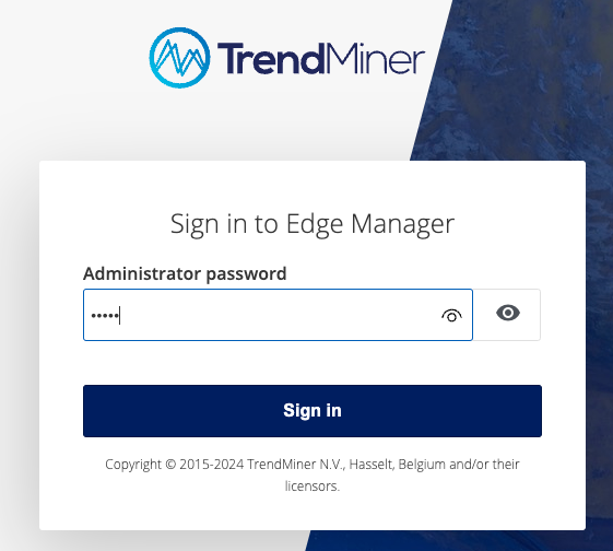

Login to TrendMiner EdgeManager
https://url/edge or http://url:8080 (in case no valid certificate is installed)
Click “Sign In”

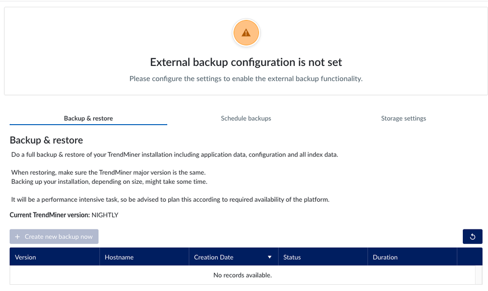

Navigate to “BACKUP AND RESTORE” -> Full
Click on Full

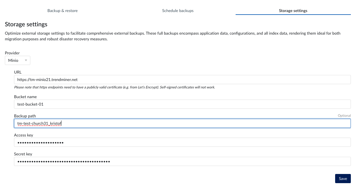

Click on Storage Settings
Select Minio in the drop down menu called “Provider”. After selecting the storage provide you need to fill in all information required, as shown in the screenshot below.
You should have all the parameters for configuring, except for the backup path.
The configured bucket needs to be empty
Wait until storage location is validated
you can click on Storage Settings tab, to refresh the page
The status should say Available before continuing with the next steps.

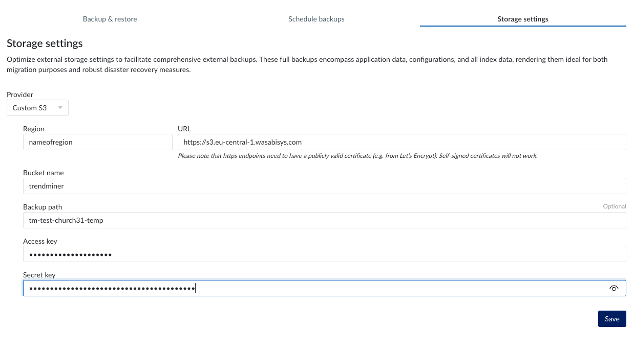

Select Custom S3 in the drop down menu called “Provider”. After selecting the storage provide you need to fill in all information required, as shown in the screenshot below.
Tip
Not all of the S3 compatible solutions are providing the Region parameter. If the Region is not available, you can pick a name you prefer, e.g. customs3region or leave it empty
