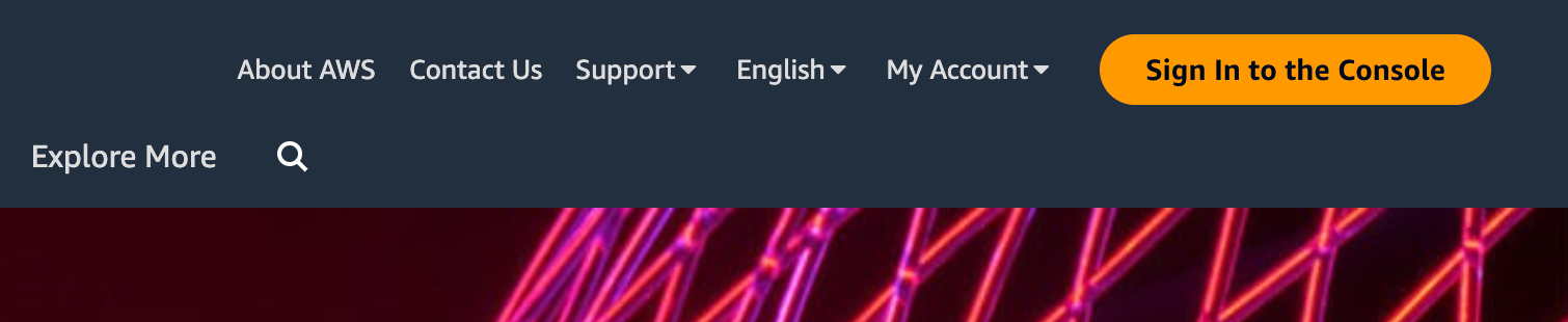

  1. login to your AWS account (https://aws.amazon.com)
    Click on “sign in to the Console”

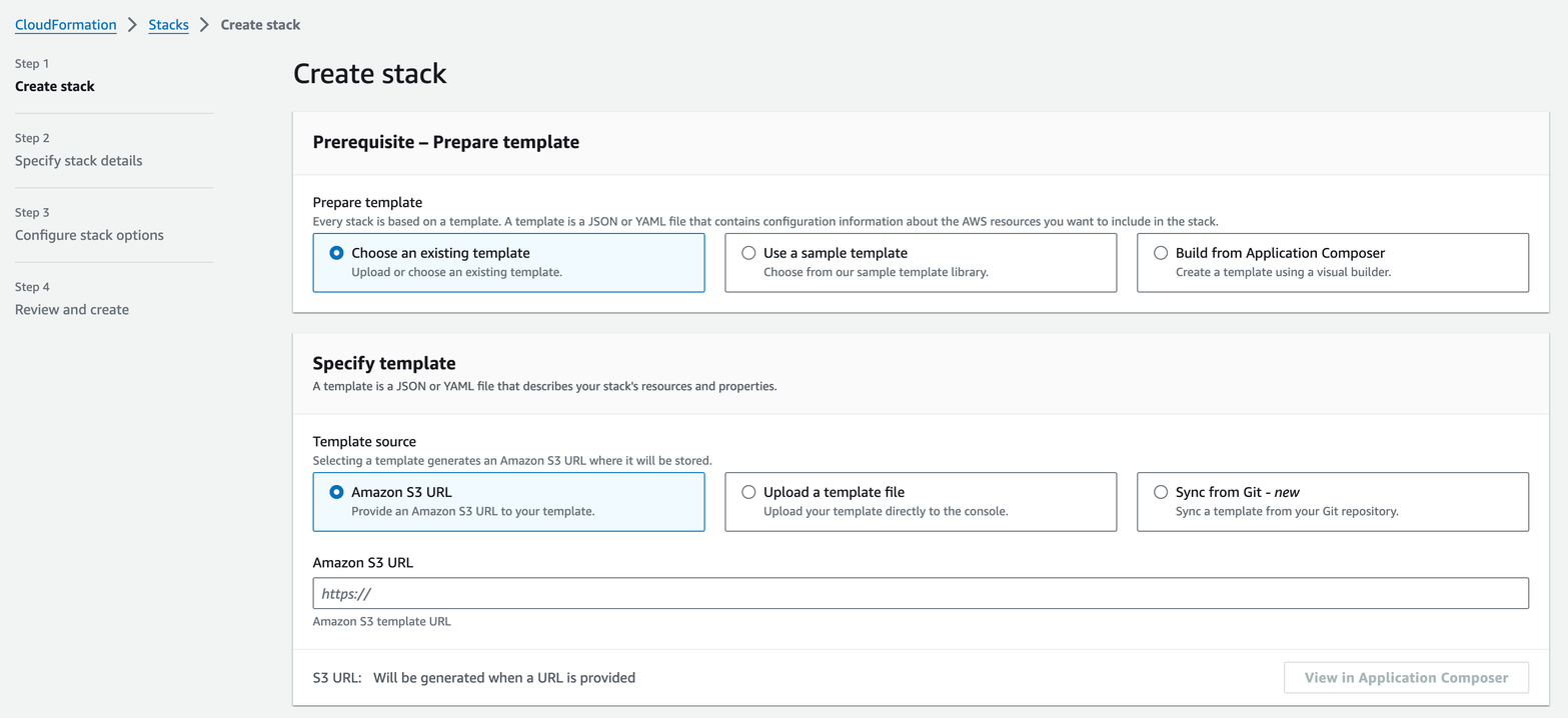

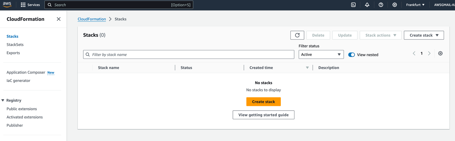

  2. Open CloudFormation, and click on “Create Stack”

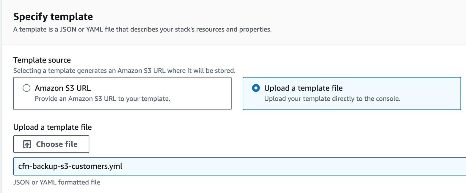

  3. Click on “Upload a template file” , then choose the file you have downloaded in the prerequisite step
    Click Next

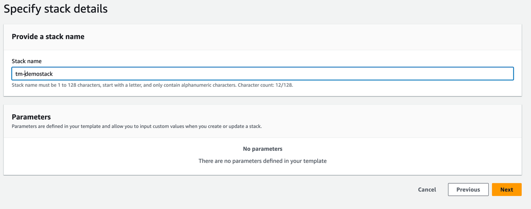

  4. On the “Specify stack details” page fill in the Stack Name
    the stack name is used to create the S3 storage and credentials. Please use something meaningful, that you can easily find back like tm-s3backup. The Stackname will also be the name of your bucket. This you will need when configuring Trendminer.
    Click Next

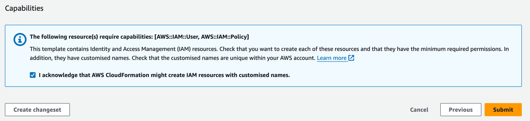

  6. On the “Review and create”
    scroll down, read & accept the terms
    Click Submit

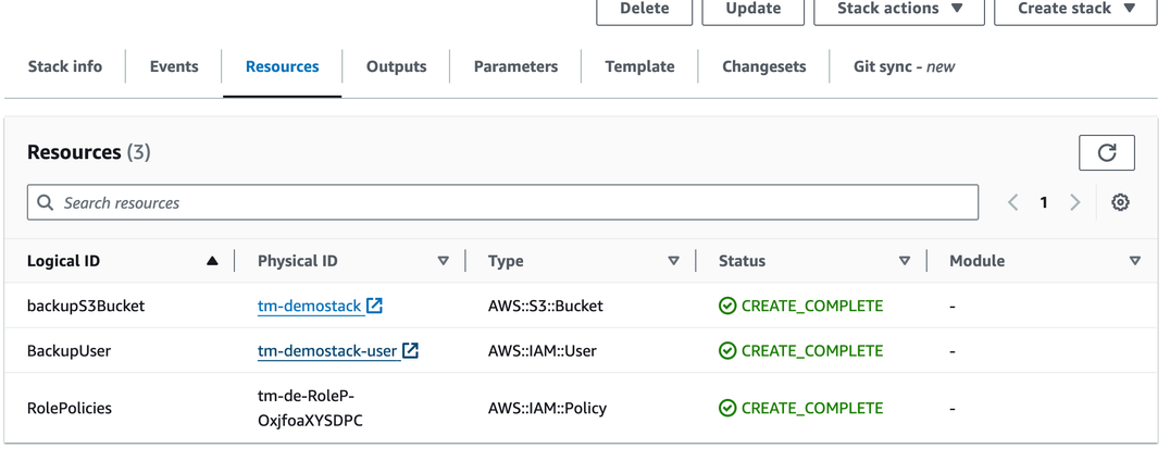

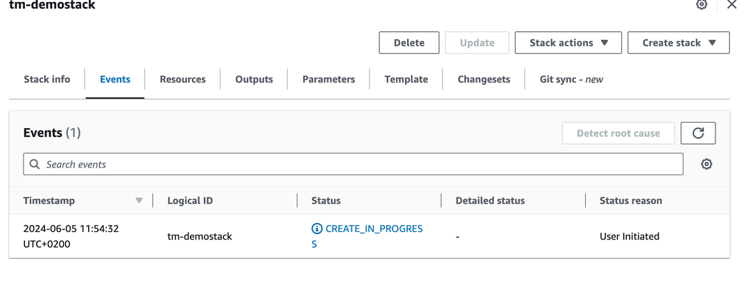

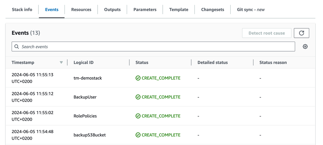

  7. Wait until the Stack is created
    you might need to click on the refresh icon, to see the status change.
  8. To get your S3 access credentials navigate to Resources and then click on the physical ID link next to BackupUser to open the user details and configure access credentials

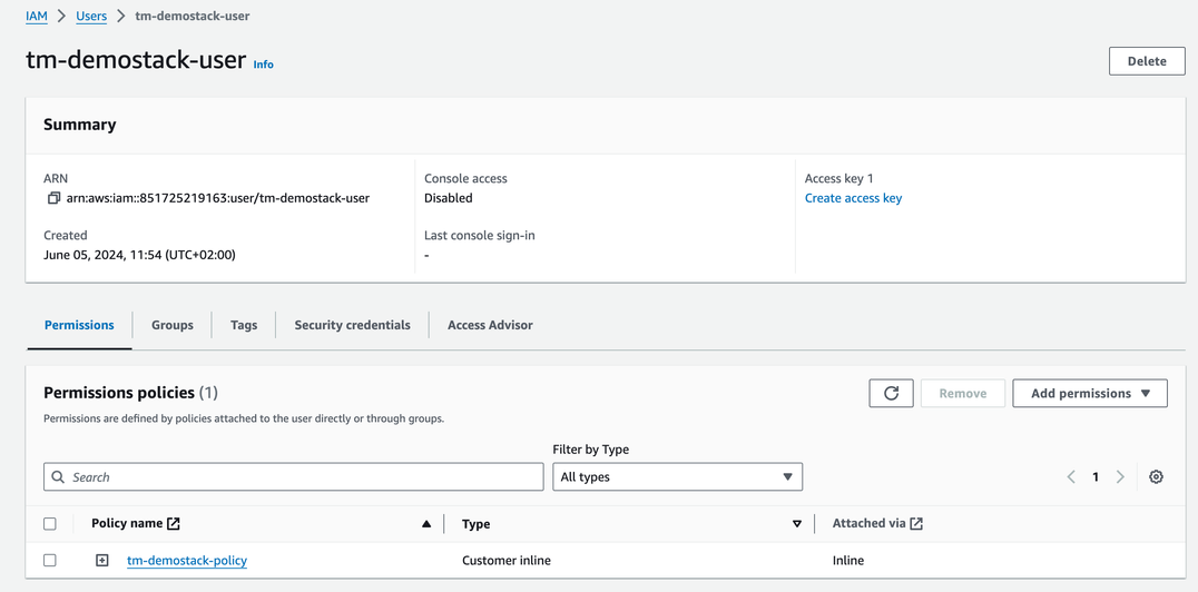

    you should have been redirected to the IAM User section.

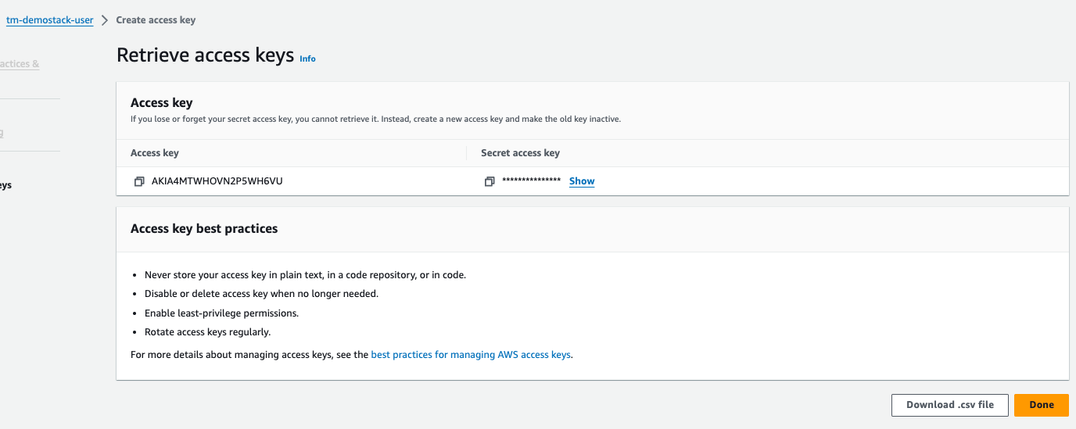

  9. Please create an access key under the "User summary" by clicking on "Create access key" on the right-hand side.
    Select Other
    Click Next

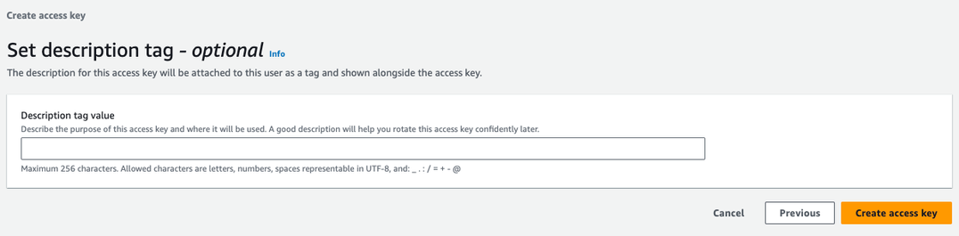

  10. on the “Set description tag” you can optionally specify a tag. After that click “Create access key”
  11. The access key is now visible on the screen. Save the access key information displayed on the screen to a secure location, either by storing it manually or downloading the CSV file and securing it accordingly.

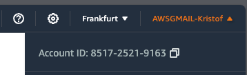

  • AWS account ID. This information is located in the upper right corner when clicking on your account name, example:

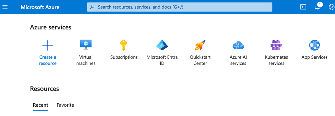

  1. after login, you shall be arriving at the dashboard page, that could look like this:
Deploy a custom template
  1. Deploy a custom template

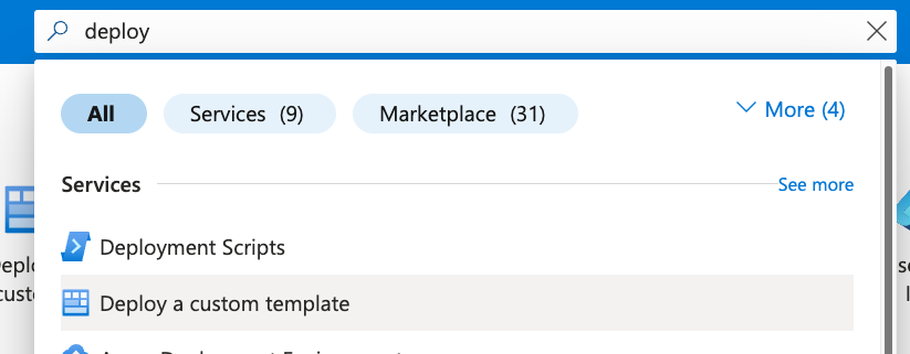

    Search for “deploy” in the microsoft search bar, and select “Deploy a custom template” service

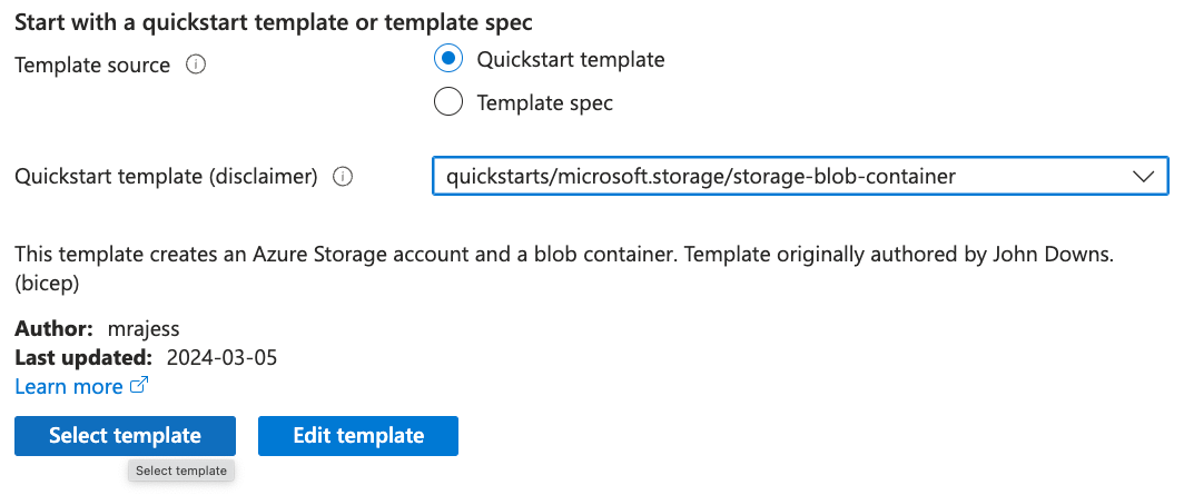

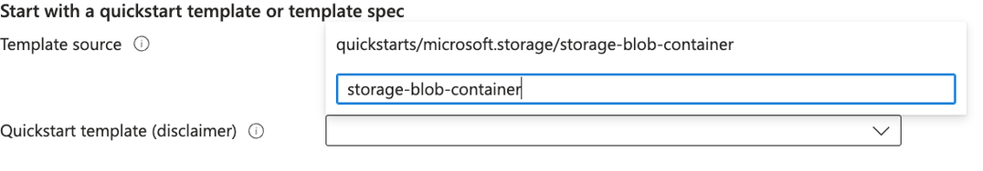

  2. Scroll down and search for the quick start template called “storage-blob-container”
    1. Click on “Select template”

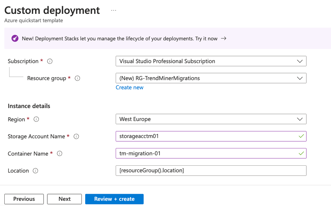

    2. On the Custom Deployment screen, fill in the following information
      - Resource group: select a existing one, or create a new one (Take Note for later use)
      - Region: select the region where the files need to be saved in. This is best as close as possible to your TrendMiner installation to avoid any delays.
      - Storage Account Name: specify a self generated name, that you can easily find back later (Take Note for later use)
      - Container Name: Suggest you are using the name of the server you are migrating here. But this field is also open to pick a generic name. (Take Note for later use)
      If done, click Review + Create

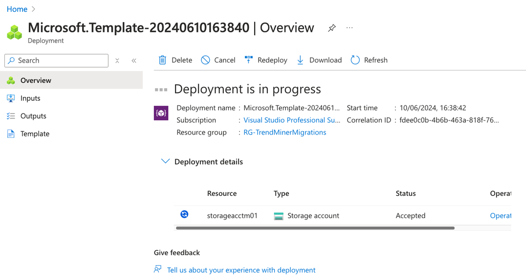

      On the last screen (review changes), Click “Create”

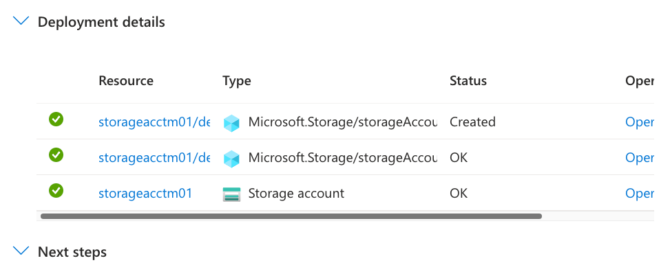

    3. Wait until all actions are done

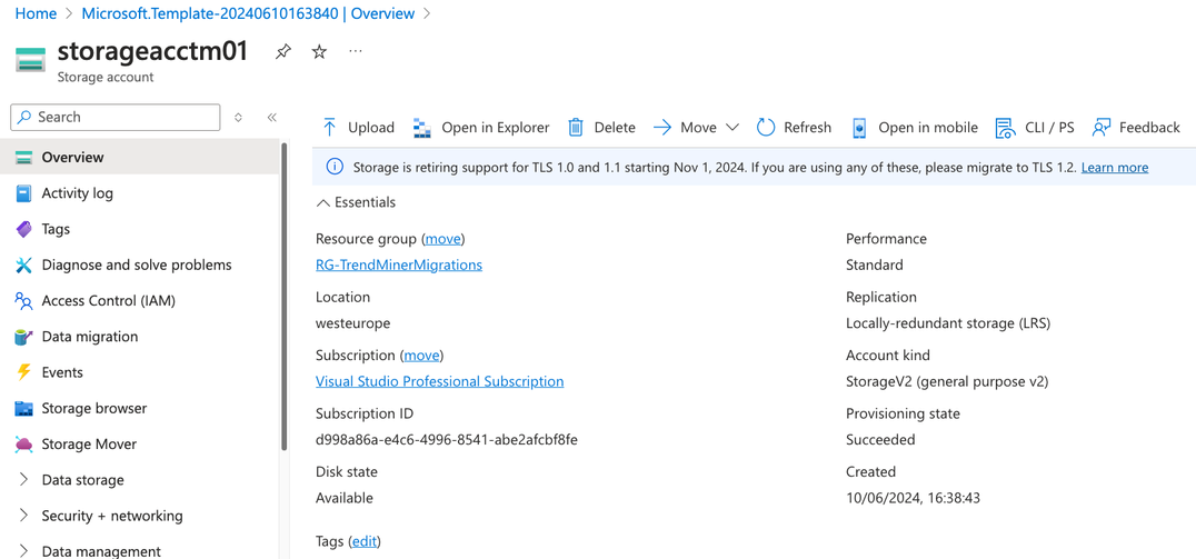

Get your Subscription ID and Access Keys
  1. Click open the ‘Deployments details’ and find back the Storage Account.
    Click the link left from “Storage account” Type
    In this case “storageacctm01”
  2. On the overview page, make note of the “Subscription ID”

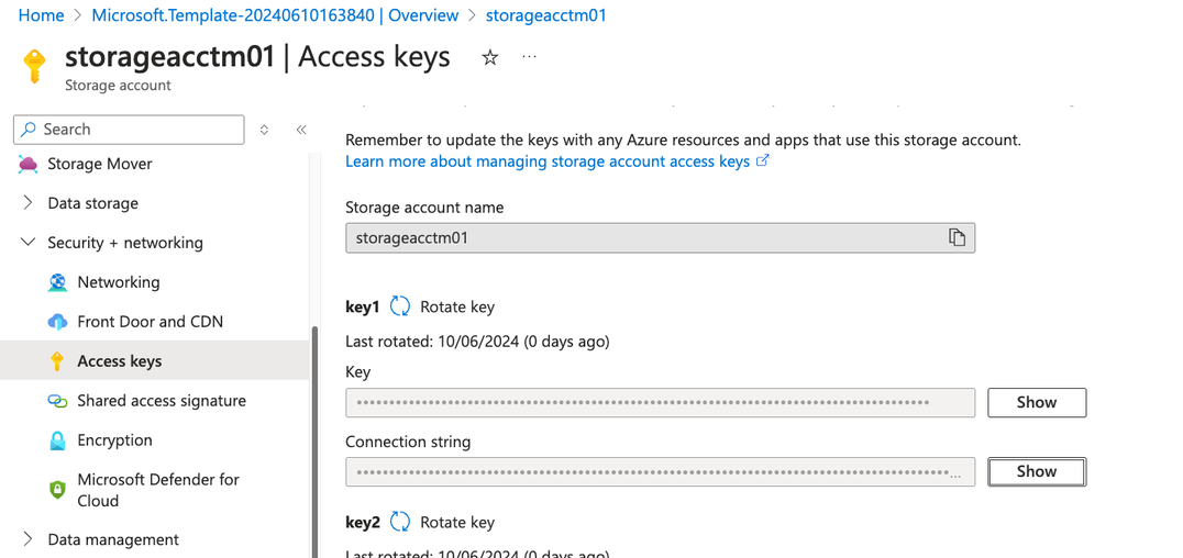

  3. Open Security + Network menu
    In the menu at the left of the screen, click on “Security + Networking” and click on “Access Keys”
    Retrieve your Access Key by clicking on Show button next to the “Key” Field.
    If you plan on rotating your access keys, do not forget to update the TrendMiner Installation with the new access key

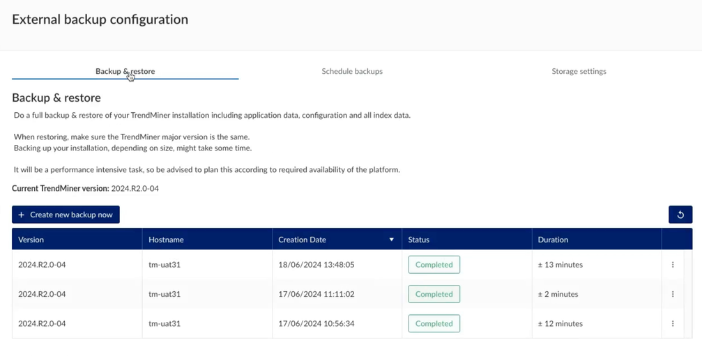

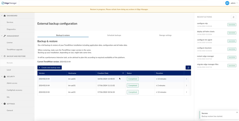

  2. Navigate to “BACKUP AND RESTORE” -> Full
    backuprestore-menu
    Click on Full
    Click on Storage Settings

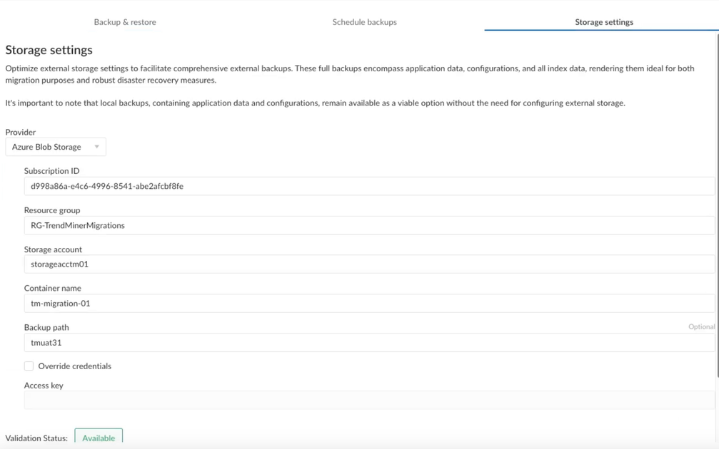

Configure the Storage Provider
In this procedure we use Azure Blob Storage, after selecting this, fill in all information required
You should have captured the data from the procedure on how to create a Azure Blob Storage account, except the backup Path.
  • You can choose a backup path yourself. E.G. name of the server that your are backing up.
  • One storage account, can be used for multiple TrendMiner Installations, however, it is advised to use at least another backup path to be able to use the same storage account.
    • There are 4 reasons for this recommendation:
      • It simplifies backup management for each environment.
      • It ensures that backups for each environment remain separate, minimising the risk of accidentally restoring from one environment with backups from another.
      • It streamlines the process of deleting backups specific to an environment.
      • It prevents scheduled backups from interfering with each other if they are executed simultaneously.
  • When restoring to a new server, make sure to use the same backup path on the destination server
The configured bucket needs to be empty
Click Save
Validate the Configuration
Wait until storage location is validated
you can click on Storage Settings tab, to refresh the page
The status should say Available before continuing with the next steps.

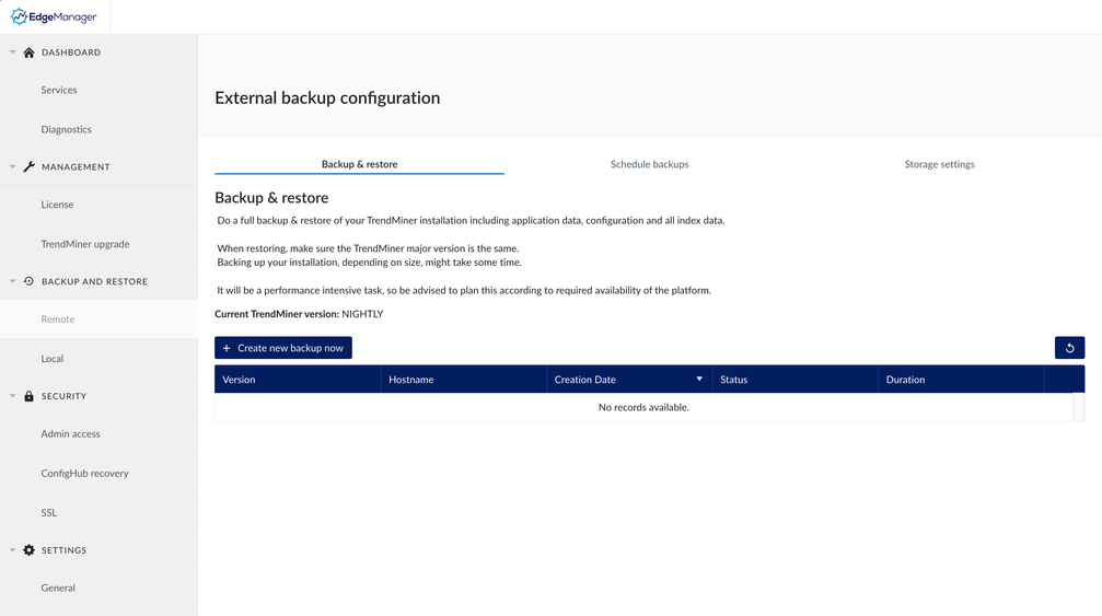

  2. Navigate to “BACKUP AND RESTORE” -> Remote
    backuprestore-menu

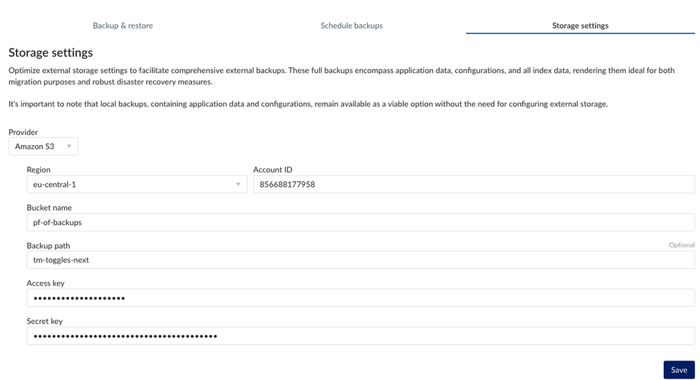

In this procedure we use Amazon S3 (default). After selecting the storage provide you need to fill in all information required, as shown in the screenshot below.
You should be able to fill in all information from the procedure to create the S3 bucket, except for the backup path.
  • One storage account, can be used for multiple TrendMiner installations, however, it is advised to use at least another backup path to be able to use the same storage account.
Click Save
In case the status is as following
Tip
In case something is going wrong (Status stays on Unavailable), these are some tips you can try to fix
  • make sure the date and time are correct on the server. Also NTP server need to be in place. Not setting it, will result in authentication failure for the backend tooling used to setup the remote storage
  • Doublecheck all parameters provided.
  • Validate you can properly communicate to Minio S3 from the TrendMiner Host.
  • In case all parameters are properly set, and it still doesn't work, please try to use a S3 client (E.g. FilezillePro https://filezillapro.com/)  that you can run on your Laptop/Desktop to try to access the Storage Account, to fully validate the parameters.
  • In case all above is not helping, please contact TrendMiner Support.
Creating Backups
Login to TrendMiner EdgeManager
Browse to https://url/edge or http://url:8080 (in case no valid certificate is installed)
replace “url” with the url of your TrendMiner installation
Click “Sign In”
Navigate to “BACKUP AND RESTORE”->Remote
Generic Information
A backup will store all your TrendMiner data and settings to be able to recover on the same or another server.
It is advised to run these backups during off peak hours of your TrendMiner installation, as it could result in performance degradation or inform your staff, about potential performance issues. In case needed, the scheduling functionality can be used to plan it accordingly.
A backup will take some time, especially the initial backup, as this will be a full backup. Any backup taken after the initial backup, will be increments from the previous backup, and will be more risk free related to potential performance degradations (depends on the data differences between 2 weeks).
Manual backups time out after 48 hours. Successive incremental backups time out after 4 hours. When a backup process times out the status will be set to 'PartiallyFailed'. In case you run into a timeout please try a manual backup. If that still fails, please contact TrendMiner support.
Depending on the size of the backup, and the network upload link to internet, the time it takes can differ.

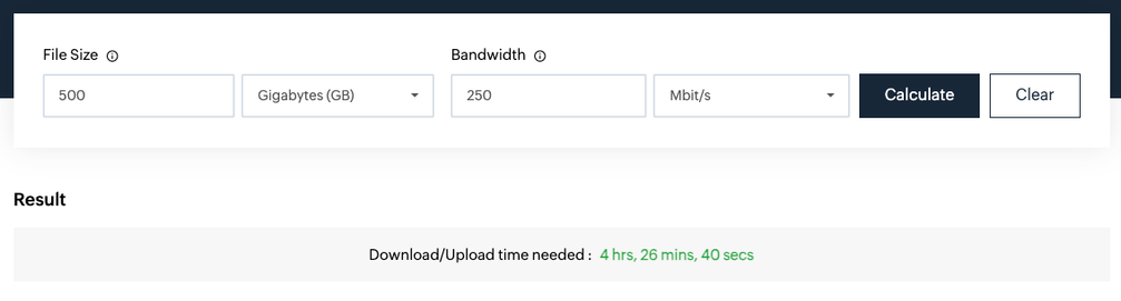

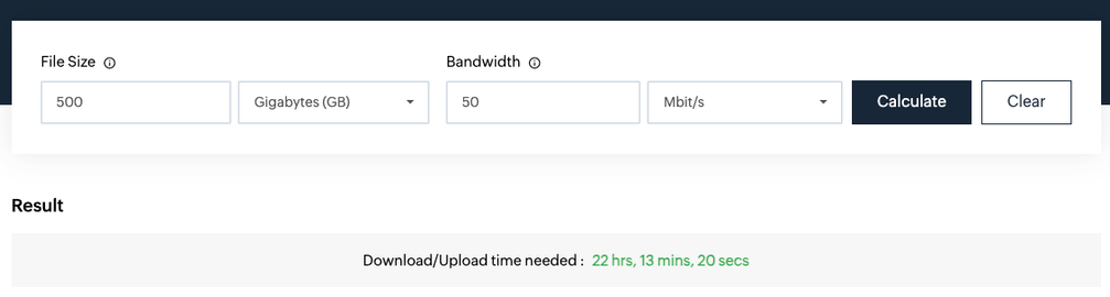

A quick calculator for this can be found here: Free Download/Upload Time Calculator | Site24x7 Tools
This will not be 100% correct, as there are many other factors involved in uploading to the internet, these can be:
  • The specified upload speed (bandwidth) below in screenshots 50Mbit/s and 250Mbit/s are most of the time shared with other servers on your network.
  • Disk performance. If the disks are slow.
  • Other overhead on the network speed like meta data traffic from the Storage Provider.
  • some examples can be found here:

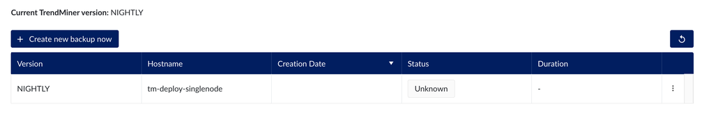

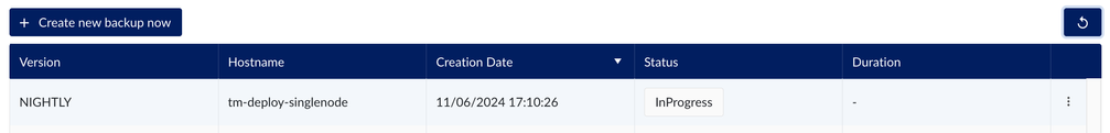

Creation of a backup

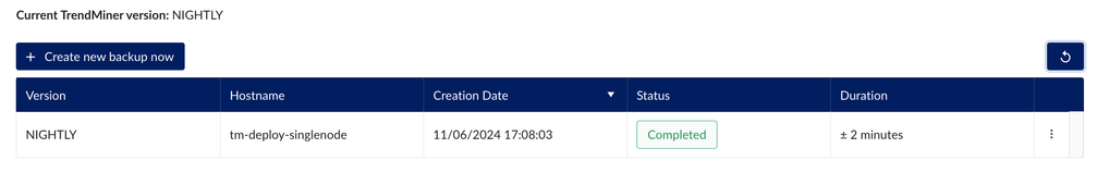

Click on “Create new backup now”
You will see a notification popup in the bottom right corner, that a backup is started.
and you will also see the backup information been triggered, as following:
Validating backup status
Click the refresh button
You can see the backup is in progress
after some time, you will see the status change to “Completed” and you can see the time it took, to make the backup.
In case something went wrong here, you will see a error “Partially Failed”. In case this happens, please reach-out to TrendMiner Support

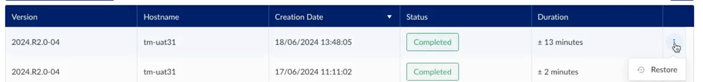

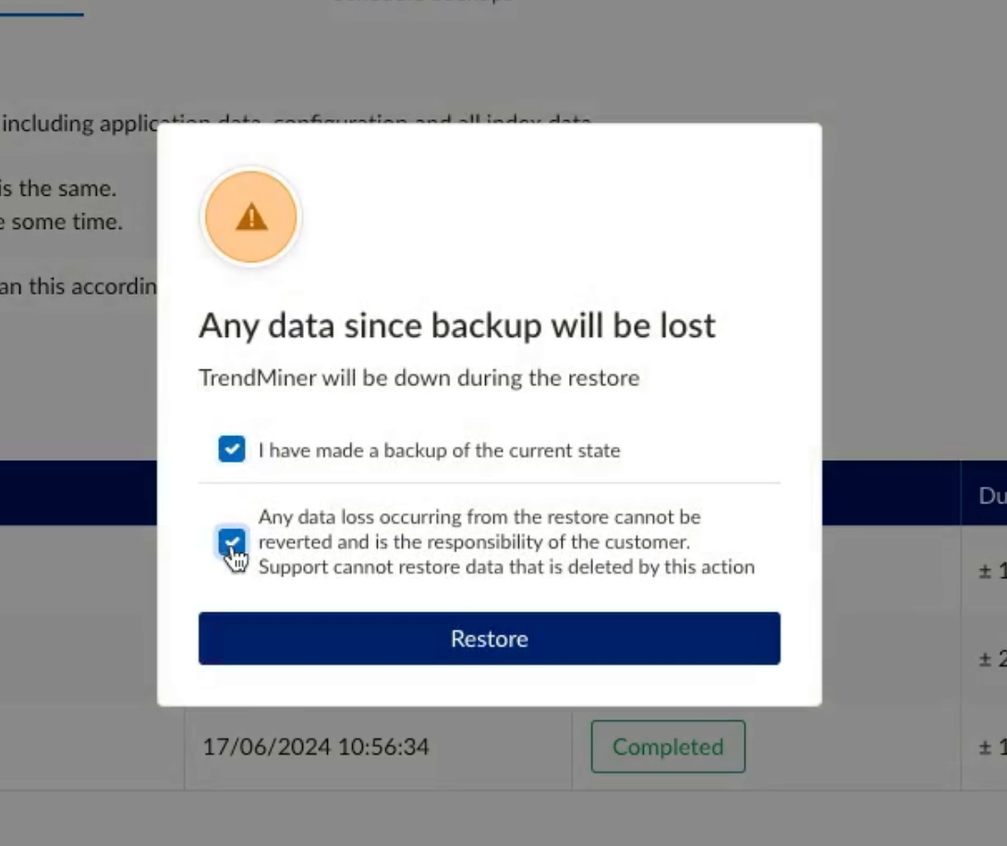

Initiating a Restore
Click on Backup & Restore tab, and you should see the backups taken from the source server here, as in the example below:
To initiate the restore, click on the 3 dots on the line of the backup you want to restore and then click on Restore:
A popup window will show, warning you about the impact of this restore
As mentioned in the prerequisites, you shall have already taken a backup of the current state using VM snapshot tools.
Click on Restore
Danger
Remember that the restore will wipe any existing data and configurations, and restores it back from the backup.

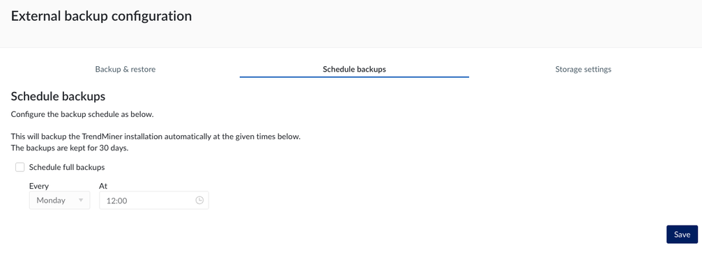

Using Scheduled Backups
Generic information
Scheduled backups are there to take on frequency based a backup of your TrendMiner installation, without the need to manually trigger it.
Currently we only support weekly backups for which the desired week day and time can be specified.
The taken backups, are always increments from the last full backup. This will also save storage space on the remote storage provider.

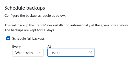

Setup the scheduling
Under the menu Backup and Restore → Remote click on “Scheduled backups”
Enable the checkbox “Schedule full backups” and select the day of the week and time, when backups need to be taken.
  • its advised to pick a time, when TrendMiner is less used, as this might bring some downgraded performance during the time of the backup. Especially if the changes between every backup are big.
  • Scheduled backups normally take a limited amount of time. Therefore they will timeout after 4h. Its advised to take a manual full backup initially, to avoid timeouts for your scheduled backups.
Scheduled backups will show up under backup & restore when they are completed.
