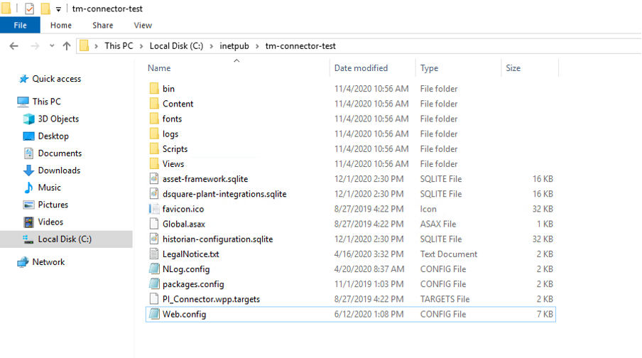

- Download the Plant Integrations installation file - <trendminer-hc-X.Y.Z.zip>from the TrendMiner download site.
- Before starting the upgrade, make a copy of your Plant Integration folder as a backup. This folder is usually located at C:\inetpub\PlantIntegrations. - Important- Each time the connector is updated a new Web.config file is installed, and the previous settings are lost, which might result in unexpected behavior in TrendMiner. We therefore strongly encourage to keep a list of overridden settings and edit the config file again manually after updating the connector. - Replacing the new Web.config with a backup of an old version is not recommended as the new Web.config might contain new parameters which are not present in previous versions. - More information on the connector configuration file can be found here . - Important- When a connector backup needs to be restored, only copy the files within the main directory (e.g. "PlantIntegrations"). Never overwrite the directory itself. Overwriting the directory will clear all configured permissions on the directory which will prevent you from updating data sources or making changes to configuration from the TrendMiner application. - In the ConfigHub UI this can be recognized by the data source errors - 500 Internal Server Erroror- Failed Error on remote service - HttpCode: '500'or- Access denied- To reset the permissions you can follow the instructions listed in the connector installation guide.
