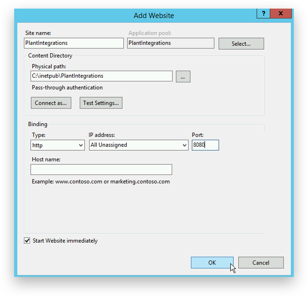

- Start the IIS Manager and 'AddWebsite'
- Complete the form as directed: - Provide the website a readable name.
- Create and select a path to store the Plant Integrations files.
- Choose a port for communication between TrendMiner and Plant Integrations.
 - Ensure that the chosen port is accessible from the TrendMiner application. Open the port in Windows Firewall and any other networking devices. - Click 'OK'

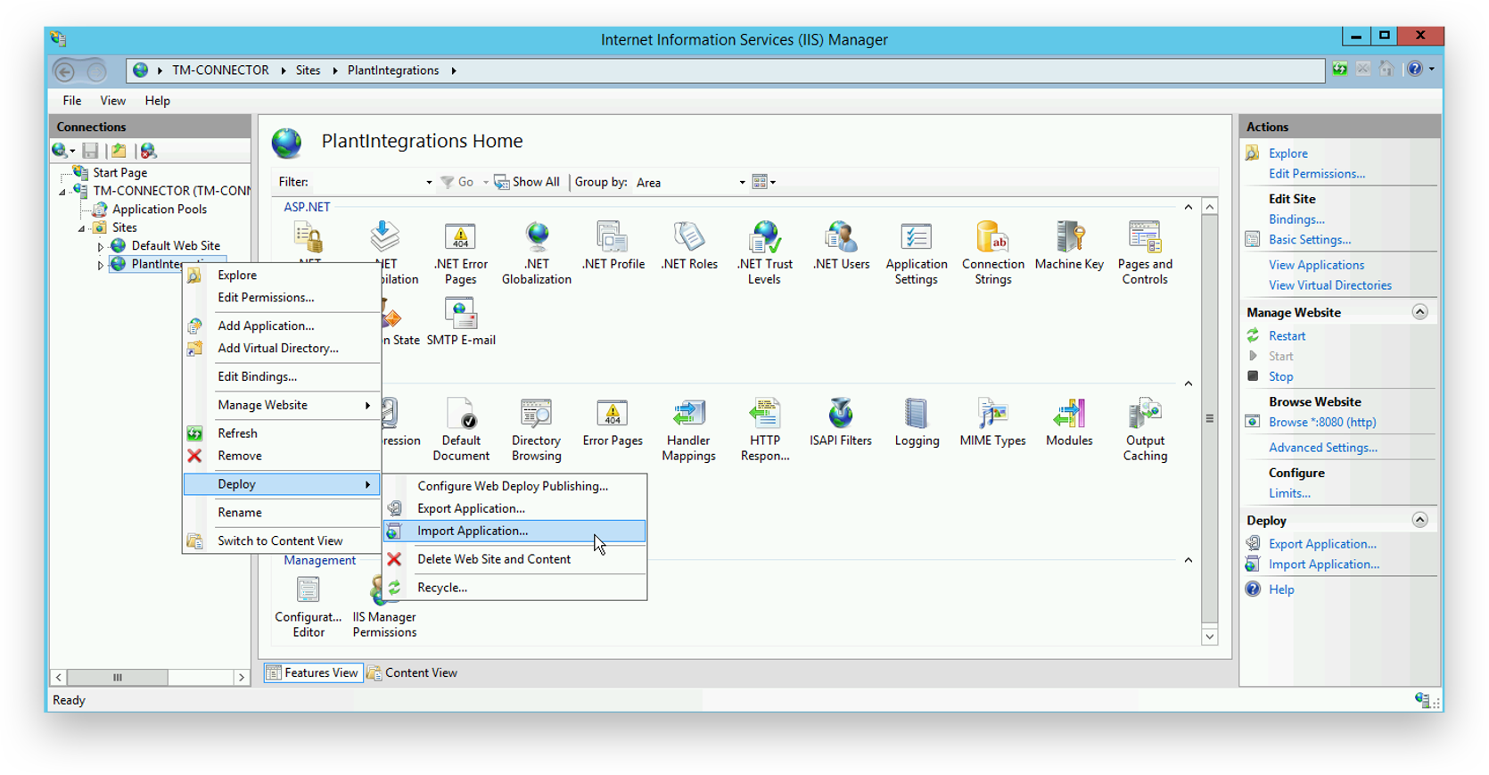

- Right click on the newly created site and choose 'Deploy’ - ‘Import Application'. - Note- If the 'Deploy' option is not available, please go back and: - verify all roles and features have been correctly selected during installation
- verify Web Deploy is installed correctly. If it was already installed, please do the installation again and make sure to restart the server after the installation.

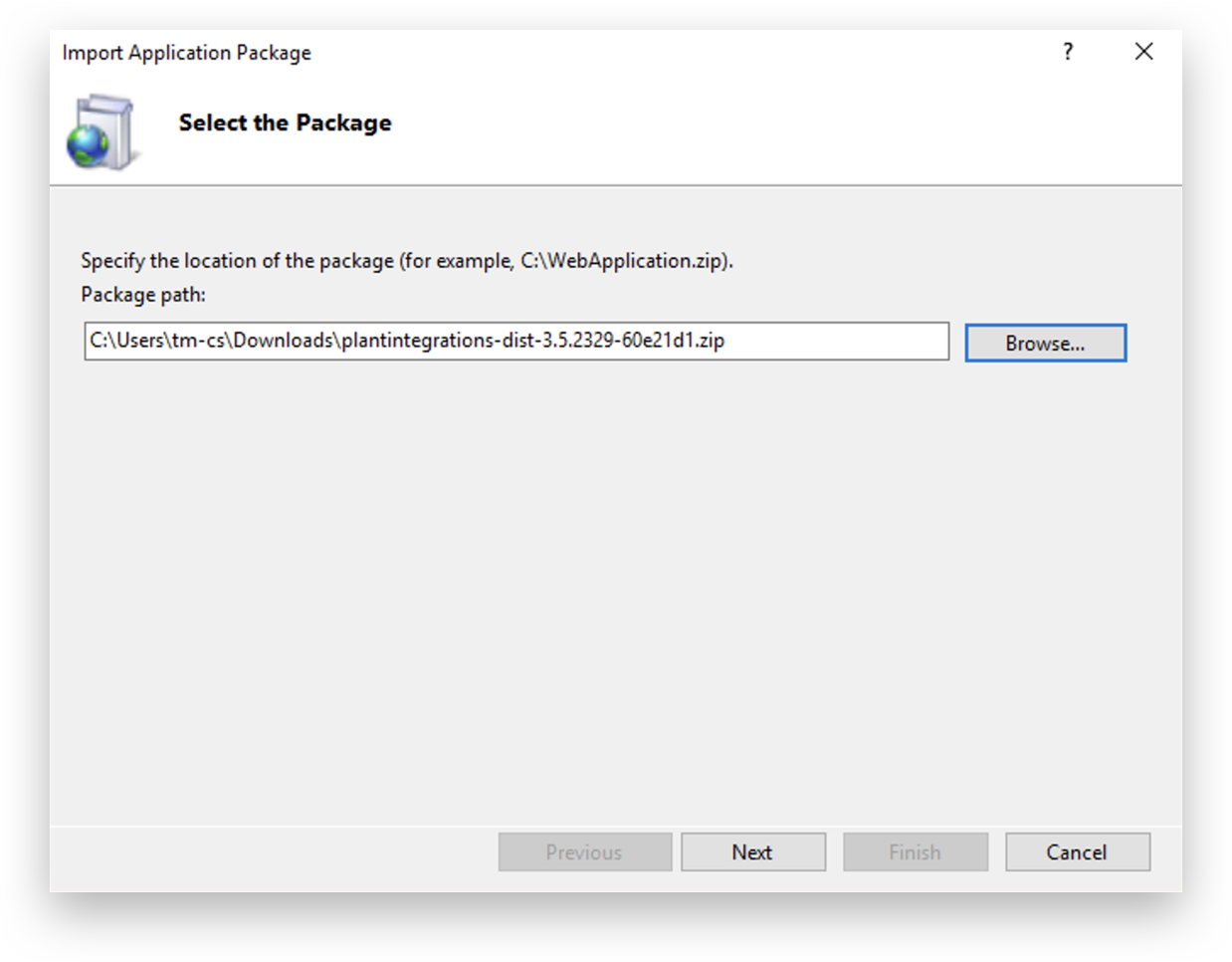

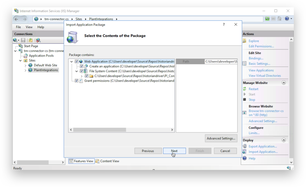

- Select the TrendMiner Plant Integrations zip archive and click 'Next'.

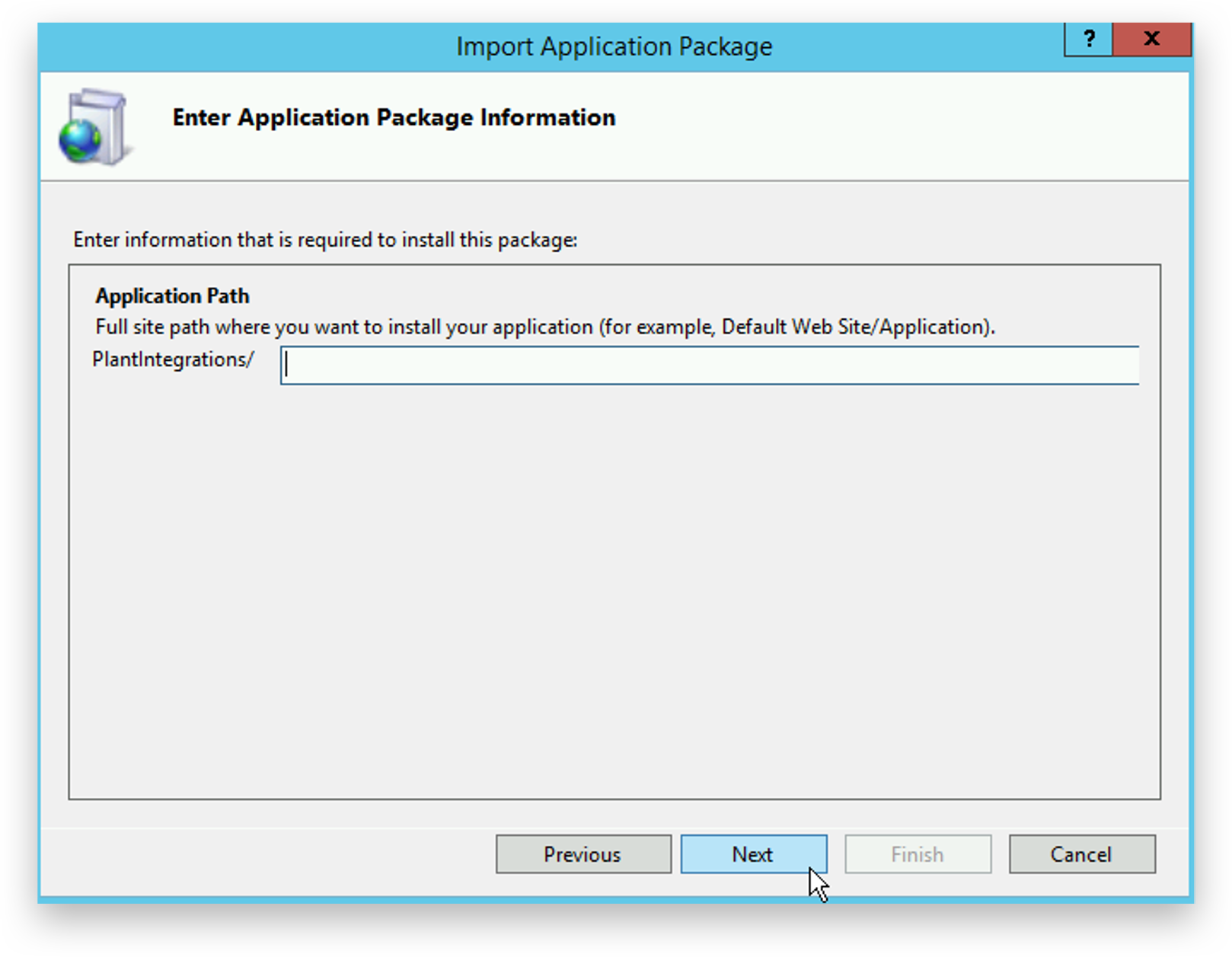

- Click 'Next'.
- Remove the autocomplete path of HC and click 'Next'.

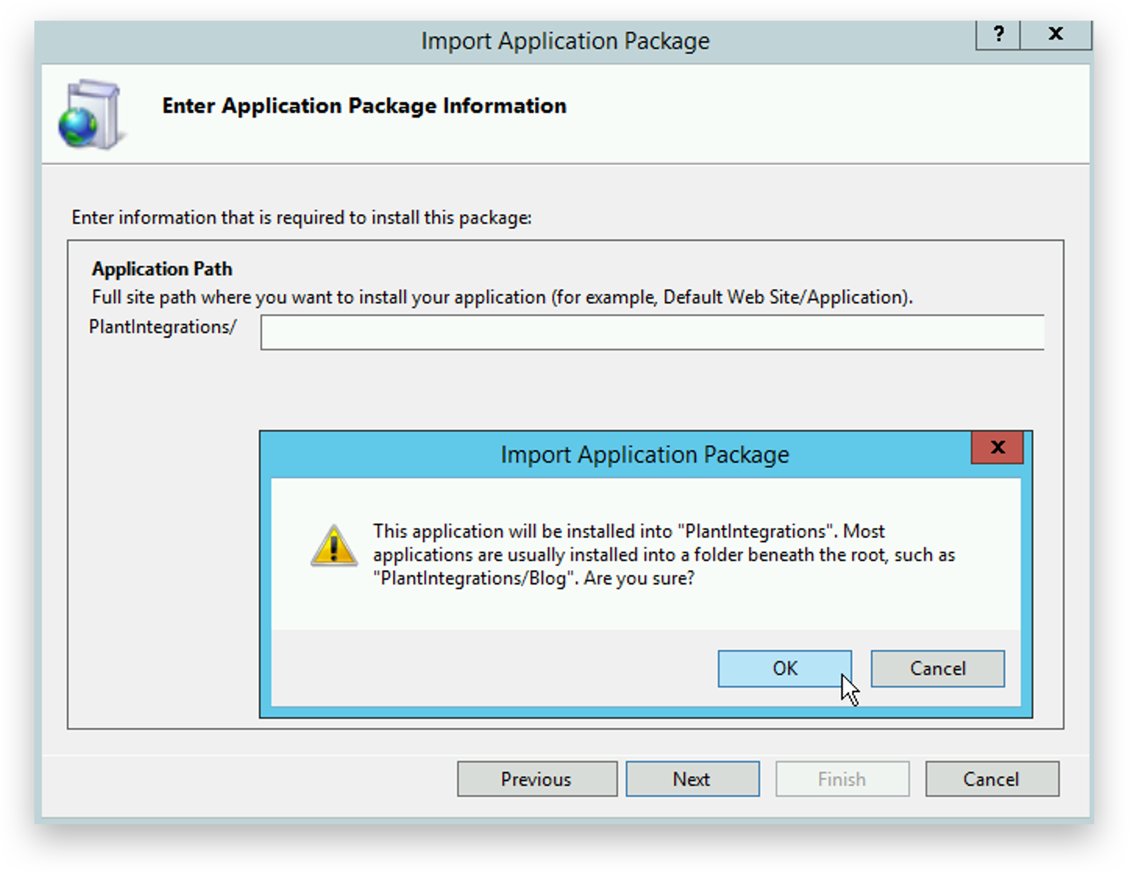

- Click 'OK' to continue. If this error message does not appear, go back to the previous step.

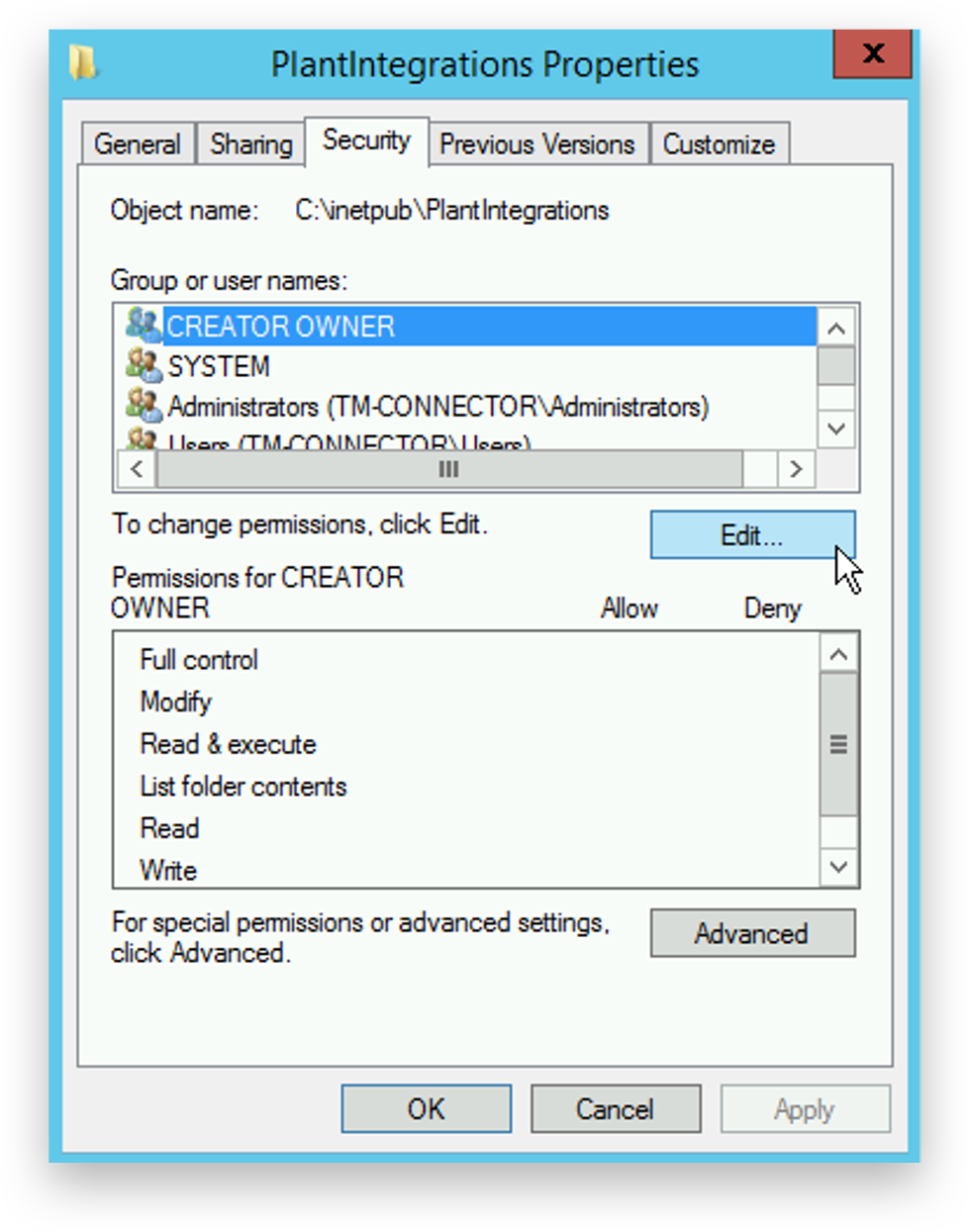

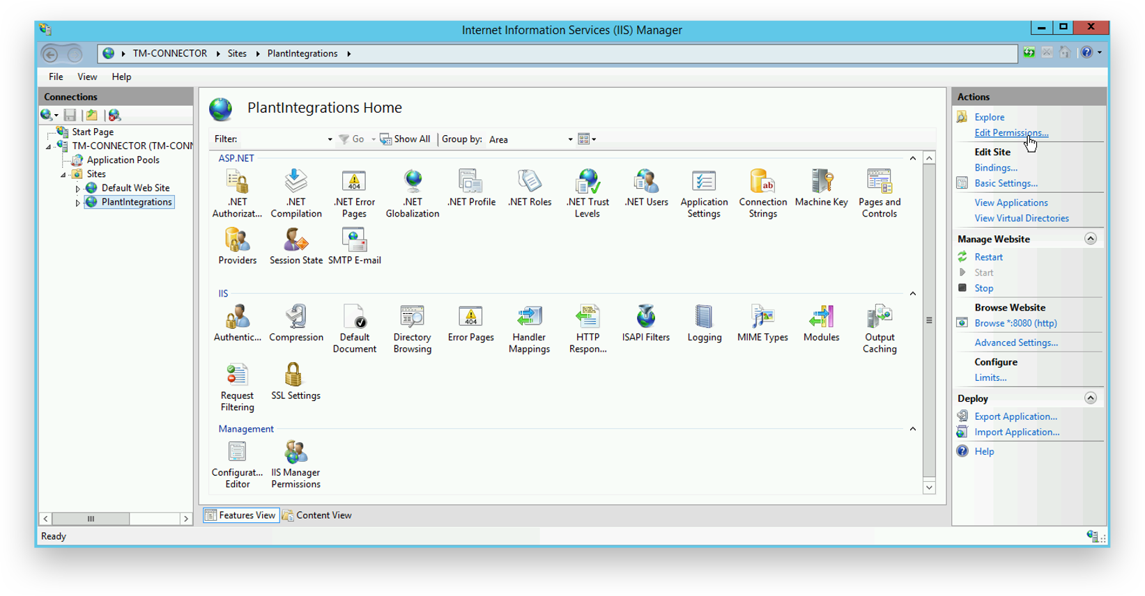

- Edit the permissions of the newly created site.
- Click 'Edit'.

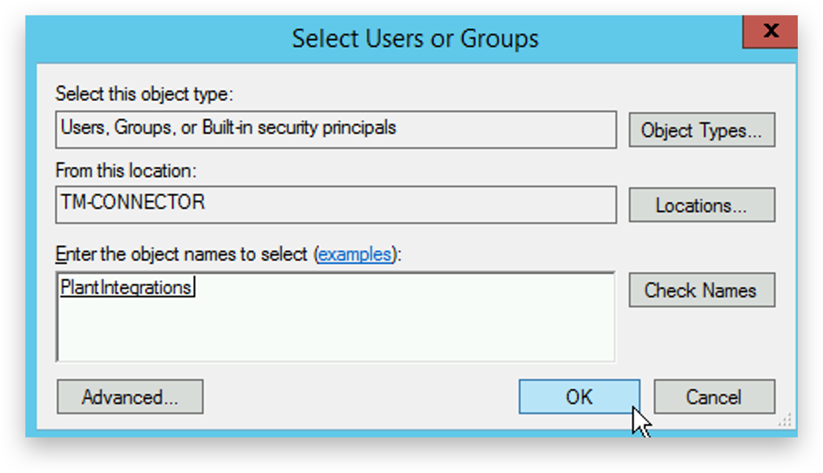

- Click 'Add'.

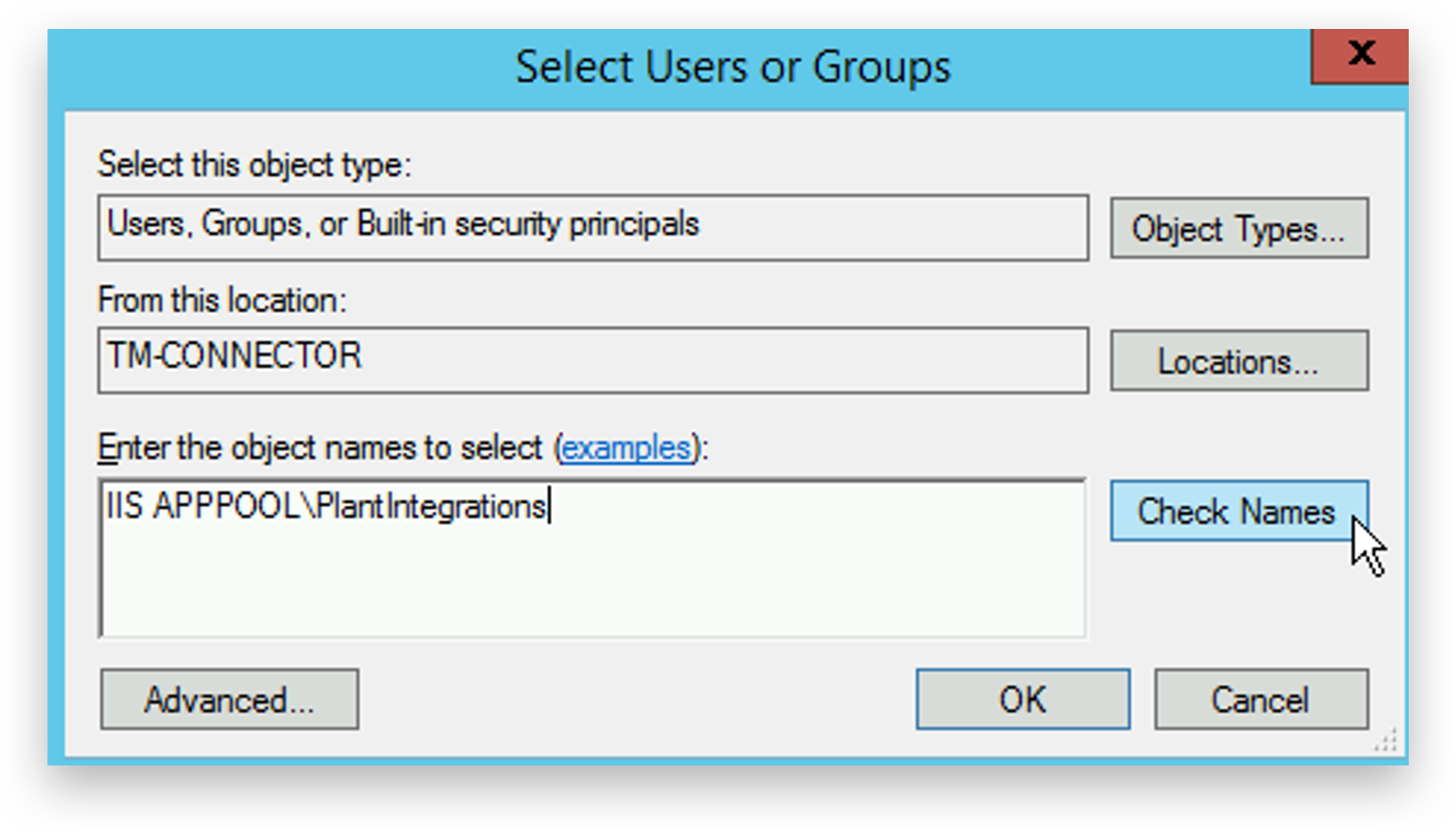

- Ensure the location is the current server. If this is a domain, select the current server in 'Locations'. Type IIS APPPOOL\<pool name> and click 'Check Names'.
- Click 'OK'.

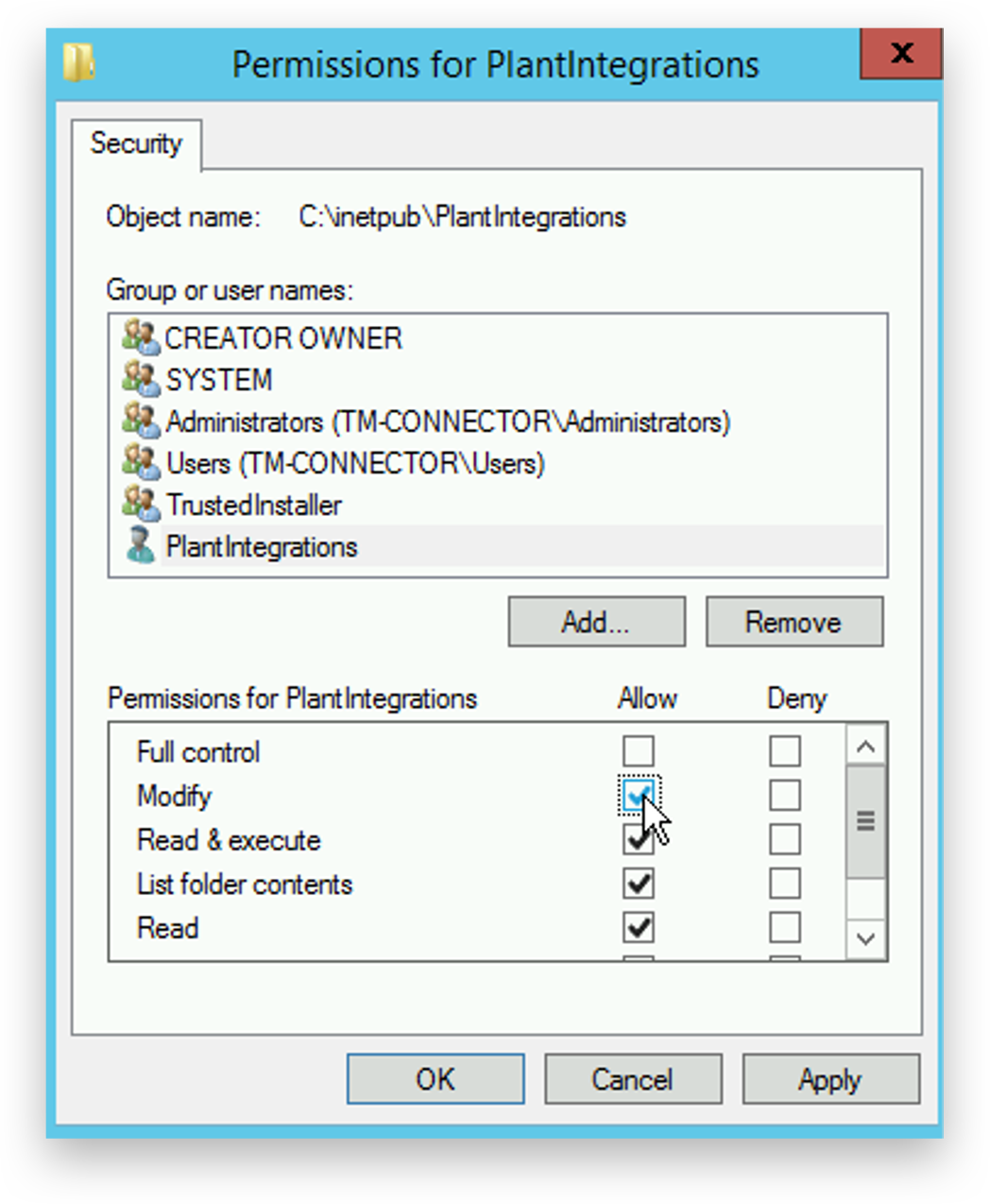

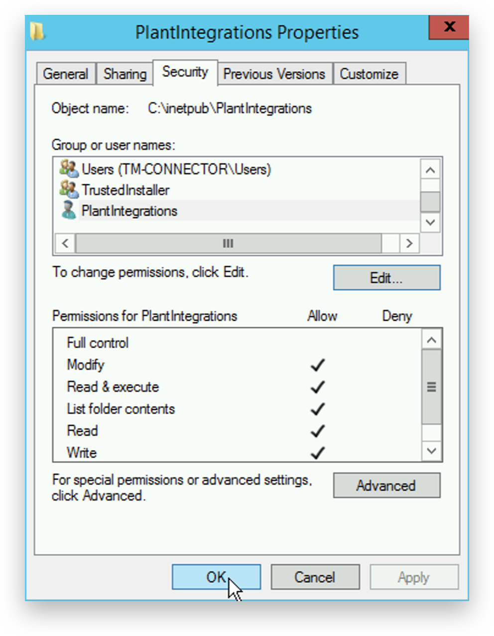

- Give the new user 'Modify' permissions.
- Click 'OK'.
- Accept the new settings by clicking 'OK'.
