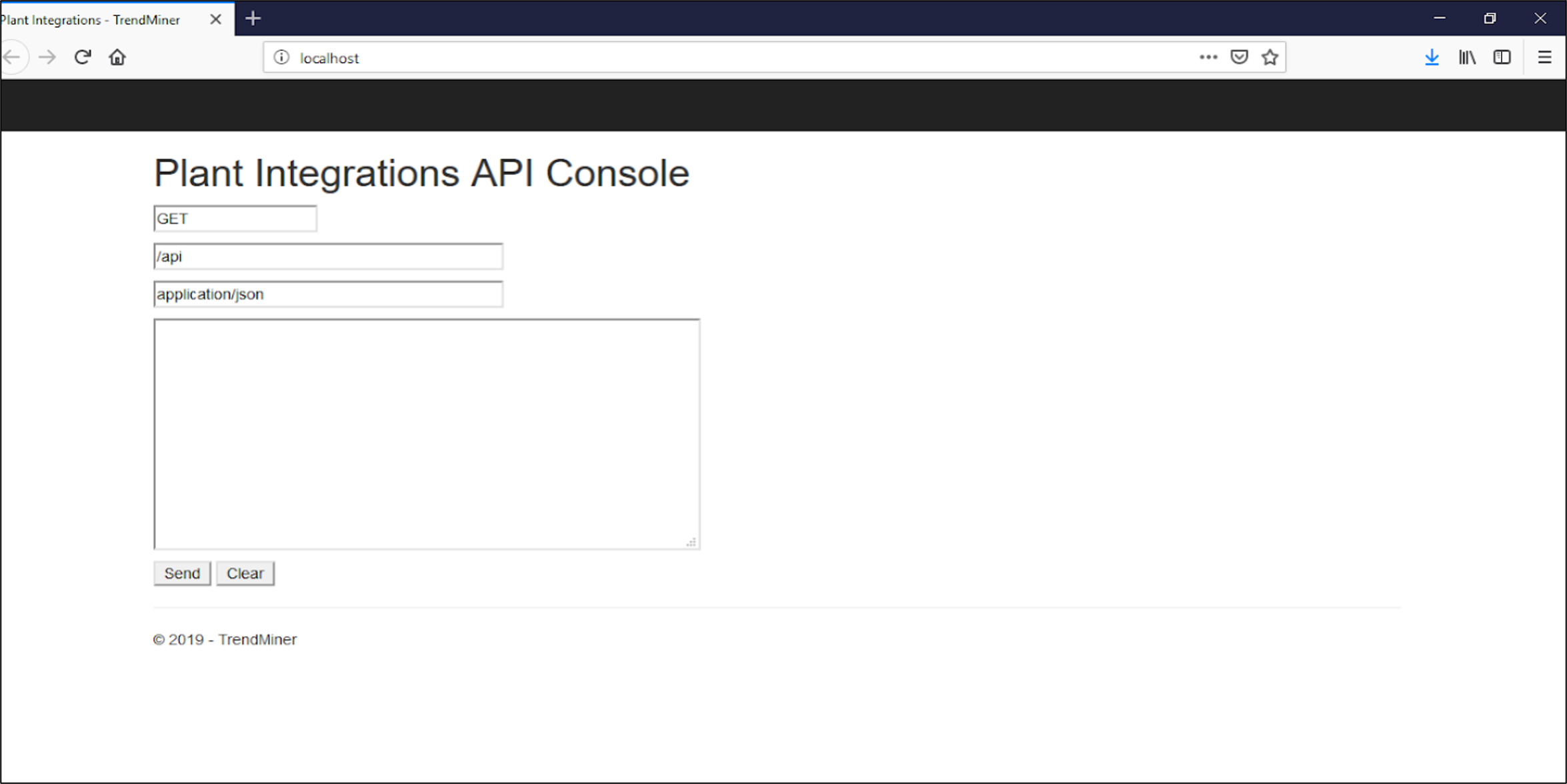

- Browse to the local server at the configured port to validate the Plant Integrations update.

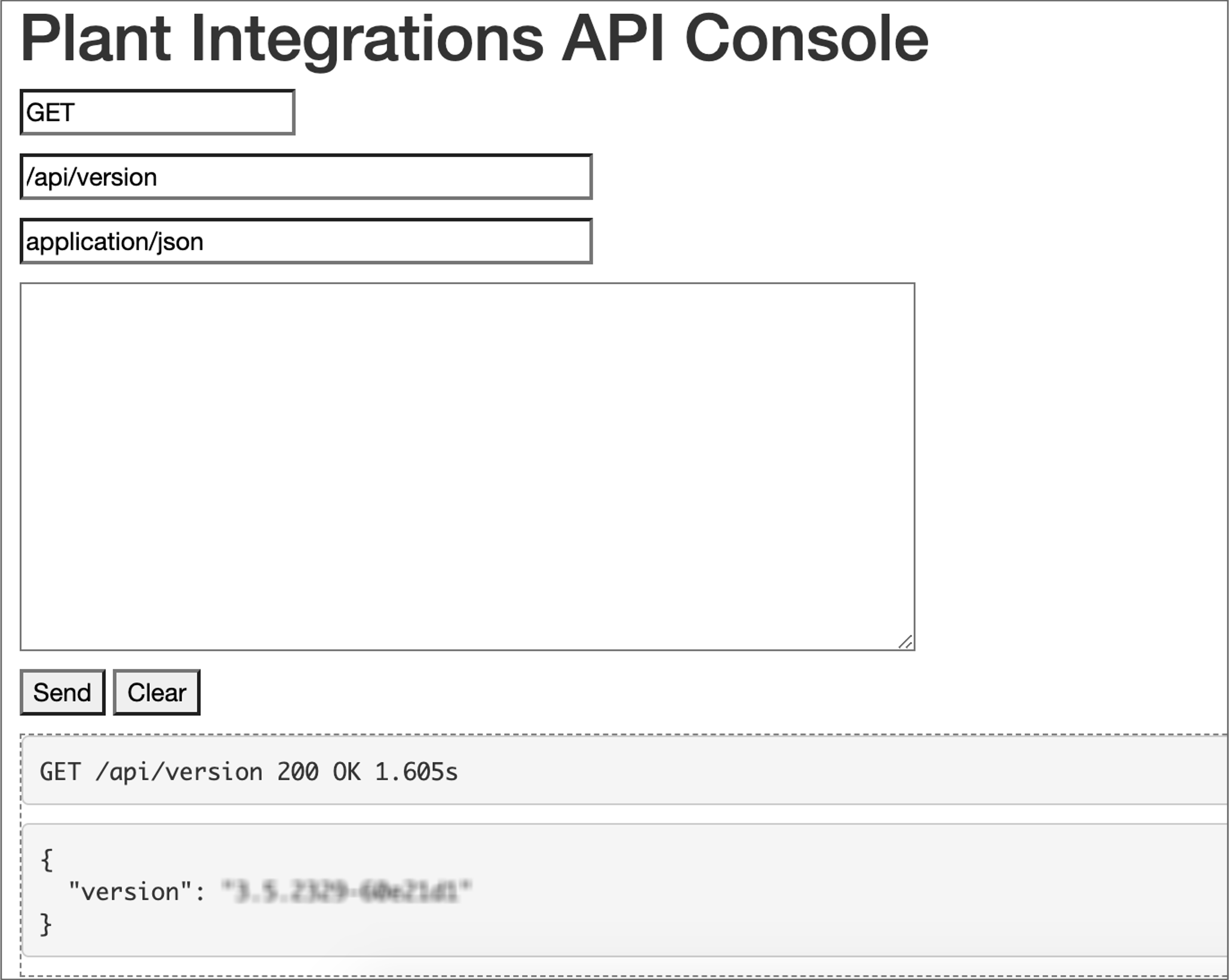

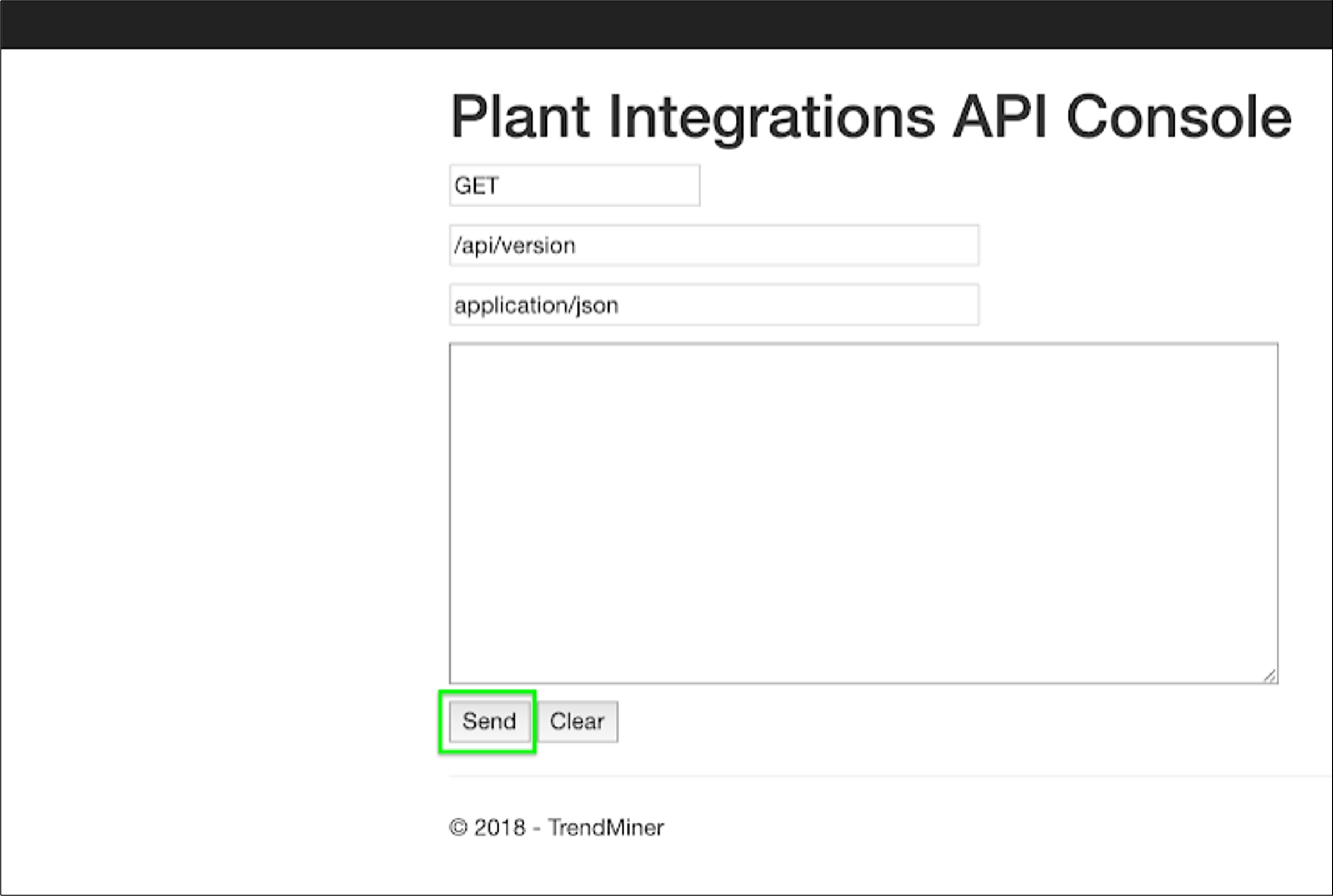

- To validate the Plant Integration version, run the following API call in the Plant Integration console. Type ‘/api/version’ without the quotation marks in the second box and click ‘Send’.
- The above API GET method should return the updated version of Plant Integrations.

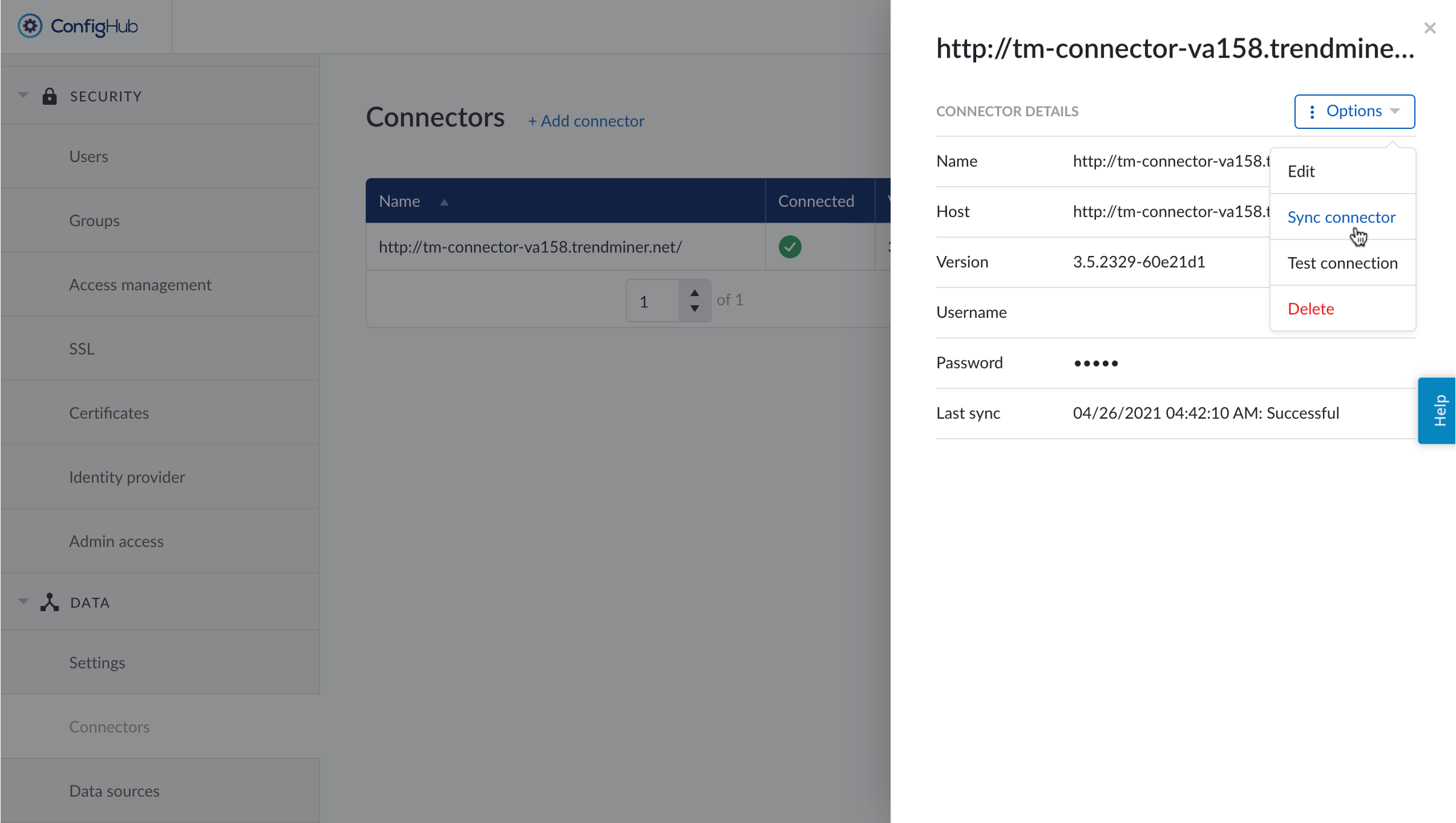

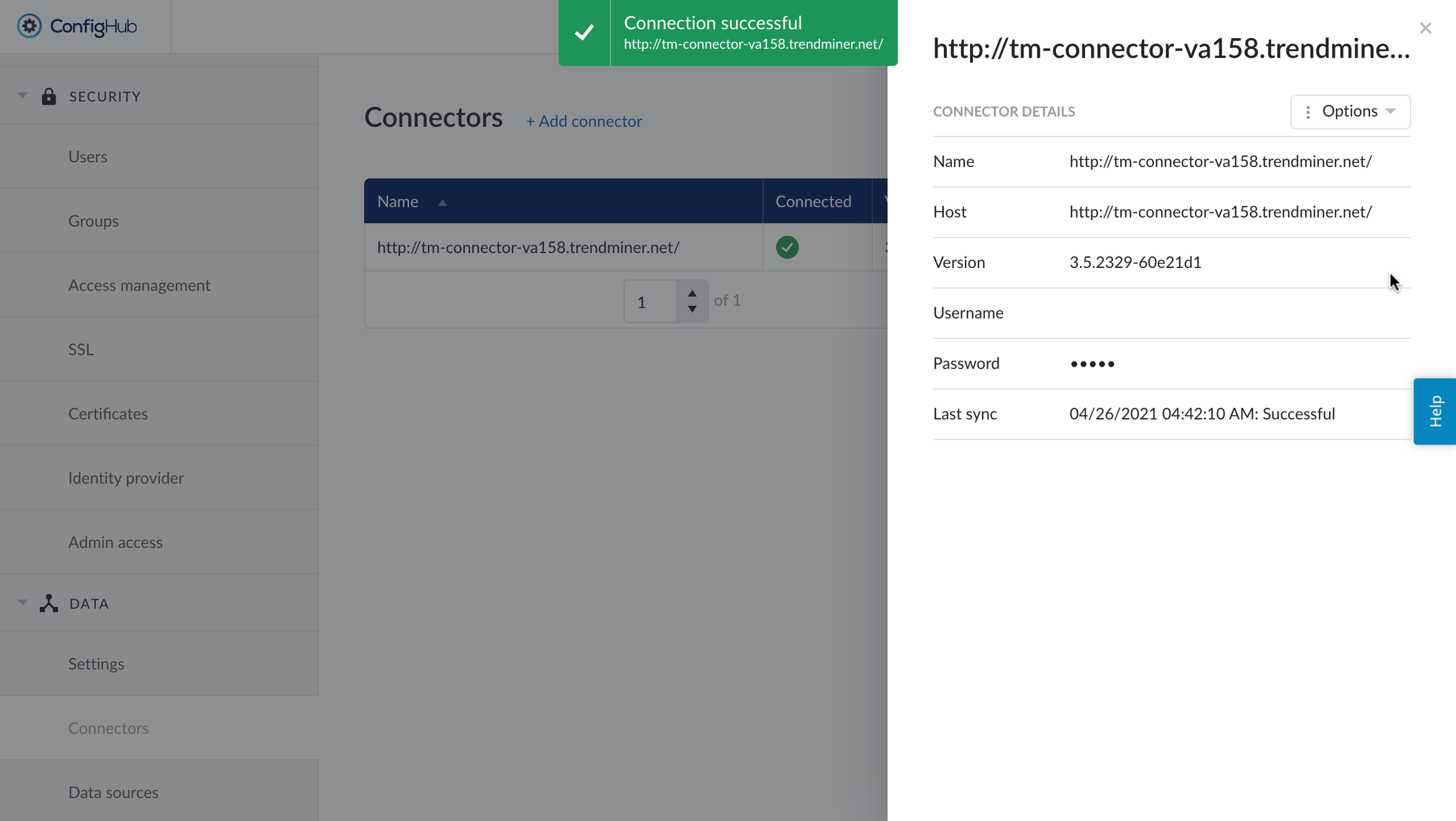

- Log in to ConfigHub by browsing to ‘http://<trendminer_address>/confighub/’. Go to the Data>>Connectors section and click on the upgraded connector line. Click on 'Option' dropdown and sync connector. After sync is completed, make sure the upgraded connector version is showing correctly.

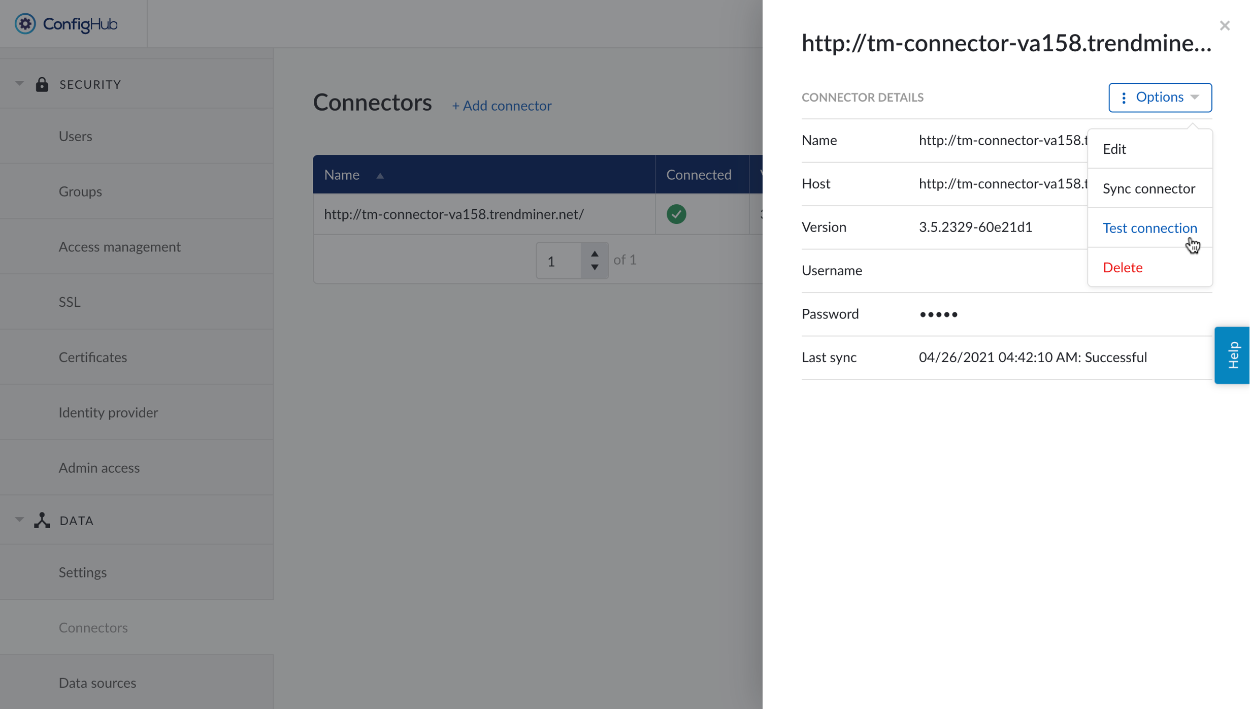

- Also, test connection to the connector.
- A green message at the top of the screen will say 'Connection successful'.

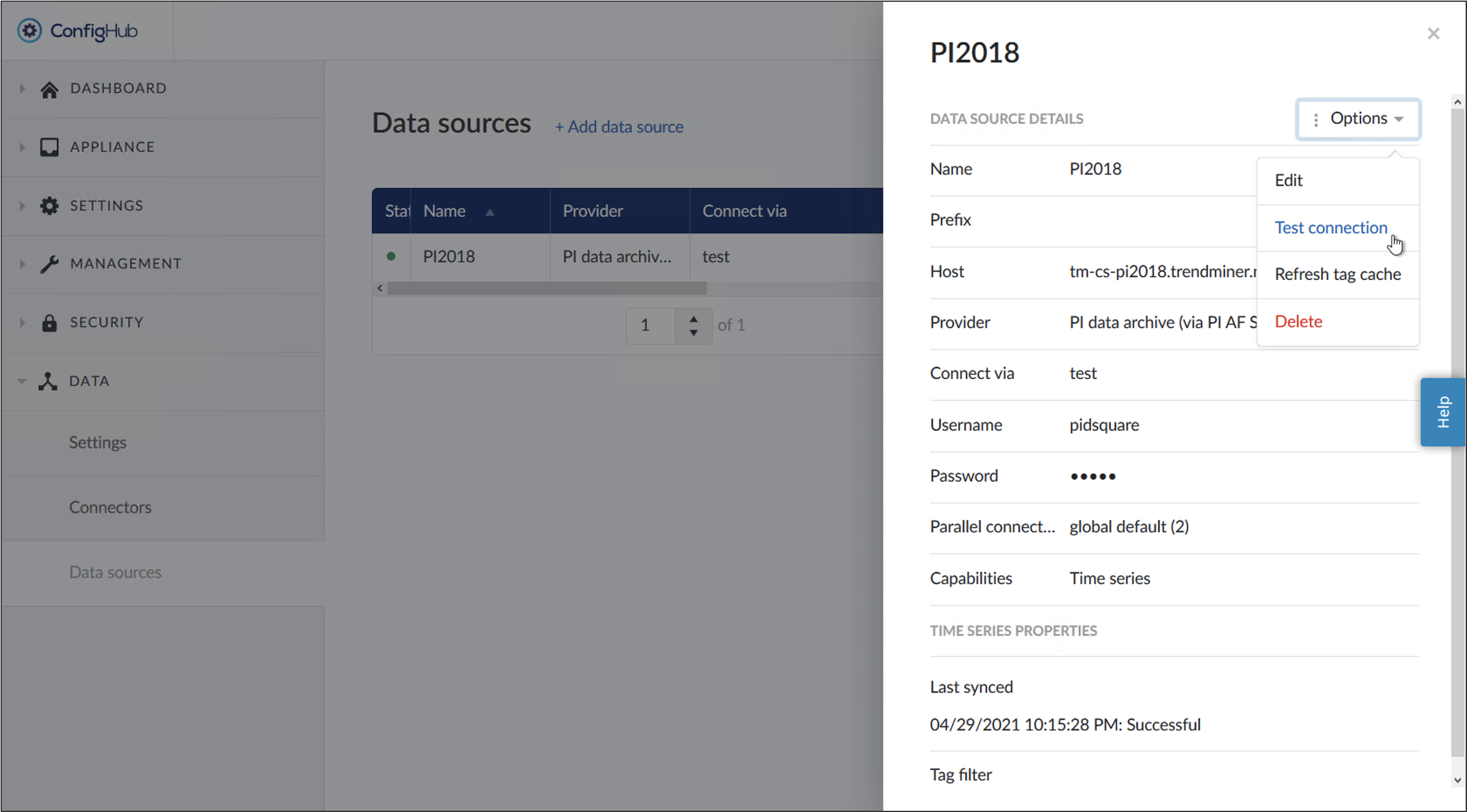

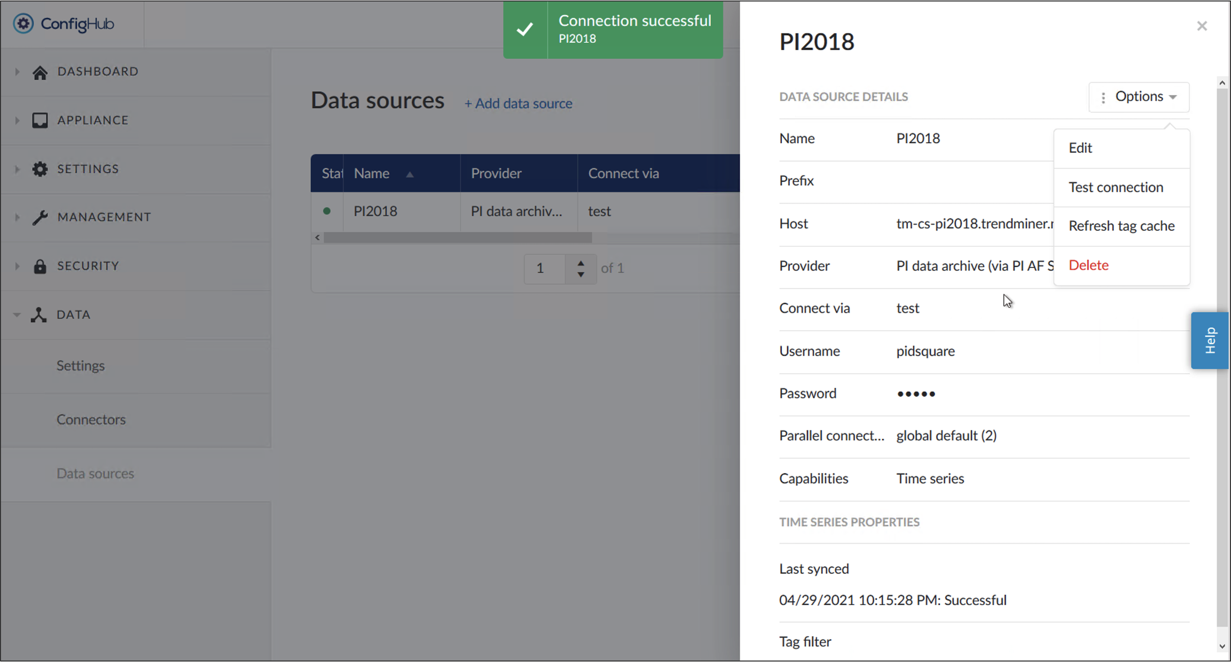

- As a final validation, you can test connection to each data source connected via an upgraded connector.
- A green message at the top of the screen will say 'Connection successful <datasource_name>'. This will conclude that the connection between the TrendMiner server and the Data Sources from an upgraded connector is healthy. You can now proceed with the TrendMiner server upgrade.
