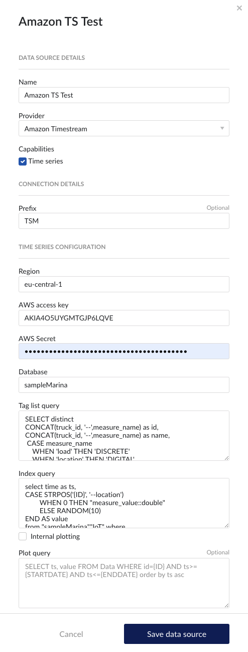

To add an Amazon Timestream data source, in ConfigHub go to Data in the left side menu, then Data sources, choose + Add data source.
Type name of data source, select “Amazon Timestream” from the Provider dropdown. Selecting the capabilities for the data source with the given checkboxes will open additional properties to enter, grouped in following sections:
  • Connection details – lists properties related to the configuration of the connection that will be established with Amazon Timestream.
  • Time series configuration – lists properties relevant for the timeseries data.
  • "Region" – enter the availability zone region within AWS cloud in which the Amazon Timestream instance is configured. For more information, please consult the AWS Documentation.
  • "AWS access key" – enter the access key to authenticate. This is the access key id as created in AWS IAM. For more information, please consult the AWS Documentation.
  • "AWS Secret" – enter the secret to authenticate. This is the AWS secret as created in AWS IAM. For more information, please consult the AWS Documentation.
  • “Database” – enter the name of database in Amazon Timestream. This is primarily used to test the connection liveness from TrendMiner to Amazon Timestream.
