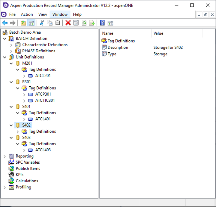

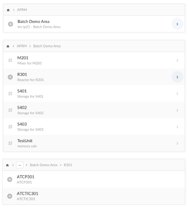

Our provider for Aspen Production Record Manager implements the asset capability and uses data from the area definition to populate the asset hierarchy in TrendMiner. The root node of the asset hierarchy is the area itself. The children nodes of an area node are created using “Unit Definitions". The “Tag Definitions“ are the children of the unit nodes, and the leaf nodes of the asset hierarchy. The asset hierarchy has a fixed depth of two or three.
Area, Unit and Tag Definitions in Aspen Production Record Manager Administrator
Asset hierarchy in TrendMiner

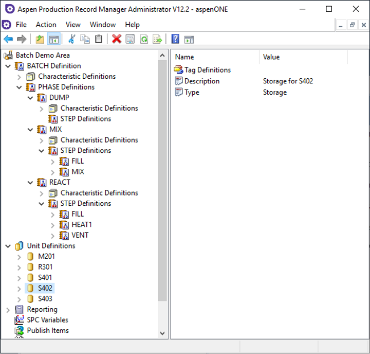

The provider will create Context Item Types for every subbatch definition in the area definition, and that type will be linked to the Context Items.

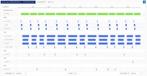

This comes into play when the user starts visualizing multiple subbatch levels at once. Together with the possibility to include the children of a component during filtering it would render the following Gantt, without the users to known which units belong to the area.
Gantt

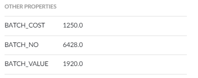

The provider generates Context Item properties based on the numeric Characteristics that are available on the subbatches of Aspen Production Record Manager. Only the numeric characteristics are included as Context Item properties, this is by design.
Since numeric characteristics are decimal values in Aspen Production Record Manager, Context Items properties are also formatted decimal numbers.
Context item properties

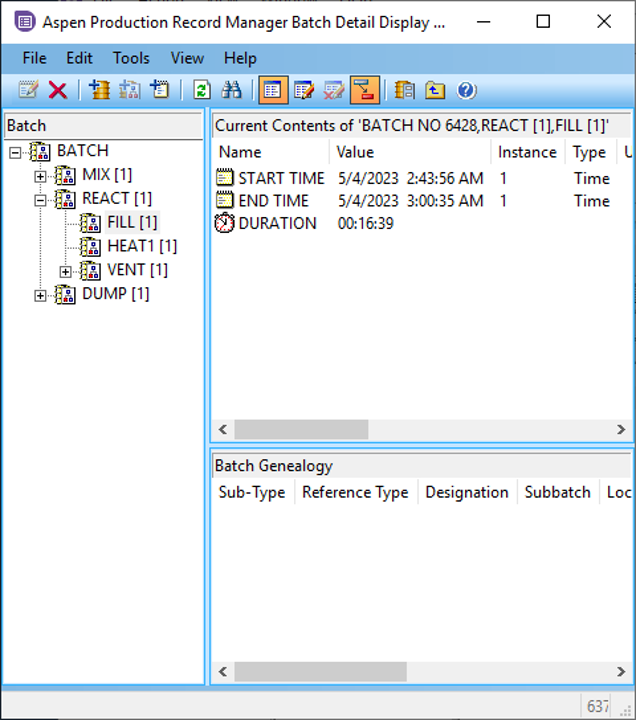

The Start Time, Duration and End Time Characteristics are available as Events. The existence of characteristics and the level on which they are defined is completely dependent on the configuration of the Subbatch Definition implemented on the customer environment.
Batch Detail Tool

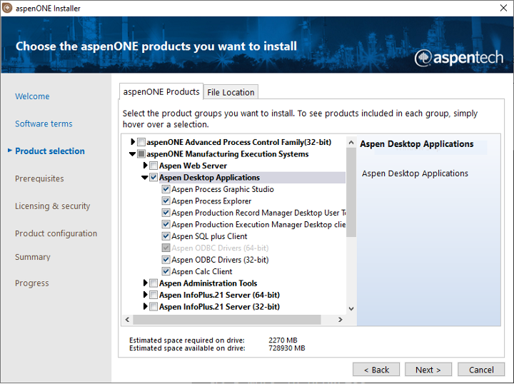

How to deploy?
AtBatch21ApplicationInterface
Plant Integrations must be configured to run under an identity that has access to Aspen Production Record Manager. This user must be a member of the 'Distributed COM Users ’group on Aspen Production Record Manager server.

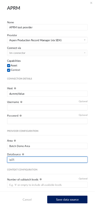

In ConfigHub go to Data in the left side menu, then Data sources, choose + Add data source. Type the name of a data source, select “Aspen Production Record Manager (via SDK)" from Provider dropdown, then select the configured connector from Connect via dropdown.
Provider properties
The APRM provider implements both assets and context capability. These capabilities have two required provider properties to be filled in:
Tableau 4.
Property
Description
Area
The name of the area inside the specified DataSource where the provider reads its data.
DataSource
The data source used by this provider. The AspenTech Production Record Manager can store multiple data sources on one server instance.
