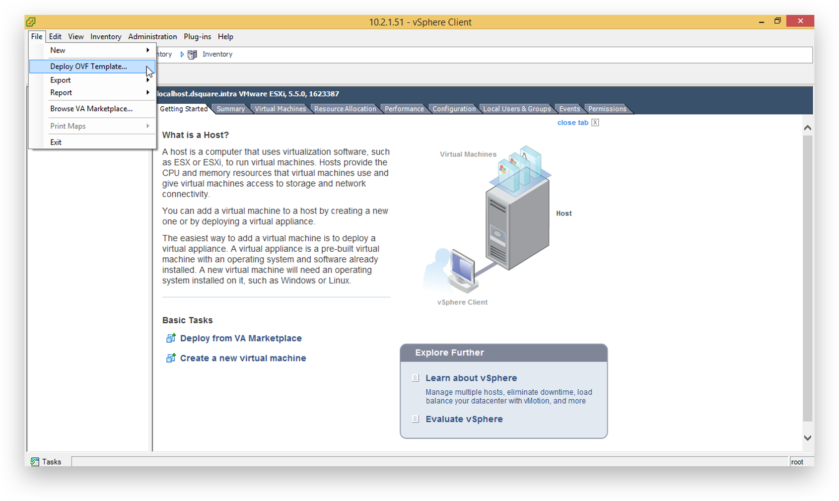

  1. Open the vSphere Client and select ‘Deploy OVF Template…’:

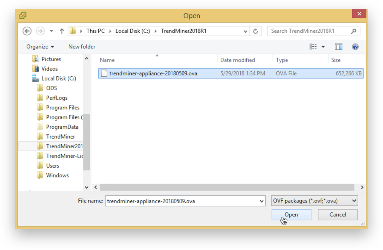

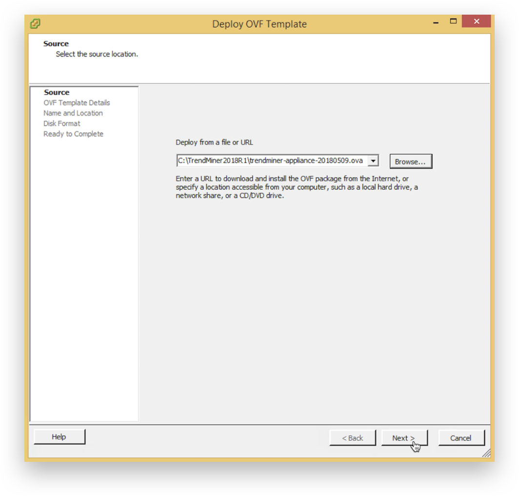

  2. Click ‘Browse’.
  3. Browse to the .ova file downloaded from the TrendMiner download portal, select it and click 'Open', select it and press ‘Open’.
  4. Click ‘Next >’ to accept the image.

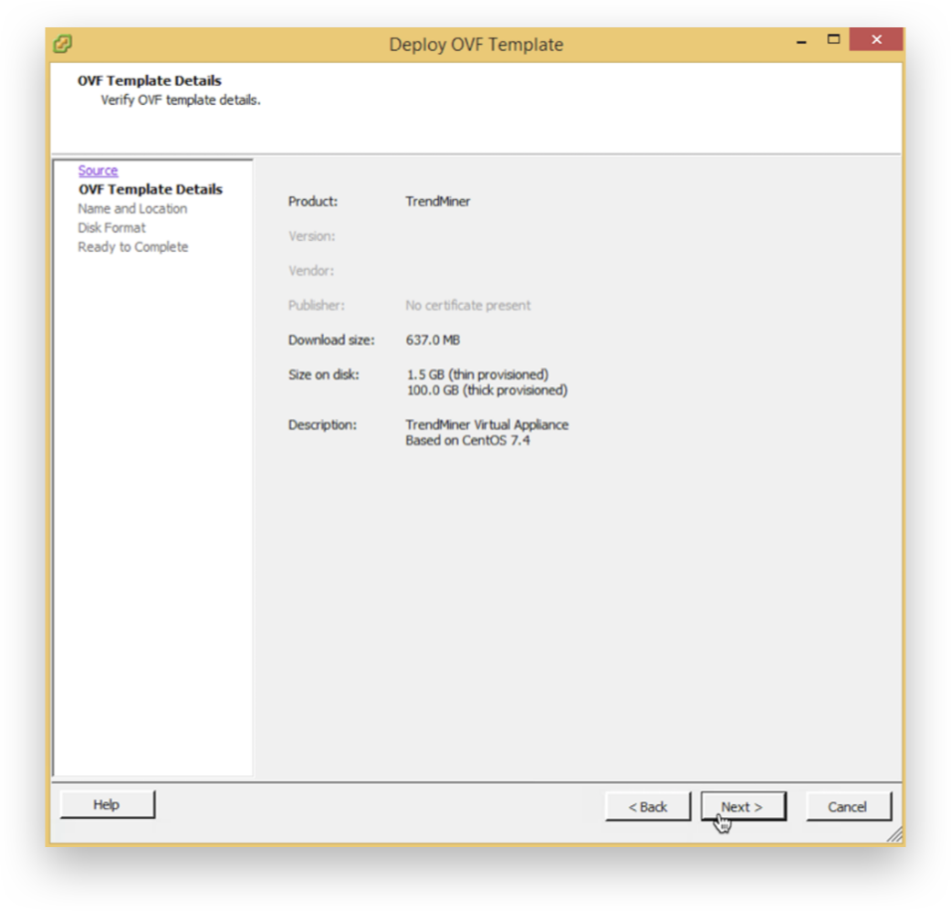

  5. Click ‘Next >’ after validating the template details.

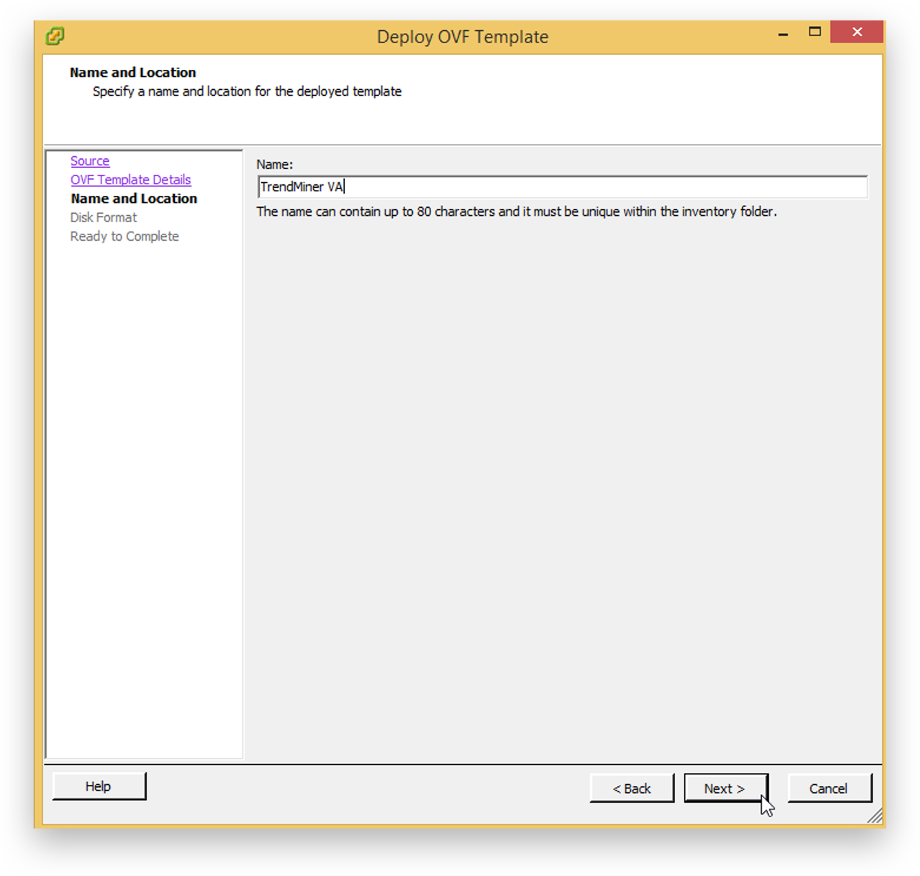

  6. Assign a name to the TrendMiner Virtual Appliance and click ‘Next >’.

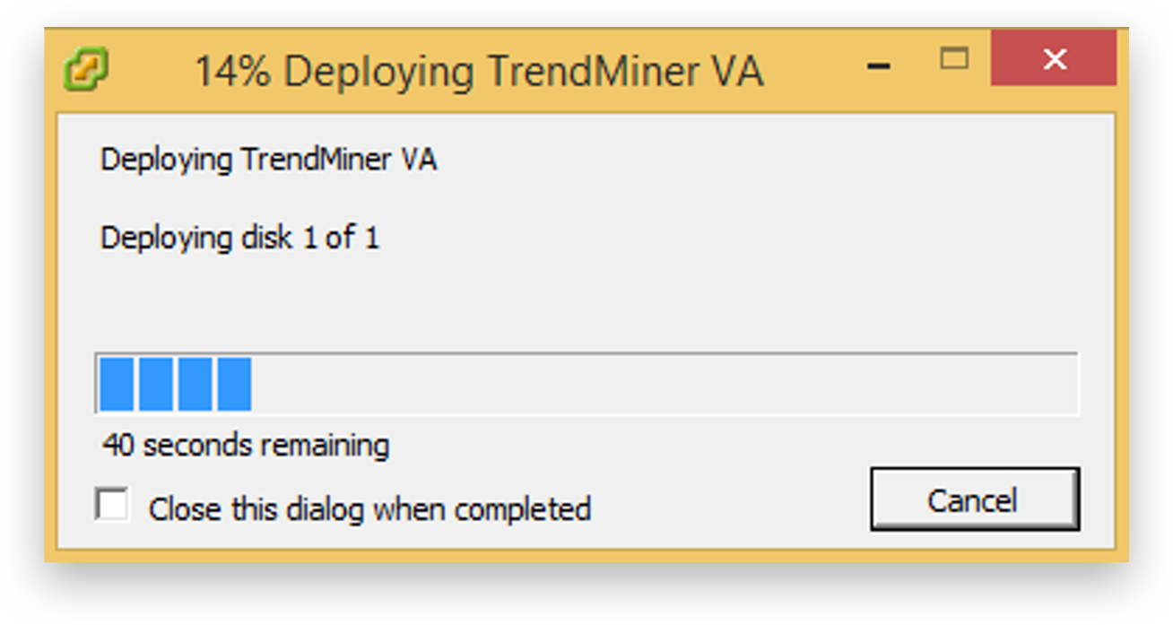

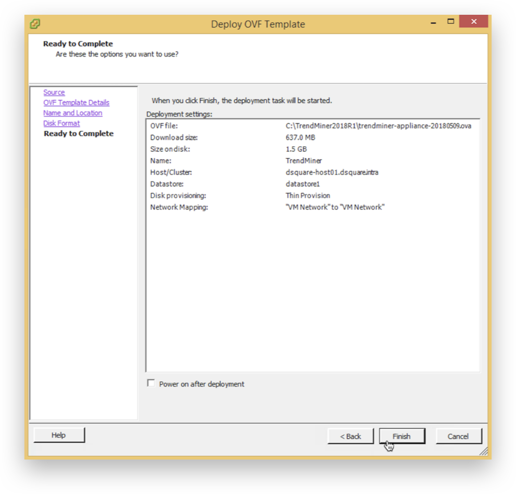

  8. Finish the import wizard to start the image deployment.

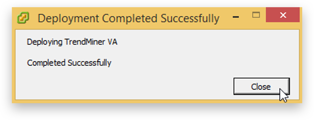

  9. Wait until the deployment finishes and click 'Close'.

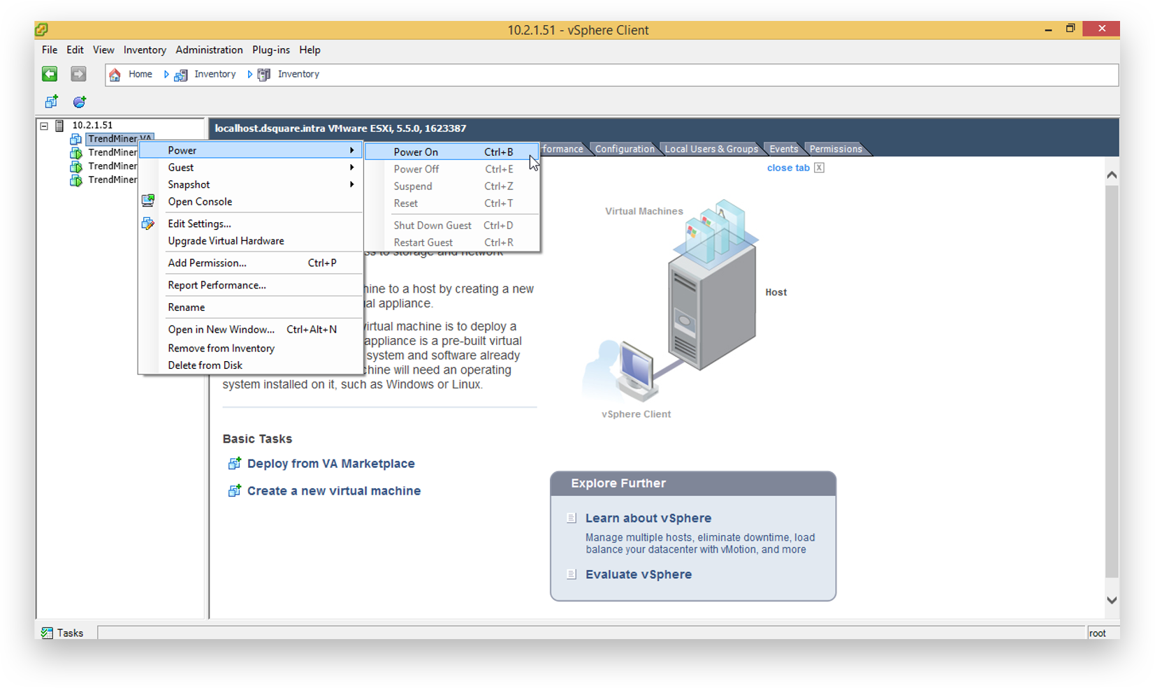

  12. Click ‘Power On’ the machine.

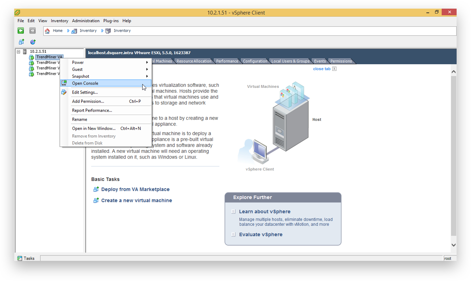

  13. 'Open Console’.
  14. Wait until the Virtual Appliance is started.

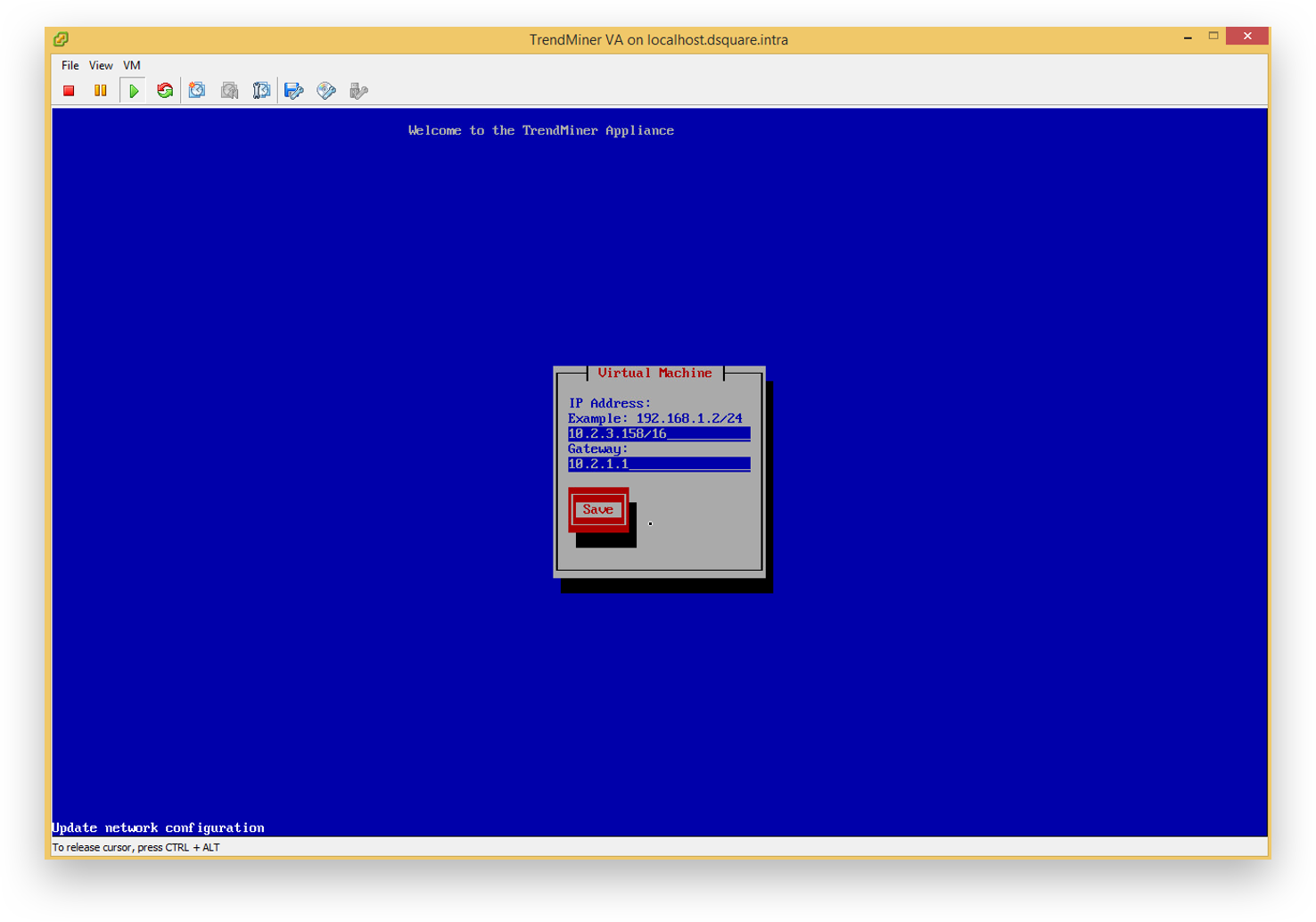

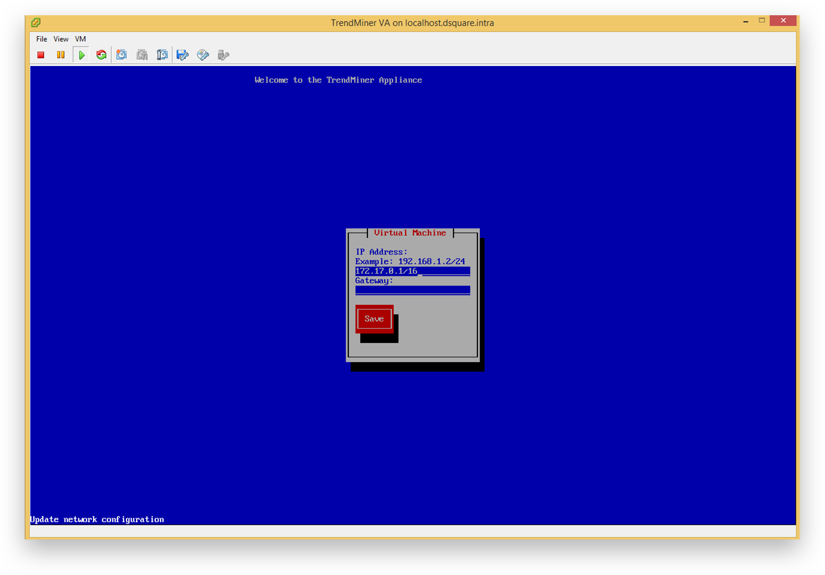

  15. Click inside the console. It will now capture the key inputs. Use the arrow keys to navigate. Provide the IP address/Subnet mask in CIDR notation and gateway address and press ‘Save’.
  16. The text ‘Update network configuration’ will change to ‘Saved’. Exit the console by pressing the correct key combination (CTRL+ALT in this example).
  17. The console can now be closed. Continue to the Network Configuration.
