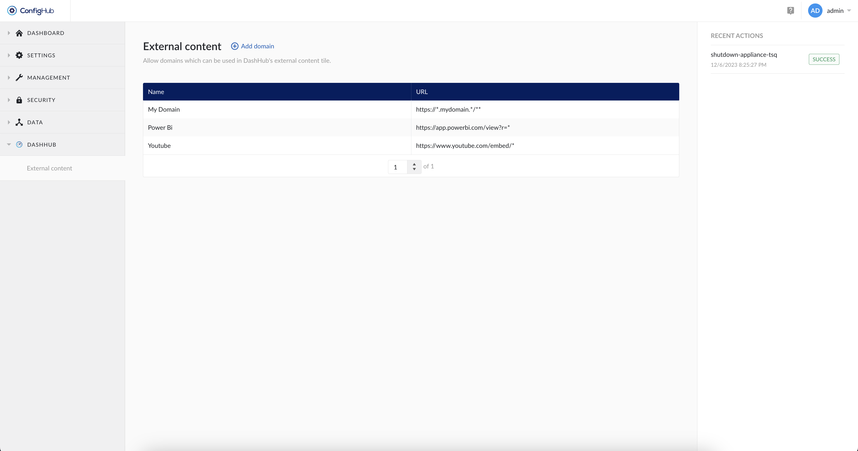

As a system administrator, you can control which external content is allowed to be embedded through the External Content configuration page in External Content. From this page, you can define and manage the list of allowed domains that DashHub users can use in external content tiles.

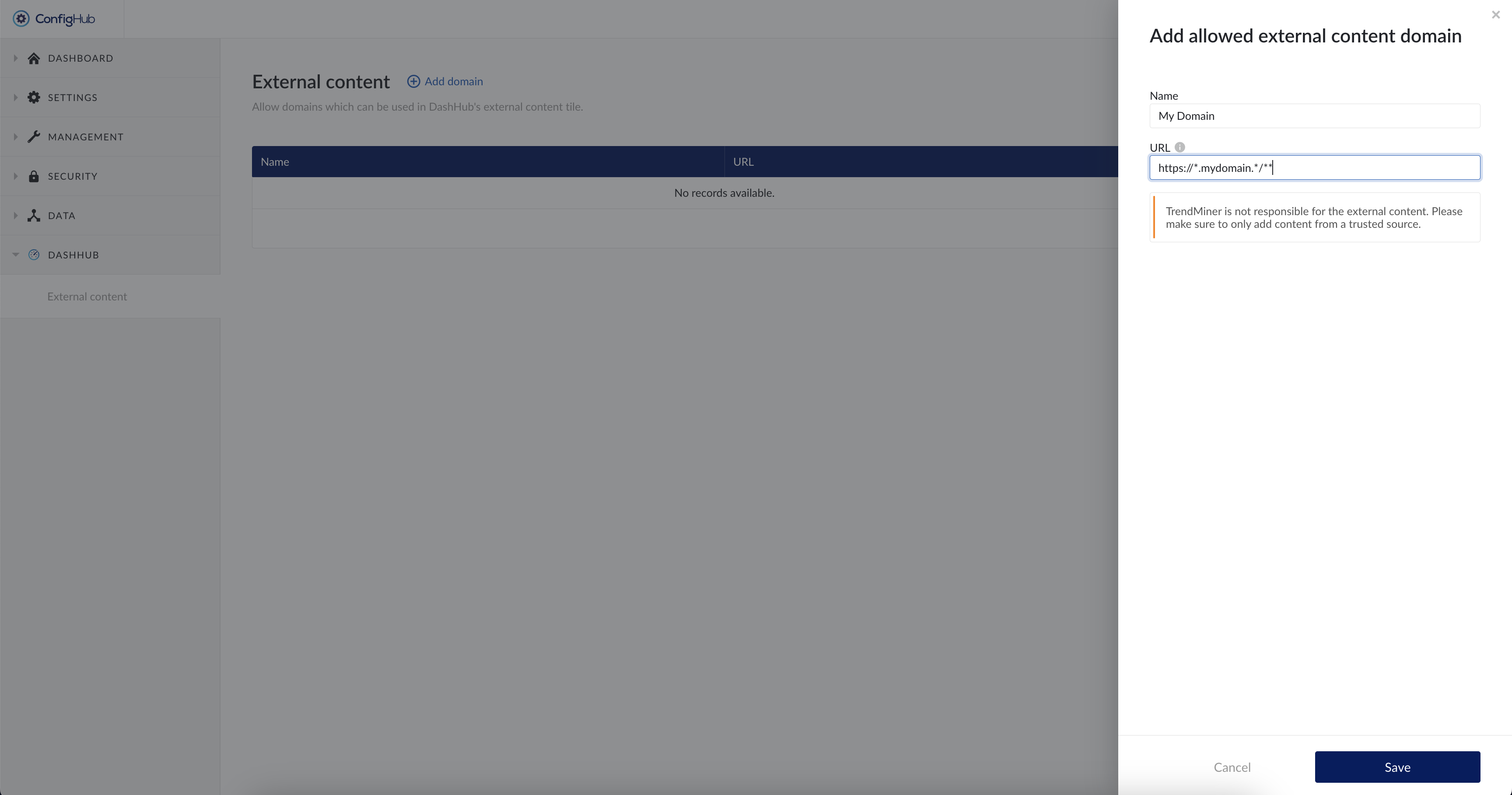

Validation rules for allowed domains
Domain
  • Wildcards are supported only for subdomains, not for the top-level domain (TLD) or root domain.
    • Allowed: https://*.trendminer.com/
    • Not allowed: https://trendminer.*/
  • The wildcard must appear at the beginning of the domain and be followed by a dot. For example, *.example.com is valid, but *example.com is rejected. This ensures the wildcard cannot create broader matches than intended.

If any existing domain entries do not comply with the new validation rules, a warning banner appears at the top of the External Content configuration page.
This banner indicates that one or more of the configured domains include patterns or formats that are no longer permitted. These entries remain visible in the list but are considered invalid until corrected.
How to fix invalid entries
  1. Review each invalid domain entry External content.
  2. Open the entry and update the domain or path so that it complies with the current validation rules
  3. Save the corrected entry. Once all invalid domains have been fixed or removed, the warning banner disappears automatically.
