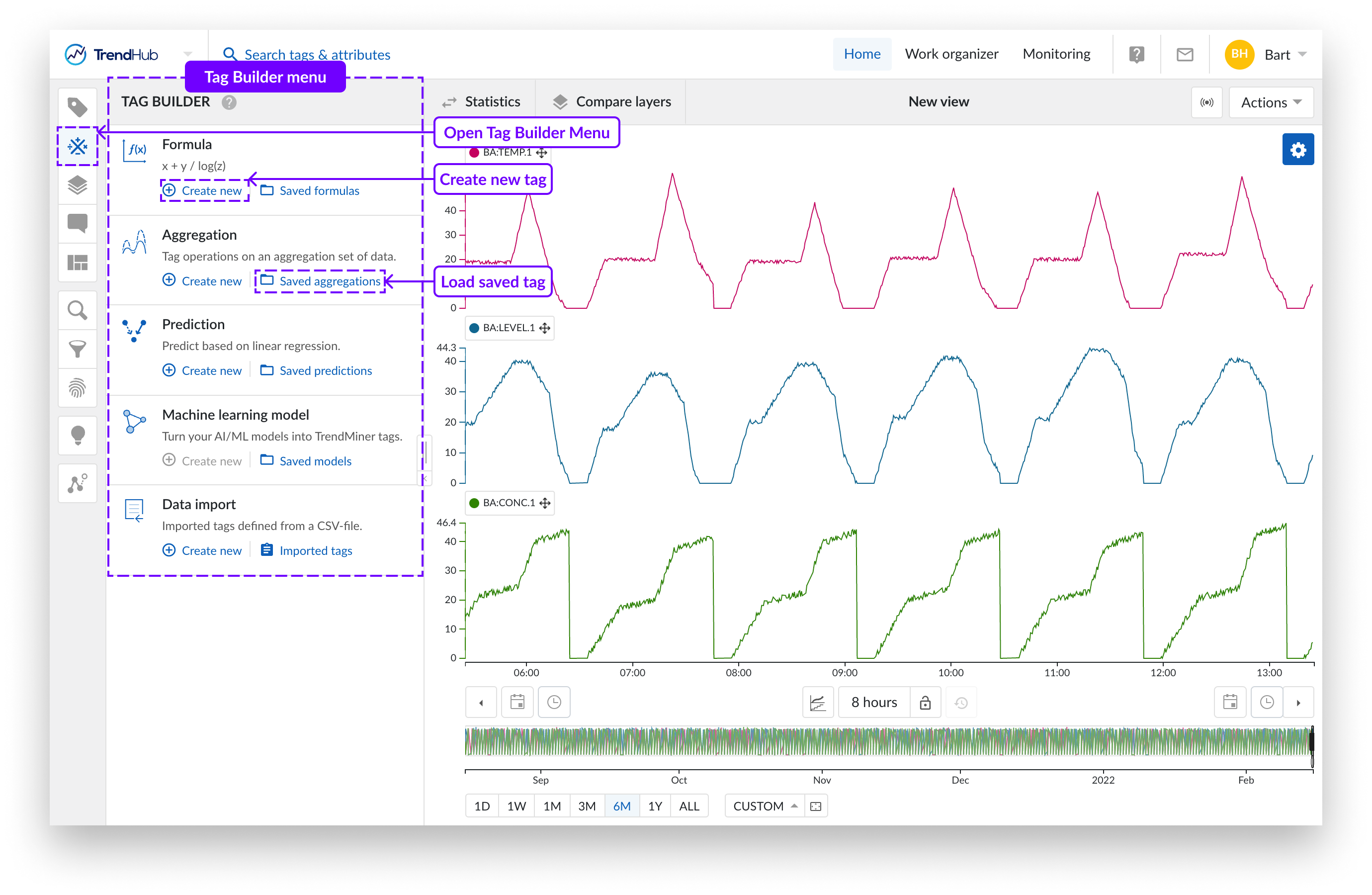

Opening the Tag Builder Menu will show you all available options as listed in the previous section. From here you can choose with which tag type to proceed with for further actions.
Open the Tag Builder Menu.

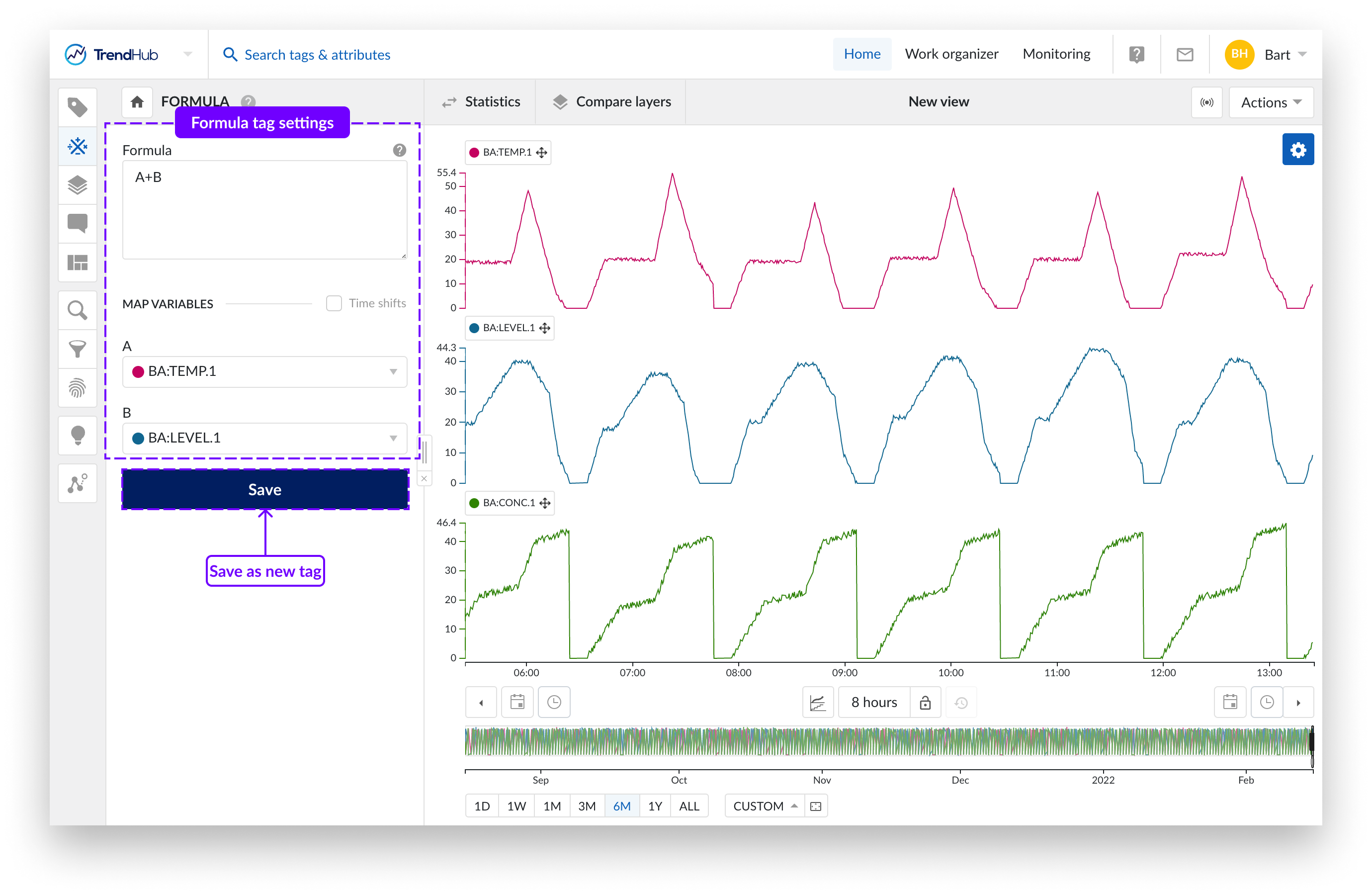

Click on the "+ Create new"-button for your tag builder type of choice. A new submenu will be shown based on the selected tag type.
Fill out the required fields. More information about the specific fields can be found on the respective page of each tag type as linked in the previous section.

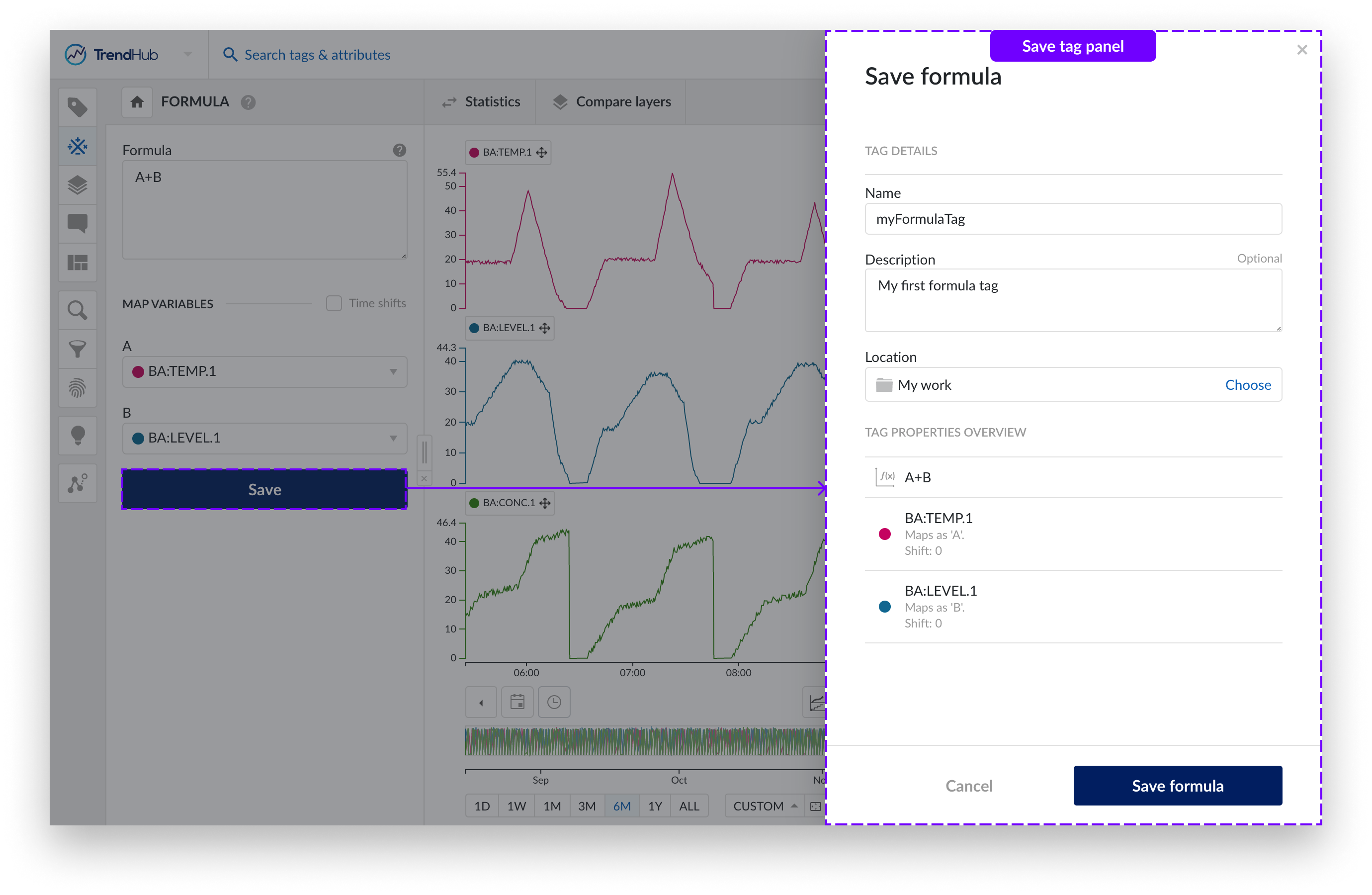

Click the "save"-button. A new side-panel appears on the right side of your screen.
In the "tag details"-section you need to fill out:
Name: The name of the tag you want to create. The tag you created will be searchable with this name.
Rules of limitations are applied so consider your tag name before committing the save, see below.
Description: The description of your tag.
Location: The folder of your Work Organizer where you want to save the tag.
The "tag properties overview" - sections shows a summary of how the calculated tag is set up.
Click on the "save Formula/Aggregation/..."-button in the side-panel. The created tags will be added to your screen automatically and a summary (tag definitions) will be shown in the tag builder menu.

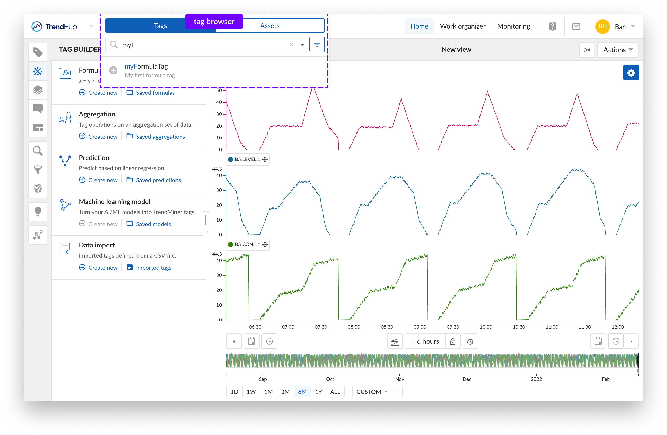

Any created tag can be added to your screen via the tag browser as with any other tag in TrendMiner.

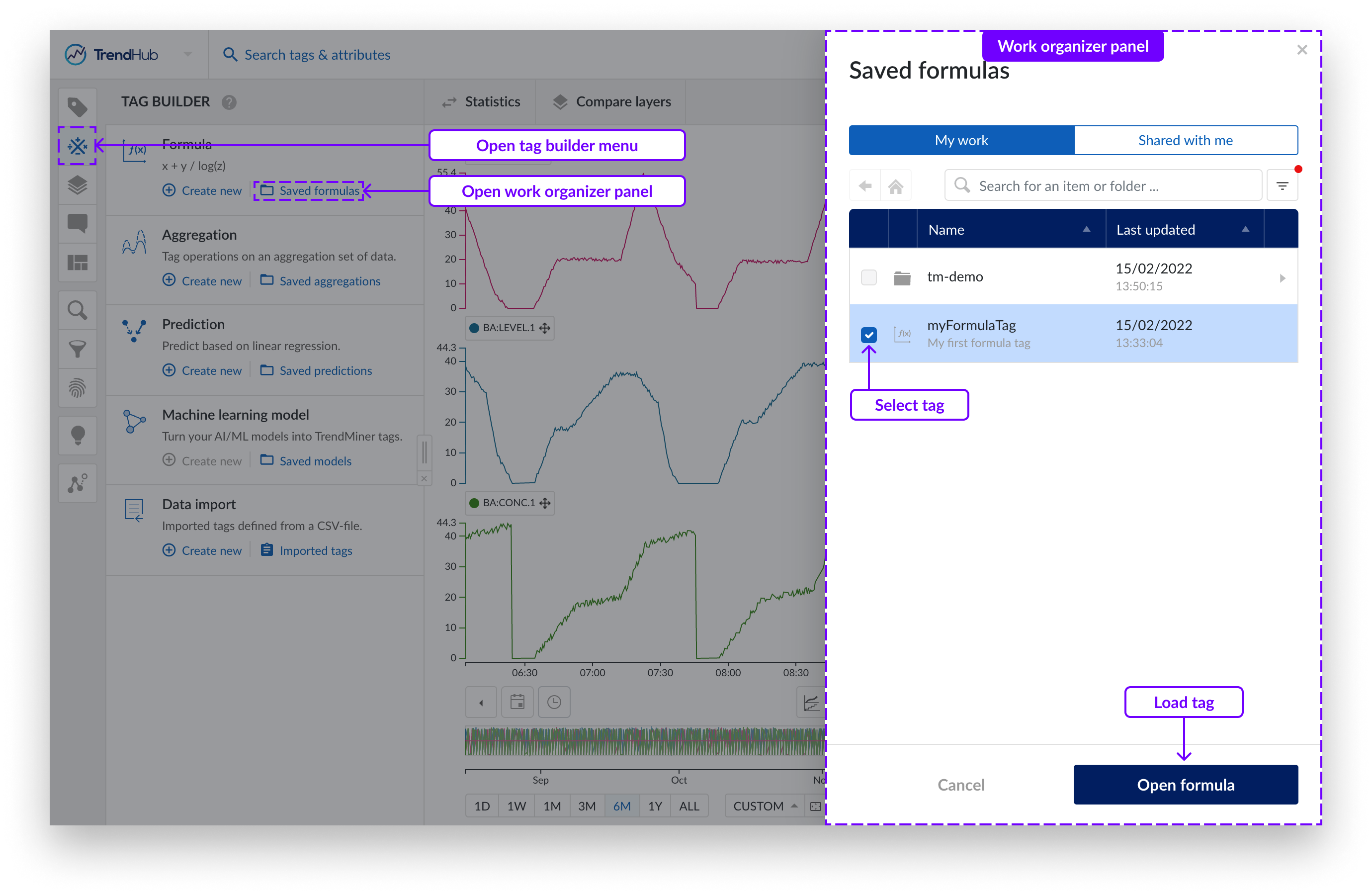

If you are the owner of a created tag you can:
Click on the "Saved Formula/Aggregation/..."-button.
Select your desired tag from the side-panel, showing the work organizer, that appears on the right side of your screen.
Click the "Open"-button.

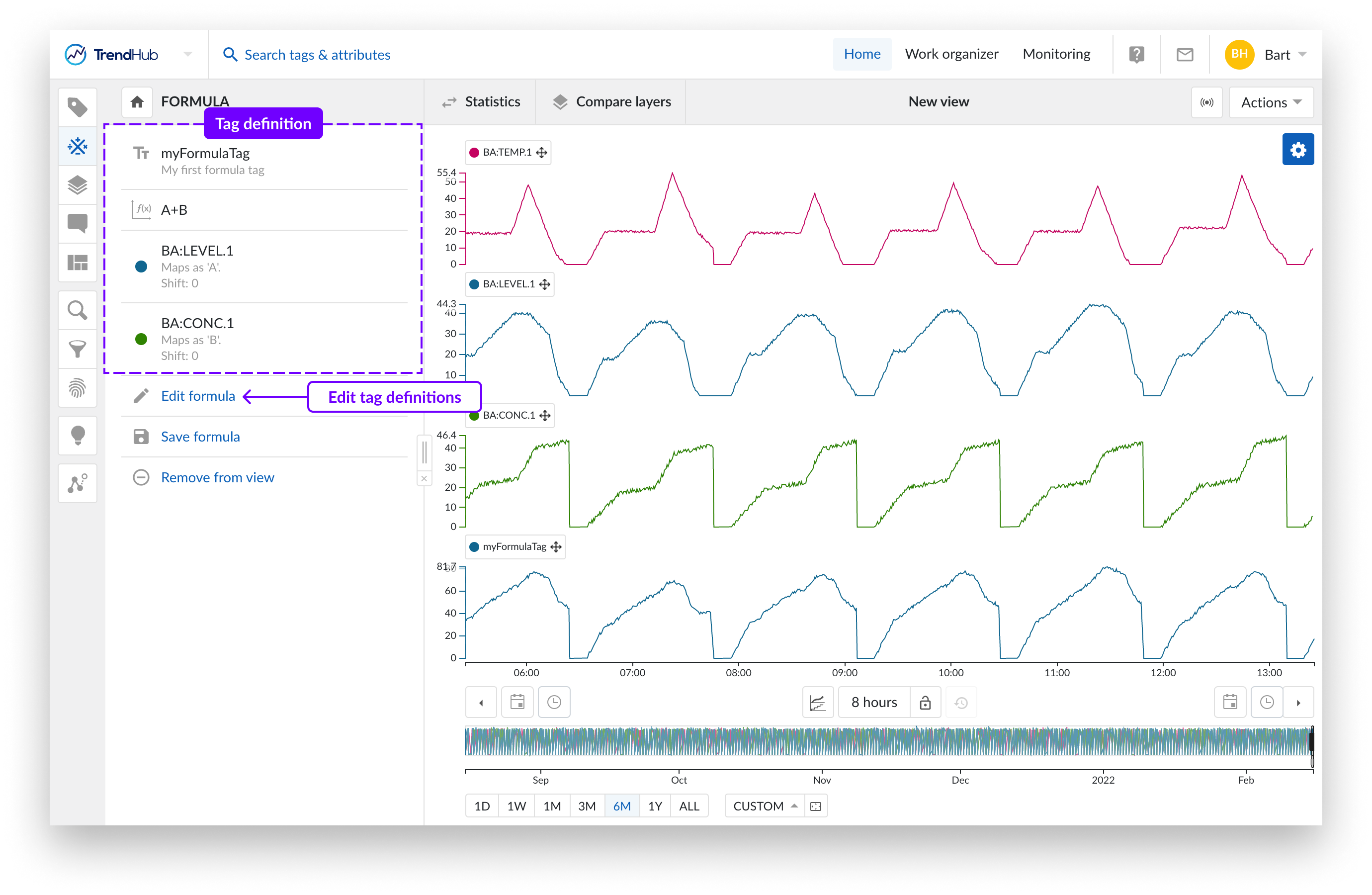

A summary of the tag details (= tag definitions) will be shown in the menu on the left including options to:
Edit your tag.
Save your tag. This will allow you to create a copy or rename your tag.
Add/Remove your tag from the current view.

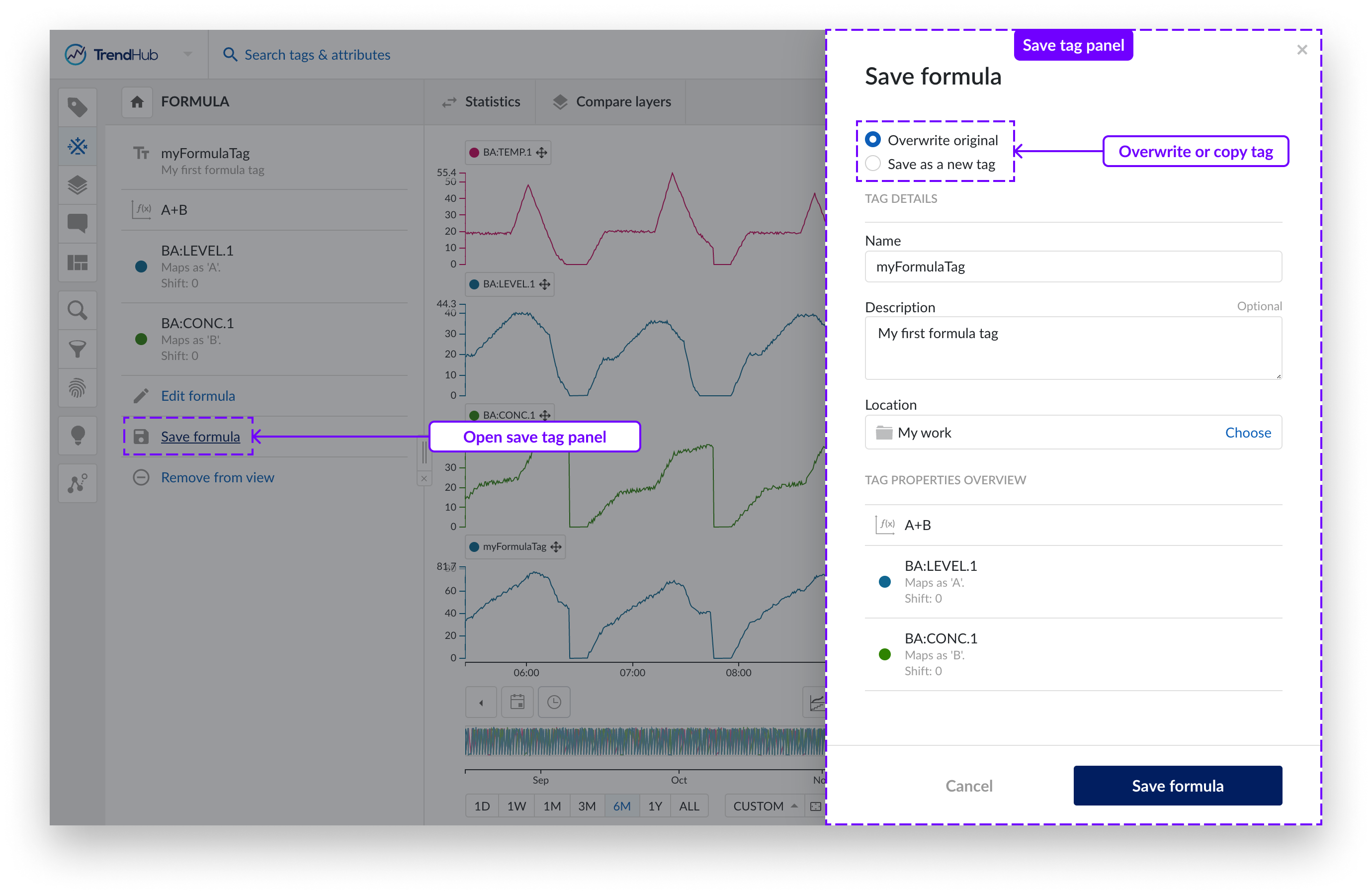

Click the "save"-button. A side-panel appears where you have the option to:
Overwrite the original tag.
Save the changes as a new tag.
Follow the steps from the "Showing tag details"-section.
Choose the "Save tag" option. A side-panel appears where you have the option to:
