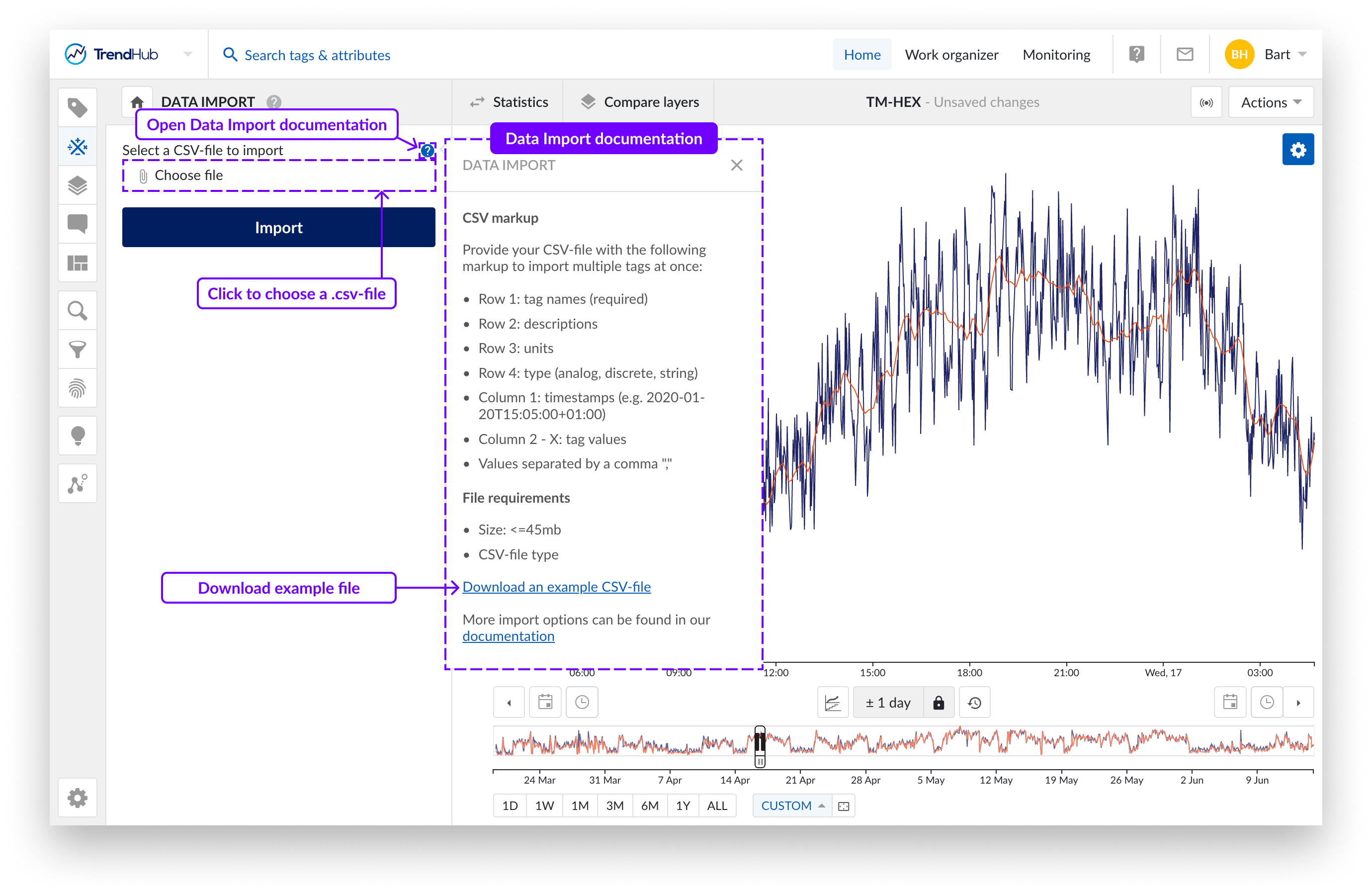

The data import functionality requires you to upload a .csv-file containing your data.
File-picker: Click this field to browse and select your local csv-file to be uploaded in TrendMiner. More details on the file formatting can be found in the sections below.

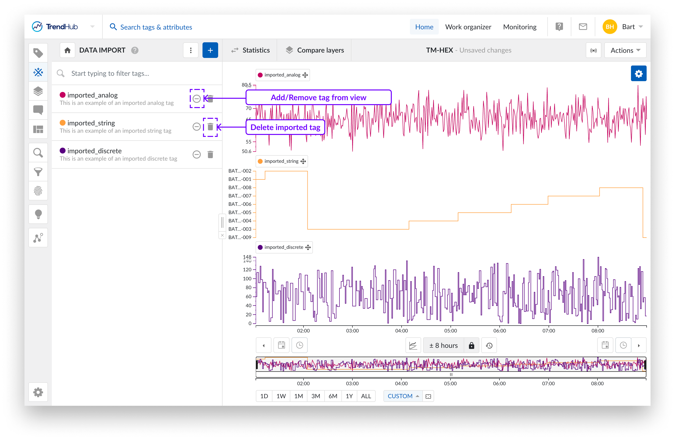

You can find an overview of your uploaded tags by clicking the "imported tags" button instead of the "create new" button in the "tag builder" menu.

Unlike the other tag builder functionalities, imported tags are not present in the work organizer. In order to delete your imported tags, you can delete them directly from the provided list when clicking "Imported tags" on the Tag builder overview.

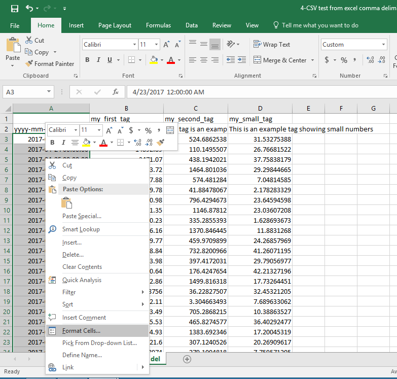

Select your range of dates (column A).
Right click.
Select "Format cells...".

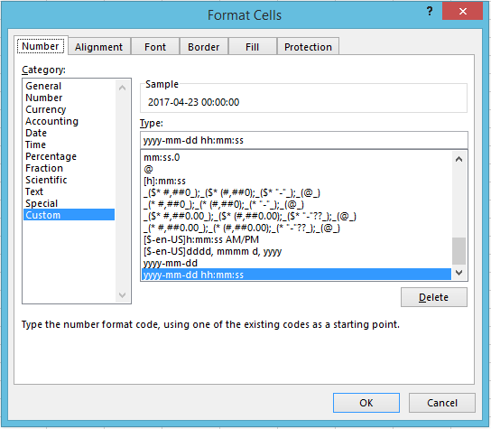

Select the "Custom" category.
Input the custom date format as: 'yyyy-mm-dd hh:mm:ss'
Click the "OK" button.

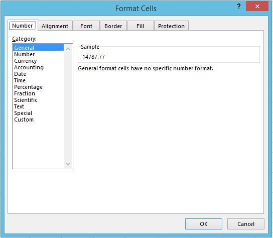

Select the "General" category.

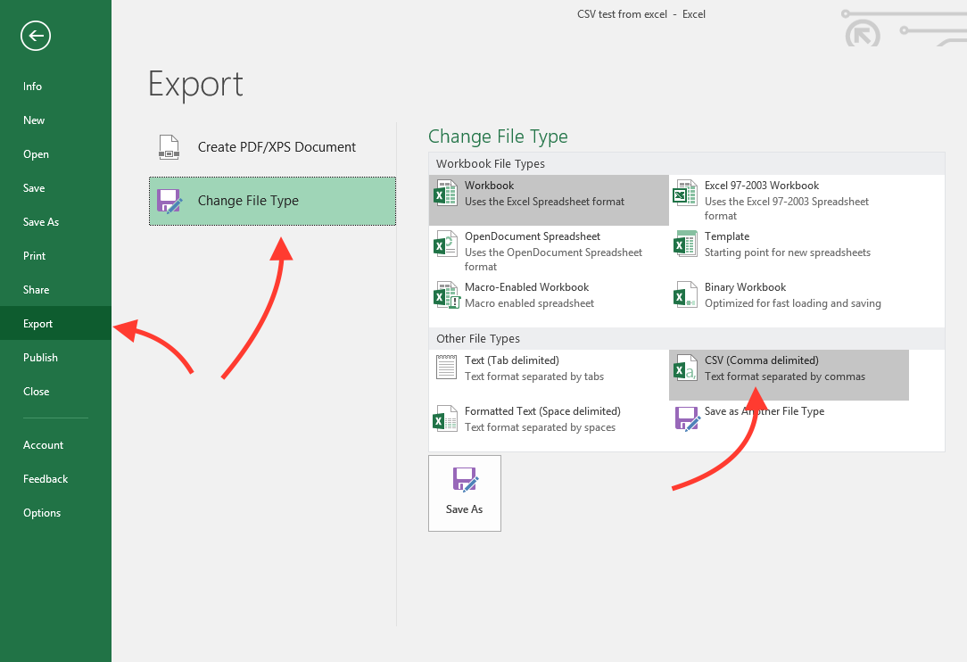

Open the "File" menu.
Select "Export".
Select "Change file type".
Select "CSV (Comma delimited".
