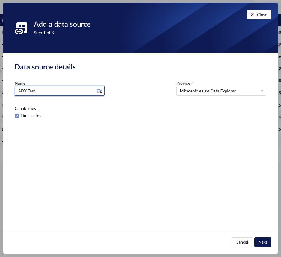

ConfigHub configuration
Fill out 'Data source details' on the first step of the datasource creation wizard: type name of data source, select “Microsoft Azure Data Explorer” from the Provider dropdown.  Time series capability will be checked by default.

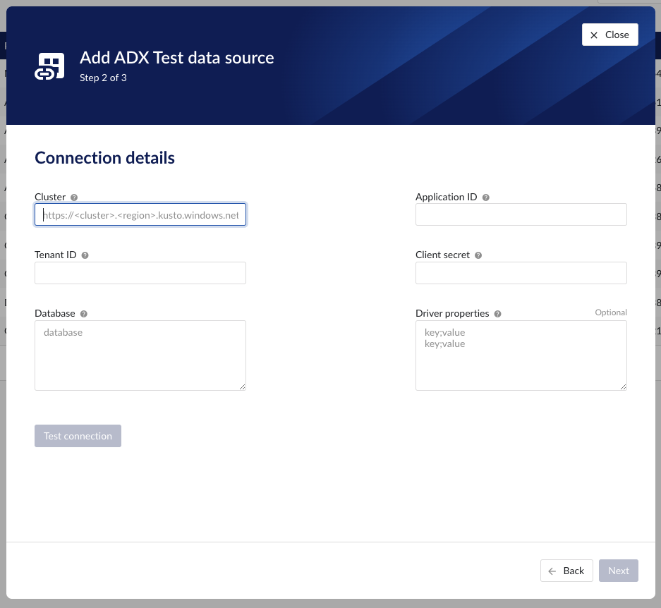

Fill out additional properties, grouped in following sections:
  • Connection details – lists properties related to the configuration of the connection that will be established with Microsoft Azure Data Explorer.
  • Time series details – lists properties relevant for the time series data.
  • “Provider” - select the option Microsoft Azure Data Explorer from the dropdown.
  • “Capabilities” - the only capability supported is the Time series capability. It will be selected by default.
  • "Cluster" - to be mapped with value of the cluster URI. https://<cluster>.<region>.kusto.windows.net
  • "Application ID" - a mandatory application id. In Azure a new application “TrendMiner” needs to be registered. After completion of this registration the application id will be available. For more info please refer to Azure Active Directory application registration or consult with the Azure Data Explorer documentation.
  • "Tenant ID" - a mandatory tenant id. In Azure a new application "TrendMiner"needs to be registered. After completion of this registration the tenant id is available.
  • "Client secret" - after registration of the TrendMiner application in Azure a client id and a secret need to be generated in order to get application access. The client secret for this access needs to be entered here.
  • "Database" – to be mapped with the name of the ADX database holding the time series data to be pulled.
  • "Driver properties" - additional  optional driver specific properties can be configured here as key;value, where key is the name of driver specific property and value the desired value for this property.

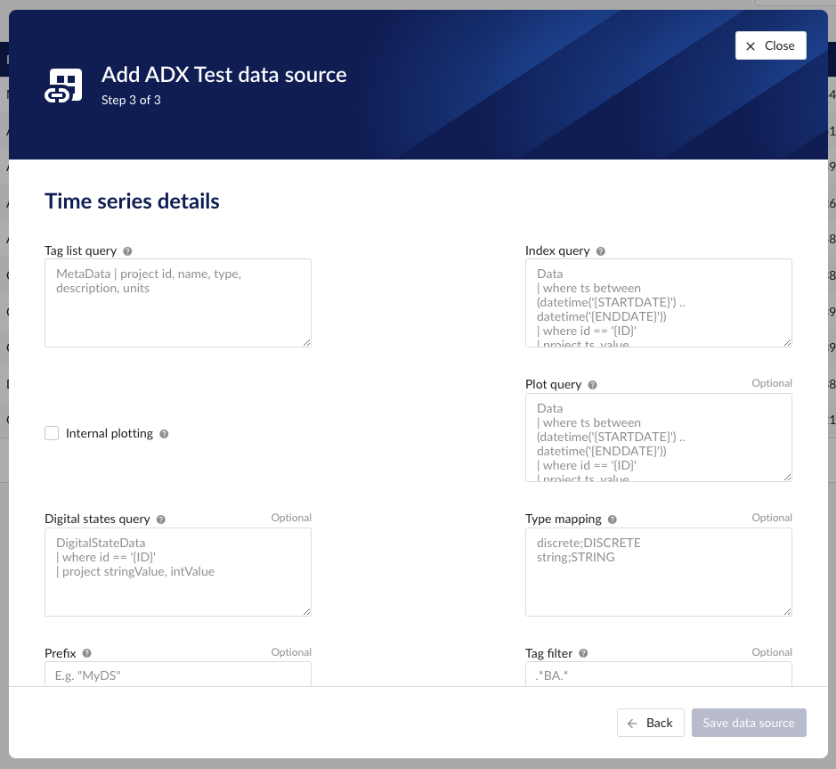

  • “Index query” - a query used by TrendMiner to ingest timeseries data for a specific tag. The query is expected to return a ts (timestamp) and a value. The following variables are available to be used in the WHERE clause of this query. The variables will be substituted at query execution with values. There should not be any NULL values returned by the SELECT statement so including "IS NOT NULL" in the WHERE clause is strongly recommended.
  • “Internal plotting” - if this option is selected TrendMiner will use interpolation if needed to plot the timeseries on the chart on specific time ranges. If this value is not selected and no plot query was provided, TrendMiner will plot directly from the index.
  • “Plot query” – a query used by TrendMiner to plot timeseries data for a specific tag. The query is expected to return a ts (timestamp) and a value. The following variables are available to be used in the WHERE clause of this query. The variables will be substituted at query execution with values. There should not be any NULL values returned by the SELECT statement so including "IS NOT NULL" in the WHERE clause is strongly recommended.
    • {STARTDATE}. TrendMiner will plot data per intervals of time. This denotes the start of such an interval.
    • {ENDDATE}. TrendMiner will plot data per intervals of time. This denotes the end of such an interval.
    1. customTypeA;ANALOG
    2. customTypeB;DIGITAL
    3. customTypeC;DISCRETE
    4. customTypeD;STRING
