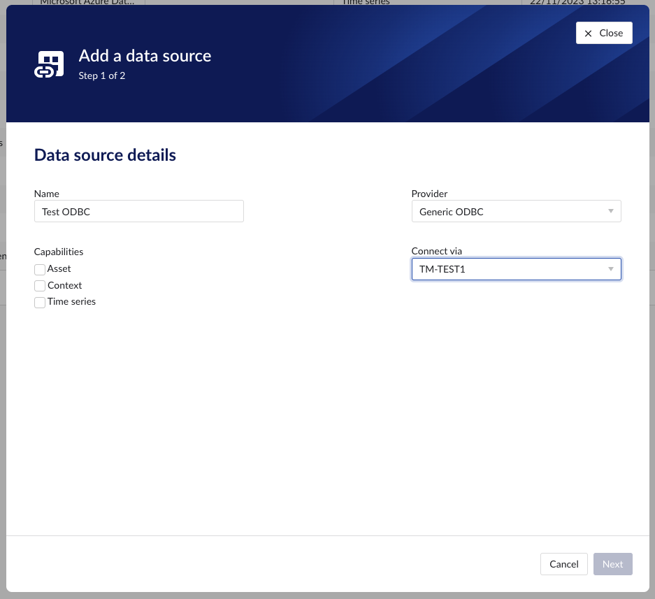

Creating a Generic ODBC data source
To integrate with and ingest data from a database that supports ODBC, a Data Source of provider type “Generic ODBC” can be added and configured in ConfigHub.
To do so, navigate to Data > Data Sources in the left side menu. Choose the "Add data source" option, which will open a wizard. In the first step, choose a name and select “Generic ODBC” from the Provider dropdown.  This will add two new options to fill in:
  1. Capabilities: tick the box for each capability you intend to activate
  2. Connect via: which Plant Integrations you will use to connect to the database
Selecting the capabilities for the data source with the given checkboxes will define the additional steps in the wizard to complete, grouped in the following sections:

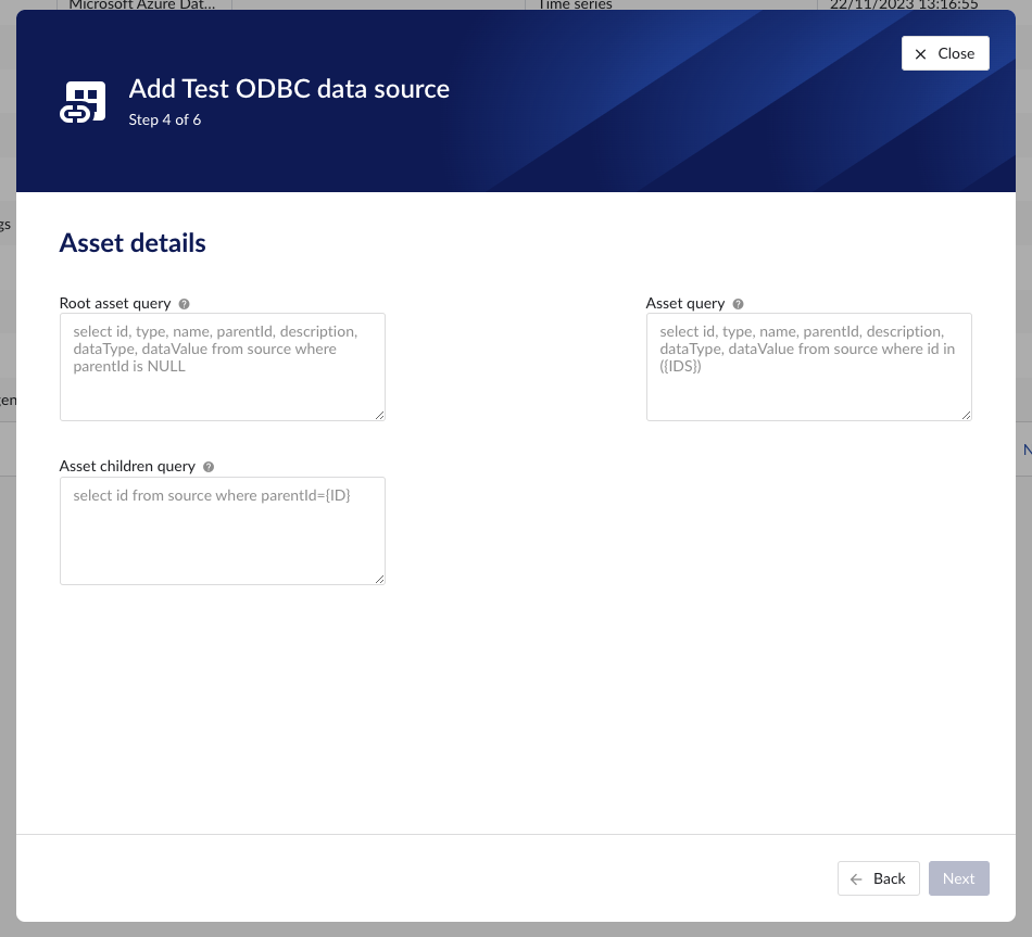

  • Asset details - configure properties relevant to asset data

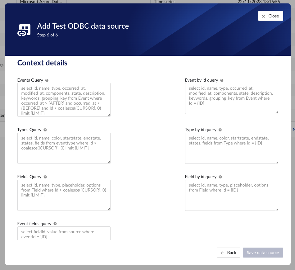

  • Context details - lists properties relevant to context data

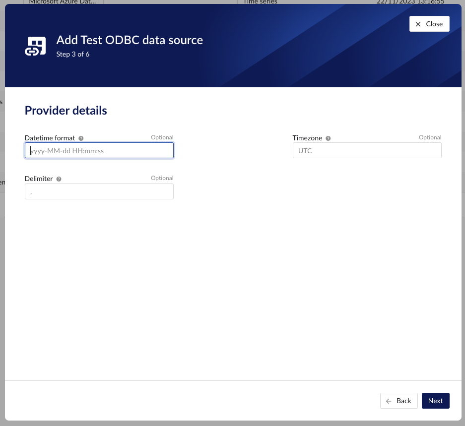

DateTime format
no
Time series
Event
An optional format your time series data is stored in.
Daylight Saving and Local timestamps
When the datetimes are stored as a date time in your local time zone, you SHOULD include the offset (which changes during daylight saving transitions) in the string representation of the timestamp, specify the DateTimeFormat as yyyy-MM-dd HH:mm:ss zzz and set the Timezone to your local time zone. This will insure that the daylight savings transition rules are respected, and that your datetimes will be parsed correctly.
There will be a validation error shown when you specify a DateTimeFormat without the offset specifier (zzz) and a Timezone other than UTC.
ISO8601
If the source system expects/returns the datetime values as ISO8601 UTC, you should use yyyy-MM-ddTHH:mm:ss'Z' as DateTimeFormatand UTC as Timezone.
e.g.2024-01-01T08:00:00Z

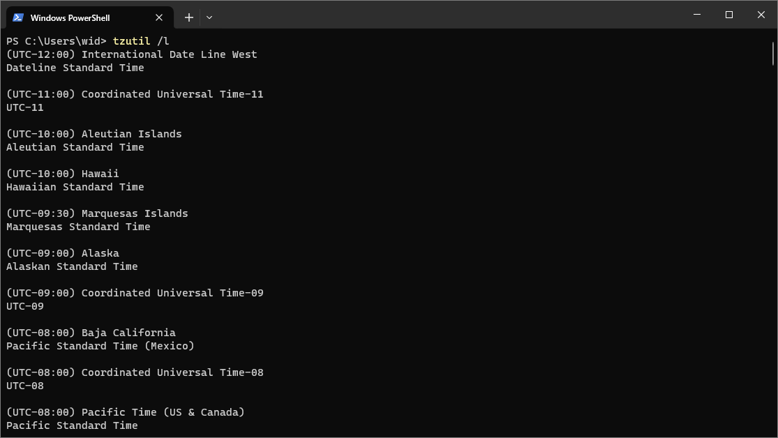

Timezone
no
Time series
Event
An optional timezone your time series data is stored in. Default is UTC.
The list of supported values are defined by the operating system of Plant Integrations. To get this list you can use the following command:
Notice
The second line for each time zone is the identifier that can be used, e.g. “Pacific Standard Time“
Delimiter
no
Asset
Event
Delimiter used to separate a multi string column/ field in the provider. The default is comma (,)

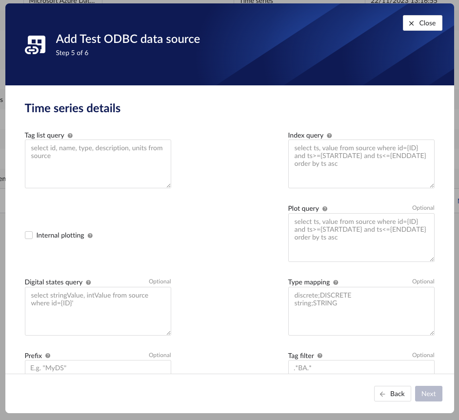

Time series capability
Caution
Because the id of the tag is missing from the contract between tm-datasource and tm-plant-integrations. The name column is used for {ID} variable.
Table 12. Time series capability properties
Property
Required
Remarks
Tag list query
yes
A query used by TrendMiner to create tags. A query needs to be provided that will, given your database schema and tables.
Example:
Columns:
  • id (string)
    • Unique identifier for each row returned by the query, like a primary key in a database table
    • Mandatory
  • name  (string)
    • Name of the tag
    • Mandatory
  • type (string)
    • Type of a tag. Without additional mapping, type must be one of the following tag types:
      • ANALOG
      • DIGITAL
      • DISCRETE
      • STRING
    • Optional, if the column is not in the query, the default type ANALOG is used
    • Custom types can be returned here but then a type mapping must be added as well.
  • description (string)
    • Description of a tag
    • Optional, can be empty or null value
  • units (string)
    • Unit of measurement for the tag
Index query
yes
A query used by TrendMiner to ingest time series data for a specific tag. The query is expected to return a ts (timestamp), value and optionally an offset.
The results should be sorted ascending on timestamp, if not they will be sorted by the provider.

Internal plotting
no
If this option is selected TrendMiner will use interpolation if needed to plot the tag on the chart on specific time ranges. If this value is not selected and no plot query is provided,
TrendMiner will plot directly from the index.
Plot query
no
A query used by TrendMiner to plot time series data for a specific tag. The query is expected to return a ts (timestamp) and a value.

  • {ENDDATE} (string)
    • TrendMiner will ingest data per intervals of time. This demotes the end of such an interval.
    • Value is formatted (string) using the format specified in the DateTime format provider property.
  • {ENDDATE:ToDateTime} (DateTime)
    • Value as DateTime data type
  • {ENDDATE:ToOffset} (string)
    • Offset of the start date as a string, e.g. “+01:00“
  • {ENDDATE:ToOffsetInMinutes} (numeric)
    • Offset of the start date specified in minutes, e.g. 60
  • {ENDDATE:ToUnixTimeSeconds} (numeric)
    • End date specified as unix epoch milliseconds
  • {INTERPOLATION} (string)
    • Interpolation type of a tag, which can be on of two values:
      • LINEAR
      • STEPPED
  • {NUMBEROFINTERVALS} (numeric)
    • Number of intervals to return. It can be used to optimize a query to return the expected number of points.
  • {INDEXRESOLUTION} (numeric)
    • Index resolution in seconds. It can be used to optimize a query to return the expected number of points.
Example:
select ts, value from source where id={ID} and ts>={STARTDATE} and ts<={ENDDATE} order by ts asc
or
select ts, value, offset from source where id={ID} and ts>={STARTDATE} and ts<={ENDDATE} and offset>={STARTDATE:ToOffsetInMinutes} and offset<={EndDate:ToOffsetInMinutes} order by ts asc
Columns:
  • ts (DateTime2 | long | string)
    • Timestamp of the value
    • Supported types:
      • string: parsed using the format specified in the DateTime format provider property.
      • long: unix epoch in milliseconds (UTC)
      • DateTime2: Seen as UTC when offset column is not included in query
  • value (string)
    • Value at the specified timestamp
  • offset (long | string)
    • Used to specify the offset of ts when specified as DateTime2
    • Is only used when ts is specified as DateTime2
    • Optional, can be empty or null value - defaults to Zero
    • Supported types:
      • string: “+/-hh:mm’” format e.g.”+01:00”
      • long: in minutes e.g. 60
Digital state query
no
If tags of type DIGITAL are returned by the tag list query, TrendMiner will use this query to ask for the stringValue, intValue pairs for a specific tag to match a label with a number.
Variables:
  • {ID}  (string)
    • The Name as returned by the tag list query for tags with type DIGITAL.
Example:
select stringValue, intValue from source where id={ID}
Columns:
  • stringValue (string)
    • Possible value of a digital tag
  • intValue (numeric)
    • Numeric representation of a possible value of a digital tag
Type mapping
no
If types differ from what TrendMiner uses and one wants to avoid to overcomplicate the query, a type mapping can be entered here. It can contain multiple lines and expect per line the value
to be representing a custom type followed by a ; and a TrendMiner type. During the execution of the tag list query TrendMiner will then use this mapping to map the custom values returned in
the query to TrendMiner tag types.
customTypeA;ANALOG
customTypeB;DIGITAL
customTypeC;DISCRETE
customTypeD;STRING
Prefix
no
An optional text can be entered here that will be used to prefix the tag names in TrendMiner.
Warning
Value cannot be changed.
Tag filter
no
An optional regular expression to be entered. Only tags with names that match this regex will be retained when creating tags (using the tag list query).
Asset capability
Table 13. Asset capability properties
Property
Required
Remarks
Root asset query
yes
This query needs to return details for a specific asset record.
Example:
Columns:
  • id (string)
    • Mandatory
  • type (string)
    • TrendMiner can handle asset of type ASSET or ATTRIBUTE. This column must be on of these two values.
    • Mandatory
  • name (string)
    • Name of the asset
    • Mandatory
  • parentId (string)
    • Identifier of the parent, which should be null in case of a root asset
    • Description of the asset
  • data type (string)
    • TrendMiner can ingest four different types of data in case the asset is of type ATTRIBUTE. This column will impact on how the data value column will be interpreted/read:
      • STRING data value is interpreted as text
      • STRING_ARRAY comma delimited string
      • NUMERIC
      • DATA_REFERENCE
    • Optional, can be empty or null or not a specified as column
  • data value (string | double | float | int | long)
    • This column will either be interpreted as text (STRING), a collection of text (STRING_ARRAY), a number (NUMERIC) , or a reference to a Tag (DATA_REFERENCE).
    • Supports following underlying data types:
      • STRING
      • DOUBLE
      • FLOAT
      • INT
      • LONG
Asset query
yes
This query is responsible for returning all top level elements from the asset tree structure.
Variables:
  • {IDS} (string[])
    • List of identifiers of assets for which the query must return data, should be used in an “IN-clause“ since, it will be replaced by any (as specified) number of parameters in the query:
      select ... where id in (?,?,?,?)
Example:
select id, type, name, parentId, description, dataType, dataValue from source where id in ({IDS})
Columns:
  • id (string)
    • Mandatory
  • type (string)
    • Mandatory
  • name (string)
    • Name of the asset
    • Mandatory
  • parentId (string)
      • NUMERIC
      • DATA_REFERENCE
      • STRING
      • DOUBLE
      • FLOAT
      • INT
      • LONG
Asset children query
yes
This query needs to return the ids of the direct descendants of this asset.
Variables:
  • {ID} (string)
    • id of the asset for which the direct descendants need to be queried
Example:
select id from source where parentId={ID}
Columns:
  • id (string)
    • Identifier for each direct descendant asset, like a primary key in a database table
    • Mandatory
Event capability
Table 14. Event capability properties
Property
Required
Remarks
Events query
yes
This query is responsible for returning events from the source database. Context items will be generated based on these events.
Variables:
  • {CURSOR} (string | numeric)
    • Unique and sorted value that is used in the cursor based pagination implementation
  • {LIMIT} (numeric)
    • Maximum number of records the query should return
  • {AFTER} (string)
    • Date after which the events must be returned
    • String formatted using DateTime format provider property
  • {AFTER:ToDateTime} (DateTime)
    • Date after which the event must be returned
  • {AFTER:ToOffset} (string)
    • Offset of the date after which the event must be returned
    • String, e.g. +”01:00”
  • {AFTER:ToOffsetInMinutes} (numeric)
    • Offset in minutes of the date after which the event must be returned
    • Numeric e.g. 60
  • {AFTER:ToUnixTimeMilliseconds} (numeric)
    • Date after which the events must be returned, in epoch time (milliseconds)
    • Numeric (Long)
  • {AFTER:ToUnixTimeSeconds} (numeric)
    • Date after which the events must be returned, in epoch time (seconds)
    • Numeric (Long)
  • {BEFORE} (string)
    • Date before which the events must be returned
  • {BEFORE:ToDateTime} (DateTime)
    • Date before which the event must be returned
    • DateTime
  • {BEFORE:ToOffset} (string)
    • Offset of the date before which the event must be returned
  • {BEFORE:ToOffsetInMinutes} (numeric)
    • Offset in minutes of the date before which the event must be returned
    • Numeric e.g. 60
  • {BEFORE:ToUnixTimeMilliseconds} (numeric)
    • Date before which the events must be returned, in epoch time (milliseconds)
    • Numeric (Long)
  • {BEFORE:ToUnixTimeSeconds} (numeric)
    • Date before which the events must be returned, in epoch time (seconds)
Example:
select
  id, name, type, occurred_at, modified_at, components, state, description, keywords, grouping_key
from
  Event
where
    occurred_at > {AFTER}
  and
    occurred_at < {BEFORE}
  and
    id > coalesce({CURSOR}, 0)
limit
  {LIMIT}
Columns:
  • id (string)
    • Mandatory
  • name (string)
    • Name of the event
    • Mandatory
  • type (string)
    • Identifier of the type of the event (as specified in the type/types query)
    • Mandatory
  • occurred_at (string | DateTime | long)
    • Timestamp when the event occurred
    • Parsed using the format specified in the DateTime format provider property
  • modified_at (string | DateTime | long)
    • Timestamp when the event was modified
  • components (string)
    • List of component (asset) identifiers separated by the Delimiter (',' by default)
  • state (string)
    • State for this event record
    • Description of the event
  • keywords (string)
    • List of keywords associated with the events, separated by the Delimiter (',' by default)
  • grouping_key (string)
    • Identifier of the object which raised the event, all events of the same object should have the same grouping_key
Event by id query
yes
This query is responsible for returning a specific event from the source database.
Variables:
  • {ID} (string)
    • id of the event which needs to be queried
Example:
select id, name, type, occurred_at, modified_at, components, state, description, keywords, grouping_key from Event where Id = {ID}
Columns:
  • id (string)
    • Mandatory
  • name (string)
    • Name of the event
    • Mandatory
  • type (string)
    • Mandatory
  • state (string)
  • keywords (string)
Types query
yes
This query is responsible for returning a list of possible event types from the source database.
Variables:
  • {LIMIT} (numeric)
Example:
select id, name, color, startstate, endstate, states, fields from eventtype where Id > coalesce({CURSOR}, 0) limit {LIMIT}
Columns:
  • id (string)
    • Mandatory
  • name (string)
    • Name of the type
    • Mandatory
  • color (string)
    • Color for this event type record. It will be used in the Gantt chart view of ContextHub
  • startstate (string)
    • Name of the start start
  • endstate (string)
    • Name of the end state
  • states (string)
    • List of the possible state, separated by the Delimiter (',' by default)
    • First item in the list must be the start state
    • Last item in the list must be the end state
  • fields (string)
    • List of custom field identifiers for this event, separated by the Delimiter (',' by default)
Type by id query
yes
This query is responsible for returning an event type from the source database.
Variables:
  • {ID} (string)
    • id of the event type which needs to be queried
Examples:
select id, name, color, startstate, endstate, states, fields from Type where id = {ID}
Columns:
  • id (string)
    • Mandatory
  • name (string)
    • Name of the type
    • Mandatory
  • color (string)
    • Color for this event type record. It will be used in the Gantt chart view of ContextHub.
  • endstate (string)
  • states (string)
  • fields (string)
Fields query
yes
This query is responsible for returning a list of possible custom fields from the source database.
Variables:
  • {CURSOR}

Event fields query
yes
This query is responsible for returning custom field values for specific event.
Variables:
  • {ID} (string)
    • id of the event for which the fields need to be queried
Example:
Columns:
  • fieldId (string)
    • Unique identifier of custom field definition (provided in the Fields query)
    • Mandatory
  • value
    • Value of the field
    • Mandatory
Example queries (Sqlite)
Below we provide some example queries that can be used in the Generic ODBC provider for the sqlite odbc drivers.
TIME SERIES CAPABILITY
Tag list query
Index query
select ts, value from source where id={ID} and ts >= {STARTDATE} and ts <= {ENDDATE} order by ts asc
Plot query
select ts, value from source where id={ID} and ts >= {STARTDATE} and ts <= {ENDDATE} order by ts ascselect ts, value from source where id={ID} and ts>={STARTDATE} and ts<={ENDDATE} order  by ts asc
Digital state query
ASSET CAPABILITY
Root asset query
Asset query
