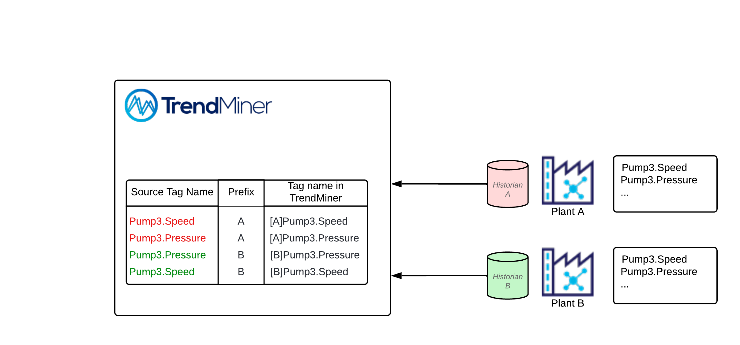

Unique tag name concept
TrendMiner does not currently support duplicate tag names. When 2 or more tags with exactly the same name are synced to TrendMiner, analytics, calculations and indexing on/for these tags might fail. Unique data source prefixes can be used to prefix all the tag names such that duplicate tags cannot occur between different data sources.
A prefix can be set up during the historian connection configuration. When you want to add more than one historian to TrendMiner, we strongly advise the use of a Prefix name. Note that the prefix will be visible to end users. For example: if the Prefix name is PI then all the tags will appear as [PI]tagname. Try to create an indicate name but keep them as short as possible for readability. For example, if a plant has a unique code like ANT or CHI, those could be a good choice.
For the scenario below there is a matching list of tags for Pump #3 on 2 historians: A and B. A prefix should be implemented on the TrendMiner side to prevent the conflict. Prefix A added to the 1st data source (Historian A) and prefix B added to the 2nd one (Historian B).
