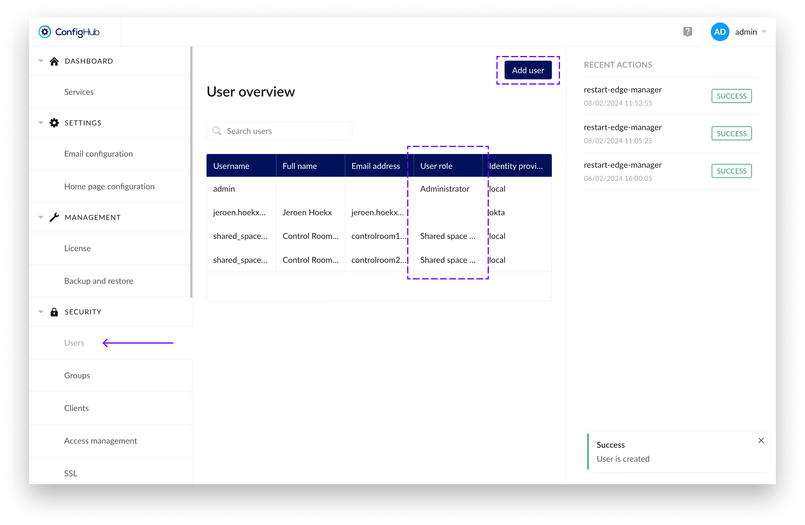

Users
TrendMiner users can either exist locally or via an external Identity Provider. An overview of all users can be found under the "Security" section in ConfigHub.
The user overview shows the username, full name, email address and the identity provider. Specific users can be searched through via the top right search bar above the table.
Creating users
You can review a list of user roles to each specific user using the “User role” column in the table.

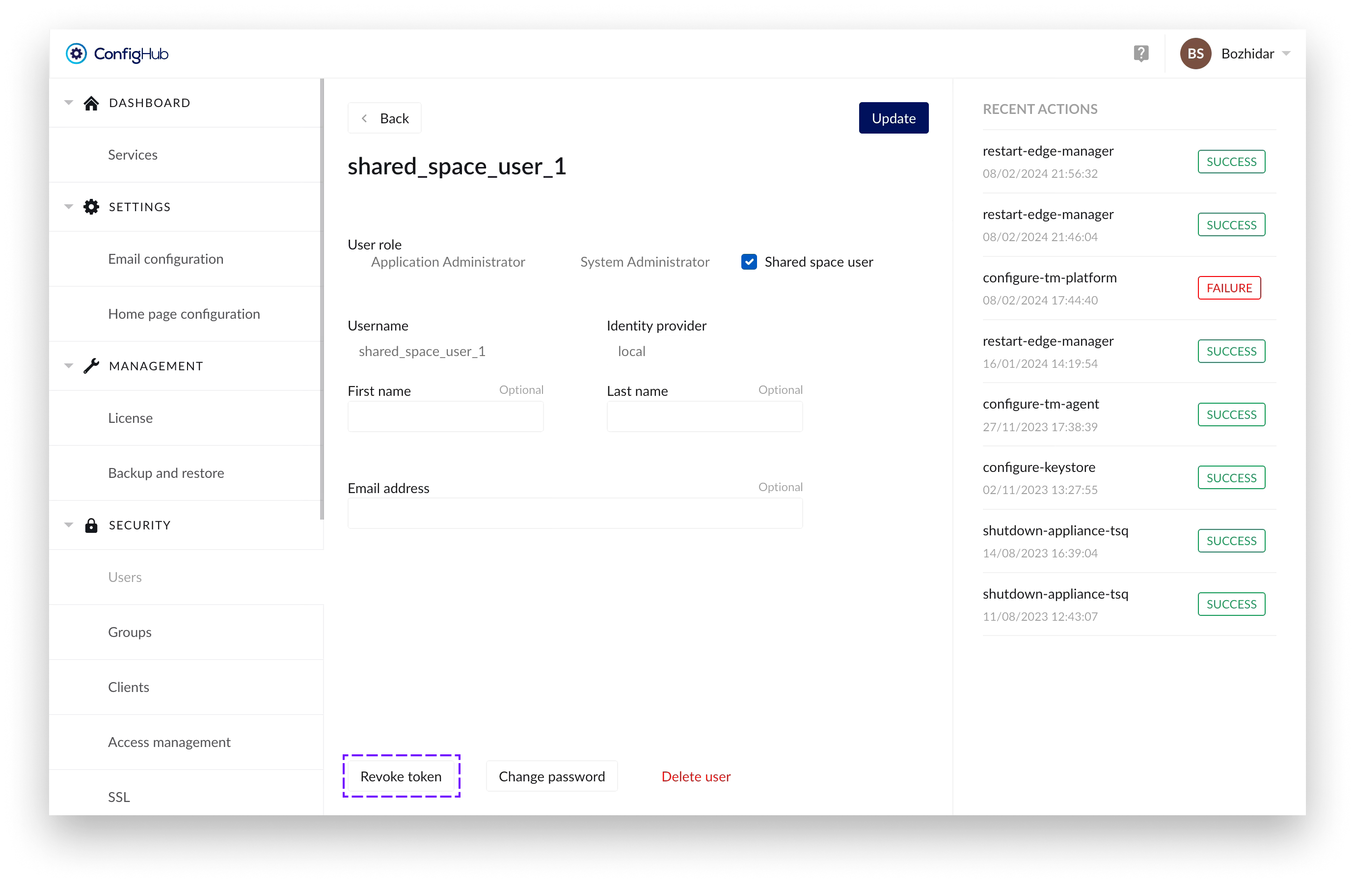

User details
From the user overview a user can be clicked to open the user details. In the user details view more options can be performed such as:
  • Change password (local users only)
  • Delete the user account (local users only).

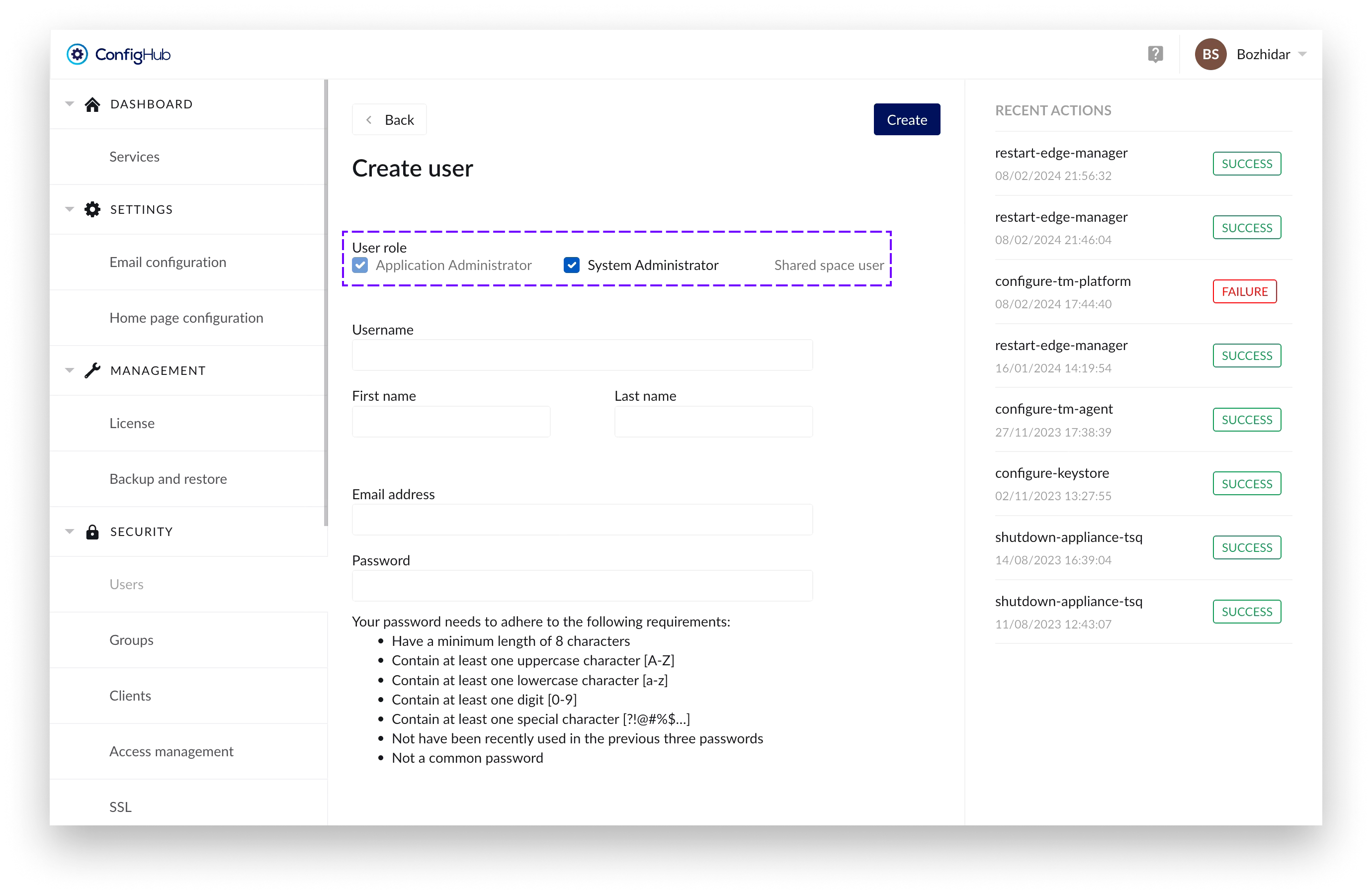

User roles
3 roles are available:
  • Application Administrator: can perform application administrator tasks such as deleting tag indexes or configure asset permissions in ContextHub.
  • System Administrator: has all permissions an application admin has + can access ConfigHub

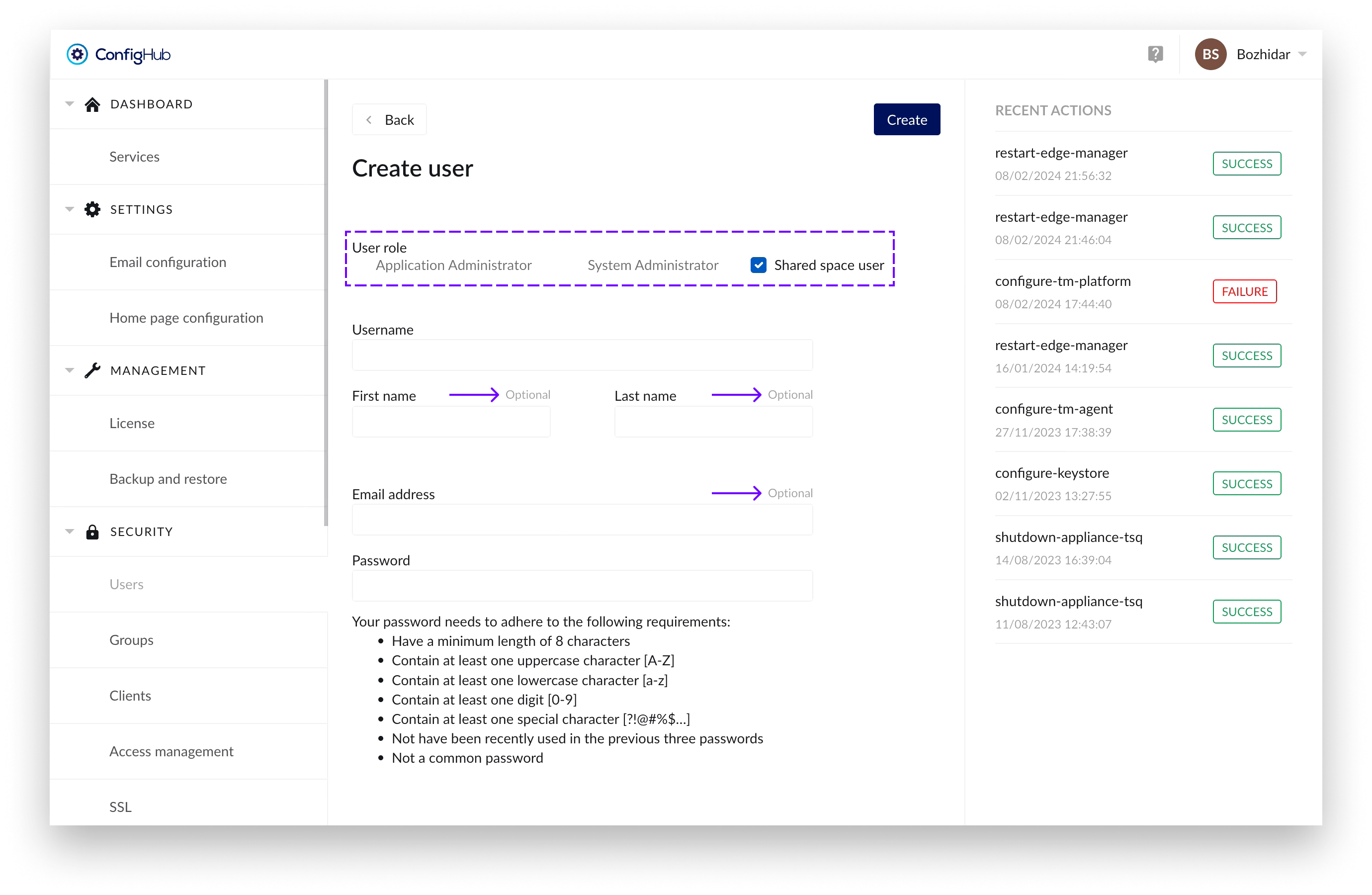

  • Shared space user:
    • User with an extended login timeout of 1 year to ensure their usability in shared spaces for displaying dashboards and other content for prolonged periods of time.
    • Users with this role have the following fields as optional: “First name”, “Last name” and “Email address”.
    • For security reasons - assigning “Shared space user” role to a specific user would prevent you of assigning any administration role in combination with it.

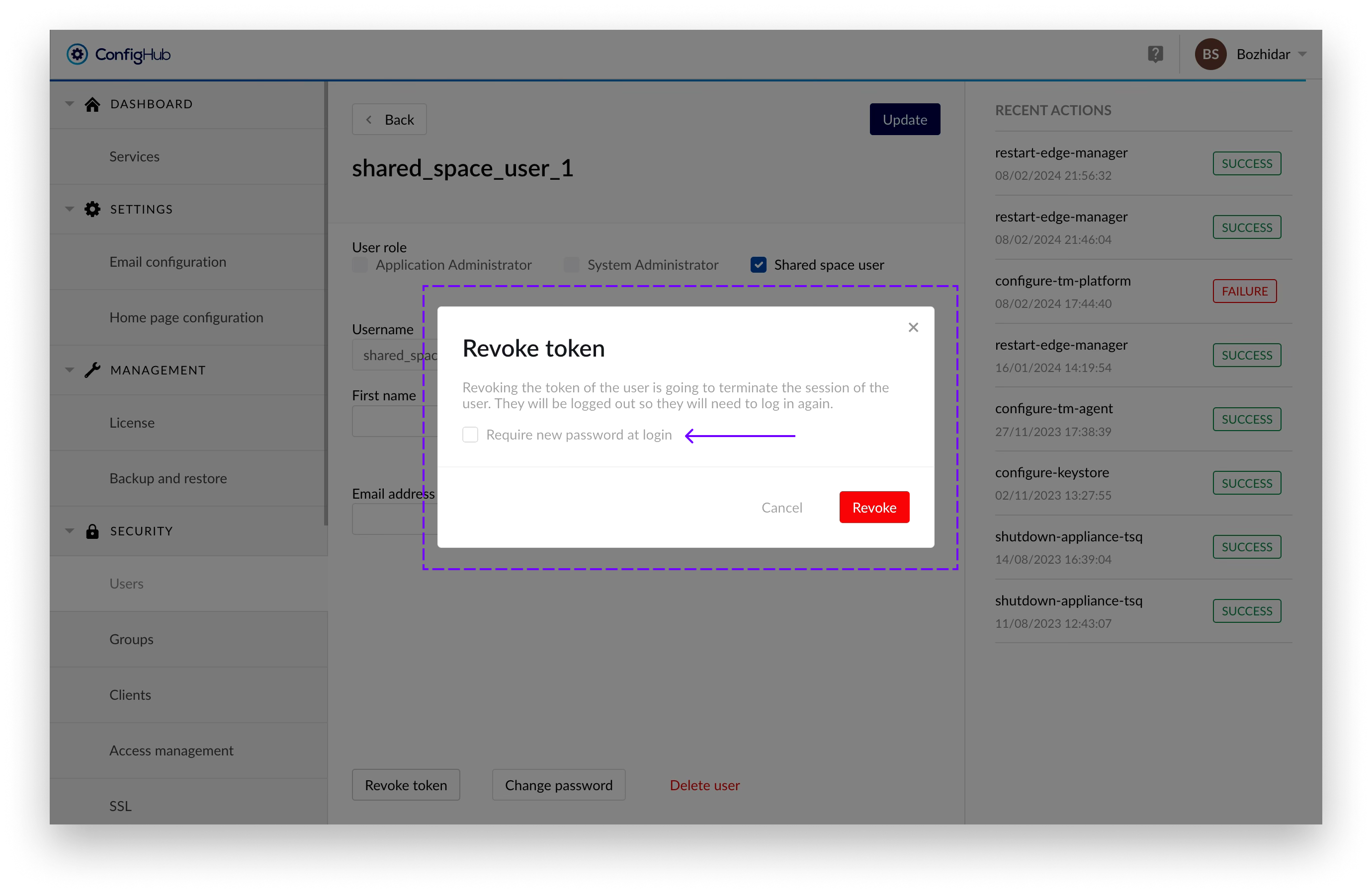

    • A forceful logout of such users can be initiated by clicking on the “Revoke token” in the “User edit” screen (to which you can navigate by clicking on an already created user in the table):
      Once that's done a confirmation dialogue would appear, from where you can also select for the user to have to update his password on next login:
      The user can remain logged in for a maximum of 5 minutes after the process has been initiated, after which he will be forcefully logged out.

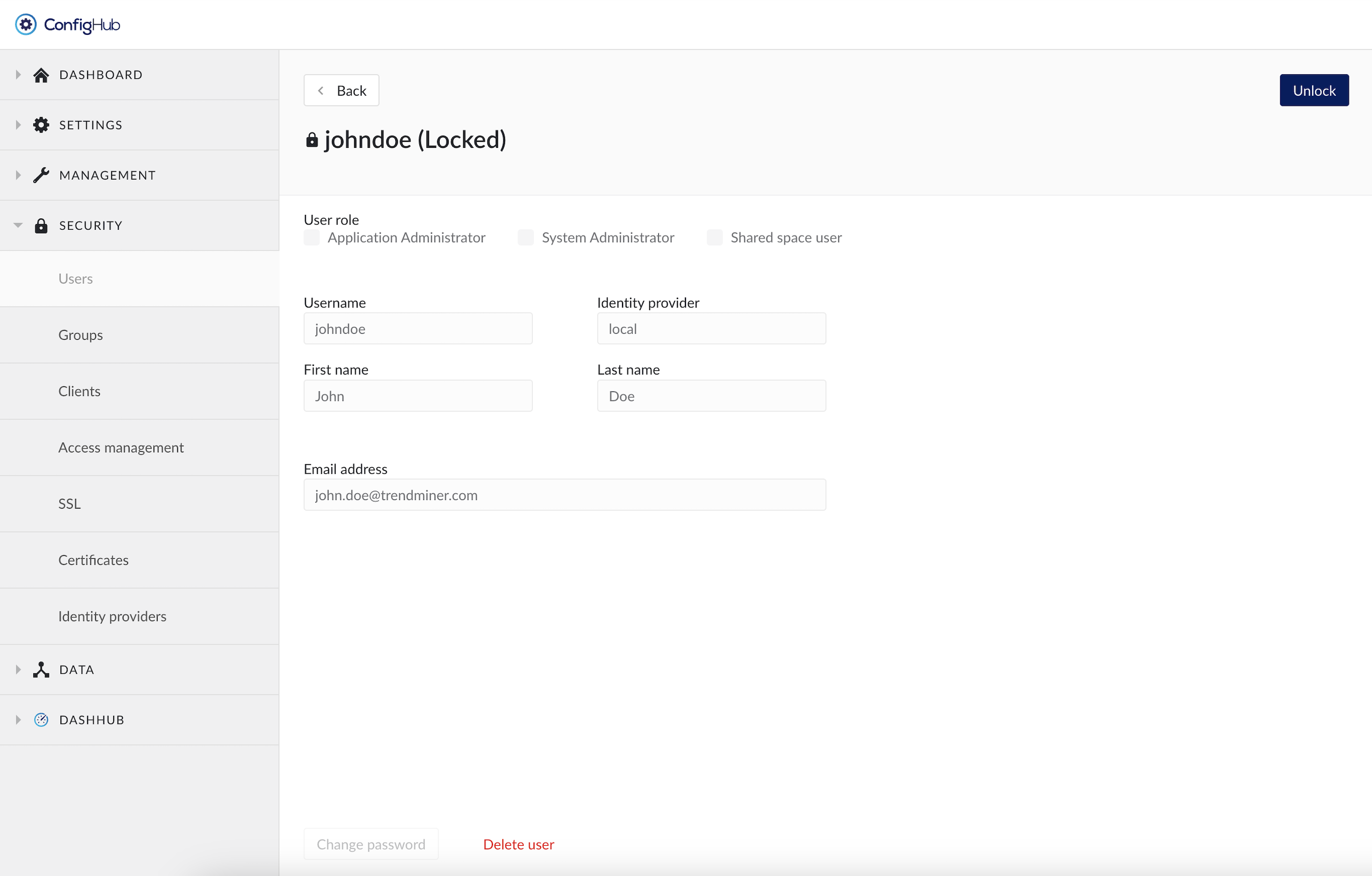

Unlock user account
A user account is automatically locked after 10 login attempts using the wrong password. The user itself will not be able to see the difference between entering a wrong password or the access being denied because of a locked account. In both cases a generic error message is shown on the login page: "Invalid username, password or locked account". This is by design for security reasons.
Only users with the system administrator role can access ConfigHub and look up the user account to check if the account is indeed locked. A locked account can be recognised as follows:
  • A little lock icon in front and the word "Locked" behind the username
  • An "Unlock" button in the top right
  • No option to edit the user details or change the password as long as the account is locked
confighub users user details locked 2024.R1.0
To unlock a user account simply click the "Unlock" button on the top right.
